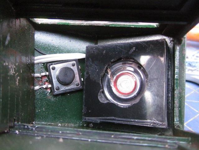

Decided to add sound to my IP Engineering Simplex. It had to be small and being a skinflint, it had to be cheap.
One greetings card sound module from China (£1.29 inc postage)
One small mylar speaker from Maplin - N93FU (£2.29) - I could have used the one which came with the module but it was too large.
The sound of a Simplex diesel was recorded from a video made on a visit to Apedale Valley Railway near Stoke on Trent.

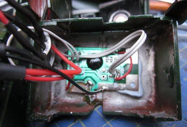

The board was modified by removing the batteries and wiring into the 3.7v supply for the motor and soldering a lead from the on/off switch to the mike terminal (the red wire on the board) - no idea why this makes the sound loop continuously but it works!
The module sits neatly inside the bonnet of the Simplex. The speaker was mounted in a plasticard box and glued under the roof of the cab. The on/off button was also sited there so the sound can be turned off
The sound is not high fidelity but it does add a little something when the loco is chugging around the track - just wish I could enhance the bass tones. There is a half second hiccup at the end of the recording before it loops round again - but for a fiver, I'm not complaining.
