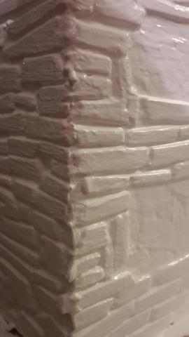

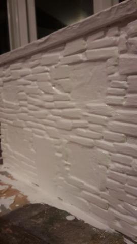

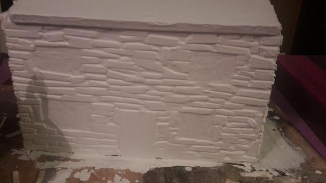

Post by jim@NAL » Tue Feb 17, 2015 11:08 pm

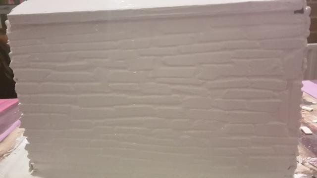

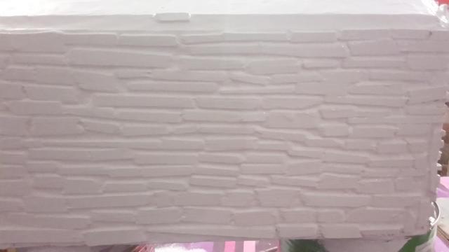

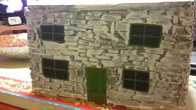

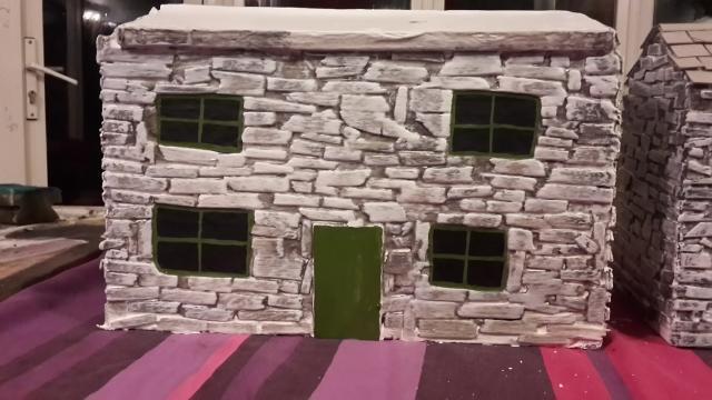

iv decided to build some cottages these are done in the same way iv done many of my buildings I cut out the buildings and they are screwed together I then siliconed the joints in the inside and the whole thing was given a good coat of pva.The roof iv done a little different to help protect the building more it is covered with lagging tape that is used for covering joints on celetx. I also covered the bottom of the wood and the joints inside the building with the lagging tape its very waterproof and sticks like s#it .next I roughly marked out the doors windows etc .the cottages im making are sort of modelled on a lot I see iv villages near me they are very small and often have odd shape windows doors etc .lots more pva and basa wood applied with more layers and layers of pva and then it starts to look like stonework.im going to paint the windows on and I may put a little outside light above the doors.the buildings where then given a coat of exterior paint

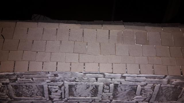

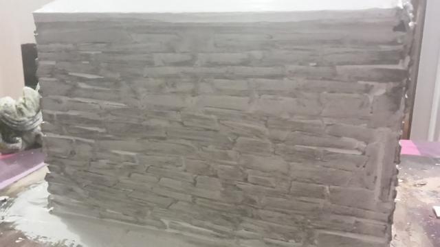

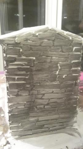

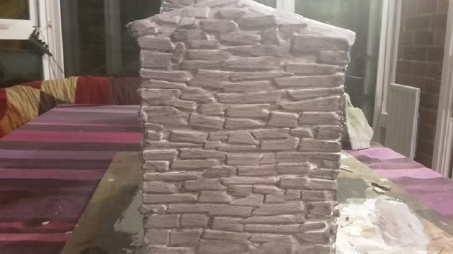

Post by jim@NAL » Thu Feb 19, 2015 10:03 pm

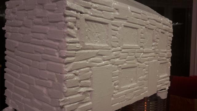

a few more layers and layers of paint and starting too look a bit different
its a bit hard to get good photos but very chuffed with how the stonework looks going to paint some darker colours in to the stone work next

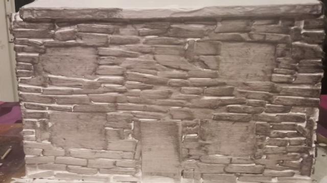

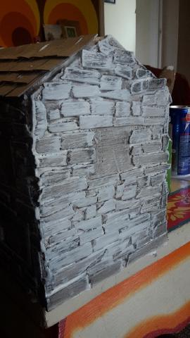

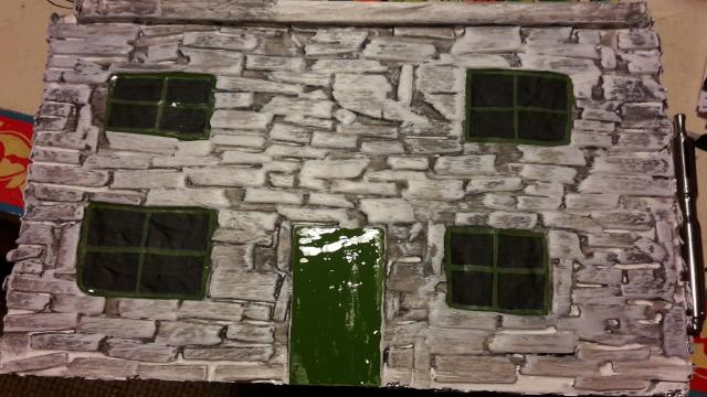

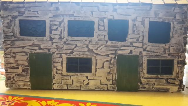

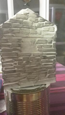

Post by jim@NAL » Thu Feb 19, 2015 11:11 pm

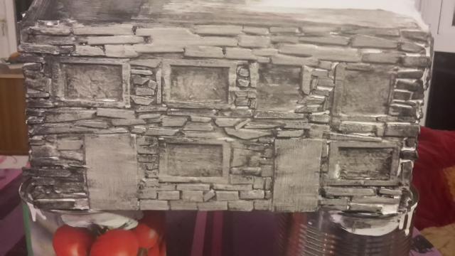

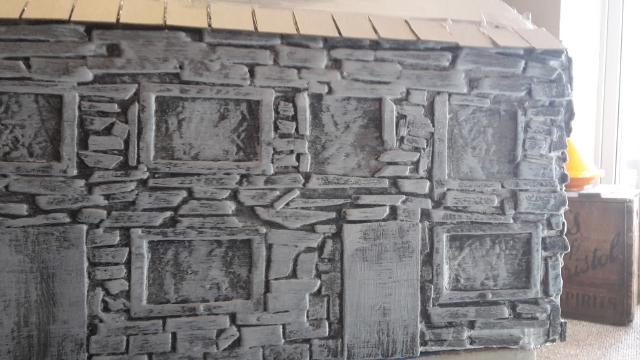

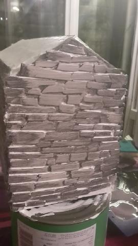

iv put some darker colours on and sponged them in and on the stone work to help highlight and bring out the stones

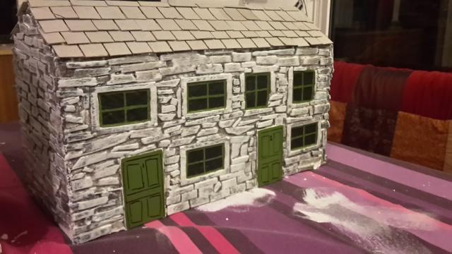

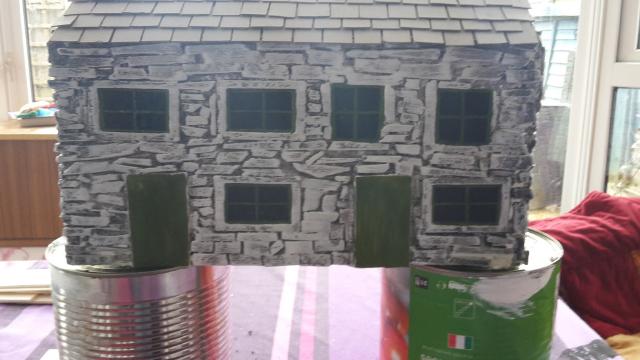

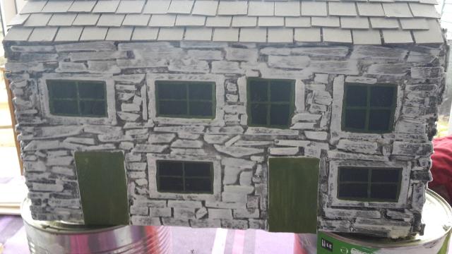

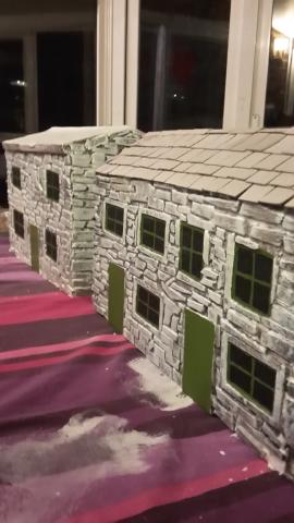

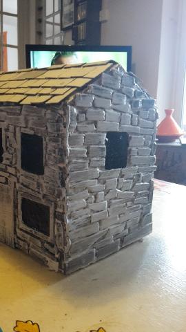

Post by jim@NAL » Sun Feb 22, 2015 12:12 pm

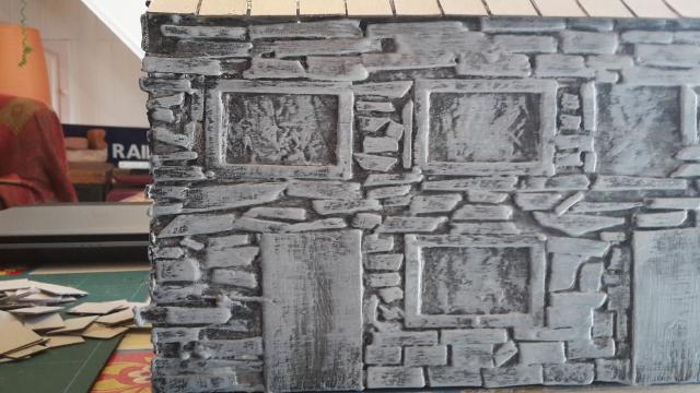

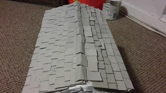

iv painted the stonework and rubbed in some dark colours and dry brushed on some white iv also started the roof on one of the buildings .this is done using card cut to size then glued on

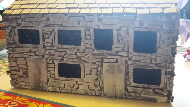

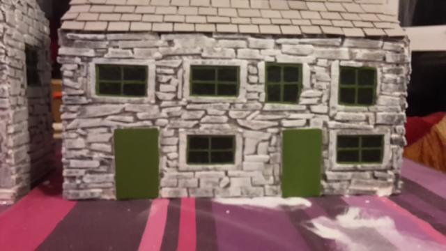

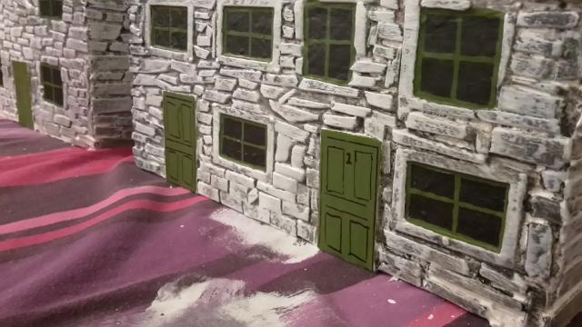

Post by jim@NAL » Sun Feb 22, 2015 9:32 pm
a few more pics from tonight more windows painted and doors hopefully il finish the roof tomorrow after work

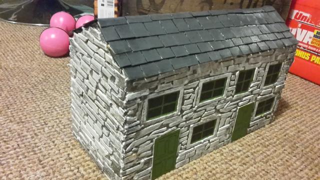

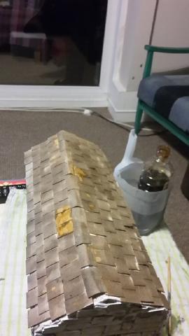

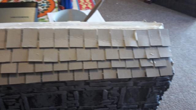

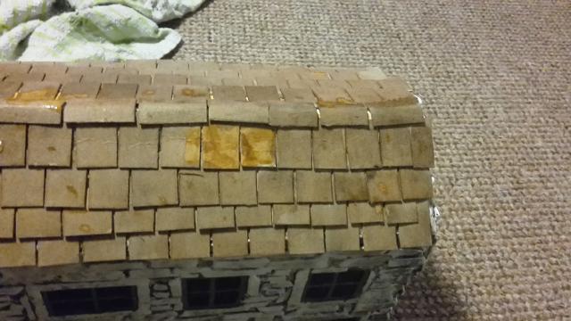

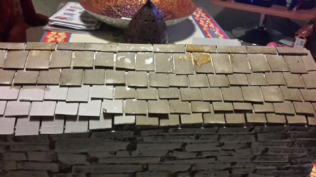

Post by jim@NAL » Tue Feb 24, 2015 9:00 pm

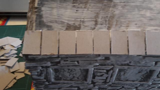

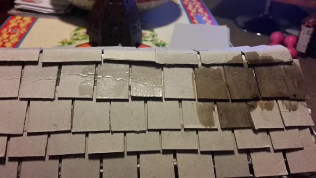

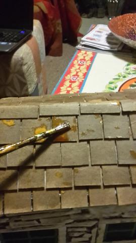

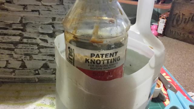

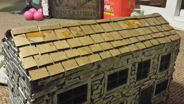

iv cut cardboard slates and glued them on with pva the cardboard is the sort from the back of note pads its good and soaks up whatever you put on it (again this is a tip from peter jones book)the slates are painted with knotting this is the stuff you put on knots on wood to stop them bleeding through the paint its very strange stuff and quite sticky.a tip here is to put the knotting in a tub on hot water it will be less thick and easier too paint on. it was painted with a few coats then left to dry this should waterproof the card then I will paint it with a coat of black paint .iv made the slates look uneven and not straight etc on purpose to give it an aged look

Post by jim@NAL » Tue Feb 24, 2015 10:50 pm

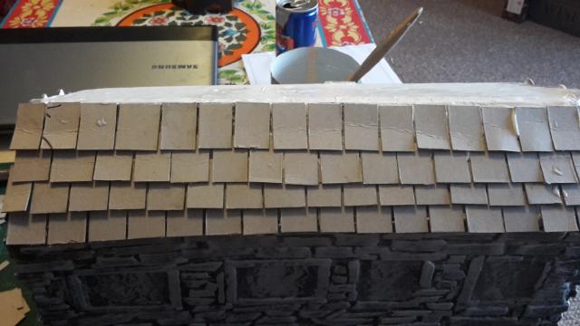

more paint added starting too look quite good
going to leave this to dry tonight and see what it looks like in the morning got 1 more roof too paint/weatherproof and then they can go outside

Post by jim@NAL » Tue Feb 24, 2015 10:55 pm
quite chuffed with these cottages they haven't taken too long to make jest over a week of a few hours each night and haven't had too spend a lot
