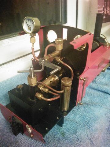

Hi all, i just tried steaming my modified mamod (internally gas fired) and it appears that the gas burner will go out after about 30 seconds of burning, i tried it indoors but it was the same, any ideas on why this is happening?
Image[/img]
cheers
Joe
by the way it now has a new safety valve and pressure gauge fitted

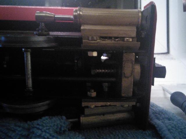

Would it be possible to have some pictures of the underneath ? Your loco is something of a rarity so the builder might have had a different way of doing things.

Heres some pictures of my loco, with the new pressure gauge fitted, you will notice there is a small dent on the back buffer beam corner which i will need to straighten. (the has a cab roof and sides etc but i took them of to do repairs)

Thanks for the photos. It does look like standard mamod parts down there. As i said earlier, there should be an O ring under the circular plate on the reversing valve, this is what forms the seal. Other things to check for are loose screws, this does happen occasonanly on new locos as things settle down.
EDIT: Just spotted something, is the pipe touching the bolt with the spring on it at the bottom of the photo ?
