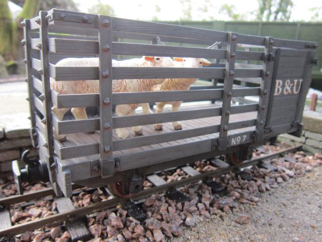

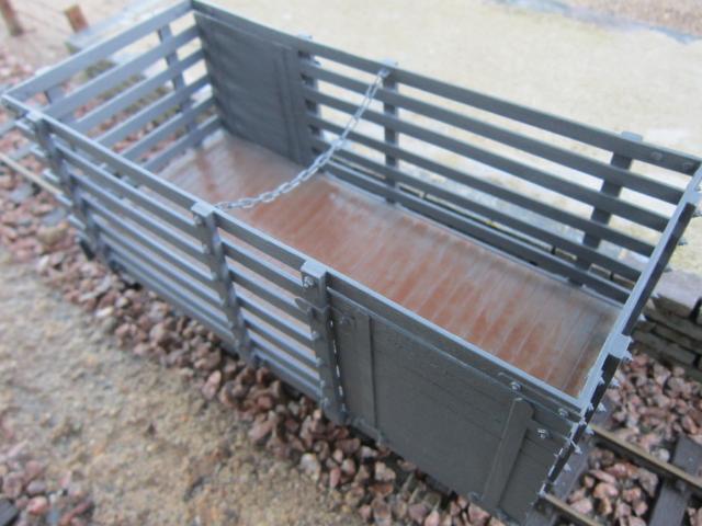

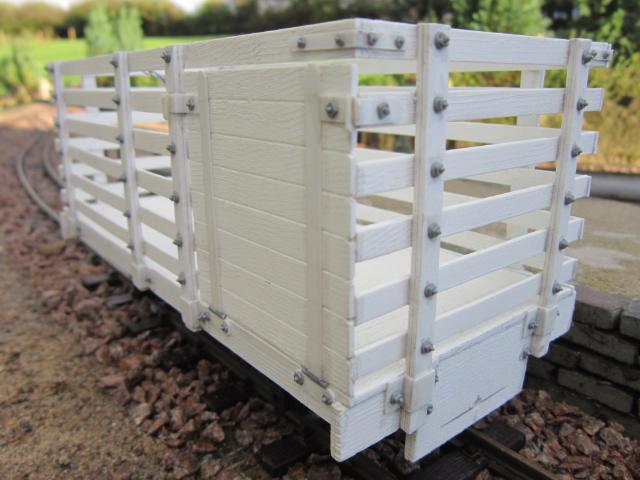

Post by Peter Butler » Wed Nov 12, 2014 1:57 pm
You might not have seen my recent scratch-build of a W&L sheep wagon which I posted on another thread. This is taken from the W&L book which shows a black and white photograph only with no dimensions. I had to base the size on a similar cattle truck which does have dimensional drawings.

Post by Hope Mountain Railway » Thu Nov 13, 2014 7:38 pm
Photos useful for inspiration - and beautifully made. But just for the record, none of the W & Ll Sheep wagons had planks above the ramp and none had two ramps. Some had 5 planks and some had 6. Some had no ramps at all. I say this with some authority, as I have spent the last 6 months researching and drawing them with some great help from the W & Ll archivist.

Post by Peter Butler » Thu Nov 13, 2014 9:45 pm
You are absolutely correct in pointing out my errors. I made no attempt to model a prototype but simply to base my sheep truck on one I thought typical of the type.
The door thing is interesting as you can't see from the photograph whether there is more than one, however, I decided that my sheep should be loaded from my cattle dock and if the truck ended up facing the wrong way, this would not be possible!
None of my stock is prototypical but I'm generally pleased with the overall impression.

Post by Hope Mountain Railway » Thu Nov 13, 2014 10:12 pm
And a lovely job you have done too, Paul. Have you used wood or plastic? Looks like wood?

Post by Peter Butler » Thu Nov 13, 2014 11:39 pm
Hope Mountain Railway:105653 wrote:And a lovely job you have done too, Paul. (Peter!) Have you used wood or  plastic? Looks like wood?
All of my models are made from plasticard but where appropriate woodgrain effect is made by scraping with a fine tooth razor saw blade in the direction of the grain. I have been working with wood all of my life and I find genuine woodgrain does not scale-down successfully and often becomes furry when paint is applied. Plastic stays put once the desired effect is achieved and needs no further attention other than weathering.
