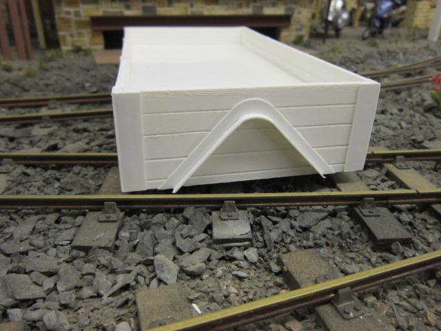

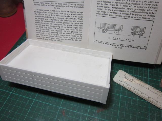

Also, a four plank open wagon base on the W&L (again)
To permanently fit a load of either coal or gravel I have set inside a raised platform to lessen the quantity of material. underneath this, at floor level, is a lead sheet weight for stability.
I have scribed the planks and wood grain effects and added corner strapping. Just the doors, end strapping, hinges etc. to add before painting. As yet I have no axleguards to fit these wagons but that can wait.

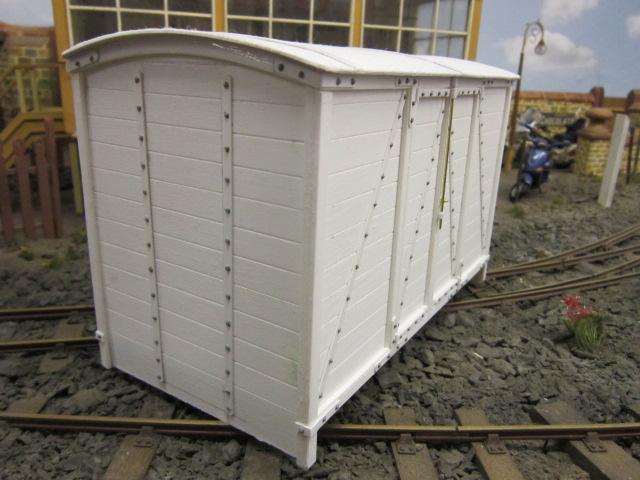

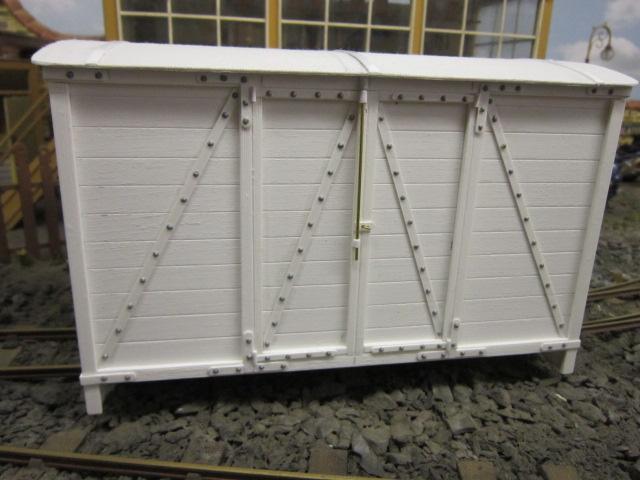

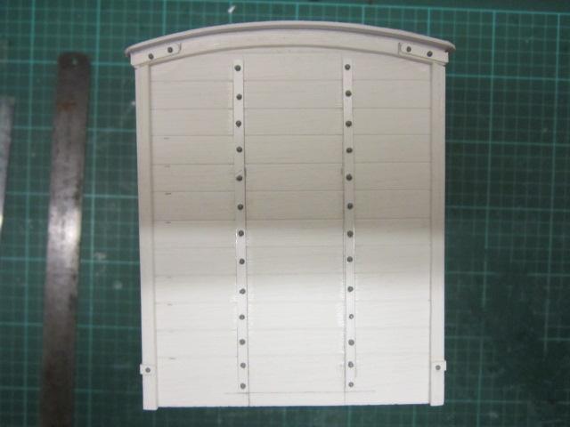

The covered van is more advanced with the doors, bracing and framework fitted so far. Inside can be seen the strengthening pieces I use to make the structure strong. This van also has lead sheet weights stuck inside at floor level.

However, I have made good progess on the covered van having fitted the roof and added a canvas effect cover. Also all of the bolt heads have been attached and it is ready for painting tomorrow....
The open wagon is lagging behind but the strapping is almost finished and the bolt heads (far fewer than the van) shouldn't take too long.
