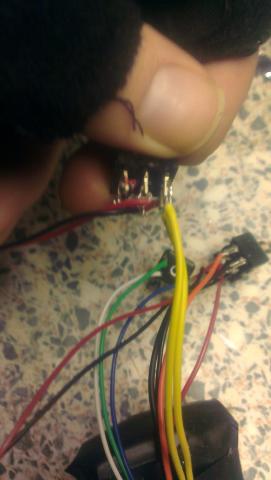

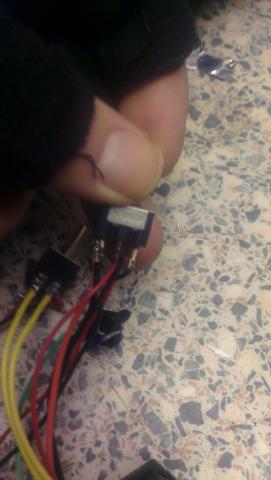

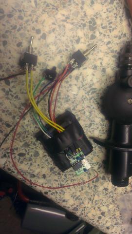

Anyway, just before Christmas I ordered a Andel PWM speed controller to fit to a Busted bricks loco. I was intending to run on 3AA batteries, and the Andel model was advertised as having a voltage input of 3.5V to 12V, so I thought it would be okay.
I followed the instructions, but I don't get any variation in motor speed. I was just wondering if any one had any suggestions for trouble shooting? I can wire up a circuit, but when it gets to more advanced electronics I can get a bit lost! I've already tried swapping round the wires on the potentiometer, but to no avail.
I've also tried contacting Andel, but I have had no response to my enquiries. I've attached some images of what I have done so far.

I too have one of these AnDel manual speed controllers, going into the same type of loco as yours. Mine works nicely... good piece of kit so far.
Looks like you have the pot wired up correctly: blue to centre pin, white and green to the two outer ones. But I'd start the diagnostics in this area.
Do you have a multimeter handy? If so, set it to measure resistance in a range up to 100K or so (mine has a 200K range which is ideal) and set the pot to the middle of its range. Then, with the battery disconnected, measure the resistances between the points on the speed controller board where the blue, white and green wires join. You ought to get about 100K between green and white and 50K between green and blue, and white and blue.
Yes, you need at least three hands for this. The 100K should stay the same as you adjust the pot but the other two figures will change (still adding up to 100K).
If vastly different from that, suspect the pot and its wiring. (In which case repeat the measurements at the three terminals on the pot; if still wrong there, replace the pot. If right there, suspect the wiring and check continuity of each wire in turn.)

Hmmm, so that's looking OK.
Ummm, check whether you've had an email back from Andy Bell? There's also a couple of phone numbers on his web site (under "Enquiries") which might be worth a go, both daytime and evening?

Well I spoke to Andel and its all sorted now. It turned out to be a connection where the solder ran across, between the negative and yellow. It made the electricity bypass the circuit, hence the motor always running at full pelt. Works a treat now.
So for anyone who gets a Andel PWM speed controller and it doesn't work, check the negative and first yellow wire are not shorting (i.e. joined).
