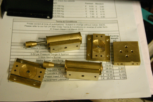

Here's a view of the lapped reverser lever, reverser block, cylinders and the port faces. I will be using these cylinders for testing purposes and then I will machine bigger and more powerful ones.

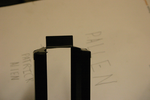

However it is not all plain sailing. This pic shows the combustion chamber has a slight deformity at the cab end of it. we have already devised a plan to rectify this.

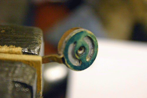

And also the reverser lever solder paste had not sealed properly leaving three small holes. This has since being soldered up.

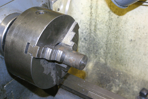

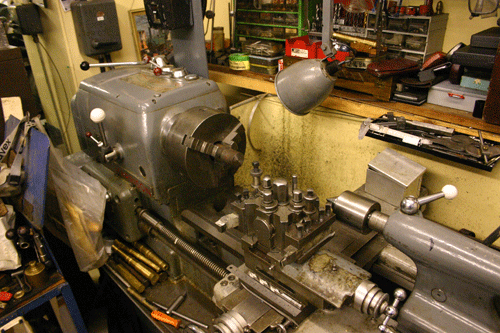

Here's a view of the lathe been set up to start turning up the wheels. it later turned out that the bar was high tensile steel which would not turn properly in the lathe.
another view of the lathe.

If those are the original cylinders looks like MSS have taken a backwards step in changing them. One weakness of the old Mamod SL cylinders was the end cap through which the piston rod travels was either not drilled fine enough or wore out very quickly causing a fair bit of steam to leak there (one reason for gland nuts on after market replacements). Previously MSS had used a thicker gland on that end cap. Wonder why the change back to a previous configuration?

The end cap I was referring to is A2 in this photo from my MSS kit build.
And also marked A2 in your photo.
I assume the rivet you are referring to is on the end caps marked E. As I cannot see how a rivet would attach to anything there I wonder if they have had too many plain end caps drilled and then just riveted up the ones fitted on the opposite end to the piston, to plug the hole.
Here is what an original Mamod SL cylinder looks like in pieces.
