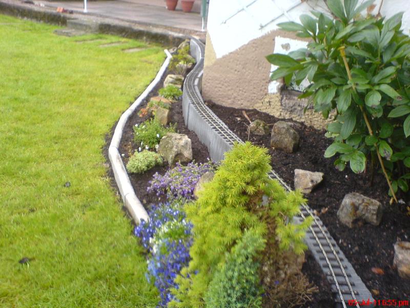

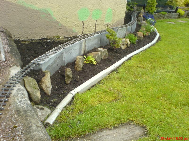

Post by LMS-Jools » Mon Jul 04, 2011 11:05 pm
Track laid this evening more pics tommoz.

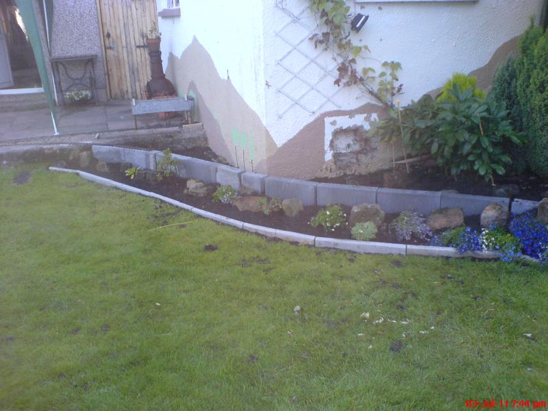

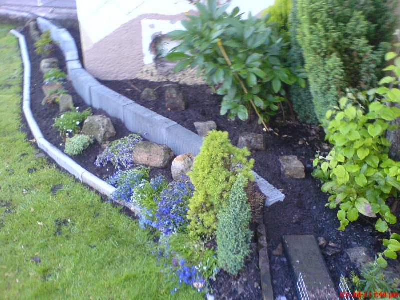

Post by LMS-Jools » Tue Jul 05, 2011 7:08 pm
Track down.
Post by tom_tom_go » Tue Jul 05, 2011 7:34 pm
Are the breeze blocks cemented in or just dug into the earth?
I was wondering whether to use these on my line.
Tom
RWLR
LMS-Jools
Post by LMS-Jools » Wed Jul 06, 2011 5:48 pm
They are lightweight aerated blocks bedded on large blobs of mortar at each end set in a trench dug to approx correct level as required.
Quick and easy to do and once you have got the first one correct and level you can work along with a spirit level.
Provided no one applies any significant lateral force they are sound.
The track is pinned down with short nails very easily.

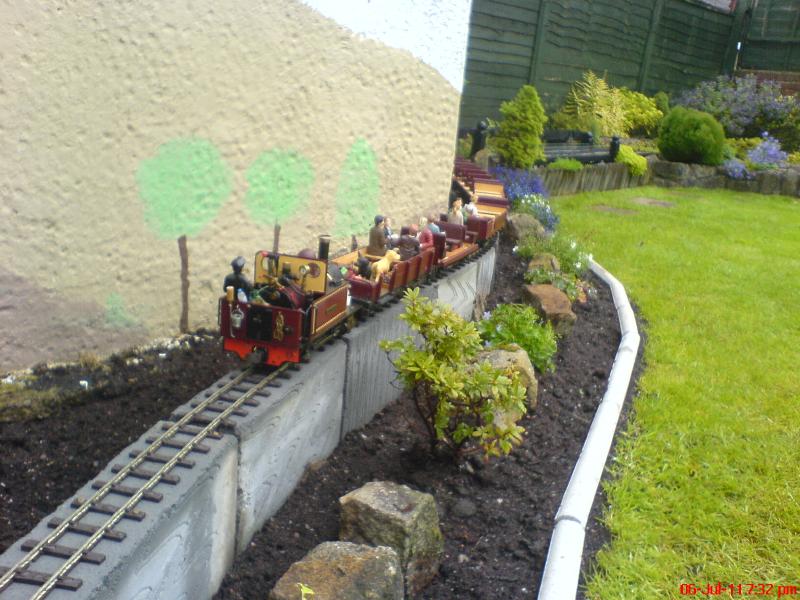

Post by LMS-Jools » Wed Jul 06, 2011 9:06 pm
Works train in somewhat damp conditions.
Steam at Little Morecambe once again now the station is reconnected.
Steam hauled train climbs from Morecambe on the new formation.
Narrow Minded
Post by Narrow Minded » Wed Jul 06, 2011 9:41 pm
Nice job and I'm luvvin' those curves! ;)
