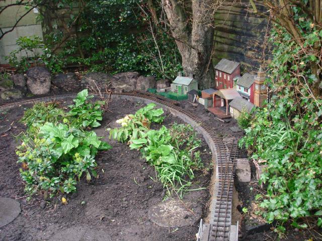

Post by SLRmidge » Sun Mar 20, 2011 10:19 am
Having lately started relaying a curve at the bottom of my modest sized garden, we've tried to put in a transitional curve this time.
The tightest bit is in the middle of the rockery stone area..........
METHSSNIFFER
Post by METHSSNIFFER » Sun Mar 20, 2011 10:24 am
What is a sharp curve anything less than 2' 6" radius I would thought. Any 040 loco would transgress a 2' radii. I have sharp curves and I open up the gauge on the outer rail. As I have white metal chairs and pins this is easier to do. But with plastic sleeping its best to remove the rail cut out the sleepers and rethread them without the webbing and space accordingly
METHSSNIFFER
Post by METHSSNIFFER » Sun Mar 20, 2011 10:26 am
SLRmidge:50645 wrote:Having lately started relaying a curve at the bottom of my modest sized garden, we've tried to put in a transitional curve this time.
Could you have utilised more of the space towards the fence and round the back of the tree

SLRmidge
Post by SLRmidge » Sun Mar 20, 2011 12:54 pm
Possibly, but then when I take photos, which I like to do, the background would be of a fence instead of foliage.
