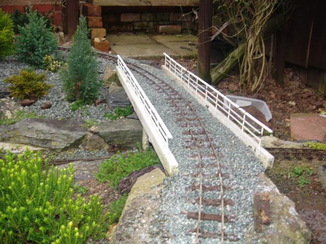

Post by METHSSNIFFER » Wed Apr 14, 2010 3:09 pm
Rhoslyn bridge with new ballast and railings! I stuck to the old faithful method of pva which I thought will waterproof the bridge at the same time.
Post by laalratty » Wed Apr 14, 2010 8:58 pm
Looks brilliant, lines that arn't ballasted are always missing something atmosphere wise. Your line looks very scenic as well :)

Post by METHSSNIFFER » Wed Apr 14, 2010 10:25 pm
I think it needs weathering a bit with some rust and time but its coming on. I used a kitchen cullander and one of those mesh filing trays to get the right grade of ballast from the grit I collected.
Can you see how Ive painted mountain scenery on my shed to give a bit of a backdrop.

METHSSNIFFER
Post by METHSSNIFFER » Wed Apr 14, 2010 10:57 pm
Another pic from another angle. I still have a lot of work to do.
