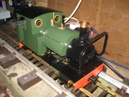

Post by PCLR » Thu Dec 17, 2009 6:52 pm
thought i post this pice for people may be have difflucts fiting rc to a mortimer
The stuff I used was
auccucraft mortimer
4 AA rechargeable batterys
planet transmitter 2.4GHz ( so no interrens or rusty bolt effect) sorces fron AnDel models at 39.99 it great vavle for money
a 4 cell battery box from maplin (longer oner 4 2 cell long by 2 cell wide )
9 gram micro servo of ebay (the cheapo ones got a bay of them)
rising steam very slowy
here's the cab the white box on the right tuck in to the tank is the reciver
here's the servo aporating the reg you can see the mass of wise to
here's the best bit the bunker i made the cover out of a bit of brass and a little coal

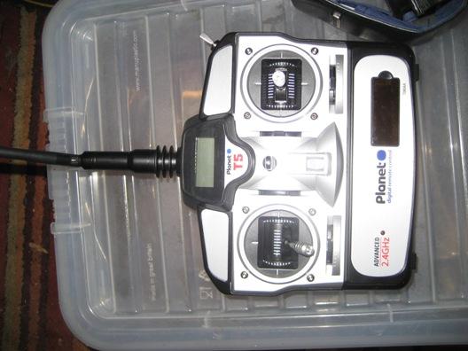

here's the transmitter
edrig making a bloody mess again!!!!
on it first run the cylinder leaks!!
