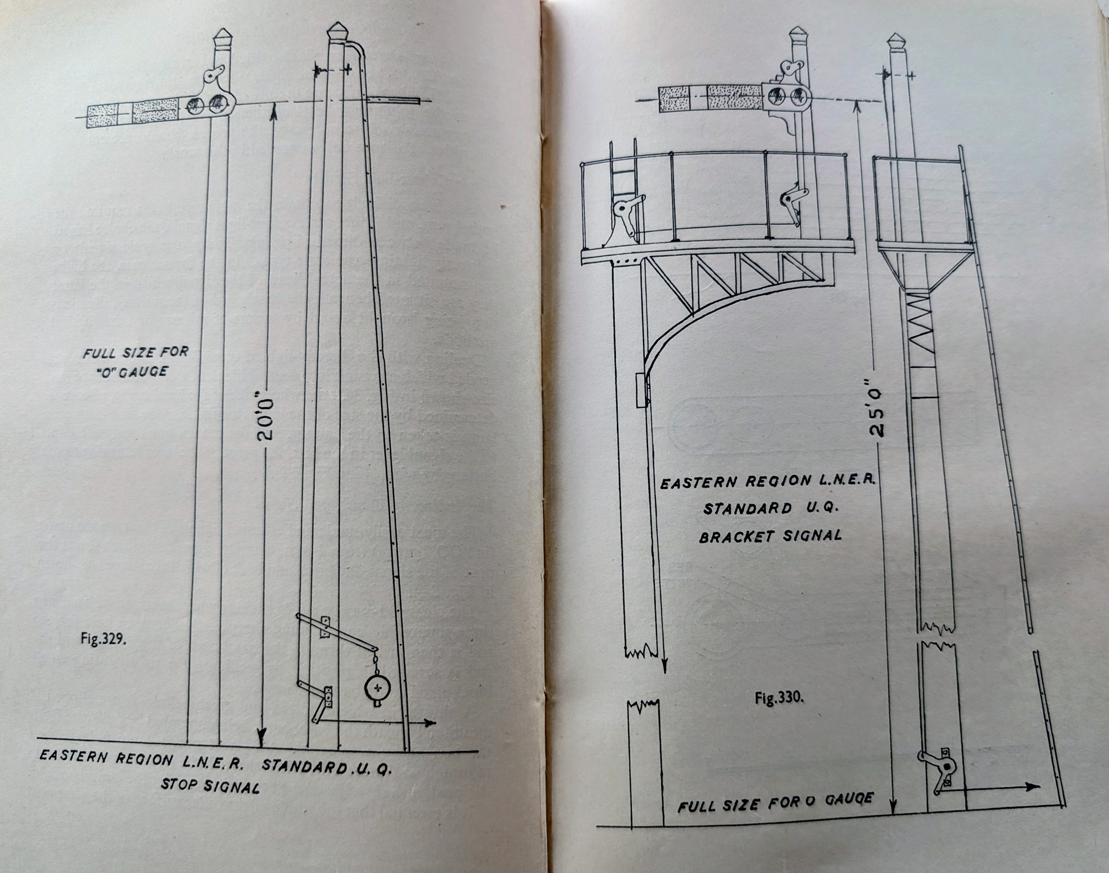

Not entirely relevant but might be of interest. Whilst at the East Kiln Light Railway on Sunday, I picked up a copy of Ernest Carter's Model Railway Encyclopedia which includes this drawing.

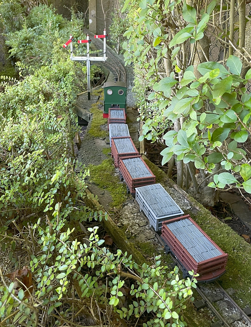

If its of any help, the brackets on my 3-way are 170mm to underside from rail level, but I'm using 16mm on 32mm track. There might be some food for thought on my build thread:
viewtopic.php?f=25&t=11935&p=138211hili ... os#p138211
