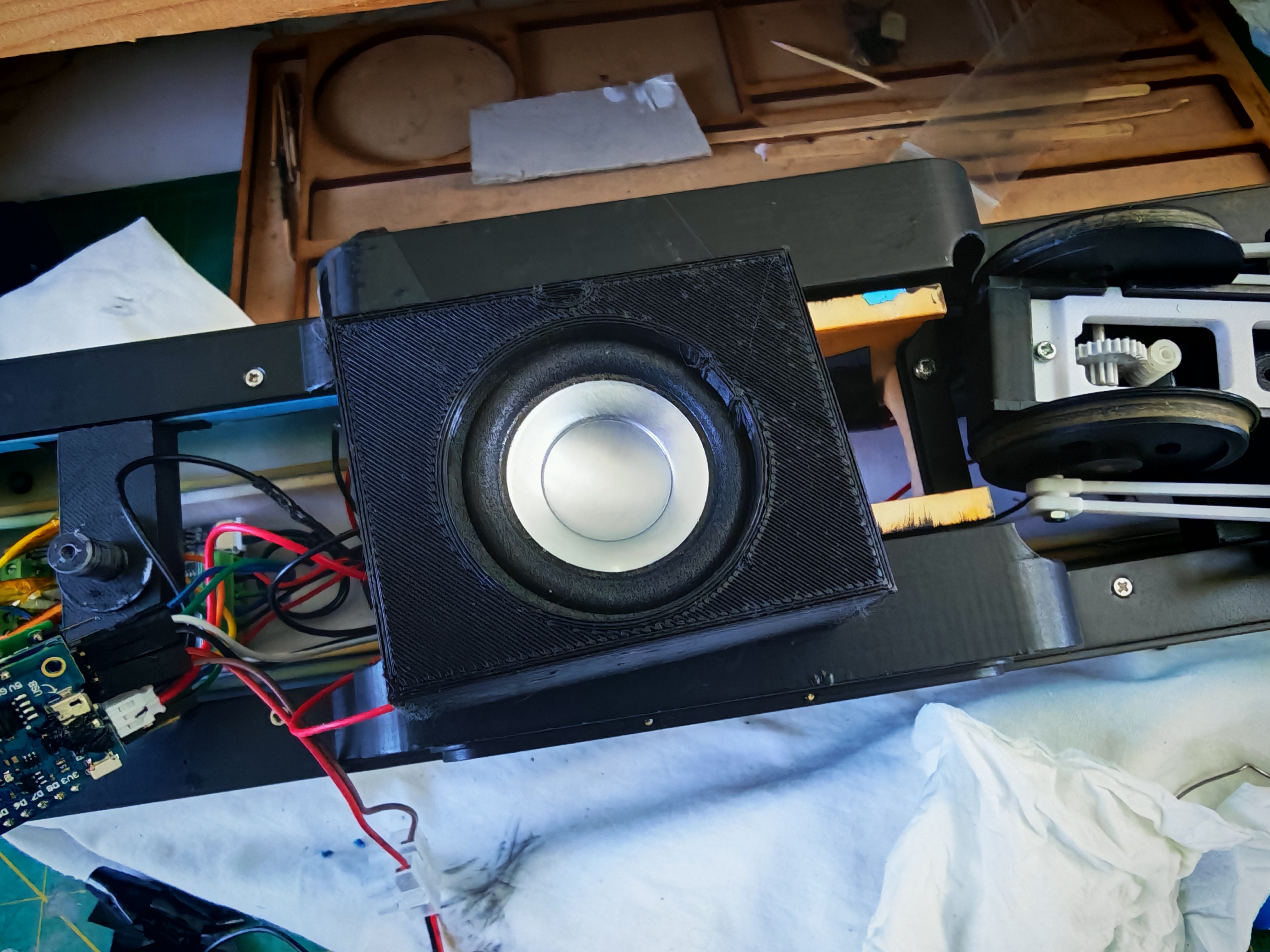

I've a Visaton BF 45.. And I'm trying to print a surround for it... It's more expensive than the ones you've linked, so, should be good.. 😌

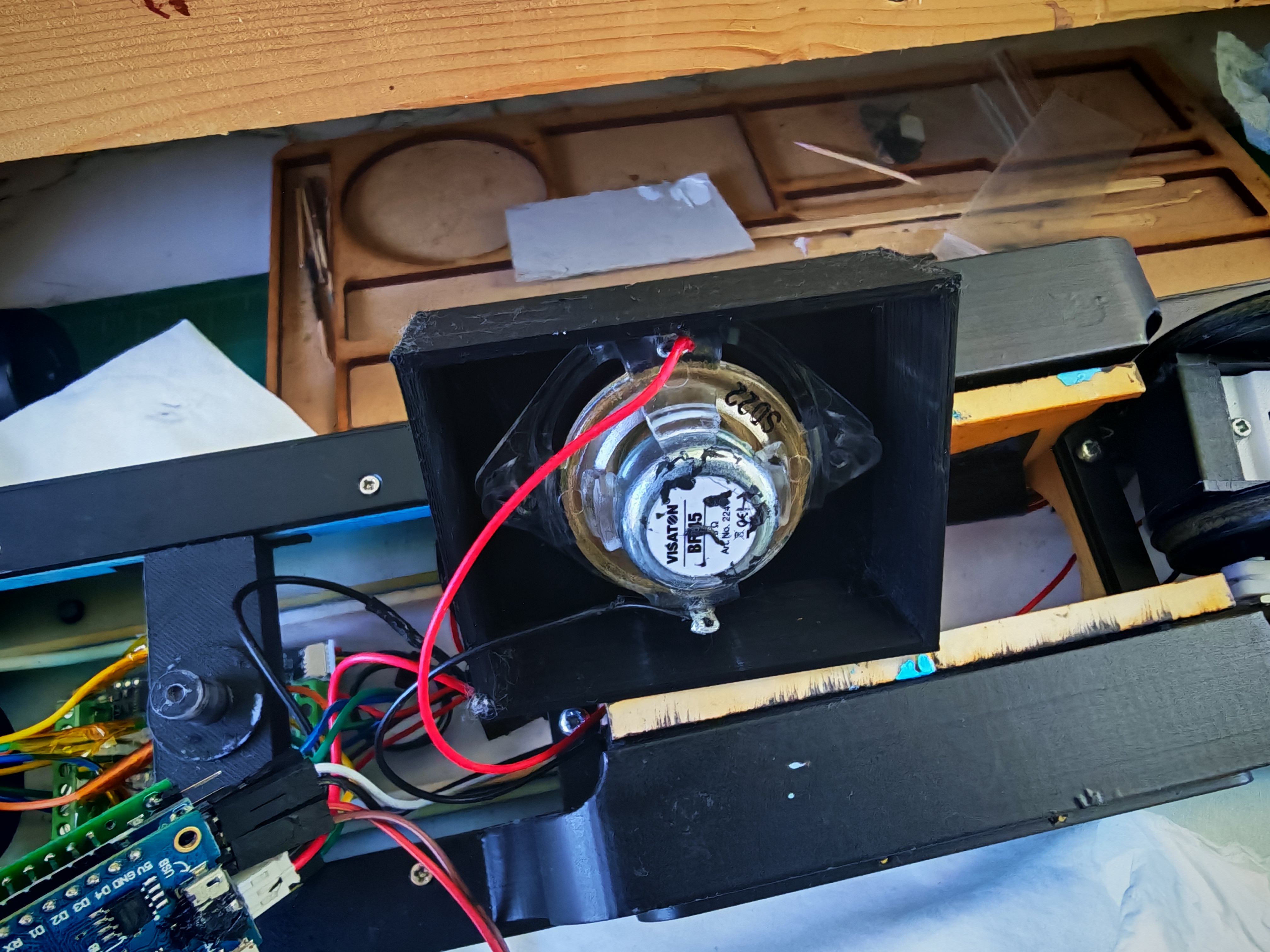

Not sure how/where you are planning to mount it, but the important bit is that the 'works' i.e the magnet etc at the back is completely enclosed and sealed to the front surround of the speaker cone. The front thick plate in your first picture does nothing acoustically, but you do need a box around everything you can see in the 2nd pic. Doesn't need anything fancy , it can be a simple as cut down lid of an aerosol can, if it fits, but a bit meatier is better if you have the room.
Your Visaton BF 45 appears to be 1.8" ( 50mm) diameter so a short piece of plastic waste pipe would possibly work with a piece of flat plastics sheet to cover the open end, or you could of course print something, but I'd experiment with lids, pipe etc first to see if it gives the sort of improvement you are after

Ok, so that box is going to slide into the frame of the loco. - But I made it a tick shallow at the back, so it's not totally enclosed.
