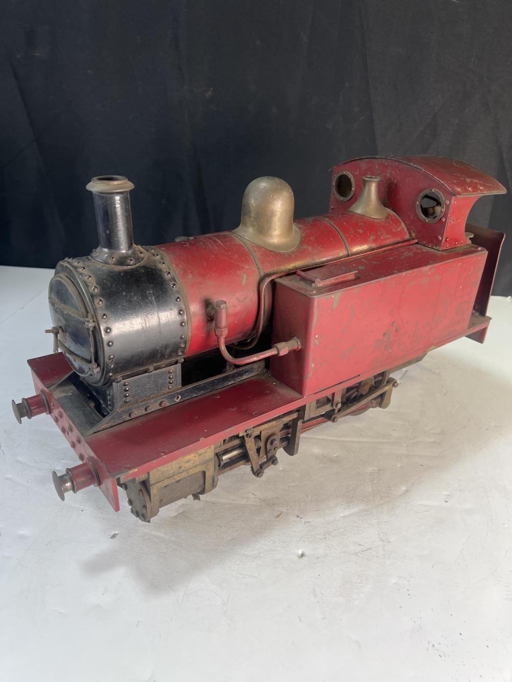

Need to know where to put the water in

I'm afraid that to answer that question, we would need a fair bit more information. The model loco manufacturer, the prototype name ( if there is one) or the model name, would be a start. Is it a tender loco or a tank engine, that might give those who know about these things a clue to answer your question.

tank locomotive

There is a check valve on the boiler visible in front of the side tank. One side or the other should have a pump handle fitting to pump water into the boiler. I have a 3.5-inch gauge "Tich " by LBSC and this is how mine works. The tank hatch on the right side of my engine has a pump hand fitting and you attach an extension on the pump and away you go. My pump was used to do a hydrostatic test for leaks, and it pumps up to 120 PSI for the test.

Do I need some external pump to fill the boiler with water. How would l get a pump like that?

It looks like I have a “Juliet” an LBSC 0.4.0 Steam Locomotive. Any info on how to add water to it. and how to add a pressure gauge?

Frank, I know very little about the intricasies of kit built steam loco's, but looking at the state of yours from that photo, I would say that it needs a fair bit of work before you could even think about steaming it.
From the very sensible questions you've asked I'm guessing that it has no instructions or other paperwork, especially a boiler test certificate? Without having the boiler test I think it would actually be illegal, and possibly suicidal, to steam it up.
If you haven't already, do a google search for simply " LBSC Juliette" and you will get loads of hits from companies selling them in all sorts of stages of build, and/or the drawings and photos, and /or components like gauges.

At 24 seconds into that video also at 2 min 11 secs you will notice what appears to be a pump handle sticking up from the near side tank water hatch indicating a pump fitted inside the tank. At a guess I would also say that looking at the loose fit of the steam dome there may be a filler cap underneath for the initial fill of the boiler.
Rik's info about at least a hydraulic test on the boiler is sound advice.

I wasn't planning to steam it up I just wanted to attempt to clean the water gauge out so planned to added some white vinagar into the boiler to let it dissolve sediments.
