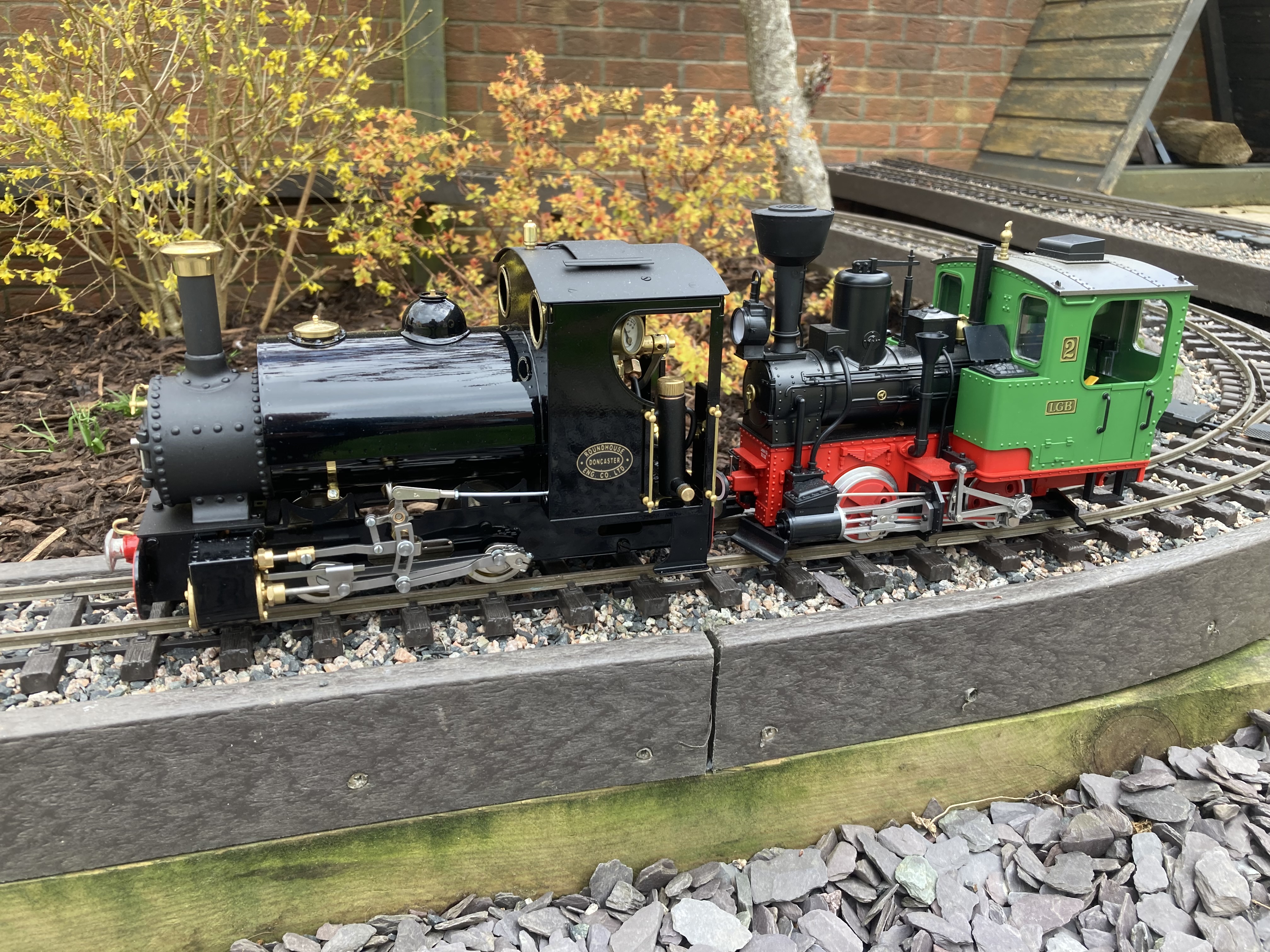

Yes the most popular garden railway scale for UK narrow gauge prototypes is 16mm /ft or 1:19 scale. This usually uses 32mm (O gauge) track representing 2ft gauge or 45mm (Gauge 1) track that scales to approximately 2ft 9 inch gauge. That doesn’t mean the models are necessarily larger than your G scale models as that depends on the size of the prototype being modelled.
To help visualise the difference, here’s a G gauge LGB Stainz next to a 16mm/ft Roundhouse Katie.
