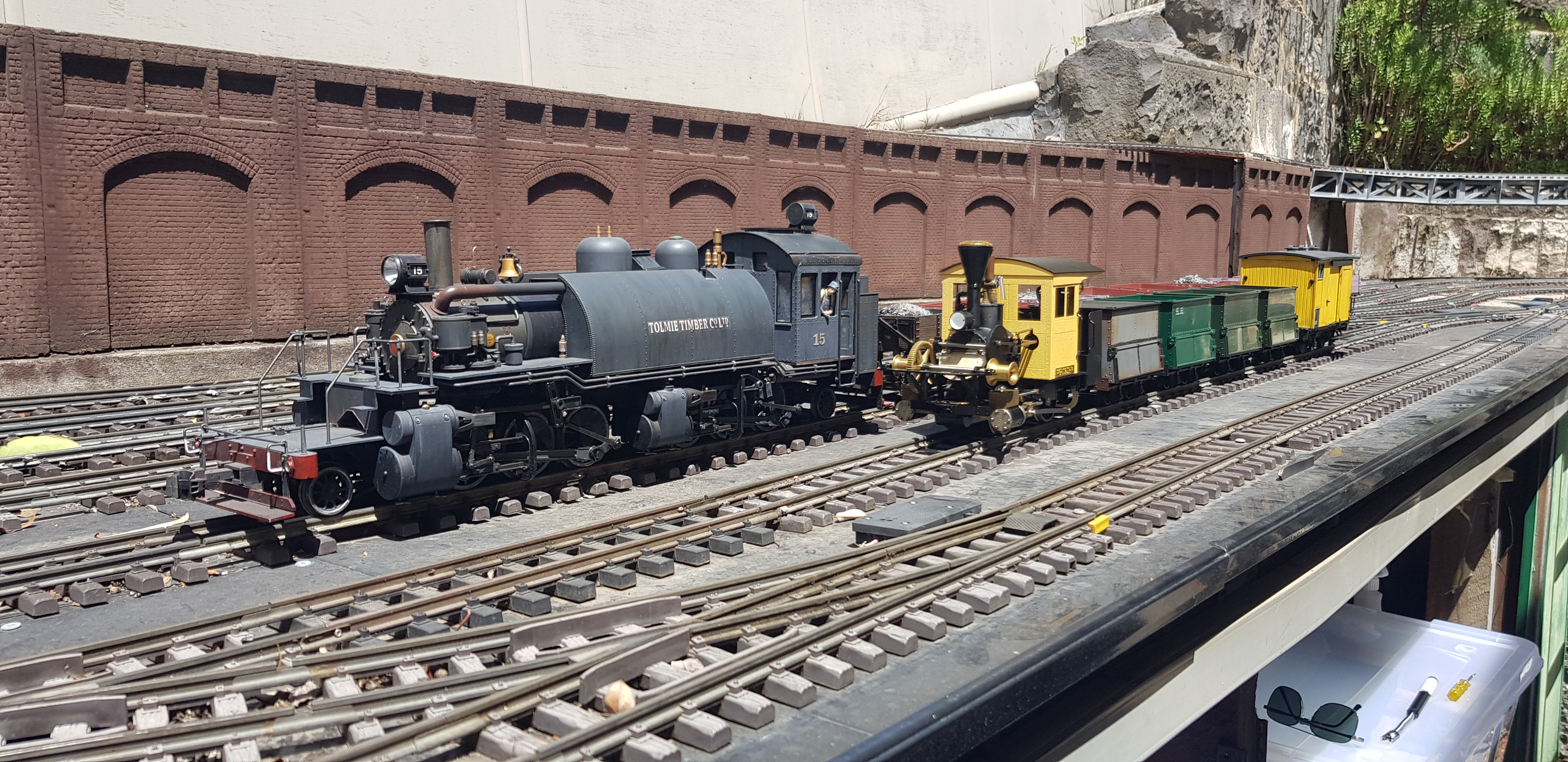

Hello,
I wondered if anyone on this forum had installed radio control onto a Bowande KM1 Falk No.1? (seen here next to my RC Bachmann Mallet)
(The Falk is the yellow one)
I have the engine running quite nicely but it becomes a bit of a road runner on the straights if the regulator is set to get a train around the curves at the club track - I also run on several lines that have quite steep grades that require regulator control for the engine.

Are we talking about the yellow locomotive? (Sorry, but I have no idea which is the Bachmann and which is the Bowande loco).
It's not impossible to fit RC to any loco, but compromises may be needed. I've squeezed single channel into my Accucraft Decauville 0-4-0 just by adding a coal bunker to the rear of the footplate.

Hi Lonsdaler,
the Falk is the yellow locomotive in the image (Live Steam) whilst the other engine is a Bachmann Mallet (CVP Airwire, ESU 5XL decoder with Mallet sounds and custom LiIon battery).
I'm assuming you are talking about the 16mm Decauville when you talk about adding a coal bunker?
I'm interested as I'm installing two channels of RC to a 7/8" Accucraft Decauville and the Fosteks receiver, batteries and switch/charging socket will all fit in the side bunker now that I have moved to the larger under floor gas tank.

David P wrote: Wed Feb 26, 2025 1:16 am Hello,
Quite a contrast between the 2 locos!
