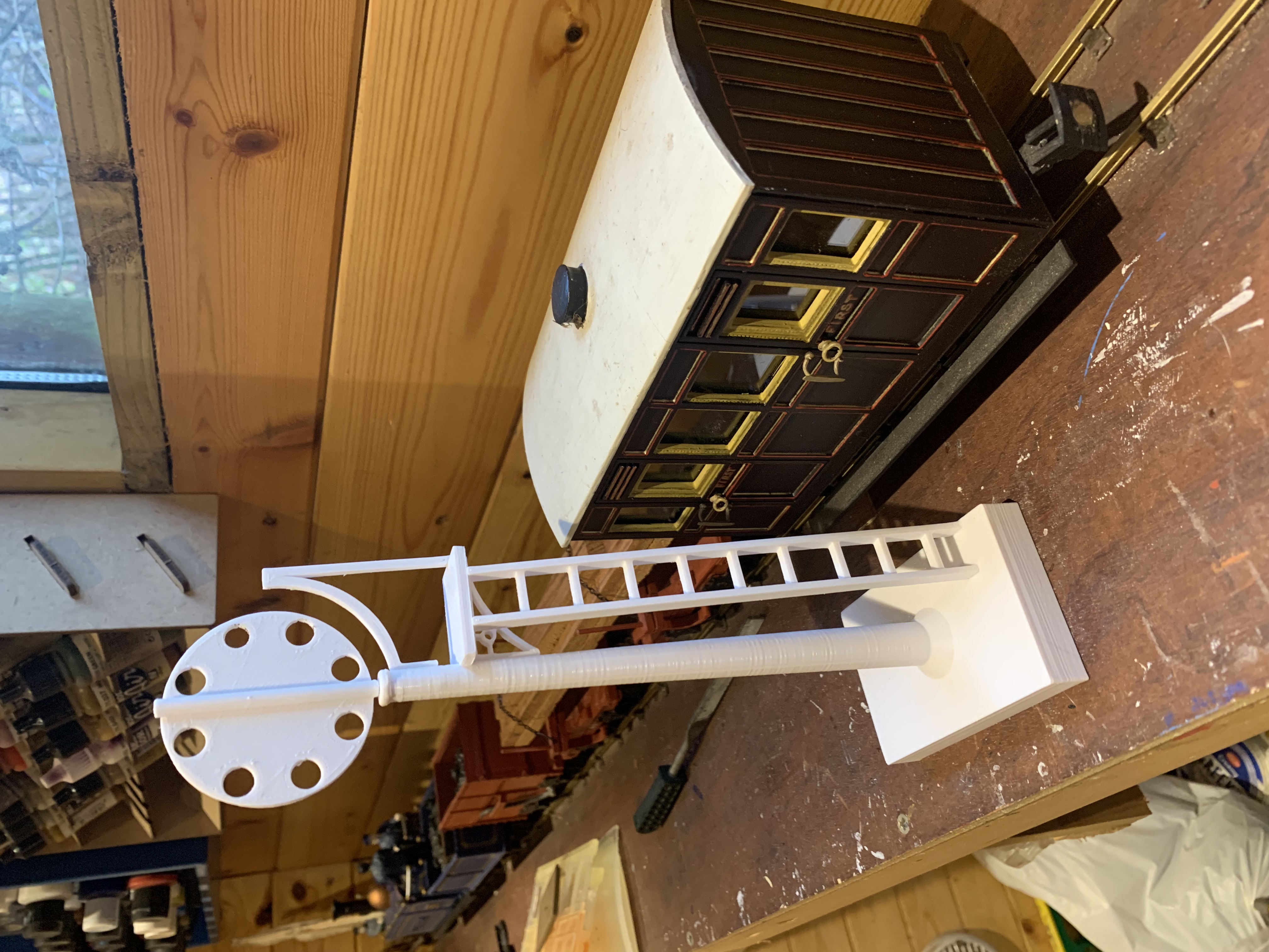

So the first thing I tried to print was the Festiniog Disk signal I have been planning to build for a while. This is the CAD model:
The plan is to use a 2mm diameter brass tube as a shaft which will have a wire passing through it, and an LED on top of it so that the lamp works. Perhaps a servo in the base to turn the disc, and a single 3032 cell in a switched holder to power the LED.
So I tried printing the main body as one piece to see what would happen. Here is the result:
That was printed in ABS as you see it with the bottom of the base on the printer bed. ABS is difficult to print with because it tends to split as it cools. This print had only one split in it in one leg of the ladder - and that was at the level where I had paused the print to adjust a cover in the printer. The very long supports worked and supported the platform properly but the frame under the platform broke off while I was removing the supports. It withstood some rough handling. It worked but I think there are advantages to making this as components and bonding them together. The glueing is so easy with ABS ( the solvent is acetone) that it is the obvious way forward. This printer is certainly a step forward in that I can now print in ABS without a raft or brim. The textured metal bed does not come out as the last one did and I was concerned about how I would get the components off the bed - without a raft to reduce the adhesion. Particularly as I couldn't get it off the bed as soon as the print had finished. There is a glue which they insist you apply to the bed before first use. Something I have not had to do before. I was amazed when I went back after it had cooled and the print just fell off the bed.
It is also fast. The castle towers which I have also been printing for a while took 4 prints each of 12 hours on my old printer, in this one I can do the whole tower as one piece in 6 hours. So that project will move along swiftly when I get back to it.

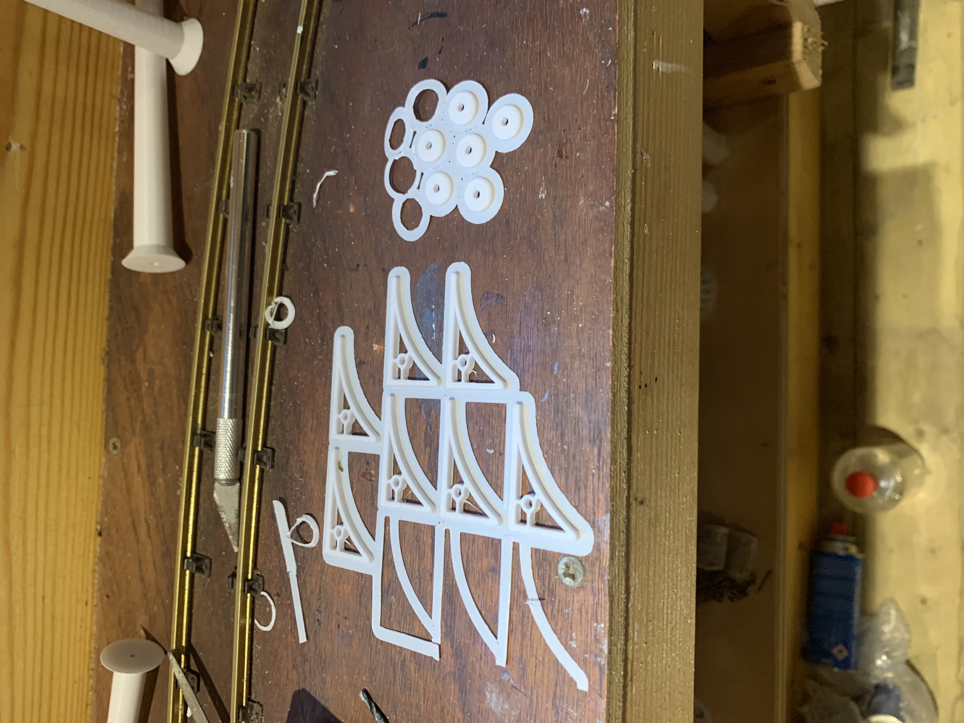

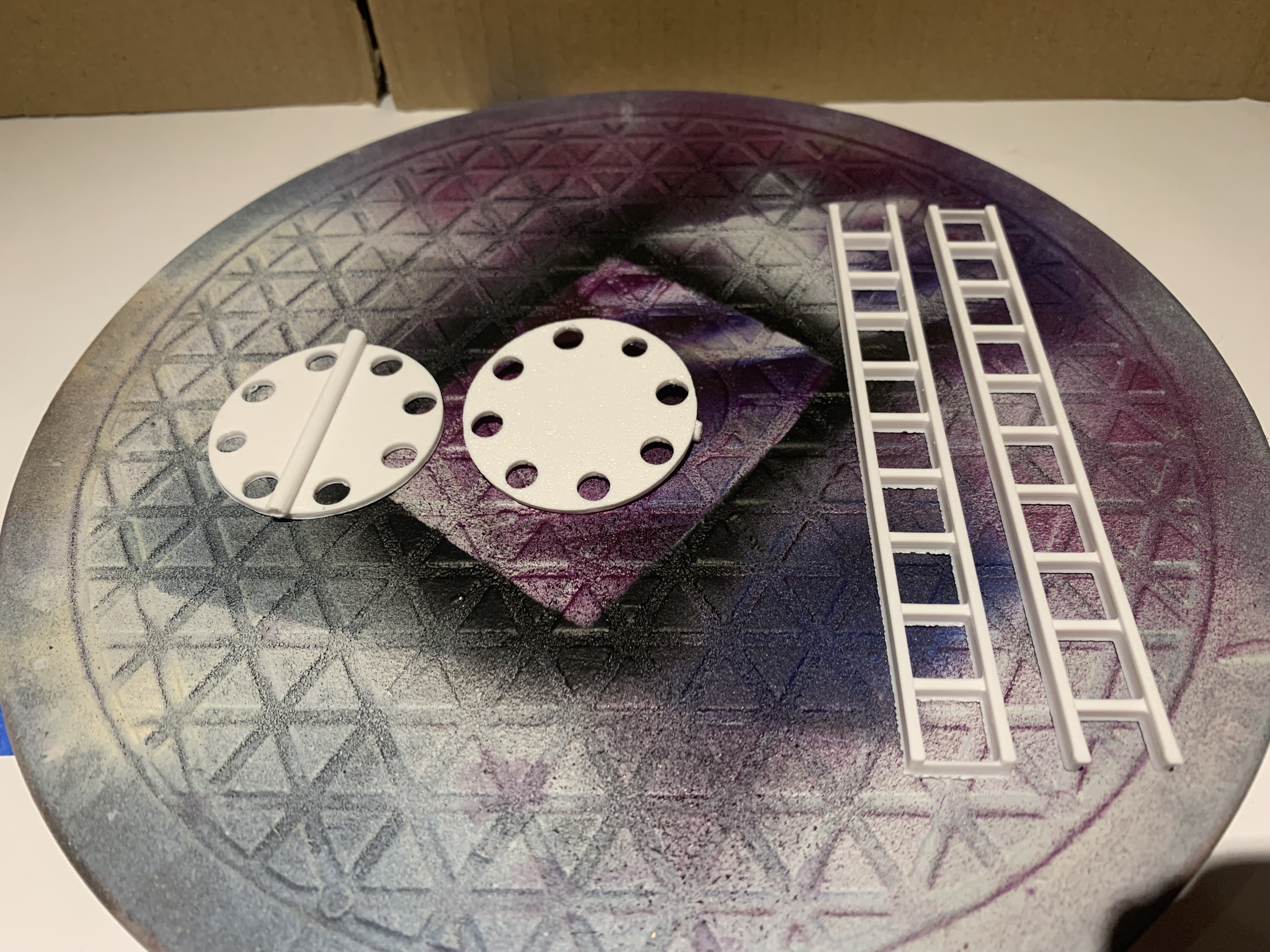

I have fine tuned the design and I am now printing 10 sets of components.
The ladders and the discs are printed:
More as it progresses.

That all looks pretty good Trevor, although it looks as though you'll have a lot of elephants feet to clean off the ladders?

The elephants feet look much worse in the photo than they really are. They are only 1 layer of filament deep, and were swiftly removed with a needle file. The glue us something which came with the printer, here is a photo of it:philipy wrote: Fri Nov 15, 2024 12:45 pm That all looks pretty good Trevor, although it looks as though you'll have a lot of elephants feet to clean off the ladders?

I mentioned earlier that I was able to print without a brim or raft - but I have found the limitations on that statement. Small items which have a small area on the bed need a brim or they just fall off:
This brim is very thin and I have been able to cut the parts out with a scalpel.

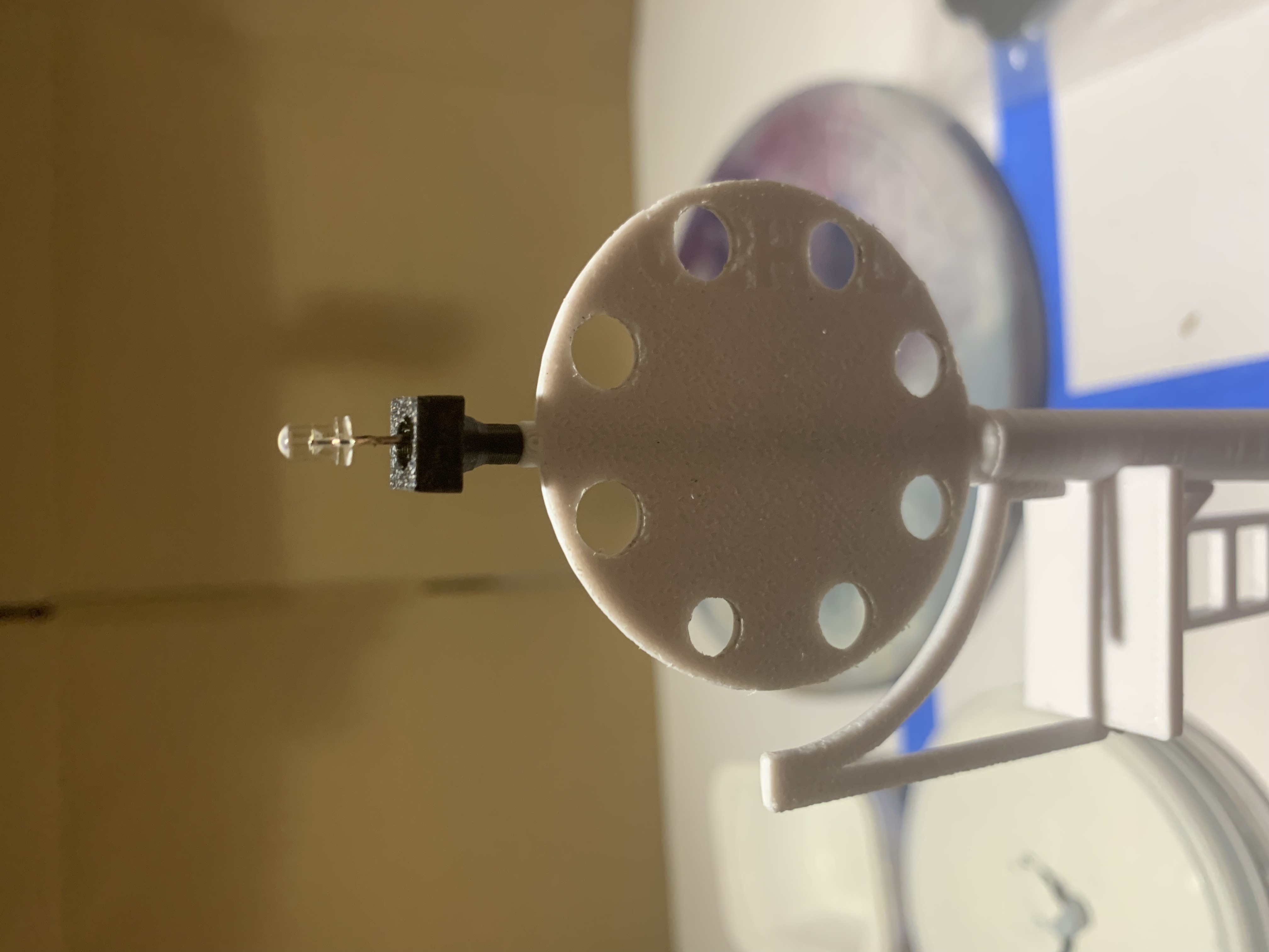

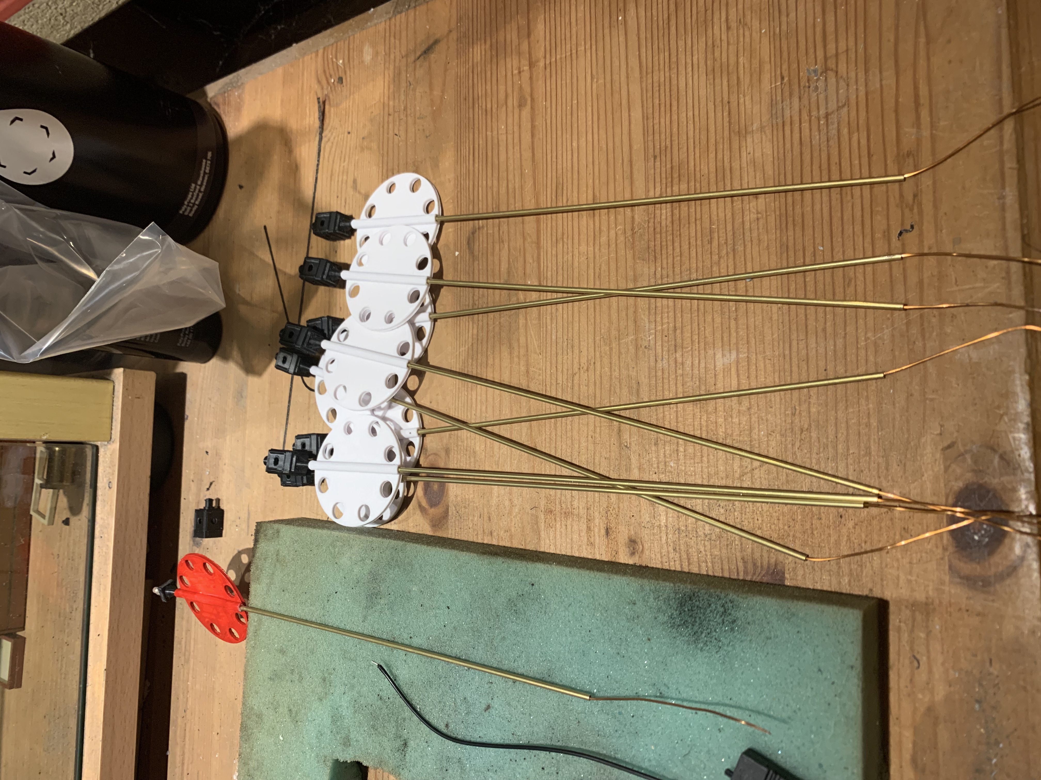

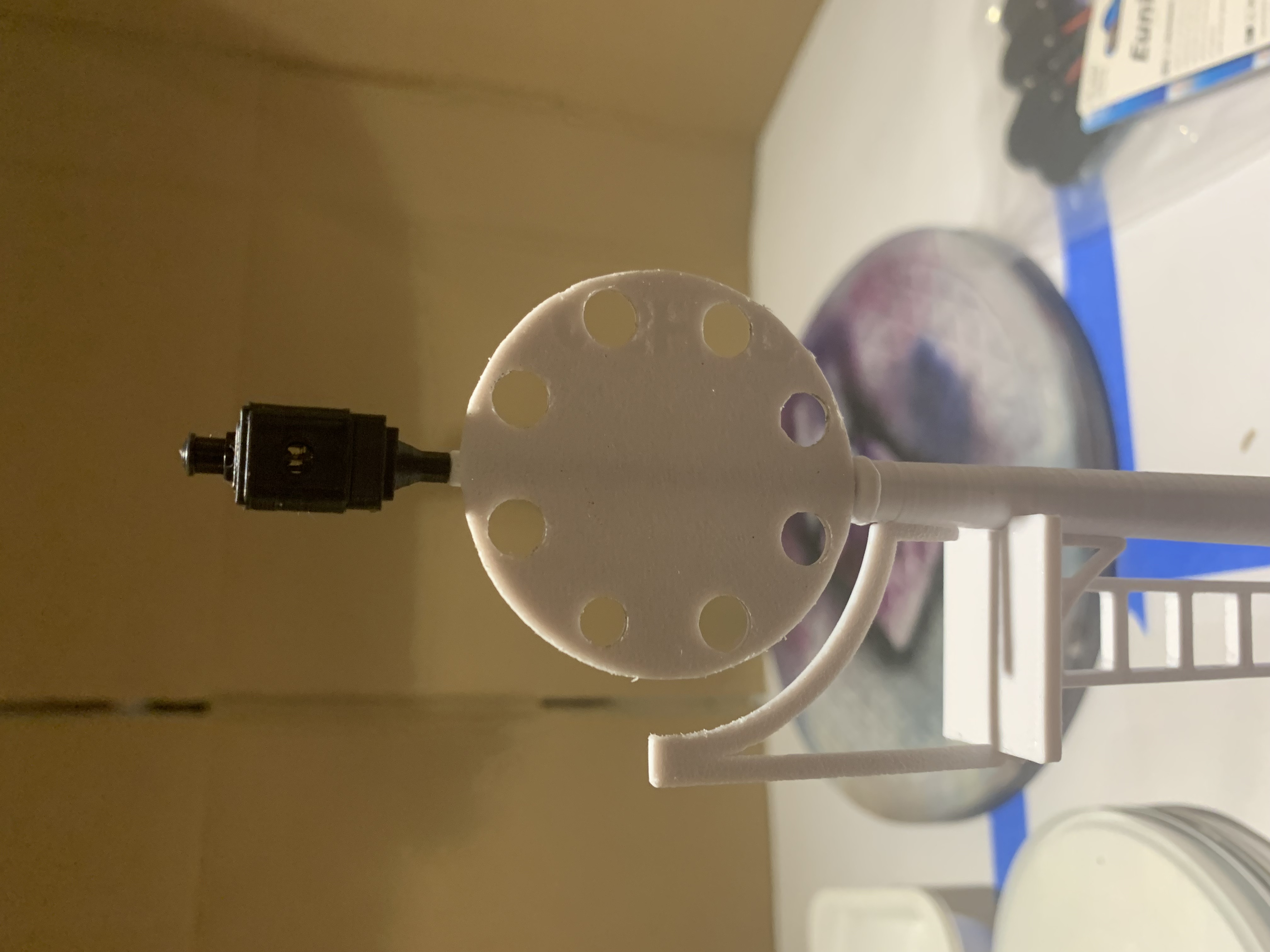

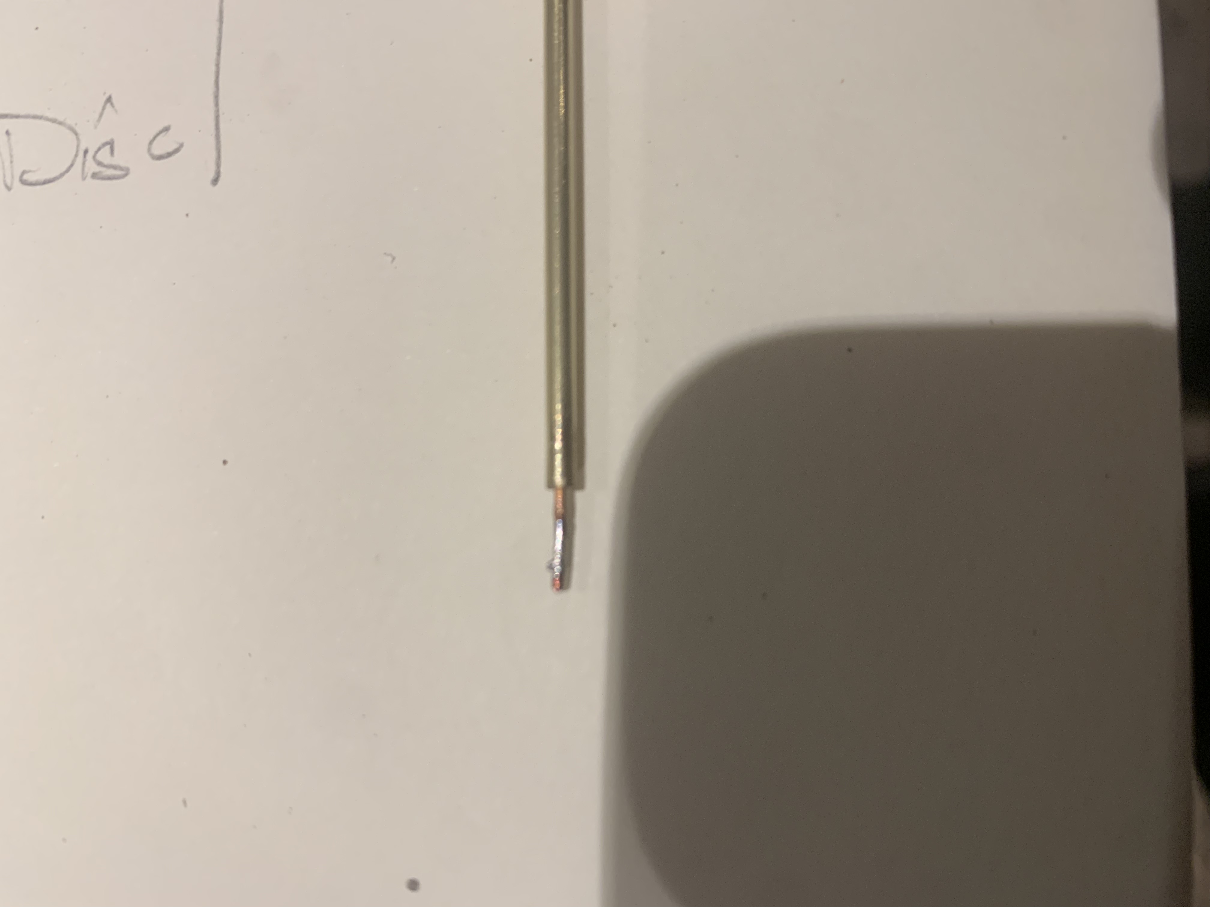

The brass tubes have arrived and I have fitted one into a signal.
I have some enameled copper wire left over from rewinding a coil, which was the right size to pass through the tube. With the tube cut to the correct length and the ends de-burred, the wire passed through and the end if cleaned and tinned:
The LED has been soldered to the copper and the brass tube. The black collar which forms the base of the lamp fits up from the bottom (it won't fit over the LED, or its leads) followed by the disc. Installed in the signal:
The lamp itself is a firm push fit over the base already fitted to the tube. It is removable, as I will need to add red acetate to two of the windows in the lamp before pushing the lamp onto its base fully.
Perhaps I should add that the lamps and bases were all filament printed. I think they are good enough not to bother printing them in resin:
I am about to print bevel gears one of which will go on the bottom of the brass tube, and the other on the servo when it arrives. Then I can connect the resistor and the battery. I should add that I have tested for continuity, insulation, and that the LED works!

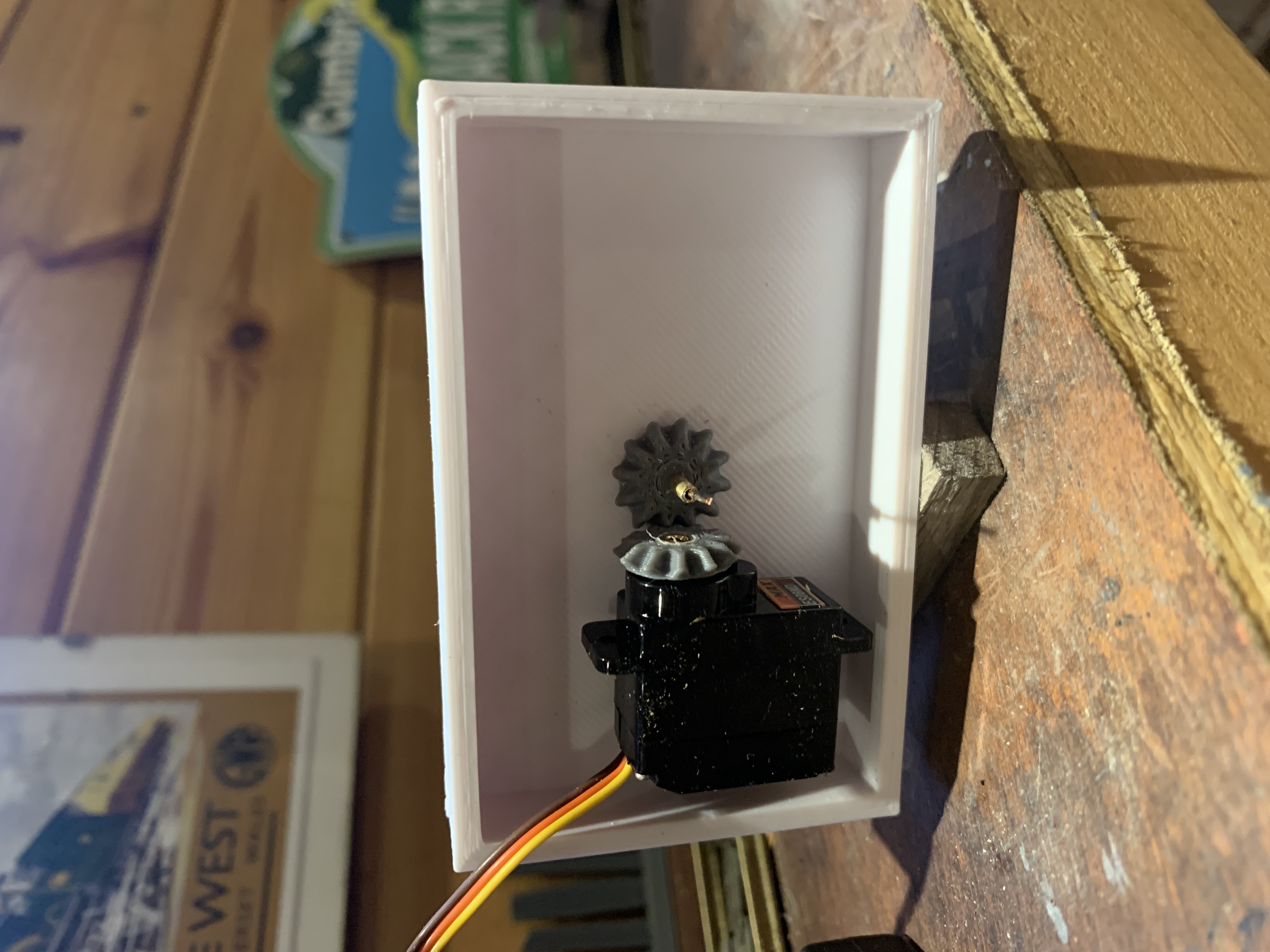

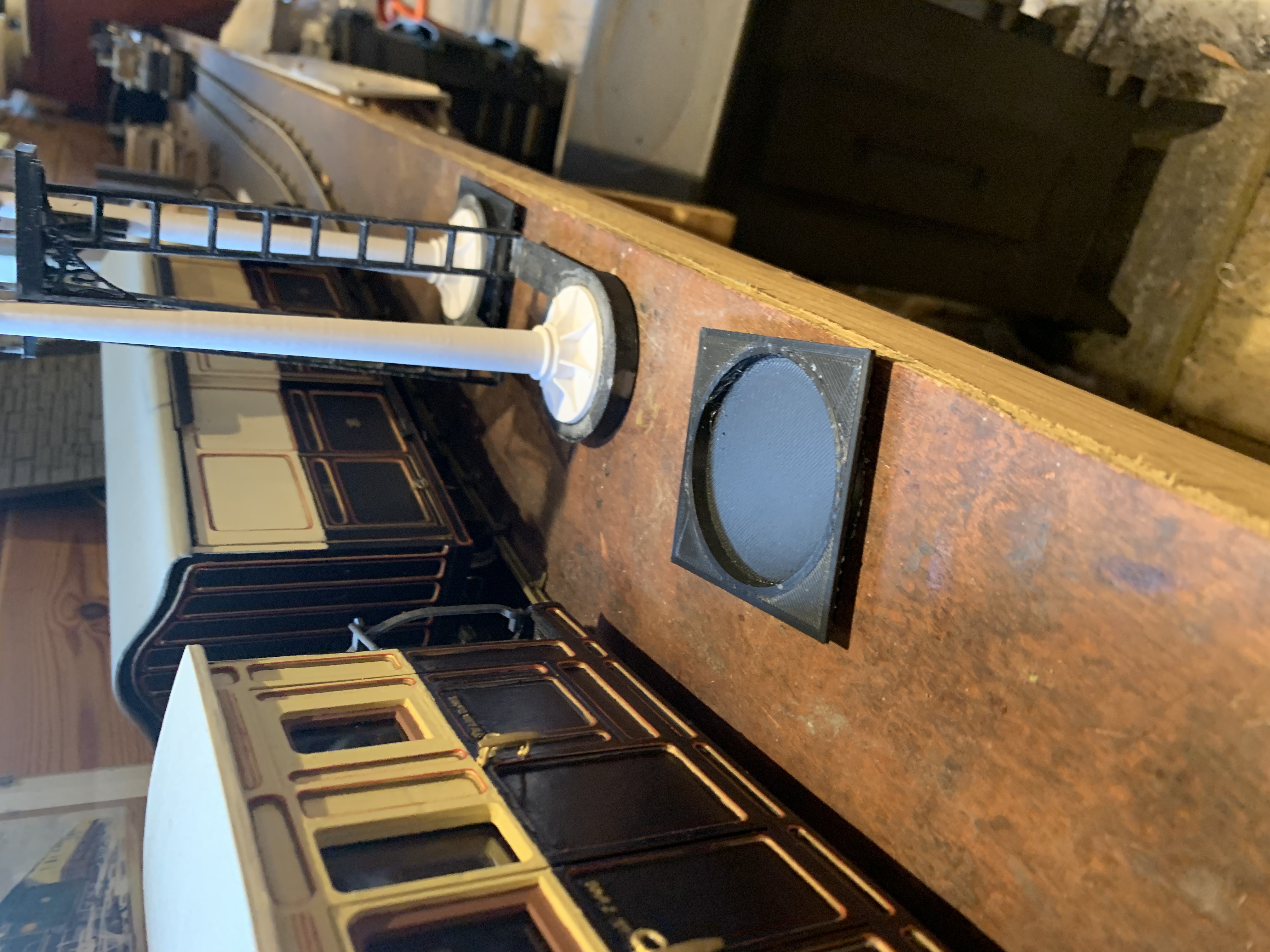

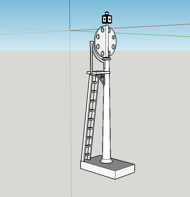

Underneath the signal I intend to mount a servo, so I created a sketchup drawing of a course ( as in big teeth) bevel gear which I hoped would work as a printed gear. It printed on the filament printer well:
I have temporarily connected a servo to the base with black tack, and wired up the light: I won't share the video of it, but it rotates through the required 90 degrees, and the gear meshes quite well. The one thing I learnt was that the wires connecting the battery to the shaft and enamelled wire were resisting its turning. But the light did work, and when the coloured acetate is fitted it will change colour, from white to red . So that requires a different solution. I could mount the battery wires on a printed block to press the bare ends onto the enamelled wire and brass tube - like the slip ring in an electric motor Or perhaps coiling the wires like springs might work. To be tried.

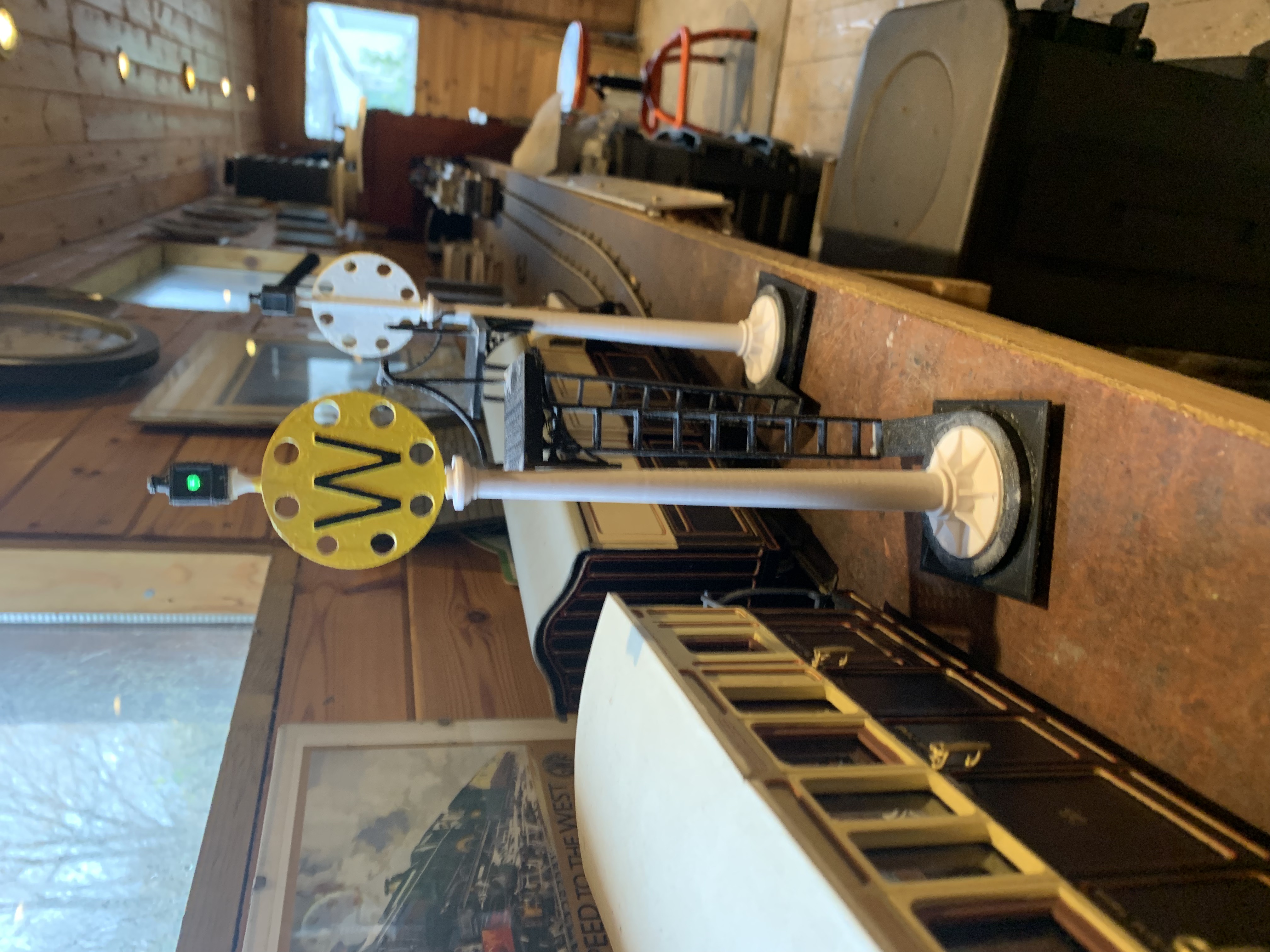

I now have the remaining 9 discs, LEDs and shafts assembled:
8 of them work and one does not light. So something to be repaired tomorrow - probably damaged the LED while soldering it.

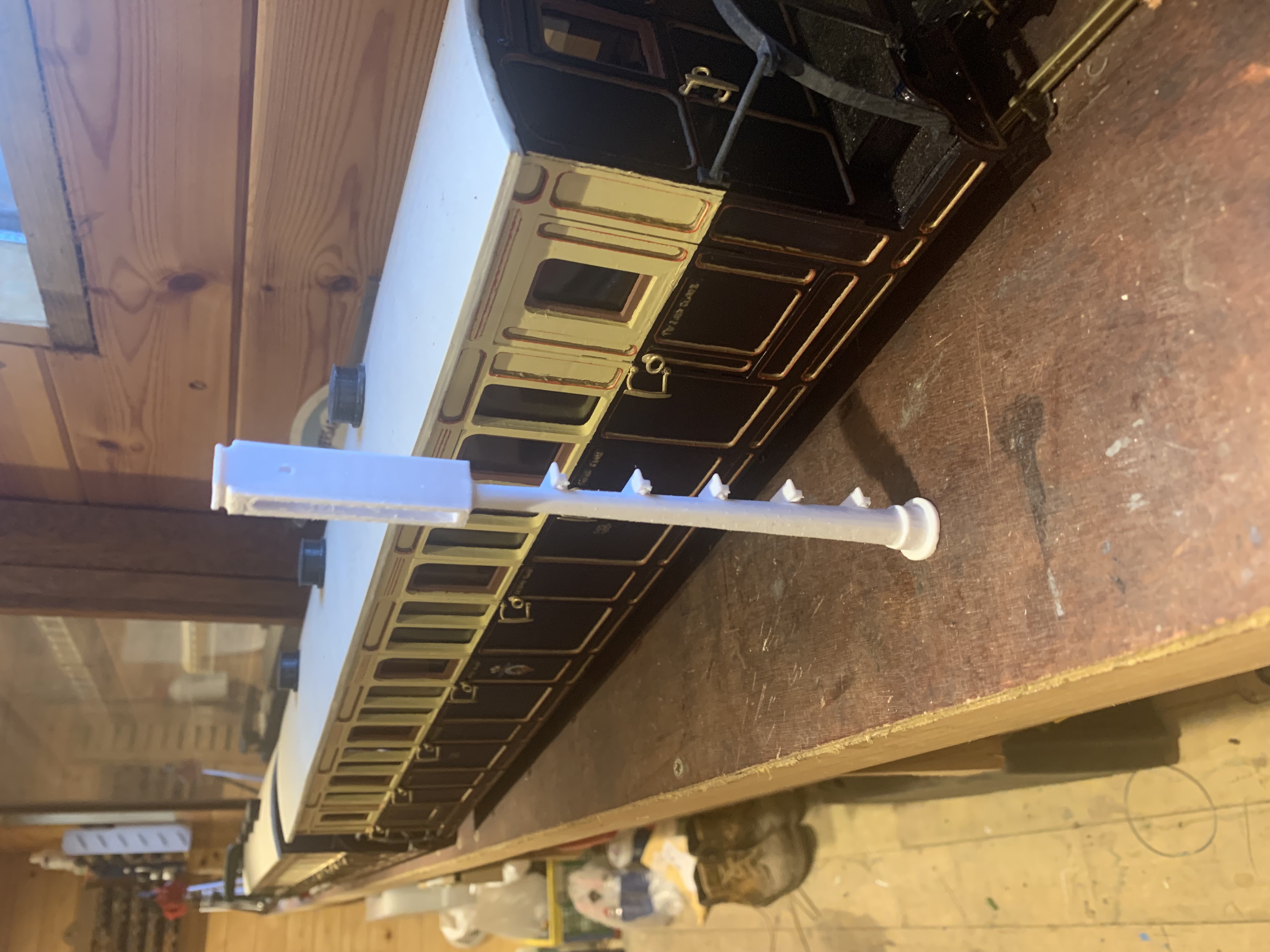

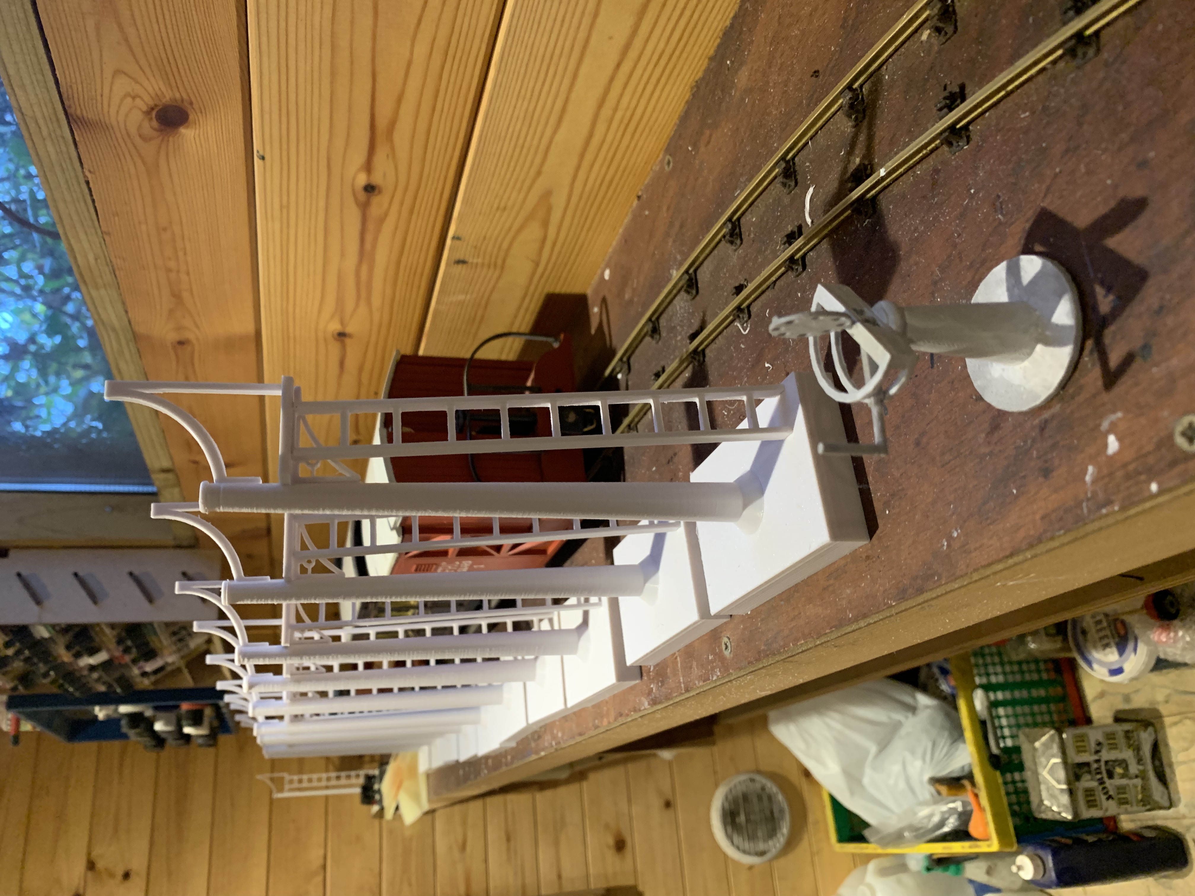

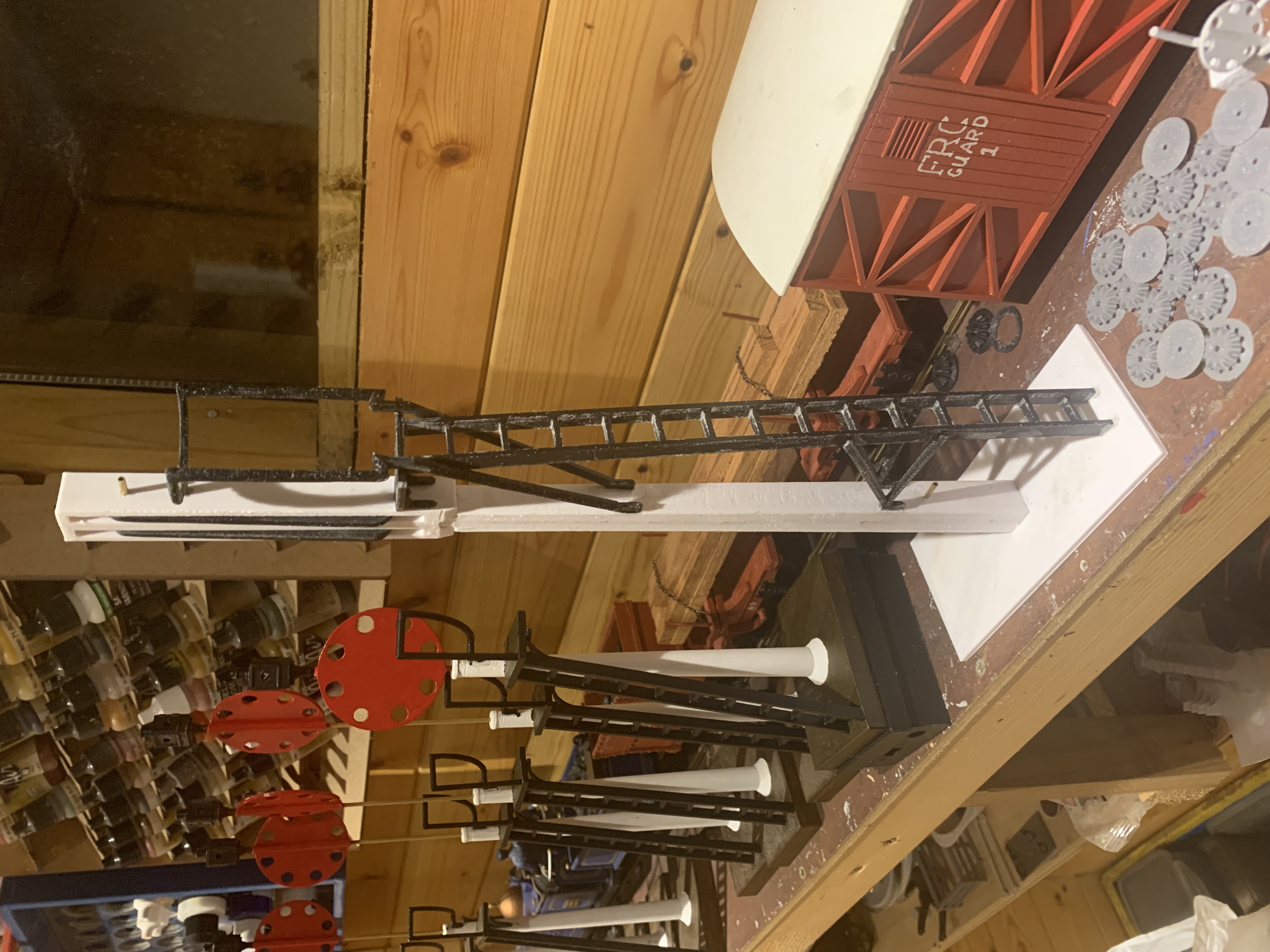

The disc signals are progressing.They are all painted and I have started to assemble the electronics. More on that when the first one is working.
I have moved on to producing the semaphore signal. The final design:
and the prototype so far:
The 10 disc signals are lined up behind it as well. These signals are 3 aspect (all right, caution, danger). One semaphore for each direction. The lights were white, green and red, denoting the meanings above (and in the same order). I initially planed to make these as just something to grace the line side, but I want to be able to control them remotely in due course. Thinking ahead I should work out how to implement those three colours. I have found tri-colour LEDs, Red green and a third colour by turning on both red and green. I wonder what colour that would be! So I think a test purchase is in order. I can see how that might work - with 2 tri-colour LEDs in the lamp one lighting in each direction and following the semaphore indication. Just more complex programming.

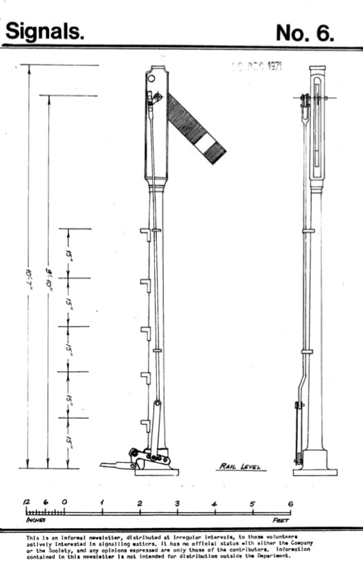

Of course all of this has caused me to investigate the "Old company signalling" in more detail. Boyde mentions point indicators. So searching on Festipedia I came across a drawing of such a point indicator - and photos as well:
So I couldn't help drawing it. Here is my prototype - as far as I have taken the design so far:
So you can see that it is a fairly big item, and I have never seen it modelled. I initially thought it should be something else to grace the line side - but actually it might not be hard to make it actually work. The semaphore arm is hidden within the body, hanging down for straight on and at 45 degrees if the point is set to diverge - in the direction it is set for. My points all have a 1mm diameter rod operating the blades. I drill a hole through the main rails and the blades so that this rod can pass right through, at a level below where the wheel flanges will pass. The rod is soft soldered to each blade. So at worst I would need to replace that rod with a longer rod the extension of which could operate the indicator.
It is just an ornament - but it would be interesting if it actually showed what it was meant to show!
