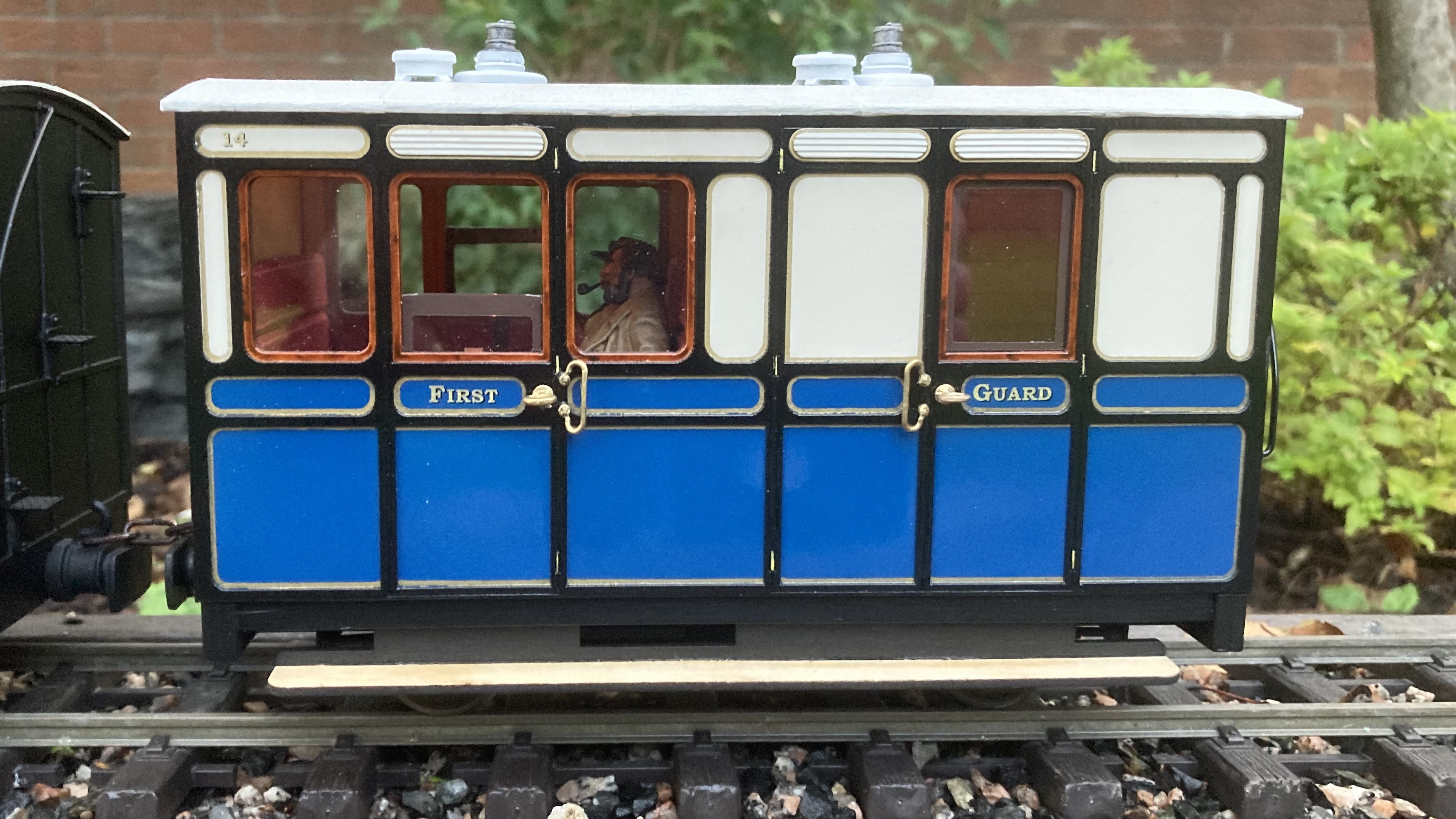

Some photos of my recently completed Brandbright premier panelled coaches. The livery copies early GWR coach livery with brown swapped for blue. The gold lining was added with a Uni paint marker, using the overlay as a template temporarily held in place, before finally attaching with Deluxe Materials Glue n Glaze and spayed over with a gloss lacquer. Interior lighting from 12v grain of wheat bulbs powered by a 9v battery to give a soft orangey glow. Passengers are 3d prints (files acquired from here https://cults3d.com/en/3d-model/art/retro-people) and painted using Citadel contrast paints. The door vents are also 3d prints to my own design. Droplight frames are cut from vinyl as I thought the wood frames in the kit looked a little too heavy. These are excellent kits and, with a bit of time and effort, make into very attractive models.

The finish is four or five coats of shellac sanding sealer, applied with a rag and lightly smoothed with fine wire wool between coats. I then primed with Citadel white acrylic spray primer, followed by cream (Wratihbone) and blue (Army painter Deep Blue). After sticking on the framework overlay which had been sprayed in Citadel Black, the whole body was given two coats of Wheel Lacquer. I find the Citadel sprays give a consistently smooth finish and dry really quickly, within a few minutes. The wheel lacquer is best I have found from a spray can to avoid orange peel effect.

I forgot to mention, the varnished wood window frames were painted over the cream using Citadel contrast paints in a colour called Gore-grunts Fur. These paints are deliberately semi translucent so leave brush marks that can replicate wood grain.
