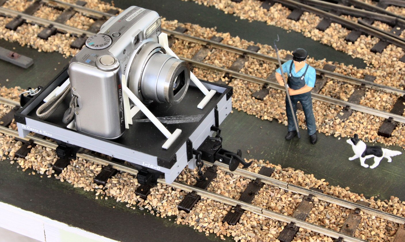

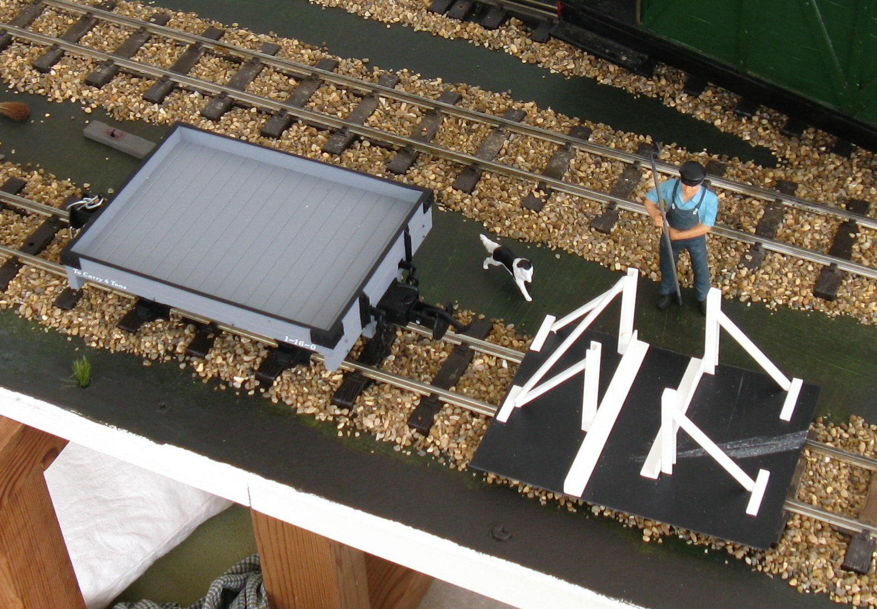

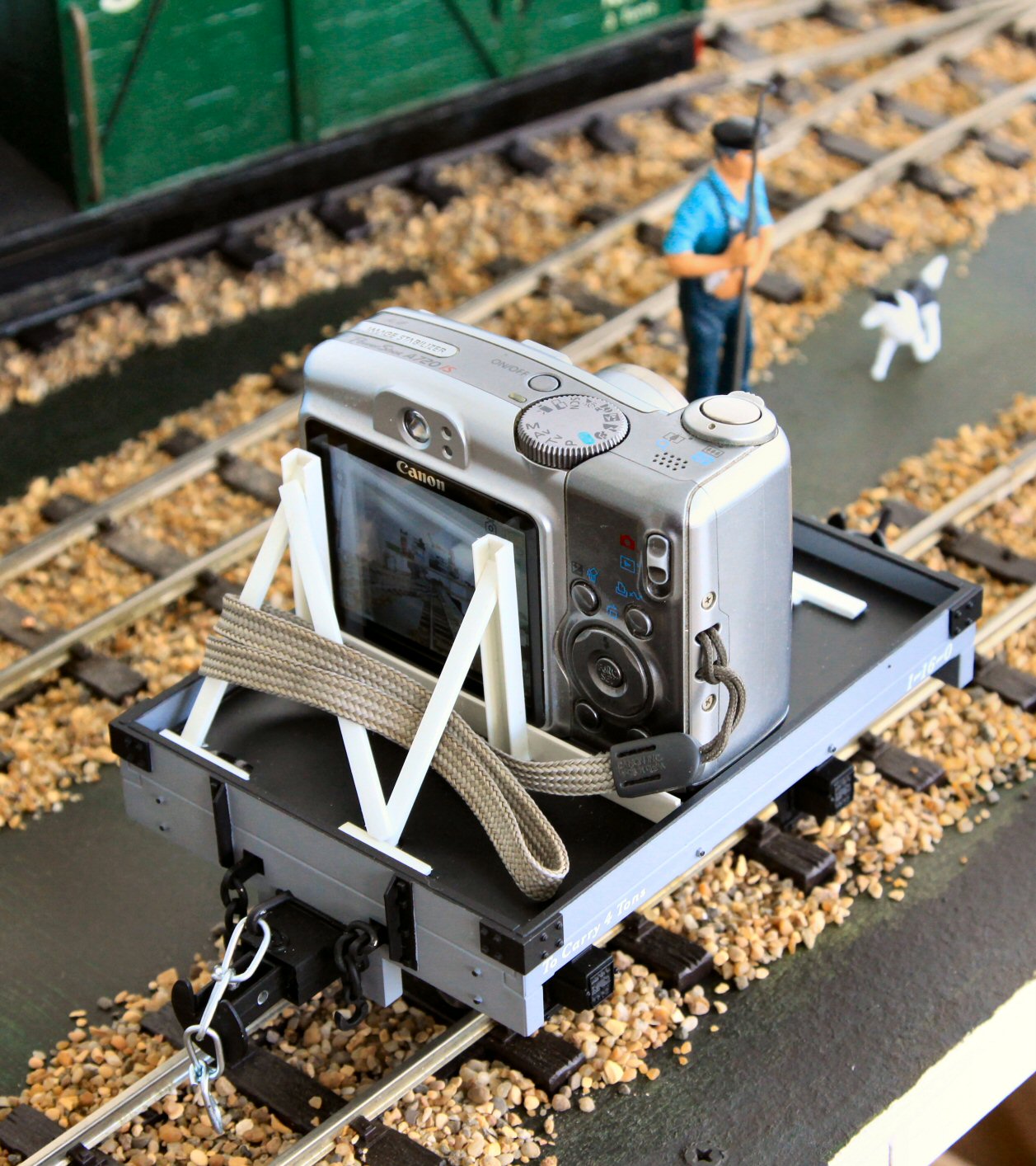

At the moment, time (and tide) is against me getting on with the bigger projects. Instead, I have to snatch an hour or two here and there when I can. I've been to some of the local area group meets and there's been talk of filming some of the lines and doing pieces on specific issues for YouTube and when the publicity stand goes to exhibitions. Which got me thinking about some of the publicity work I used to do and the scope for suitable clips.
I don't have a camcorder, just a compact digital camera, with a video option. This is around 20 years old and is starting to slow down a bit now. But I've had some good results from it an thought I'd try a little experiment. As well as shooting the odd clip of trains passing, I thought a driver's eye view could be interesting. So I took the 'honey wagon' one plank used in the last quarter's gallery entry and removed the timber insert. With care, the compact camera will fit on this. For obvious reasons, I had to build a cradle for it to sit in - this time, I used some spare plastic sheet and Plaststruct as an insert.
The cradle is rather basic and crude but holds the camera securely in place. I tried it on my shunting puzzle layout and then on a neighbour's line at his next steam up. The footage came out well, it shows the camera's age but was well received by the others attending. Our 'official' group cameraman has used the idea since with better and more modern equipment and is threatening to show some at the Exeter show next month.
Best not ask how 'Bill' got the wagon load out of the wagon ;) - and I think 'Ben' is going to start barking at it any moment now... :scratch:

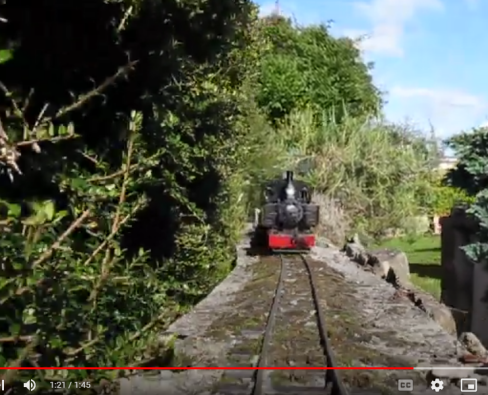

I won't post the You Tube links (yet?) but took a few screengrabs:
I coupled the wagon to a battery 'diesel' loco and ran this as smoothly and steadily as possible round the line. This shot is coming 'off shed'.
And then further round the line.

A very "scale-looking" camera mount there. Bit of paint and weathering, and it wouldn't look out of place on a railway if left on the wagon. You could even make a lift-off "crate" to cover the camera - with the lens peeking out of course. 8)
See if people spot the hidden camera. :lol: 8)

I do like the ground level shots with plenty of depth of field, always adds to the realistic effect.

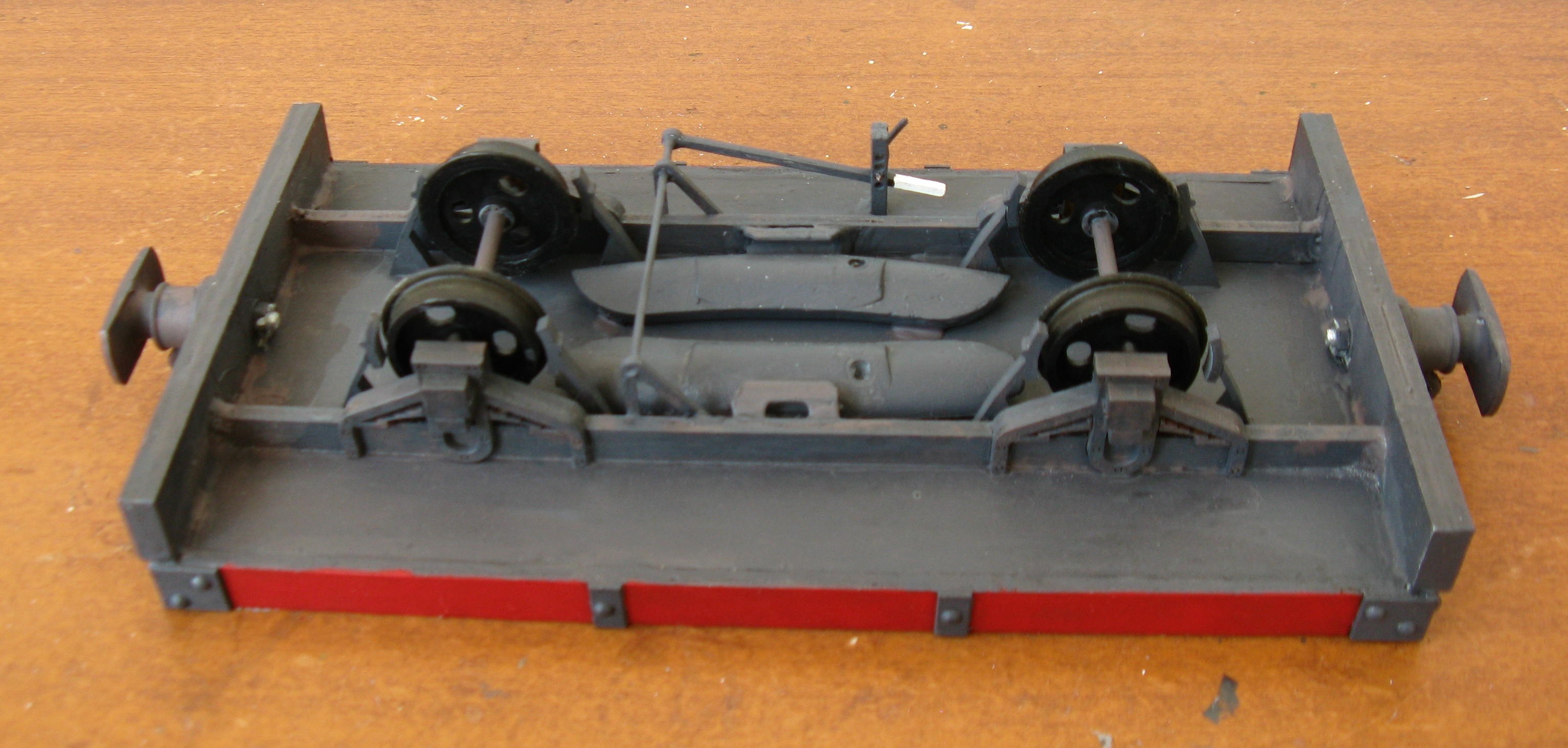

No news on the video clips yet - my IT is definitely having a moody and I'm lacking the patience to coddle/indulge it - but I have been able to do some lower tech work. Earlier today I [finally] finished my first SM32 wagon kit. The Plateway one plank kit.
I did add some refinements to the basic kit, the lettering is also from Plateway - I thought I'd try some of their letters both as an [embossed] decoration and as a paint stamp. 'Vulcan Works' was chosen as it sounded like a suitable name for a light engineering company and avoided repetition of letters - Plateway's alphabet doesn't (yet? - pretty please...) have multiples of the most commonly used letters). The rivets are from BA Bolts (1/16 x 3/16 stainless steel) as I wanted to model the heads and couldn't find any nail art or 3D printed heads as suggested by members here. (I have since had some 3D rivet heads printed for me by a fellow local group member which I will try next time). The wagon was very light as supplied, so I added a couple of weights (car tyre balances) which make it much more sure 'footed' on the rails, without them the wagon derailed frequently.
I haven't quite finished with the wagon - I will replace the supplied brake lever peg with something more realistic when I find it - I know what I want, it's something from my 4mm modelling - but finding it... after a house move.... may take 'some' time! I will probably apply another weathering wash to the decking and add some sort of load. But for the moment, time to pass this one out.
