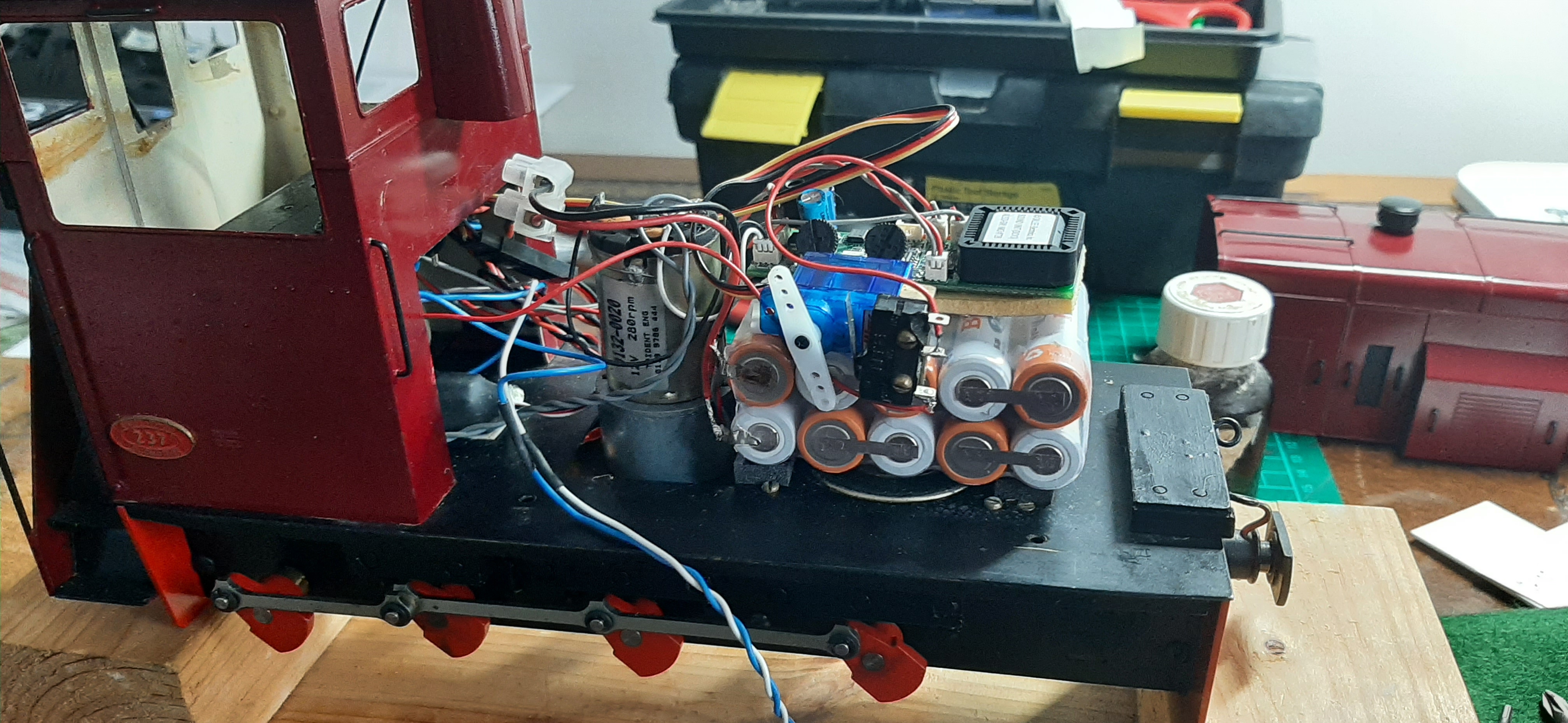

I took most of the body off ,well the bonnet so far to reveal lots of gubbins. See image .What do you all think the servo motor is for ?
Re: Essel Chattendon body removal
Posted: Tue Jul 09, 2024 10:44 am
by Phil.P
The servo operates the micro switch next to it..
I would guess a crude way of triggering the horn, perhaps?

Phil's suggestion looks quite likely. Easiest way to test is switch it on and manually operate the micro switch to see what happens.

Phil.P wrote: Tue Jul 09, 2024 10:44 am The servo operates the micro switch next to it..
Top marks Phil .
I took it apart yesterday and was surprised to find the horn was operated by a servo motor pushing the not so micro switch . A very Heath Robinson approach. I was wondering why the horn was not that responsive the servo is more suited for a slowmo point switch ! there are a lot of bare wires to be sorted out . the sound chip/card is quite rudimentary. though the speaker is quite large ( 6cm diameter ) I wasn't sure what to expect when I removed the bonnet . The cab is more reluctant to come apart . It looks like I will have to remove the rear buffer beam to get more access. All this just to get at the two nuts that secure the steps. Oh well the joys of buying a S/H loco . on the positive side the mechanics are fine and it runs very well .

Finally managed to dismantle the cab from the chassis. It was a matter of getting the right tools for the job and removing the rear buffer to get access to the one bolt that held the cab in place. One issue I noticed was the receiver antenna. Shouldn't the insulation on the black wire cover its whole length ,as is there's approx 3cm of bare wire showing .
Posted: Sat Jul 13, 2024 7:20 pm
by Phil.P
Preseli Chris wrote: Sat Jul 13, 2024 7:08 pm One issue I noticed was the receiver antenna. Shouldn't the insulation on the black wire cover its whole length ,as is there's approx 3cm of bare wire showing .
No..
The black 'wire' will be a coaxial cable. - Think like on a TV aerial.
The 'expised' bit, is the inner core (and its insulation) . - The outer black insulation, and the braided screen, have been stripped off.
