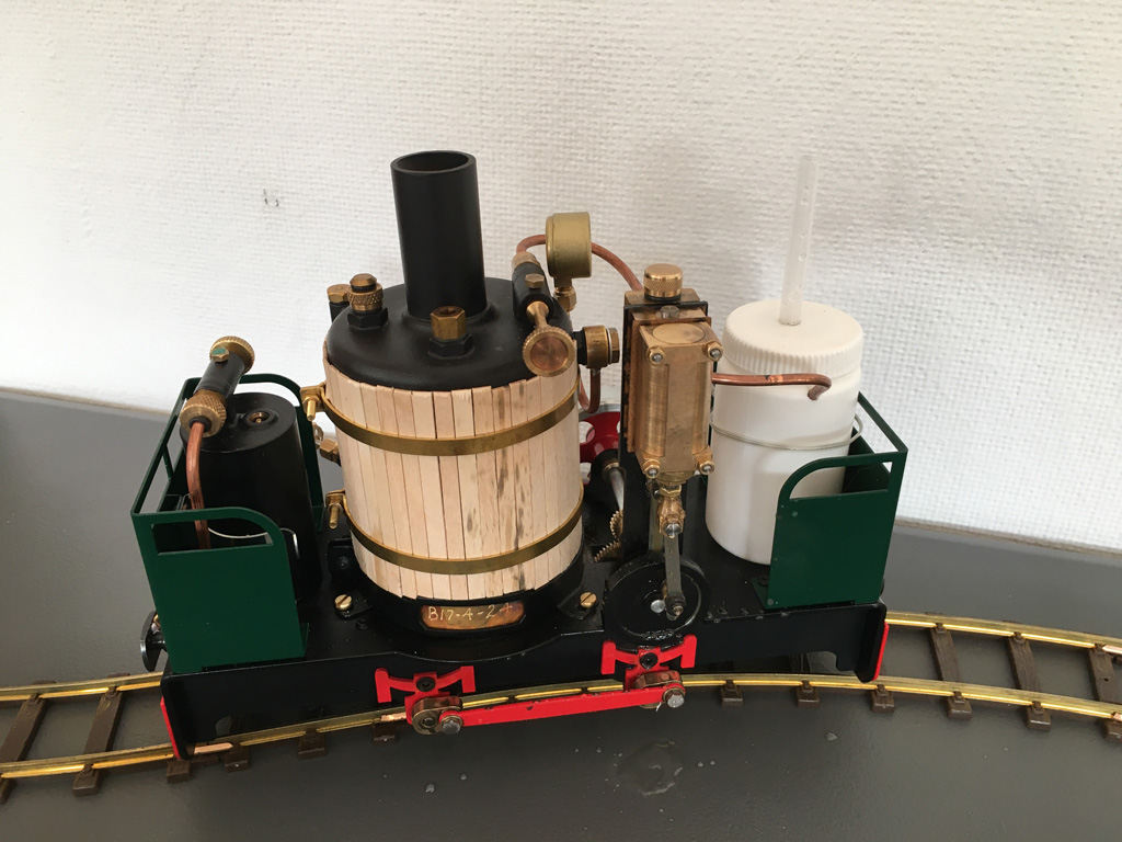

I have got one of these chunky beasts.
Guess it takes some time to get used to it.
And some modifications are needed.
Looks like the exhaust outlet has threads.
What kind of threads?

To do test runs indoor I made a condenser. The copper pipe used is 3 mm, just screwed in.

Being used to noisy burners, it took some time to figure out that the ceramic burner is totally silent. Only a very small turn of the gas valve is needed. The burner starts with a blue flame and then turn into glowing red.
Don't look down the chimney! :shock:
I don't see any reason to lift the boiler from the footplate with washers. Maybe Mamod has made the holes in the frame larger?
The cylinder was leaking and left a lot of water and oil along the track, so I replaced the o-ring on the piston rod inside the cylinder with teflon string. Now it runs much better and without leaking.
