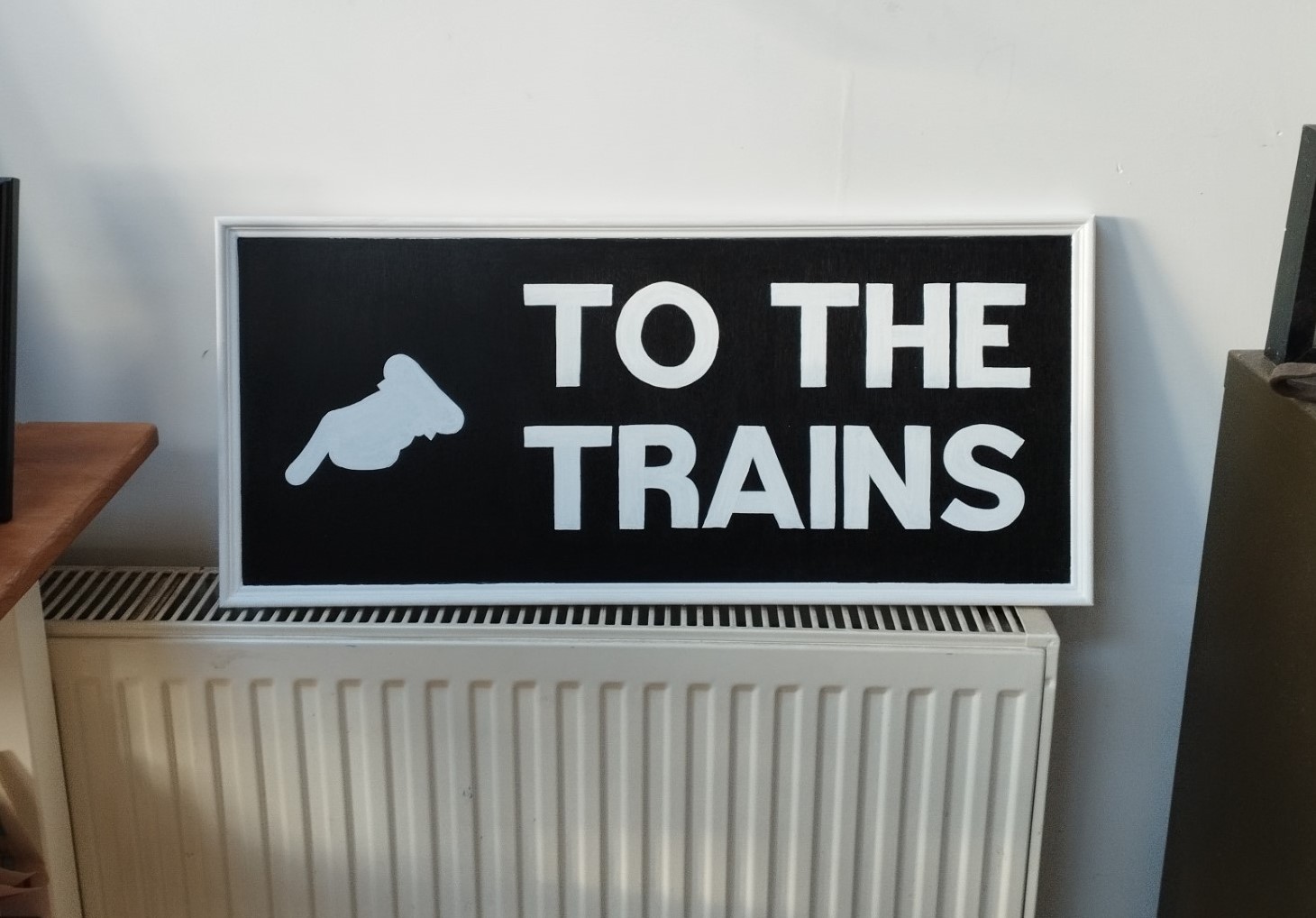

Hi all,
Last November, I went on Joby Carter's excellent week-long signwriting course and, since then, I've knocked up a handful of signs, with more on the way. Naturally, some have a railway theme - here's my latest example:
To the trains sign.jpg (217.94 KiB) Viewed 136041 times
It's a tricky art to master, and with a san-serif font and no shading etc, there's nowhere for mistakes to hide! Nonetheless, I'm pleased with how it turned out...
I plan to put it up outside, and wonder whether anyone could off any advice on varnish? There seem to be two, opposing, schools of thought - either that varnish helps protect the sign, or that it doesn't, because the weather gets underneath and causes it to deteriorate faster. Any thoughts?
The sign is made of exterior ply and softwood mouldings, treated with Cuprinol wood preserver, and painted with stuff intended for garden use.
I think I might try and do some fancy carriage style lettering next, maybe "FIRST CLASS", although double letters are a challenge, because it's glaringly obvious when they're different, and it's really hard to get "S"s to come out the same!
Re: It's a Sign!
Posted: Thu Apr 18, 2024 12:11 pm
by -steves-
That's really good, sign writing has always been a skill I have envied, simply because it's something that I have tried and just can not do, well done :salute:
Re: It's a Sign!
Posted: Thu Apr 18, 2024 12:31 pm
That looks excellent, Andrew.
I'll have a word with my signwriter mate in the village to find out how he protects his handiwork.
PS Particular congratulations on the S. I'll bet that letter can be a signwriter's nemesis
Re: It's a Sign!
Posted: Thu Apr 18, 2024 12:42 pm
by Andrew
-steves- wrote: Thu Apr 18, 2024 12:11 pm That's really good, sign writing has always been a skill I have envied, simply because it's something that I have tried and just can not do, well done :salute:
Thanks Steve! A week of intensive expert tuition definitely helps!
Re: It's a Sign!
Posted: Thu Apr 18, 2024 12:46 pm
by Andrew
ge_rik wrote: Thu Apr 18, 2024 12:31 pm That looks excellent, Andrew.
Thanks Rik! And yes, I'd really appreciate it it if you could ask your friend, thank you!
"S"s are hard to draw - and I am drawing the letters out by hand at the moment as practice, although I could "cheat" and print them on a computer. Joby's "Old School" - he doesn't allow the use of masking tape either! I find curvy letters easier to paint than straight ones - you can kind of just let the brush do the work, whereas following a straight line accurately is harder, and the results less forgiving...

Re: It's a Sign!
Posted: Sat Apr 20, 2024 9:26 am
Andrew wrote: Thu Apr 18, 2024 12:46 pm I'd really appreciate it if you could ask your friend, thank you!
Hi Andrew
Sorry about the delay, but I've not seen him recently and it seems he doesn't check his emails regularly.
His reply ......
Hi Rik if he has used good enamel paint it does not need Varnish , the Varnish becomes Brittle after so long and starts to come off
He has made a brilliant job of it. Peter
Peter was a professional signwriter (and artist) and quite of few of the shop signs in the neighbourhood are his handiwork. They've been there for years so he presumably knows what he's talking about.
Re: It's a Sign!
Posted: Sun Apr 21, 2024 1:54 pm
by Andrew
Brilliant, thanks Rik!
Not having a separate workshop, I can't use enamel paints, on account of the need to avoid filling the house with white spirit fumes. I'm using "Alphakrylik", a water-based substitute, but it's supposed to have the same qualities as enamel in terms of coverage and durability, so I'm going to go varnish-less and see what happens. The downside of acrylic is that it doesn't replicate the glorious gloss sheen on enamel - which is where varnish could help. Not much of a problem on this utilitarian sign, but it would notice on something flashier...
I'm very grateful for your friend's kind words about my efforts too - that means a lot!

Re: It's a Sign!
Posted: Wed May 15, 2024 8:47 am
by FWLR
Hi Andrew,
When my Dad used to get his wagons sign written the guy used to chalk out the sign first and then use that bit of stick that has a piece of cloth wrapped around it. He had many different sizes of those because some letters were really small, like the bottom of the doors on my Dads cabs which had if my memory serves me right.. :dontknow: was Dad's address.... :scratch:
I have seen other sign writers on the telly doing exactly the same way. Do you do it like that also. :thumbright:
Re: It's a Sign!
Posted: Wed May 15, 2024 11:11 am
by Andrew
FWLR wrote: Wed May 15, 2024 8:47 am Hi Andrew,
Hi Rod,
Yes, that's the technique. You can draw (or print) a design on paper, then transfer across either by charcoaling the back and tracing, or by pricking lots of little holes and dusting chalk through ("pouncing") - with practice, you could chalk the letters on directly, or even paint them straight on with just chalk lines to keep you level. I'm a long way from that! There's a really cool trick where you "snap" a guide line onto your surface, which involves covering string in chalk, holding it really taut just above where you need it, then kind of pinging it against it to leave a line - I've not tried it, but apparently there's quite a knack to it...
The stick's called a mahl stick - if you're right-handed, you hold one end in your left hand, and rest your right on it at the other. It's partly to stop you smudging work youve just done, but sometimes you also move the stick to control the brush, especially on a long contiuous stroke. It takes some getting used to, but I like the technique.
Small letters are really difficult - so hard to get neat corners in particular...

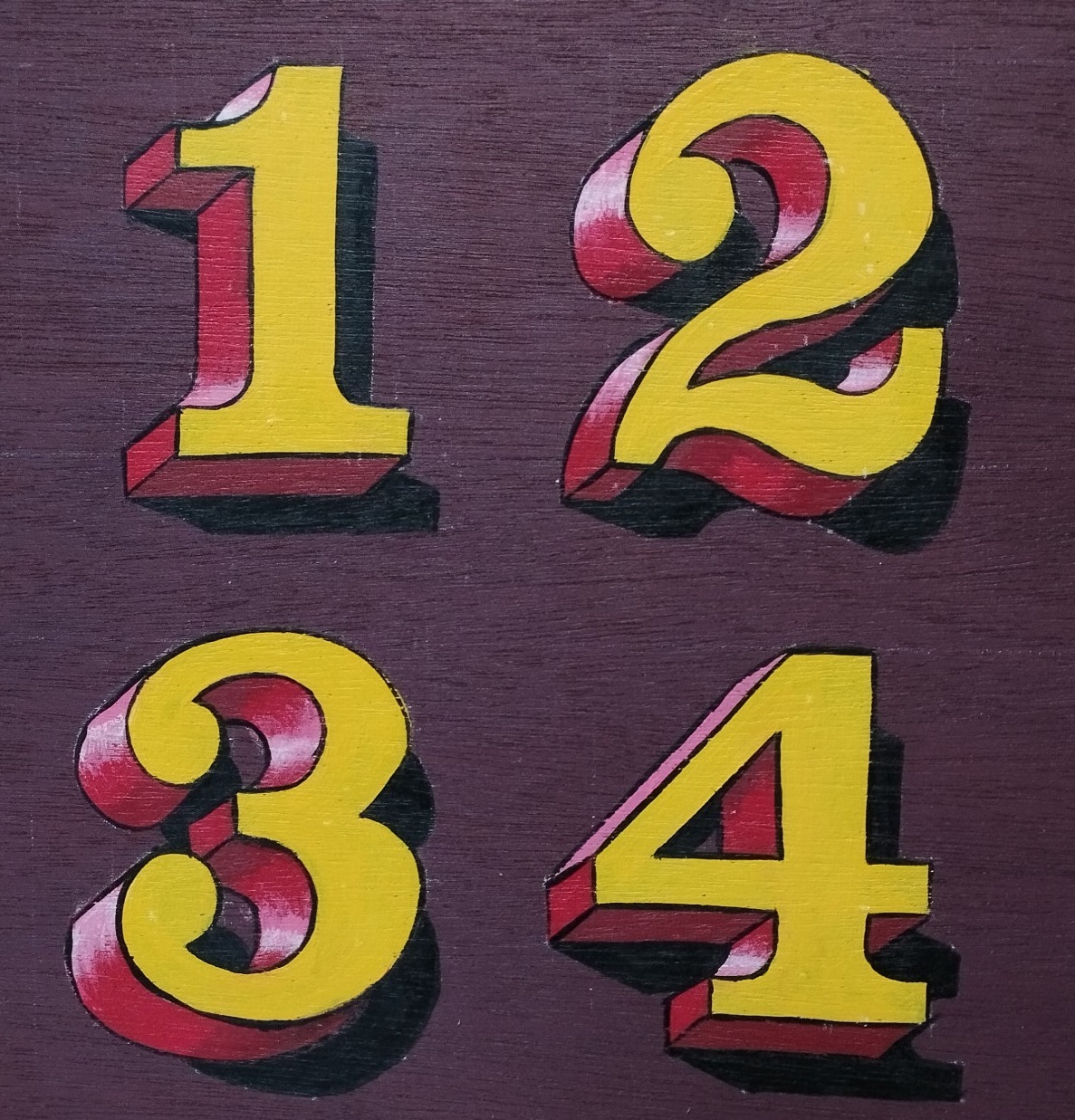

Re: It's a Sign!
Posted: Wed Aug 28, 2024 2:13 pm
by Andrew
Hi all,
I think I mentioned that I fancied painting some more railway-style signs? These are based on carriage and locomotive numbers, and were a test run on some scrap wood, with the idea that I'd use this style for some friend's door numbers. I think they're actually a bit ornate for that, but I might do some bigger ones (say 12", these are about 4"), just for the fun of it. I learned lots from doing these that I can incorporate into future ones.
Hope you like 'em!
