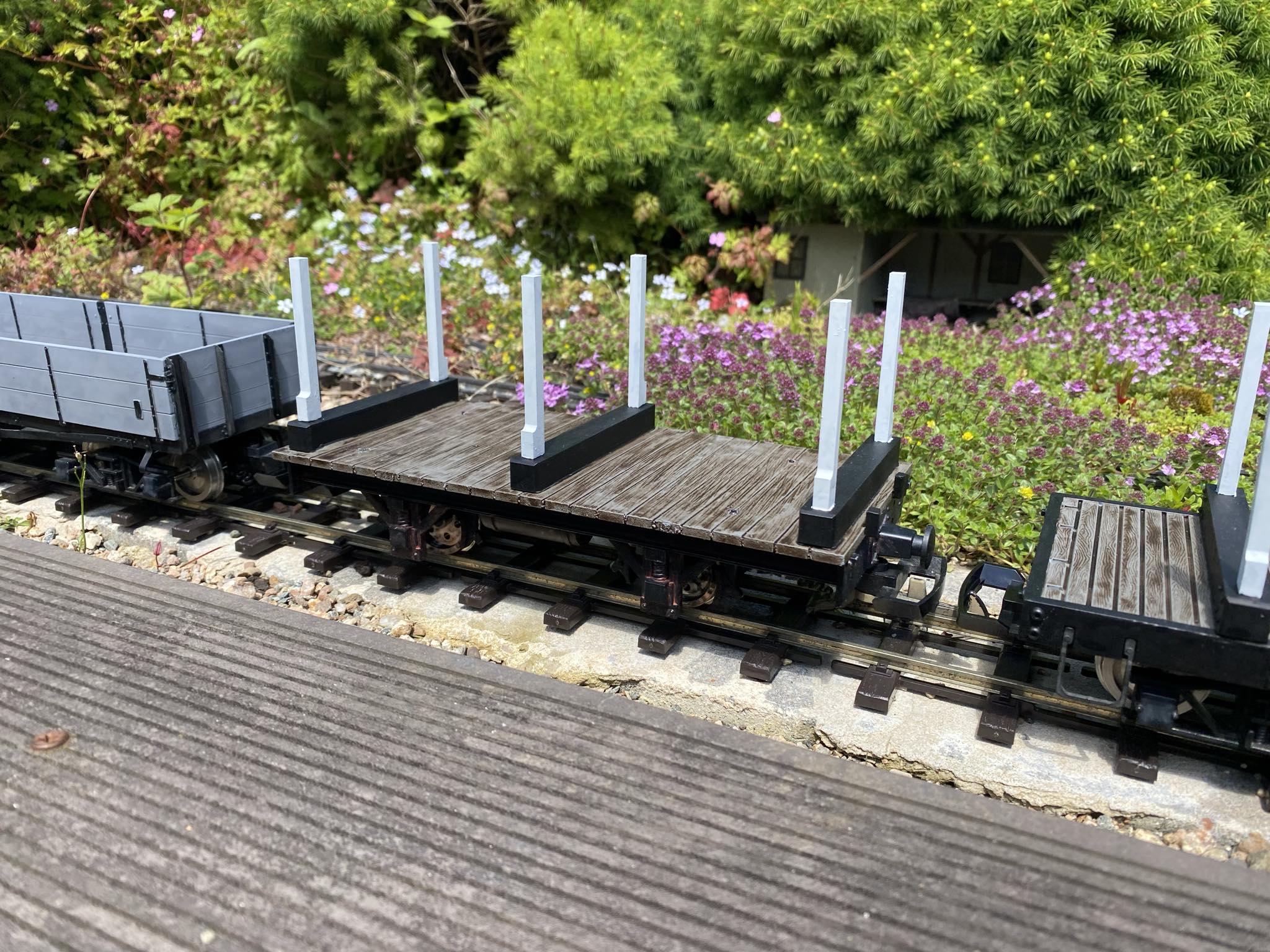

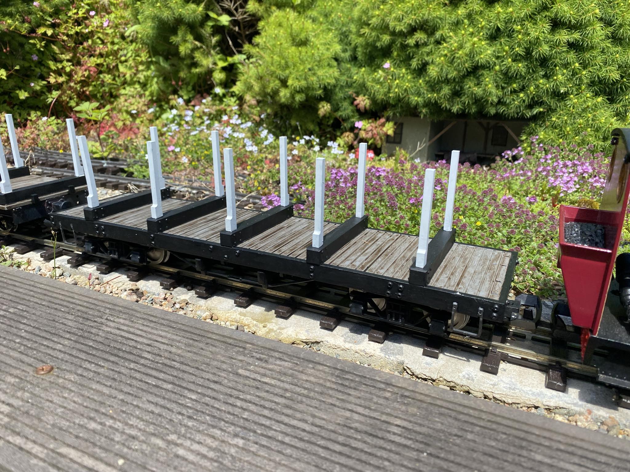

Rolling stock continued:
This is a stake wagon used for transporting logs around my railway. The up-right sections were designed on tinkercad and 3D printed on my resin 3D printer. I based the designs on drawings from my Vale of Rheidol in Detail book which I picked up on my last visit to the VOR. These were used on the bolster wagons at the VOR. The base of the wagon was cut and scribed using a foam board sheet (3mm I believe). Once the 3d printed uprights were attached to the wagon base using two part epoxy and bolts, the wagon was primed with Halfords grey primer. I then picked out the details using games workshop paints and added agrax earthshade wash to the base (I decided not to go over this with a light coat of Halfords grey primer to give a heavily used look). This was again attached to an lgb wagon chassis with accucraft 32mm wheel sets.
This is a bogie stake wagon built using a bachmann g scale bogie flat car. This wagon is based on the proposed designs for a bogie stake wagon for the Vale of Rheidol railway, which is included in my VOR in detail book. I first removed the original stake bracket from the sides of the wagon using an angle grinder before sanding smooth. Small holes were drilled and bolts added using epoxy to add some detail to the sides of the flat bed. The 3d printed uprights were added using epoxy. The wagon body was then primed with Halfords grey car primer and painted using the methods used on the above stake wagon. GRS 32mm wheelsets were again used.
I would really like to build a brake van next. Wether to scratch build with plasticard or buy a kit I am not yet decided. I do really like the reliability of the lgb wagon chassis with the accucraft wheel sets.
Harry

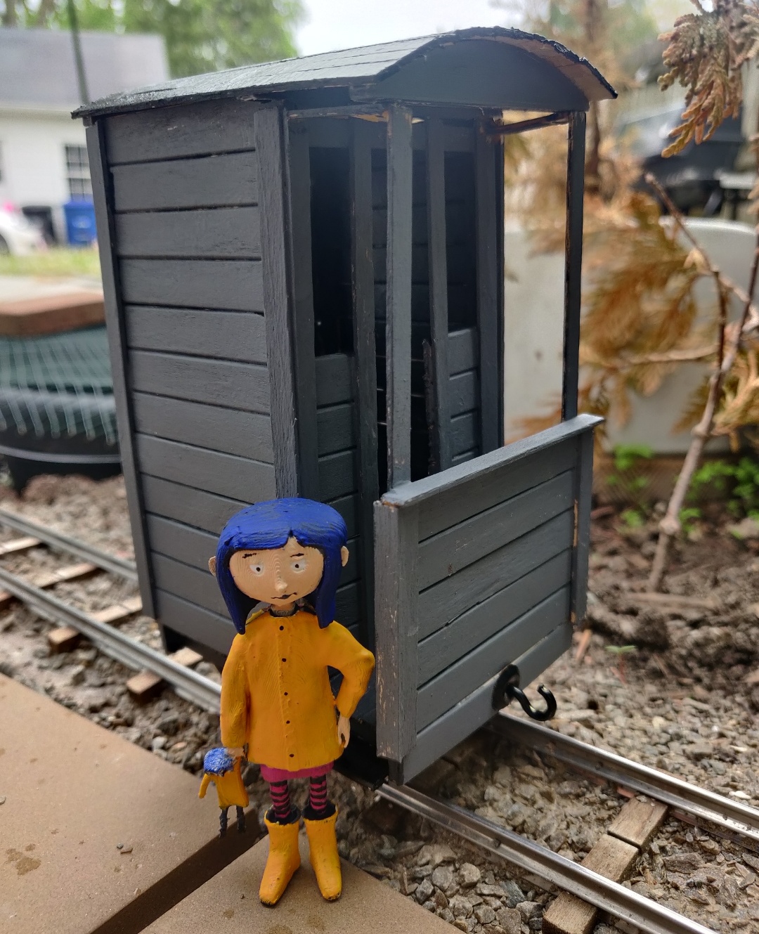

I can highly recommend Rik's GVT brake van model. I printed it in FDM and it's a valuable component of the NVT roster.
Careful what material you use to print your stock... Some shrinkage may occur!
(Kidding! This shorty brake van is pre-shrunk and made of popsicle/lolly sticks.)

Nicely printed and finisheddrewzero1 wrote: Tue Jun 18, 2024 1:45 am I can highly recommend Rik's GVT brake van model. I printed it in FDM and it's a valuable component of the NVT roster.
