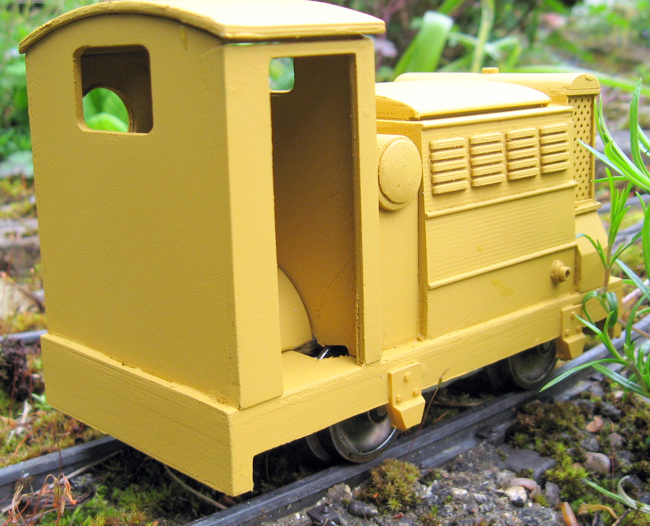

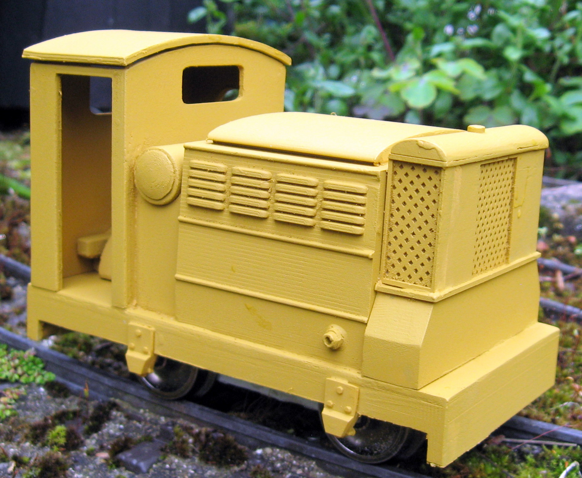

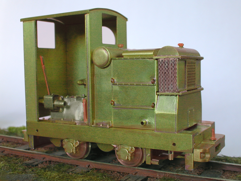

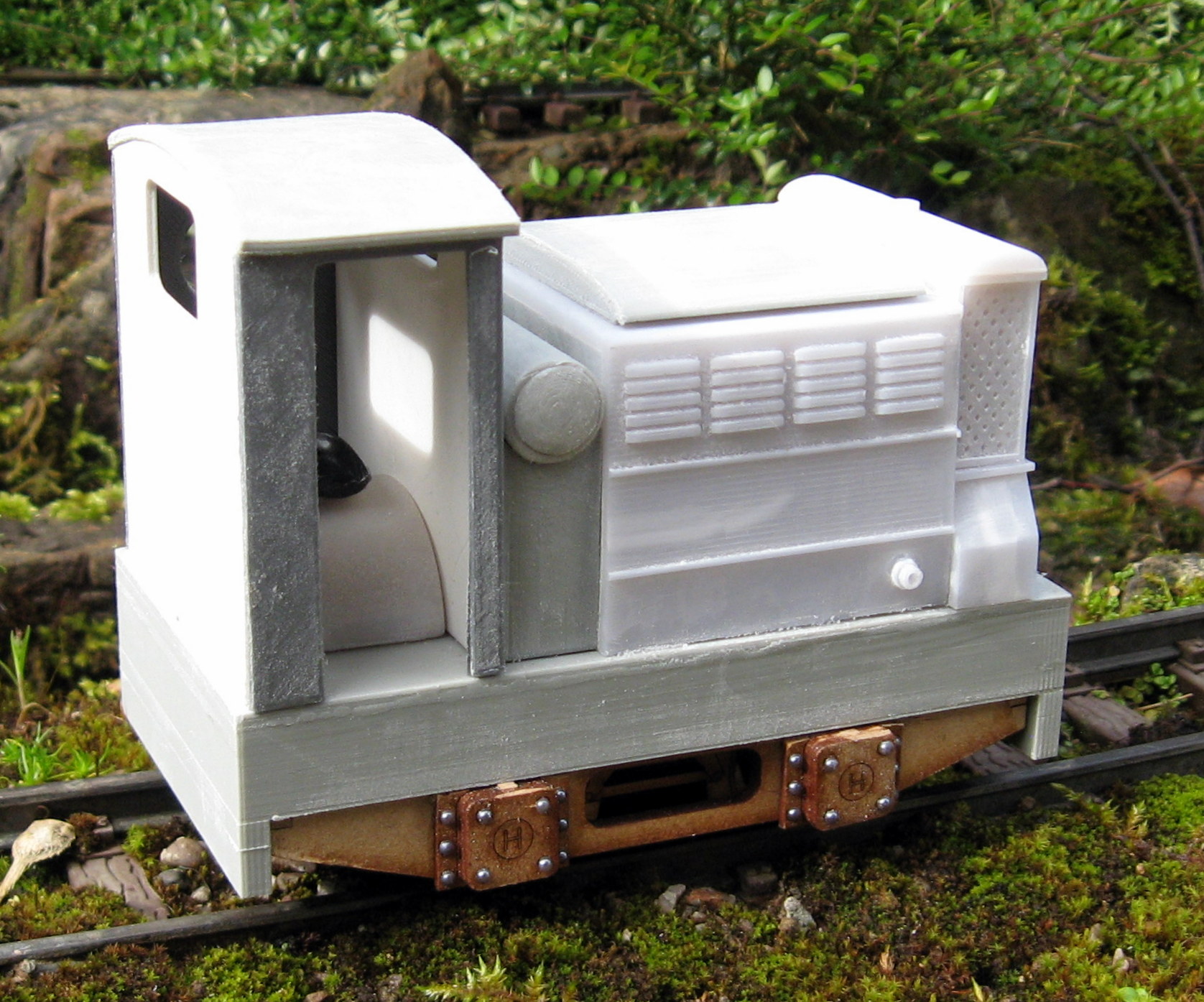

I bought another HGLW chassis and was wondering what to do with it .....
It's a sort-of, maybe, might be Ruston. I couldn't find a 3 foot gauge Ruston and so 'adapted' a 2 foot gauge one. I've almost got away with it.
I think, when Ruston's did produce 3' gauge locos, they were inside-framed. Maybe, if the wheels on the chassis were a bit smaller, it could sit closer to the ground, and look less sit-up-and-beg.

Well... it's .... errr... different! :lol: :lol:
Be good to see how you finally finish it. :D

What surprised me is the large number of variations in the basic design of these locos, which is why I felt justified if creating yet another version.

ge_rik wrote: Tue Apr 09, 2024 4:22 pm I think, when Ruston's did produce 3' gauge locos, they were inside-framed.
Rustons that were built to other than 2' gauge had extensions welded to the sides of the frames to carry the wider wheelsets.
This link to a photo taken by the late Weston Langford shows a later model Ruston that ran on the 3' gauge SECV Bogong Tramway in the Vic. high country. The frame design didn't change over the years, just the bodywork styling......

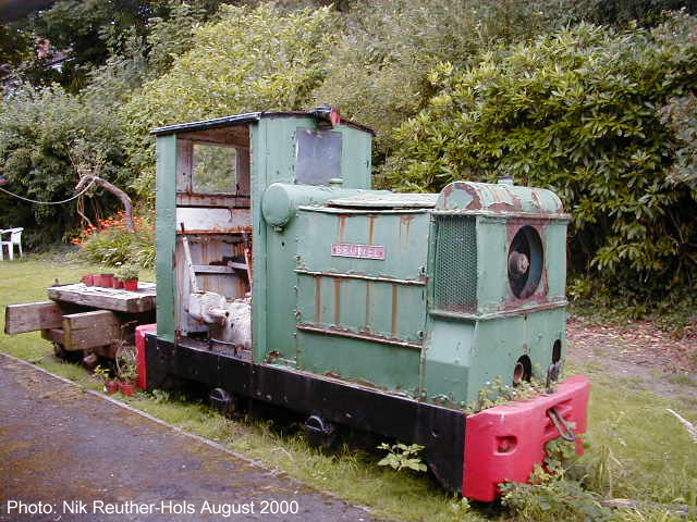

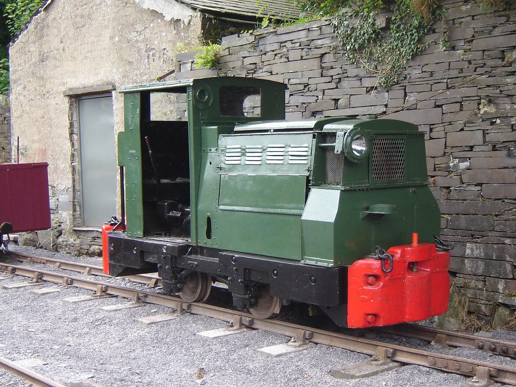

Rik,
If you want pictures of Berwyn, or 'the pigs' (the various orange painted loco's)..
These are at the WHHR, and I can get/take chapter and verse, for you.
Berwyn is now in the museum, for this season.
Berwyn at WHHR
Berwyn at WHHR

Thanks Phil
They're a bit too modern for me - I like the earlier diesels.
PS - I like the way they've bolted chunks of steel on the outside of the loco - presumably for extra adhesion?

Is that a 3D print, 'papered' in lino?

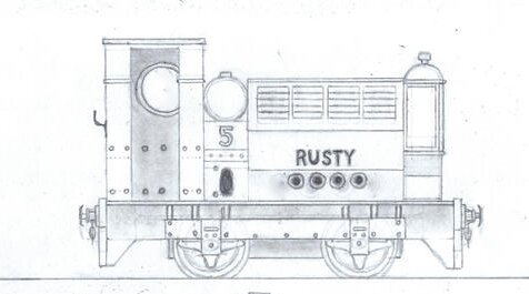

I do love a Ruston - always have done, "Rusty"'s such a likeable character in the Thomas books...
I like your 3' version, looks like a plausible "might have been" to me... Will it go into your standard green livery?

Andrew wrote: Tue Apr 16, 2024 1:32 pm I like your 3' version, looks like a plausible "might have been" to me... Will it go into your standard green livery?
Thanks Andrew
Yes. I'm working on another Ruston and so will put both through the paint shop together

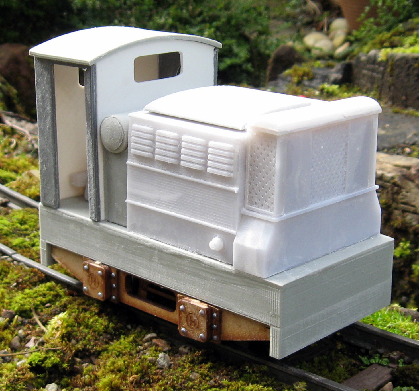

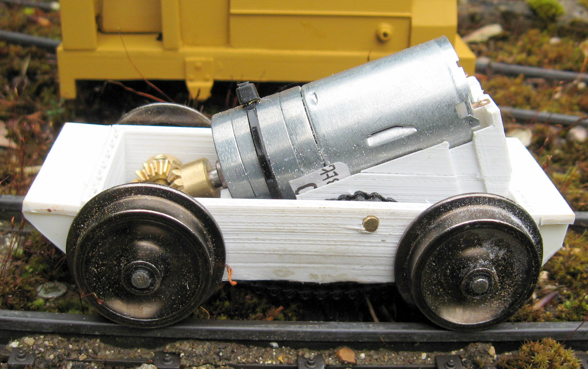

It's been a while. I have been busy with this, honest!
I wasn't at all happy with the HGLW chassis. Nothing wrong with the chassis per se, it just didn't look right with the Ruston. And so, the time has been spent in perfecting my own powered chassis. I've not altered the dimensions of the body (which were based on photos, guesswork and what would fit the original chassis), but I think the new chassis is much better suited to the prototype.
Still more smoothing and a tiny bit of filling to be done - but it's now under way once more.

Rik,
Four-wheel drive, and are those metal wheels?

I think it is Phil... I spotted that little peek of the drive chain! :D
Keeping my eye on this one Rik. I used one of those geared motors on Thornas originally and really like the (quiet) sound and performance.
