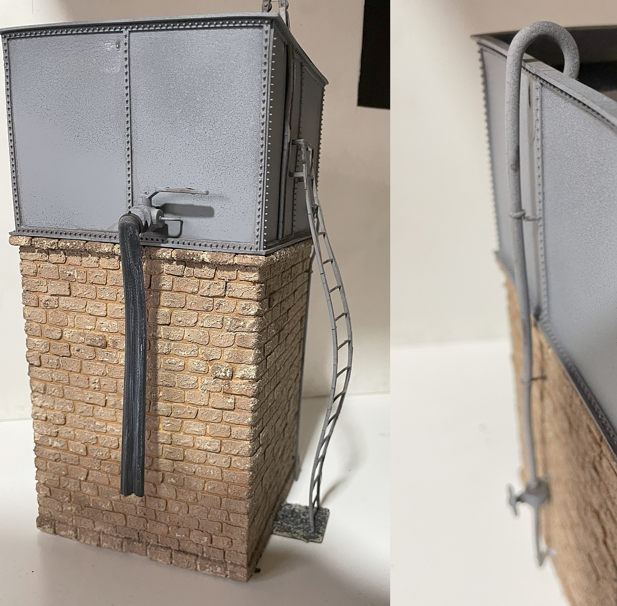

I've been really positive about the Sunlu Water Washable ABS-like resin, because it gave me superb results.
HOWEVER..... After I finished the Water Tower, I moved on to some winter maintenance of other buildings, one of which is the little signal cabin from Bench Junction. Having been outside for about 6 years 24/7/365, it needed a few bits sticking back on, etc. The barge boards at one end had dropped off and disappeared so I thought I'd print one V-shaped replacement, rather than messing about cutting styrene sheet. That worked easily and a couple of drops of superglue and some paint and job done.
Running out of space to keep them I took them down to the shed, which is cold and damp but watertight, and put them on a shelf out of the way.
That was three weeks ago.
Yesterday I went down to get something else, and to my horror this is what I found:
I think that even when cured and painted, this resin is extremely hygroscopic and has absorbed lots of water with the result that everything swells.
It is very obvious on thin items, but in fact the tower and tank sides are no longer flat either.
Just to complete the sorry tale, I did say in one of the conversations at the time with Trevor, that I would put a dummy building outside over winter to see how it stood up... this is the result:
Again, it has absorbed water but because it is constrained at the corners, the 4 sides have all bowed inwards!
So the lesson is: Don't use this stuff for anything that might get damp.
I'll find somewhere warm and dry to put them now and see if they shrink back, although I'm not optimistic. :(

philipy wrote: Wed Feb 21, 2024 2:12 pm I've been really positive about the Sunlu Water Washable ABS-like resin, because it gave me superb results.
Do you know if the standard resin does the same or is it just the water washable resin?
Really sorry to see your buildings in that condition, but alas I am with you, I don't hold much hope of them shrinking back :oops:
Re: Sunlu water Washable Resins WARNING!!!
Posted: Wed Feb 21, 2024 2:32 pm
-steves- wrote: Wed Feb 21, 2024 2:23 pm
No, I don't know for sure, because I haven't got anything else in resin that has been left outside.
However, I don't know if you remember that I was working on a DeWinton with a one piece resin printed body? I left it on a window cill just supported at both ends on its end plates and forgot about it over last summer. I've found that it has sagged significantly in the middle. That was printed using Elegoo water washable standard resin. So it looks as the W/W resins are not very robust.
