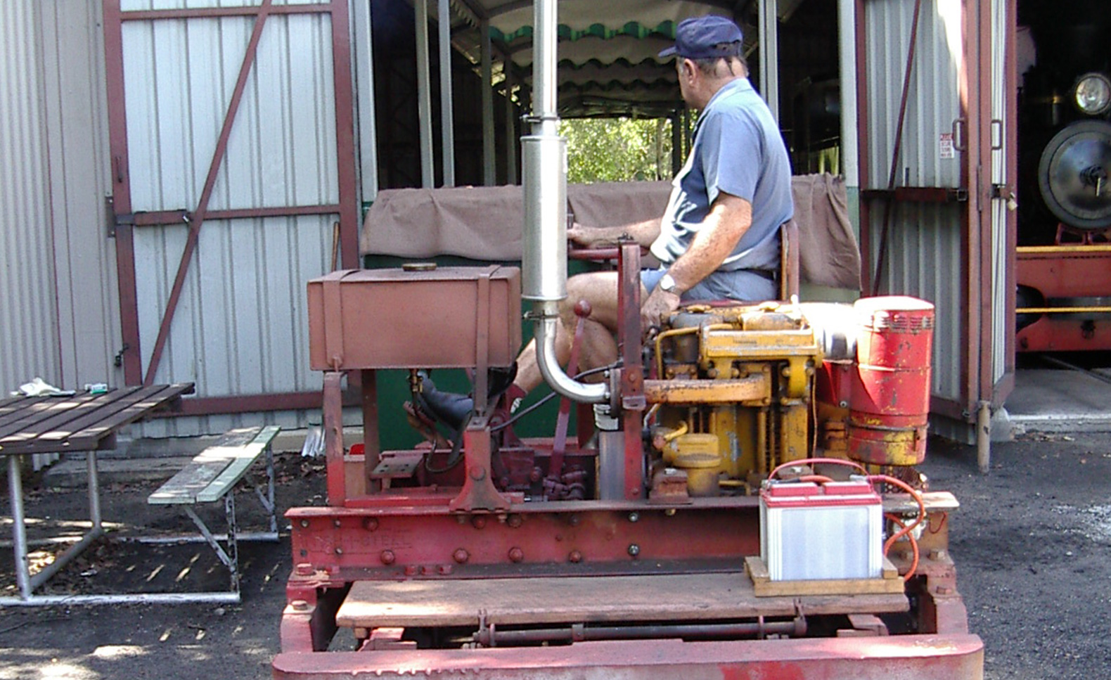

This is an old photo of it before restoration
Re: Simplex Yard Shunter

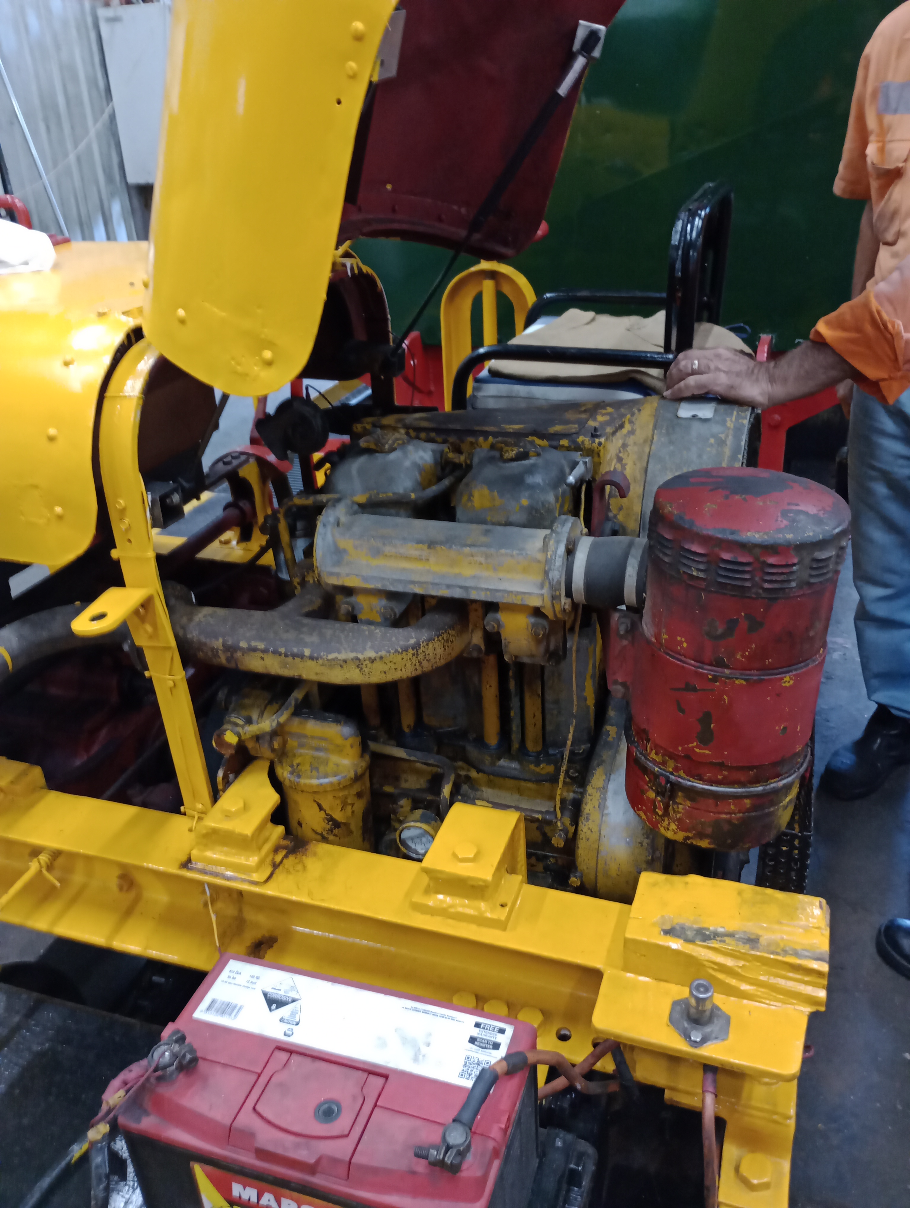

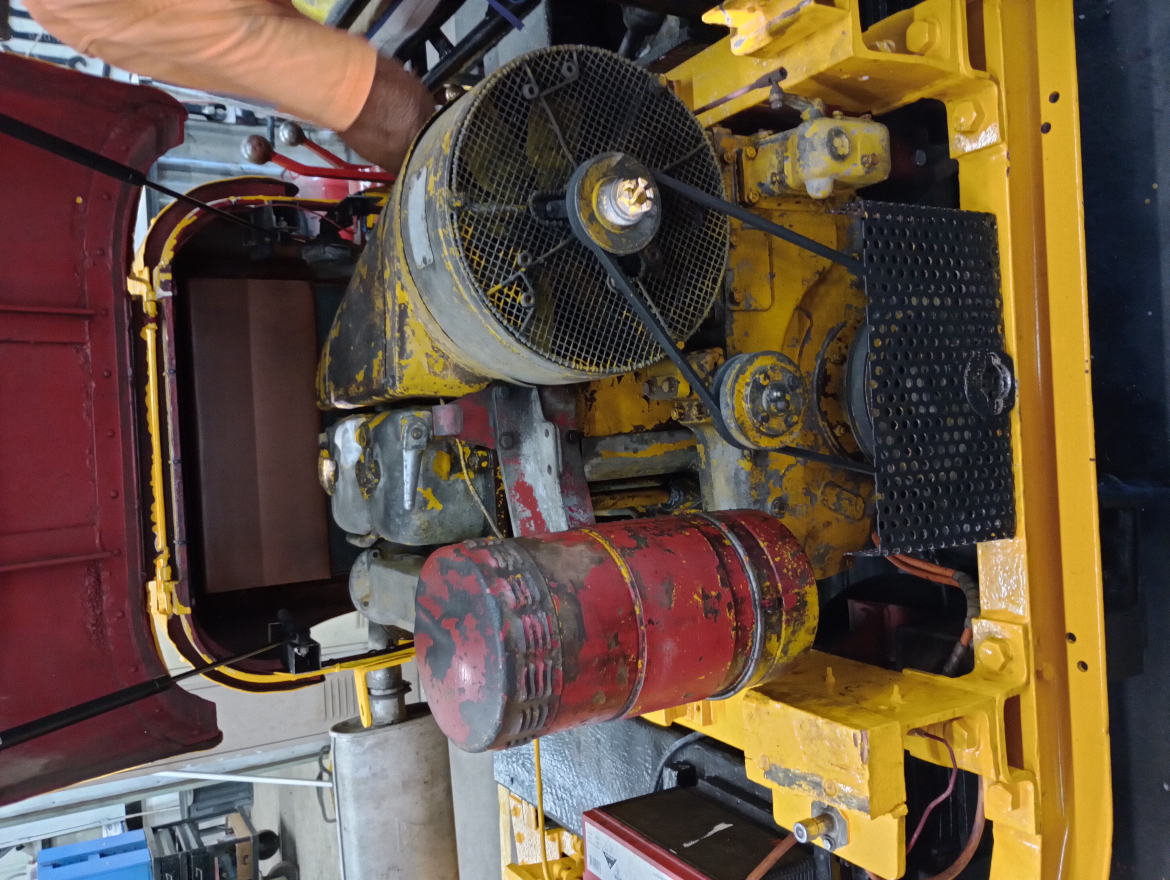

As promised pictures of the motor, there is no radiator so presumably it is an air cooled diesel.
In mid picture is the decompression lever and down the bottom the crank handle slot.

The switch in lower part of picture is used once the engine is starting to fire.

Start sequence is;
Check kill lever is in run position it is being checked in top picture
Lift decompression lever
Crank 4-5 times or till engine sounds like it is starting to fire
Press switch and lower decompression lever.
The press switch is an electrical assist motor it can be used as a starter but is not really effective hence using the hand crank.
Posted: Mon Feb 05, 2024 7:03 am
by dudeface
It's air cooled, the hollow thing with the fan in it is a cooling shroud.
