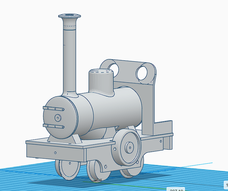

A friend likes the design of the Cracker loco, but asked if I could do a 3D printed electric one. So I have sat down with CAD for a couple of days and I think have the basis of an E-Cracker. It will still have the 3 gears, a flywheel and a pretend working oscillating engine. The chimney is purposely long as he likes long chimneys.
This is the ROUGH sketch up so far.

Post by -steves- » Wed Oct 18, 2023 9:29 am
philipy wrote: Tue Oct 17, 2023 4:28 pm Interesting project Steve.
Keep us updated please.
I will do. It all depends on whether I can get it all working and the gears to mesh etc. My gears are thin plastic and I have a suspicion that any play in the axle will enable the gears to be hit and miss. It might take a few washers to pad out any play or I might need to invest in some wider gears, or even make some if push comes to shove. :dontknow:

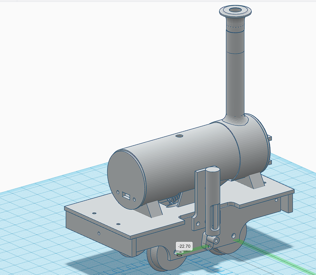

Well I think the CAD work is done, just got to print all the bits now and see if they all fit together as expected.
I wonder how many CAD workers try and view the picture below in 3D and try to spin it round to view it? Why do I think this, because it's something I do myself, lol :lol:

-steves- wrote: Thu Oct 19, 2023 11:19 am I wonder how many CAD workers try and view the picture below in 3D and try to spin it round to view it? Why do I think this, because it's something I do myself, lol :lol:
:+1
...although I haven't done it with one. :lol:
-steves-
Posts: 2473
Re: Electric Cracker
Post by -steves- » Thu Oct 19, 2023 3:16 pm
philipy wrote: Thu Oct 19, 2023 12:24 pm
:+1
Phew, at least I am not the only one :D

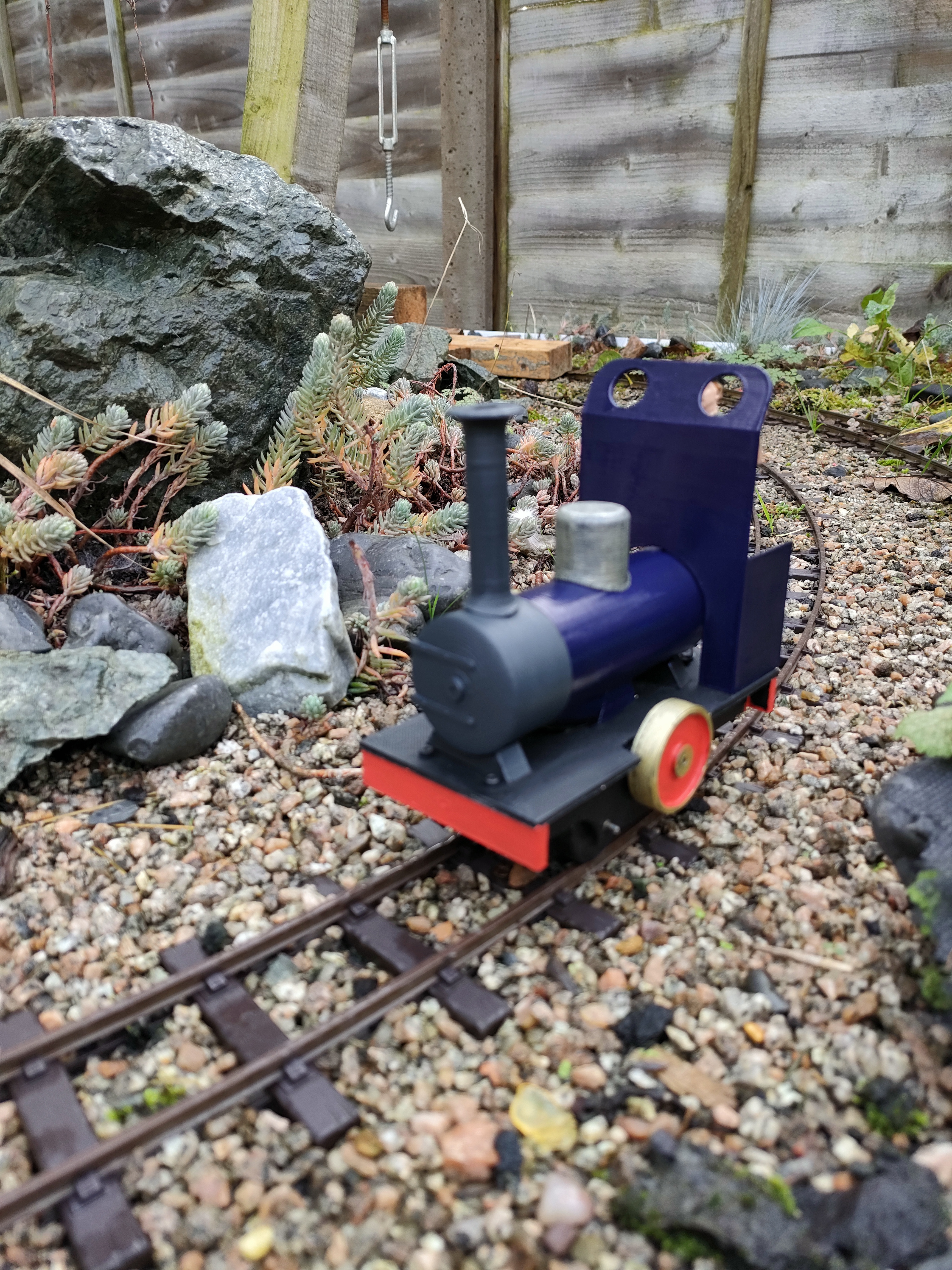

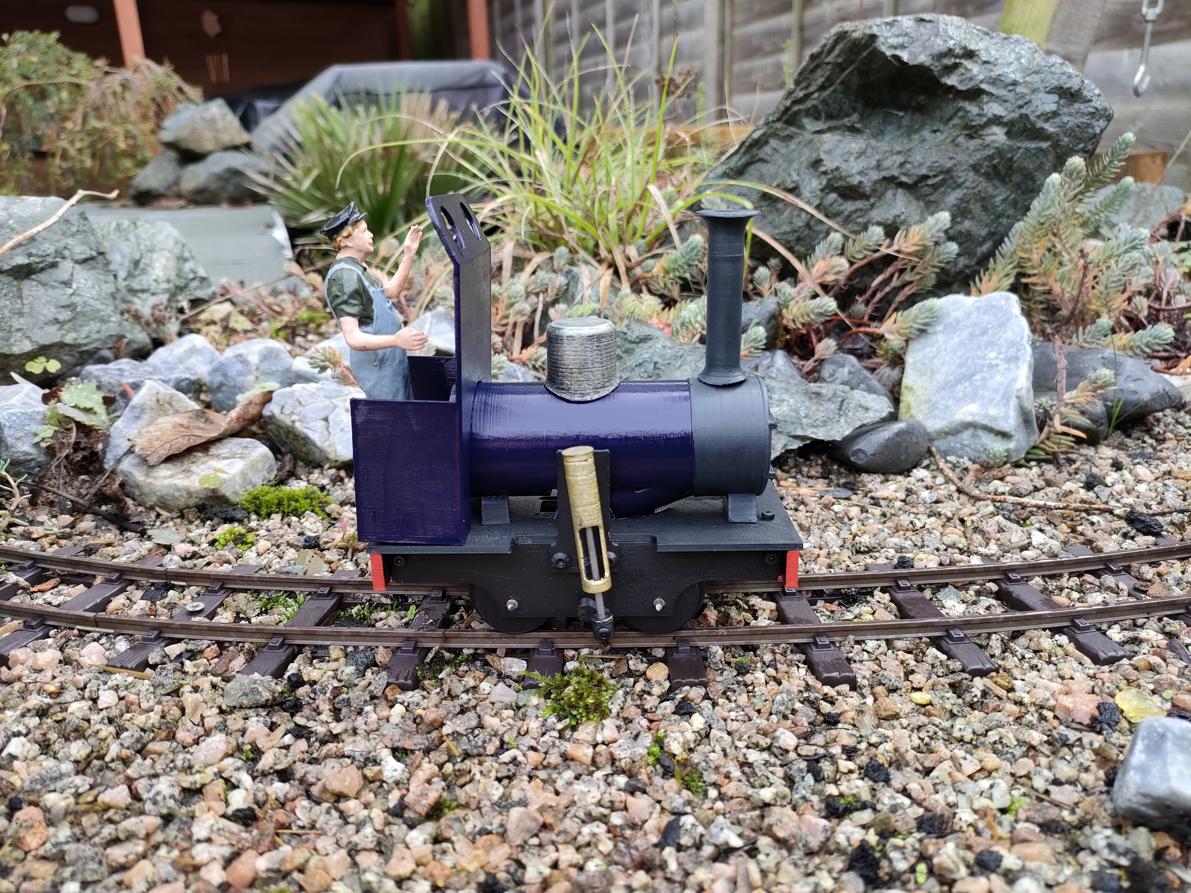

Post by -steves- » Mon Oct 23, 2023 1:23 pm
Well here is the almost finished loco. It need a few more coats of paint and a bit of tidying up, but it's there and it all works. I can't show a video of it going around the line as the line is in pieces at the moment awaiting repair, so just some still shots I am afraid. This is not my best paint job, it was done in a rush, with a big fat brush, not sprayed, just to have a rough feel how it might look, also no rubbing down has been done on the model. The cab is also not glued on at this stage, neither is the driver, lol.
