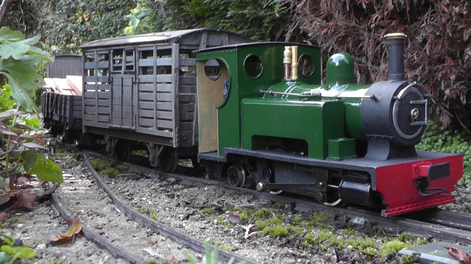

I've constructed a few semi-scratchbuilds (ie scratchbuilt body on commercial motor block) over the years. Not sure if thy are all G Scale - they are a mix of 16mm / SM45 (1:19) and 15mm /Fn (1:20.32) - I think Fn is part of the G Scale family but the G Scale ruler is somewhat elastic.
In chronological order:

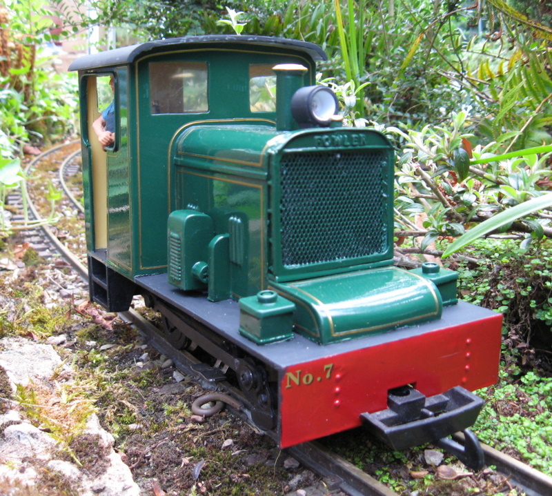

My first semi scratchbuild was a Fowler-ish 0-4-0DM. I couldn't find any photos or plans of a 3' gauge Fowler so it's a cross between a standard gauge and 2' gauge model in SM45 scale
My next model was a representation of the Southwold Railway Manning Wardle 0-6-2T No. 4 in Fn scale. The scale was dictated by the wheelbase of the LGB motor block which wasn't quite right but 15mm scale was closer than 16mm scale.

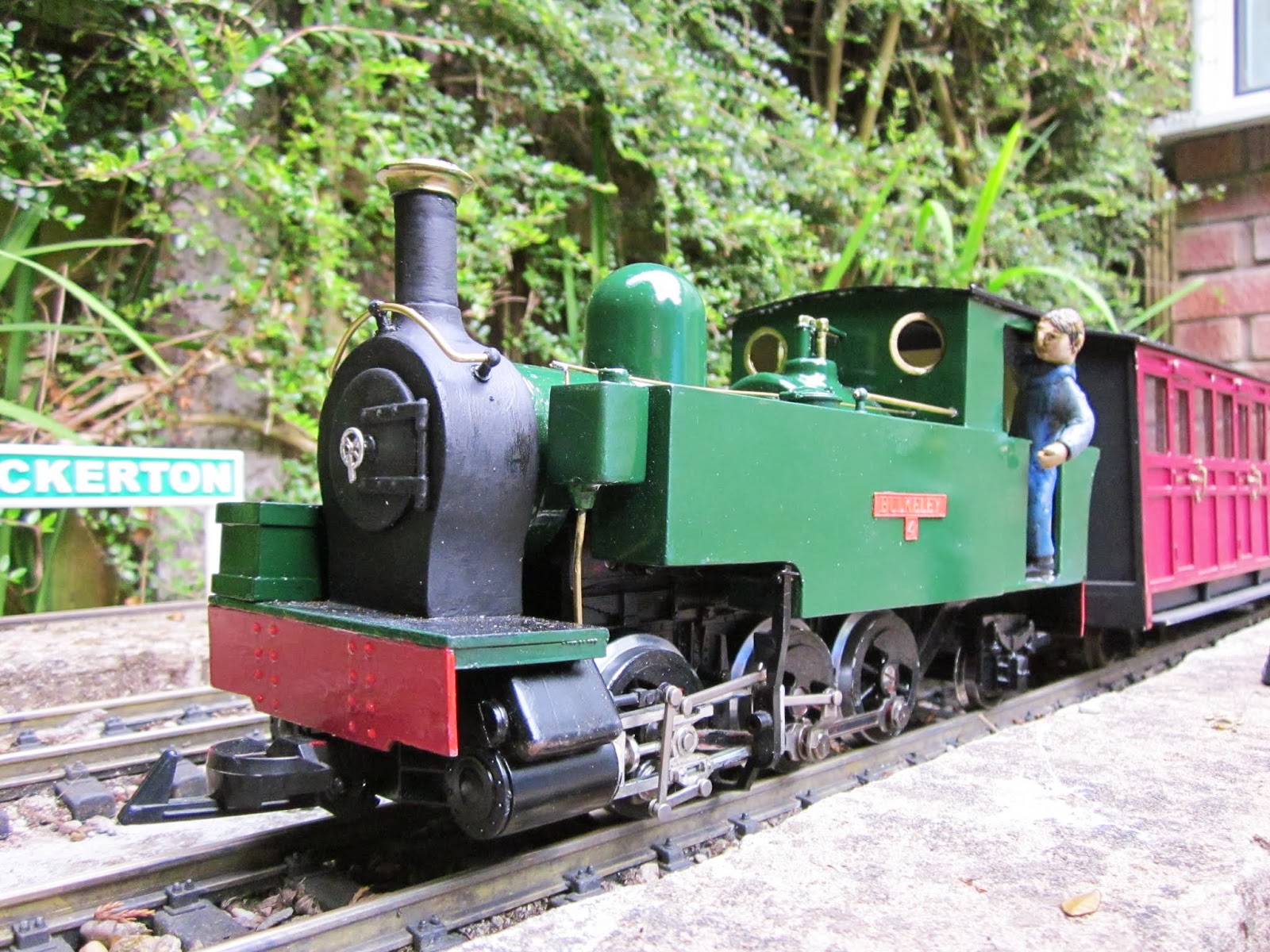

I then turned to another Southwold loco, on of their Sharp Stewart locos, the 2-4-2T No. 1, Southwold. The Playmobil motor block was closer to 16mm scale so this was chosen, which means I rarely run this loco and the Manning Wardle side by side as the scale difference would be too noticeable.

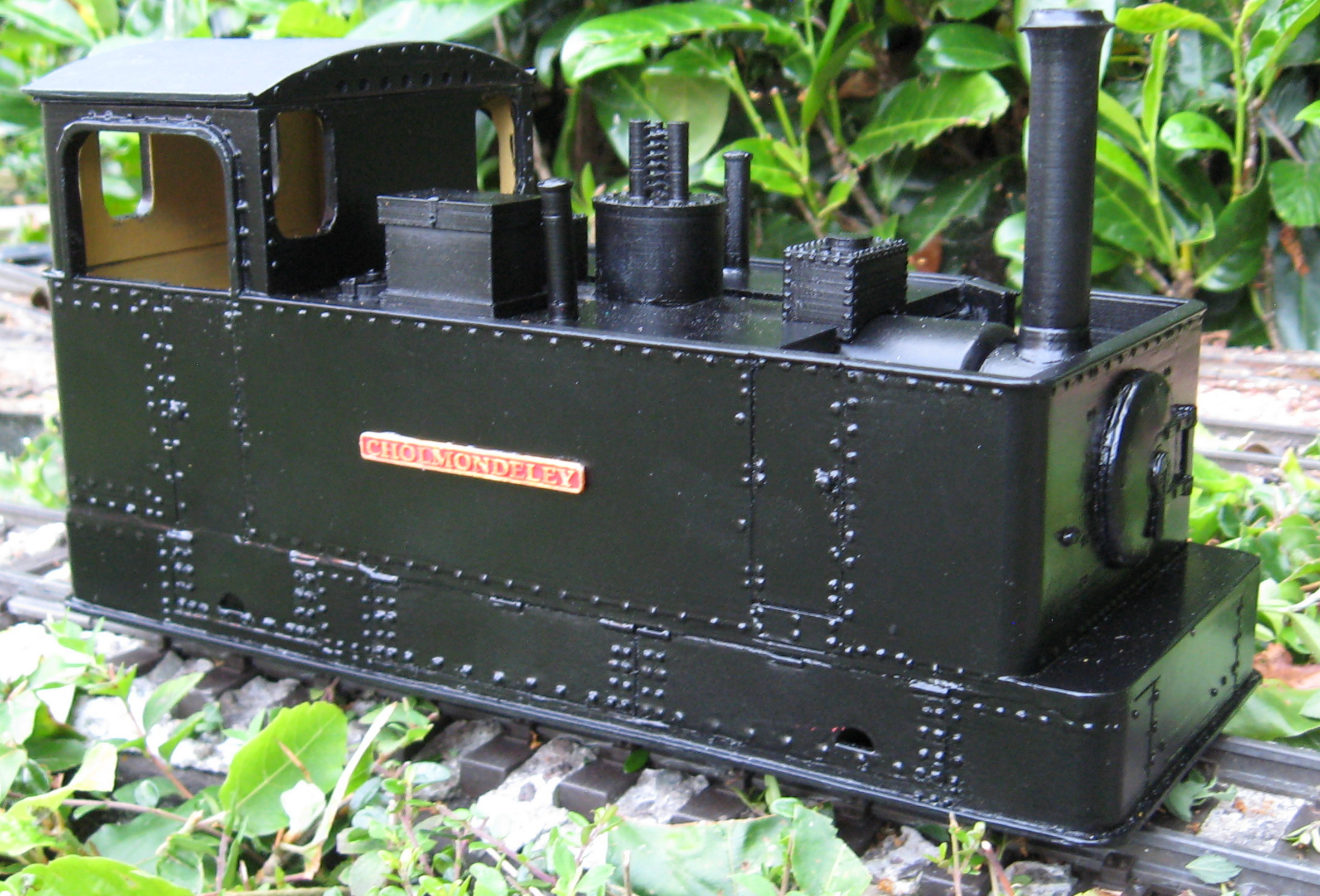

My first scratchbuilt 3D printed loco was a Schull & Skibbereen Nasmyth & Wilson (ish) 0-4-4T using a modified Bachmann Lyn motor block. This is almost a complete scratchbuild as the motor block was so heavily redesigned and rebuilt by me that there is very little of the original left. It is 15mm scale.
Next came a Metropolitan Water Board Kerr Stuart 0-4-2T in 15mm scale on one of the more recent Bachmann Lyn motor blocks. I had such difficulties with the old Lyn motor block I was sent a couple of blocks by fellow modellers in the hope I could make use of them.
My most recent scratchbuild is a GVT Beyer Peacock 0-4-2T. This is a complete scratchbuild as I have replaced the Bachmann tram motor block which I used originally with one of my own design, built from scratch. It is 15mm scale.

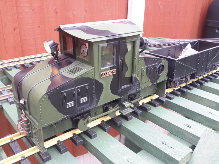

A Malcolm Moore loco, built for the Australian Army in WWII. The prototype was 2ft gauge, but I built mine wider as a fictitious 3ft gauge conversion, to fit the 1:20:3/Fn3 scale I was working with at the time in 2015. In mid-2022, I decided to finally bite the bullet and convert to 32mm, and model 2ft in 16mm properly. Converting this loco to 32mm and a scale width is more work than it's worth, so I will unfortunately have to sell my first scratchbuilt loco, once I've built a replacement.
It runs on three 14500 Li-Ion cells, through a Deltang Rx63, driving a shortened IP Engineering chassis with added delrin 4WD.

Posted: Thu Feb 16, 2023 8:31 am
Love that, Aaron. The weathering adds finesse

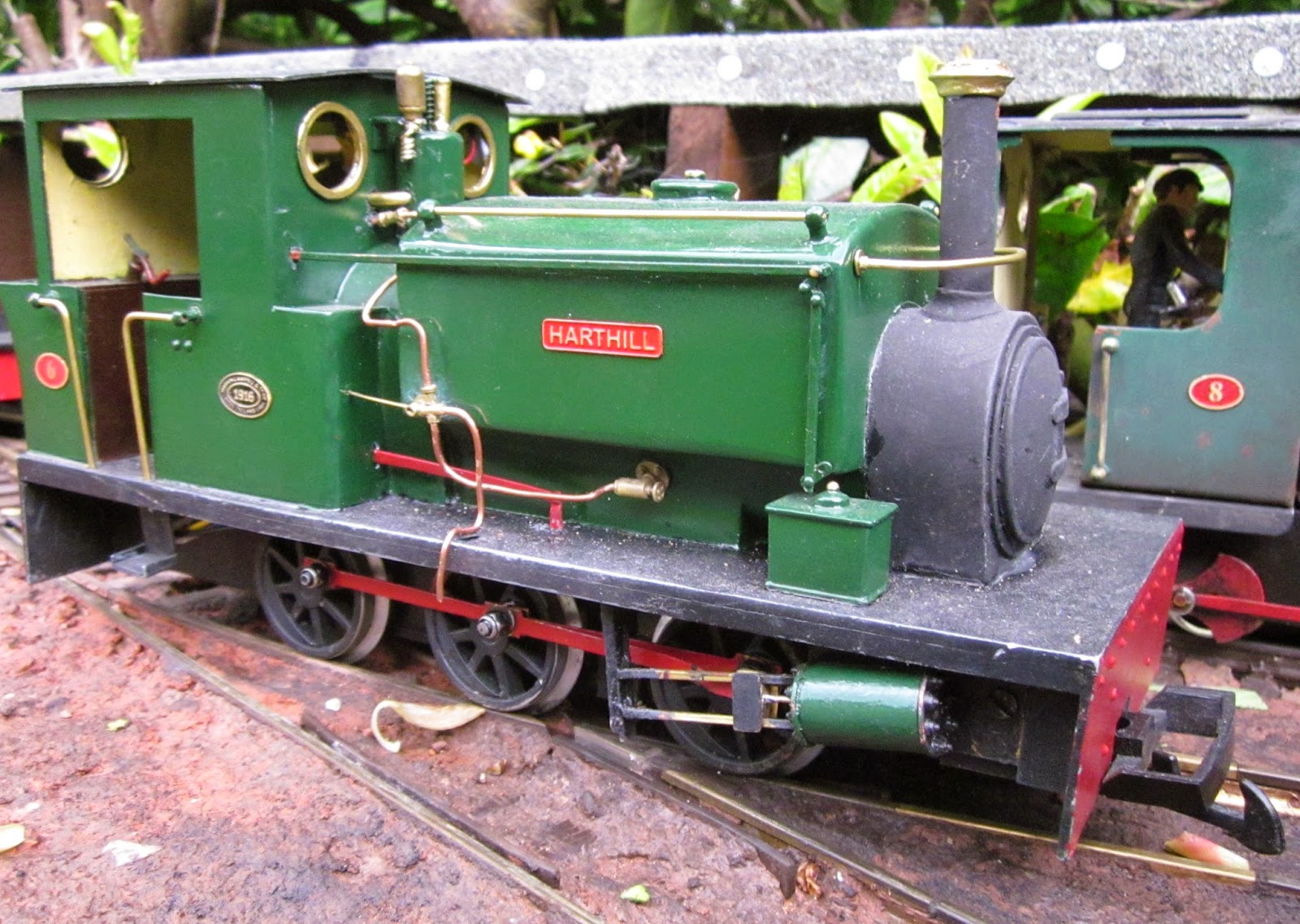

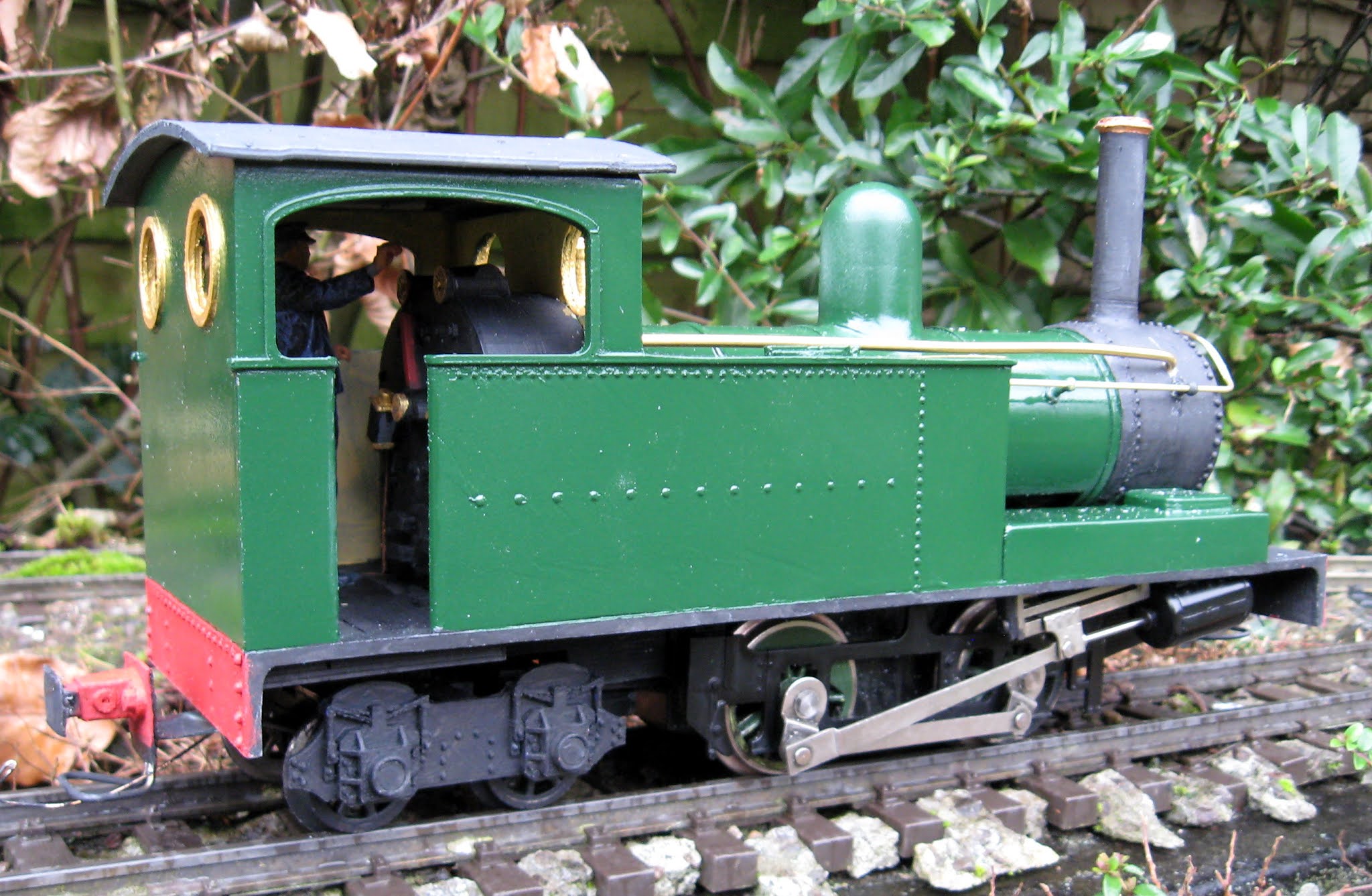

I've been debating with myself whether to post on this thread because I don't have anything that hasn't been seen before, all having been detailed in their individual build threads. However, just for the record and in the order in which they were built:
DSC_0007 (2) small.jpg (99.28 KiB) Viewed 56743 times

philipy wrote: Thu Feb 16, 2023 8:49 am I've been debating with myself whether to post on this thread because I don't have anything that hasn't been seen before, all having been detailed in their individual build threads. However, just for the record and in the order in which they were built:
I had similar thoughts, but decided this was an opportunity to show them all (so far) in one place. It's also prompted me to update my blog. I hadn't noticed that the last time I listed my loco roster on there was 2015. And a lot has happened since then.

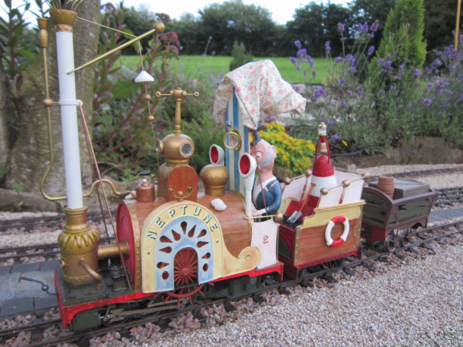

Scratch-built R/C locomotive model, 'Neptune'. Originally built to run on the 'Far Tottering and Oyster Creek Railway' 18" gauge line,1951 'Festival of Britain.

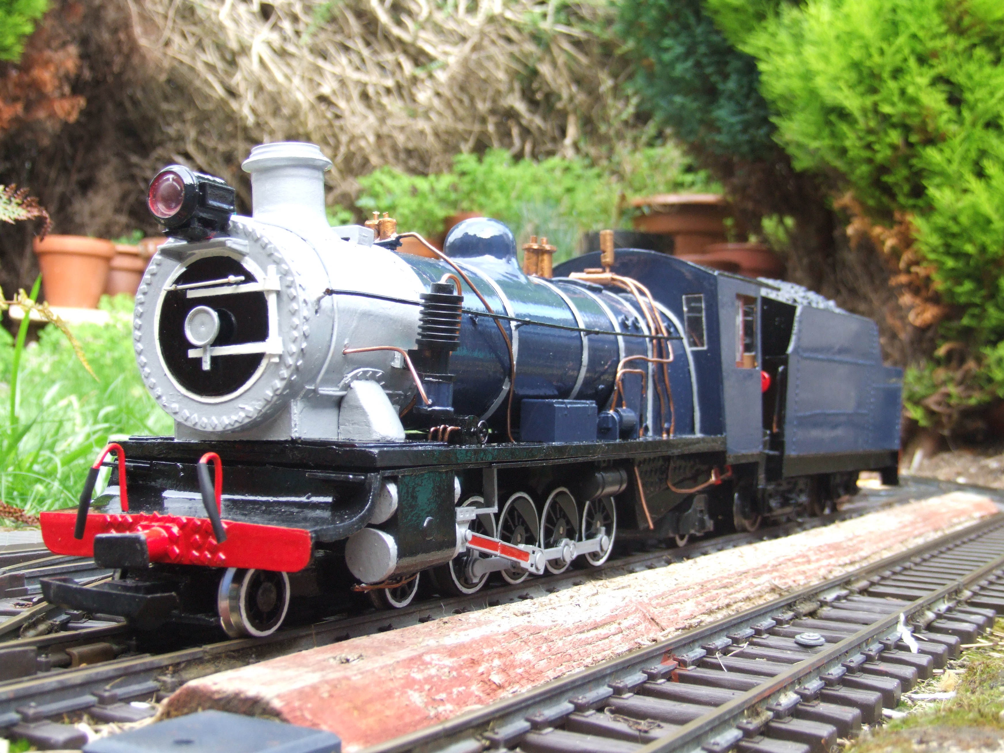

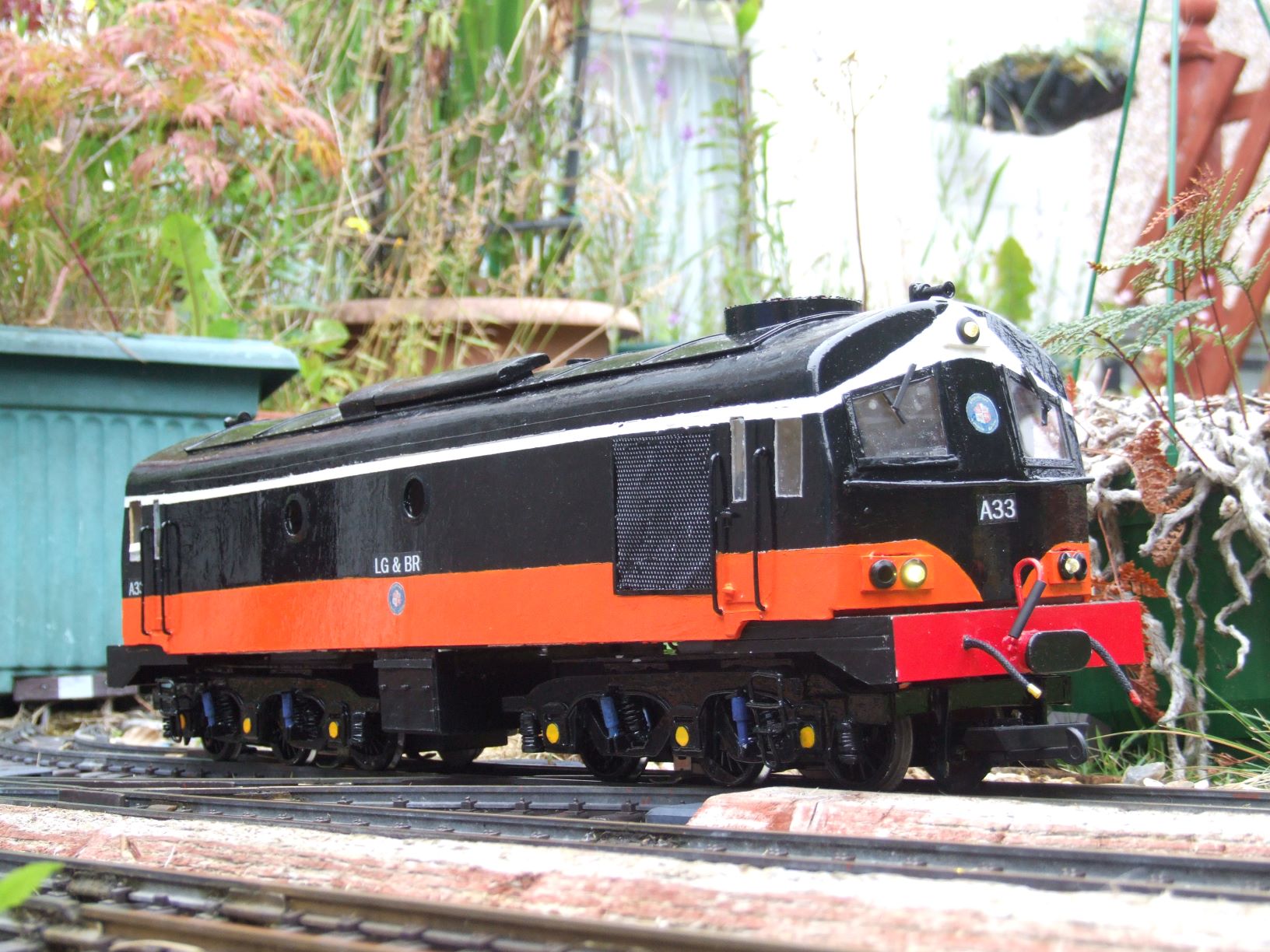

Number 13 Titus a 2-8-0 of South African origin using an old Delton chassis ! An Ex Irish Rail class 141 using USA trains power bogies bearings rotate as per prototype lights etc .Not fully finished here :D Image

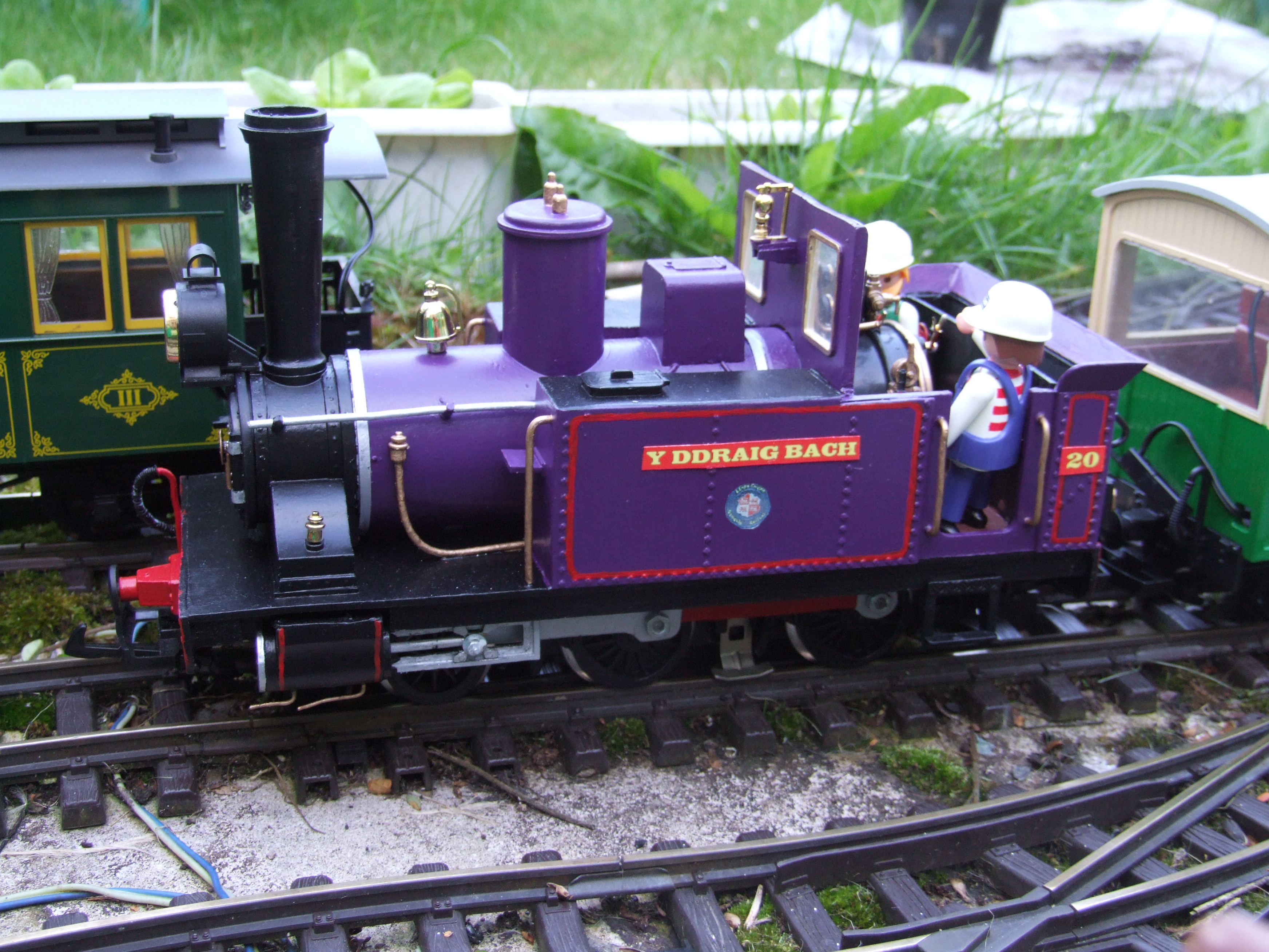

Next a Sudo Beattie Well tank Y Ddraig Bach (Little Dragon !!) Built with bits from the scrap box and a Playmobill chassis

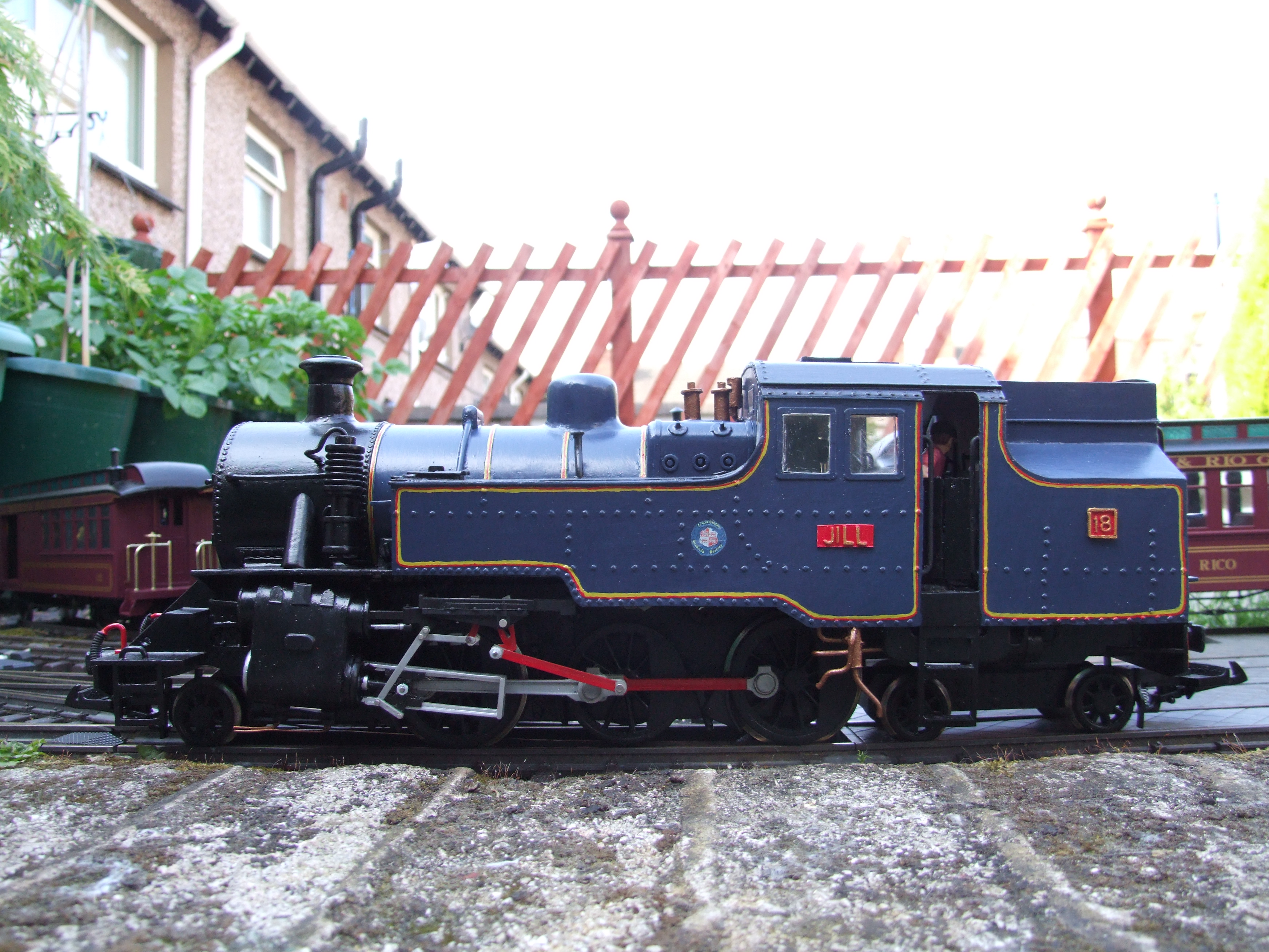

Next a Sudo NCC 2-6-4t " Jeep " Jill built on heavily modified Bachmann 4-6-0 chassis nice machine
Cab interior !

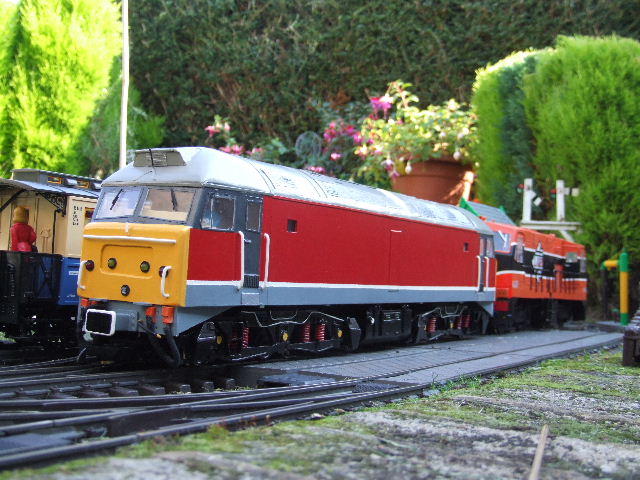

Class 57 or Rhodesian DE 4 diesel totally scratchbuilt aprt from USA power bogies named Commonwealth Spirit after much loved 47 local to N Wales

Ooooh! That 47/57’s very interesting…

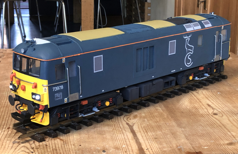

A garden railway just can’t have too many big tank engines and even bigger diesels, I reckon. Here’s my fun-scale Class 73 from not that long ago (I assumed I must have posted a snap of it complete before but it seems not).

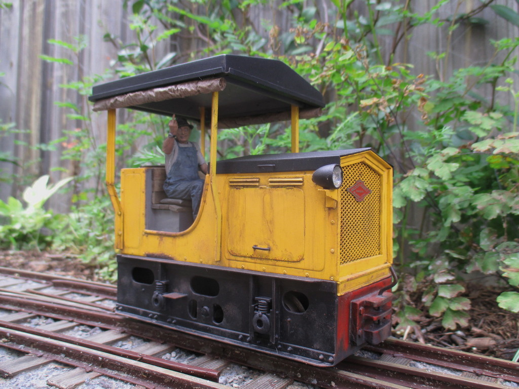

by Johnnie1000
I did this one in Lockdown II & III (or was it III & IV)
Cobbled together from some bits from an IP engineering chassis and a few other bits and bobs.
(A sort of NER/ Steeplecab battery electric thingumybob)
Kept me entertained for a month or so on and off.

Johnnie1000 wrote: Thu Mar 09, 2023 1:37 pm I did this one in Lockdown II & III (or was it III & IV)
Interesting design. Its name fits its appearance really well.
