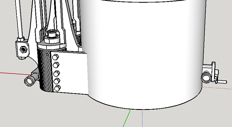

Sketchup drawing
- Screenshot 2022-12-12 17.18.39.png (67.37 KiB) Viewed 55018 times

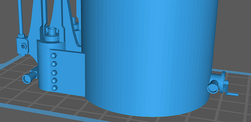

Chitubox slicer
- Screenshot 2022-12-12 17.21.10.png (115.21 KiB) Viewed 55018 times

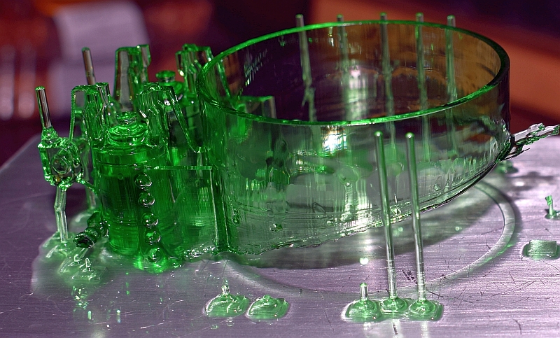

Failed print number 7
- DSC_0002.JPG (415.25 KiB) Viewed 55018 times

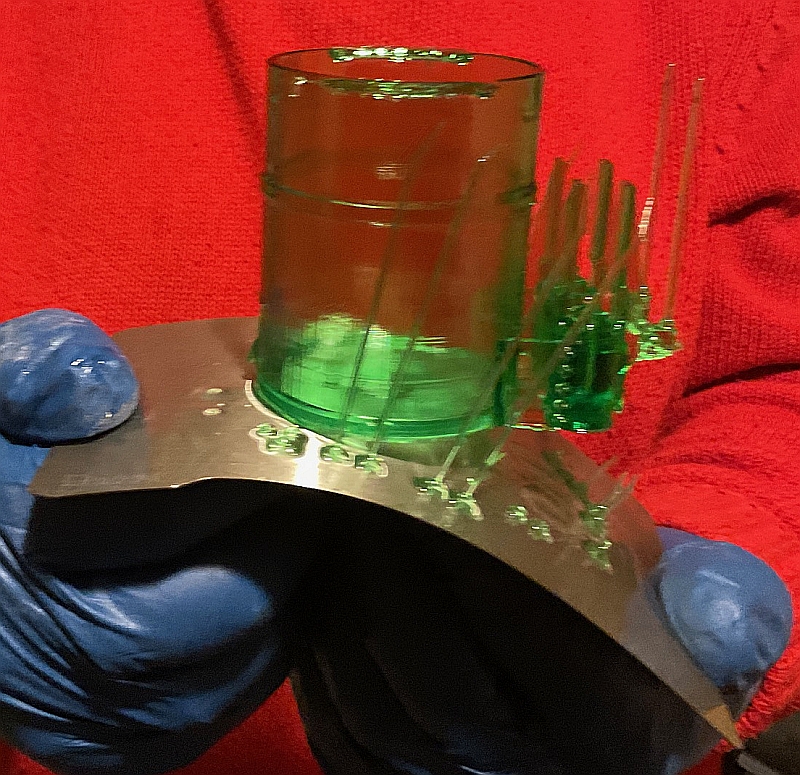

Thought it might be of interest to show a print coming off the flexible plate. I have literally just flexed the plate and swmbo managed to grab a piccy as I did so.
- IMG_3874.JPG (520.1 KiB) Viewed 54943 times

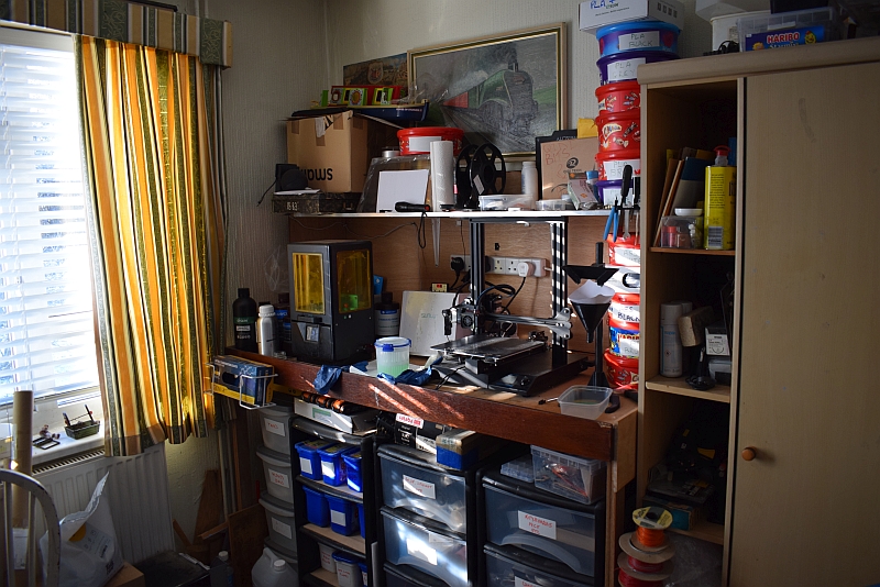

I have both printers set up in the small spare bedroom that I use as a workshop and general dumping ground. Atm, the radiator in there is off, but the door is open so it gets some warmth from general heating in the house, although that is also turned down significantly!
- DSC_0002.JPG (428.81 KiB) Viewed 54913 times
