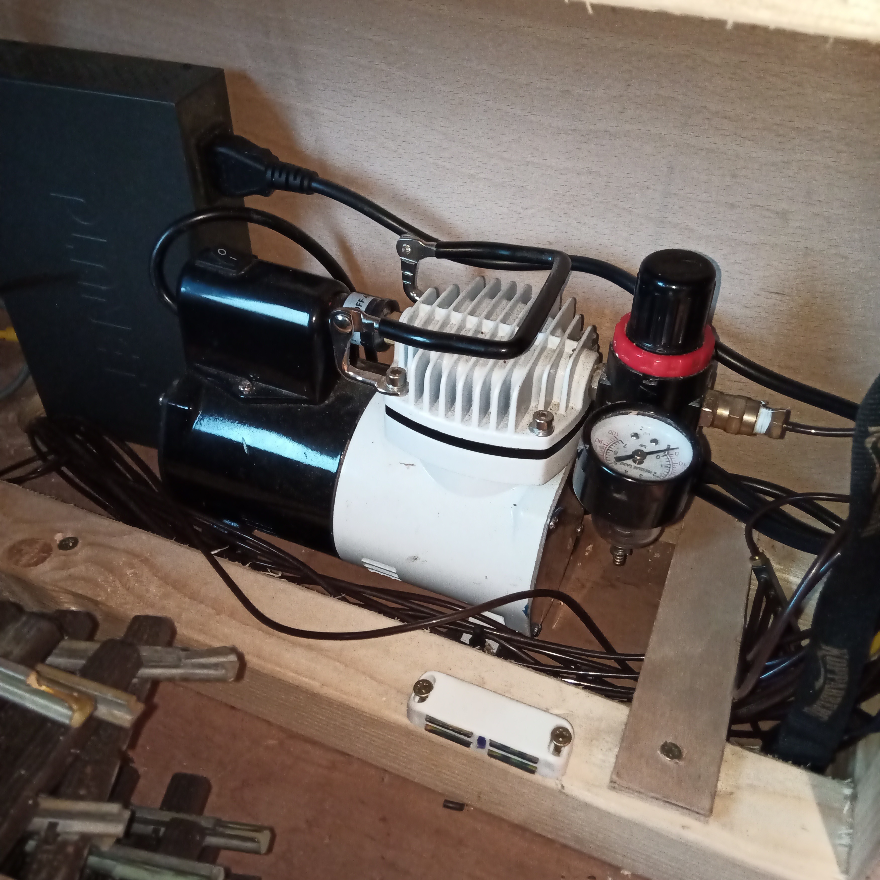

ge_rik wrote: Mon Nov 14, 2022 12:26 pm I'd love to see/hear more about the system overall. Do you use a compressor or manually pump up a pressure vessel (eg an old inner tube) at the start of a session? What do the operating switches look like? Etc.
I'm using a small compressor from a air brush set as its pretty quiet, i was previously using a 24Ltr one such as this https://www.screwfix.com/p/stanley-b6cc ... 230v/48089 but when it kicked it all of a sudden it gave you quite a shock!

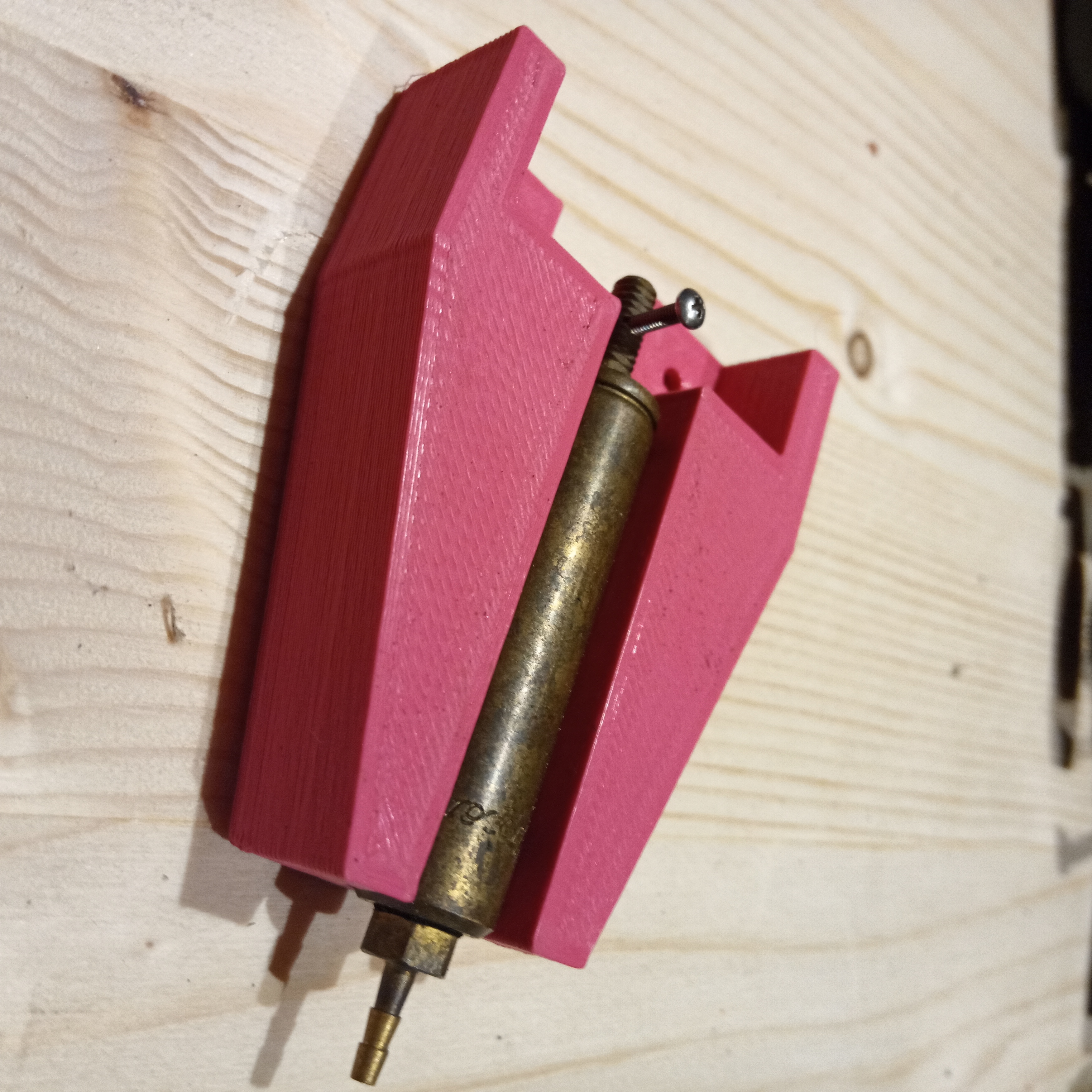

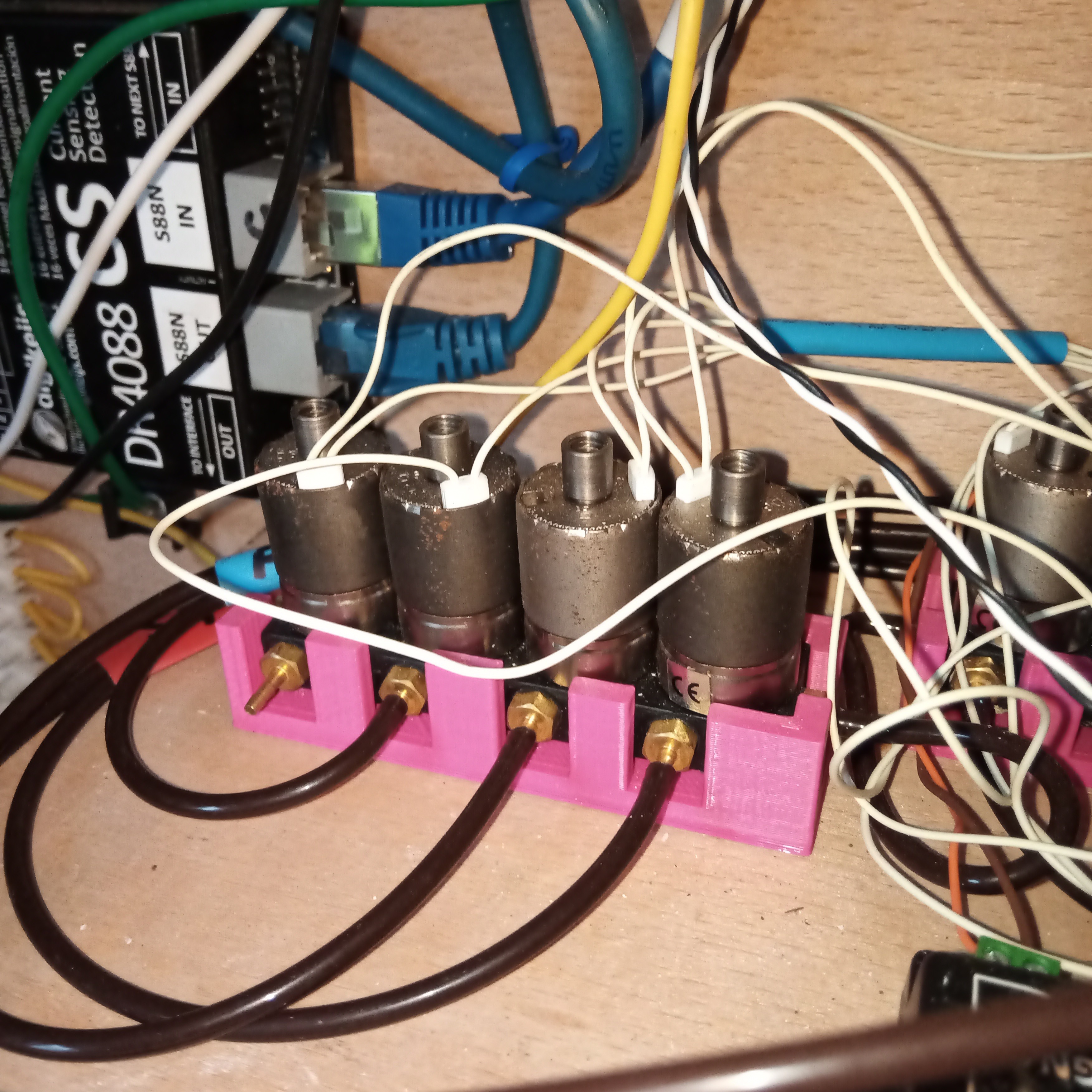

The Controls i use are 12-24V solenoid valves as its all computer controlled, the same reason i use a compressor instead of having to manually pump pressure up.
The solenoids sit in a 4 way manifold to attach the tubing to and are simply open when power on and closed when power off. I run 16 of them directly from a 16 way accessory controller and have no issues with power or overloading the controller (Digikeijs DR4018). The pink plastic bit is just a 3D printed holder for them to sit in, holder screwed down to shelving.

Air distribution from the compressor is via simple manifold.
