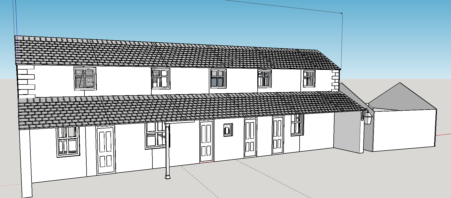

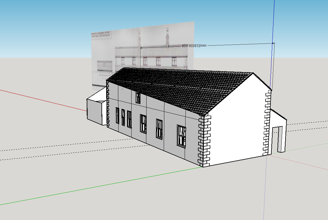

It is a true scale copy of the victorian building - well as close as I can get bearing in mind it is to go on a flat site rather than the odd sloping position the original occupied.So here are two views of the 3 D model to give you an idea of what it looks like:
In this view you can see the front of the building - the track sits in front of the veranda. As far as I can work out the veranda does not act as a canopy as it sits clear of the track. Details are not yet added. It should have gutters and down pipes. I have made a first attempt at the lamp ( there should be a similar one on the other end of the veranda), and the posts supporting the veranda.
This is the rear of the building which demonstrates its unusual shape. The down end of the station is much wider than the up end of the station, hence that roof shape. I am using the same technique I used for the cottages - a facing covering a latticework frame. The lines on the rear wall show where it is divided into sections which will fit on my printer. That rear wall requires 12 separate pieces for the face, and 12 for the frame.
The station building is a large structure, the model will be 845 mm long overall (without the goods shed), so it is going to take some time to print.
There is a goods shed on the up hill end of the station which is sketched out in the model.

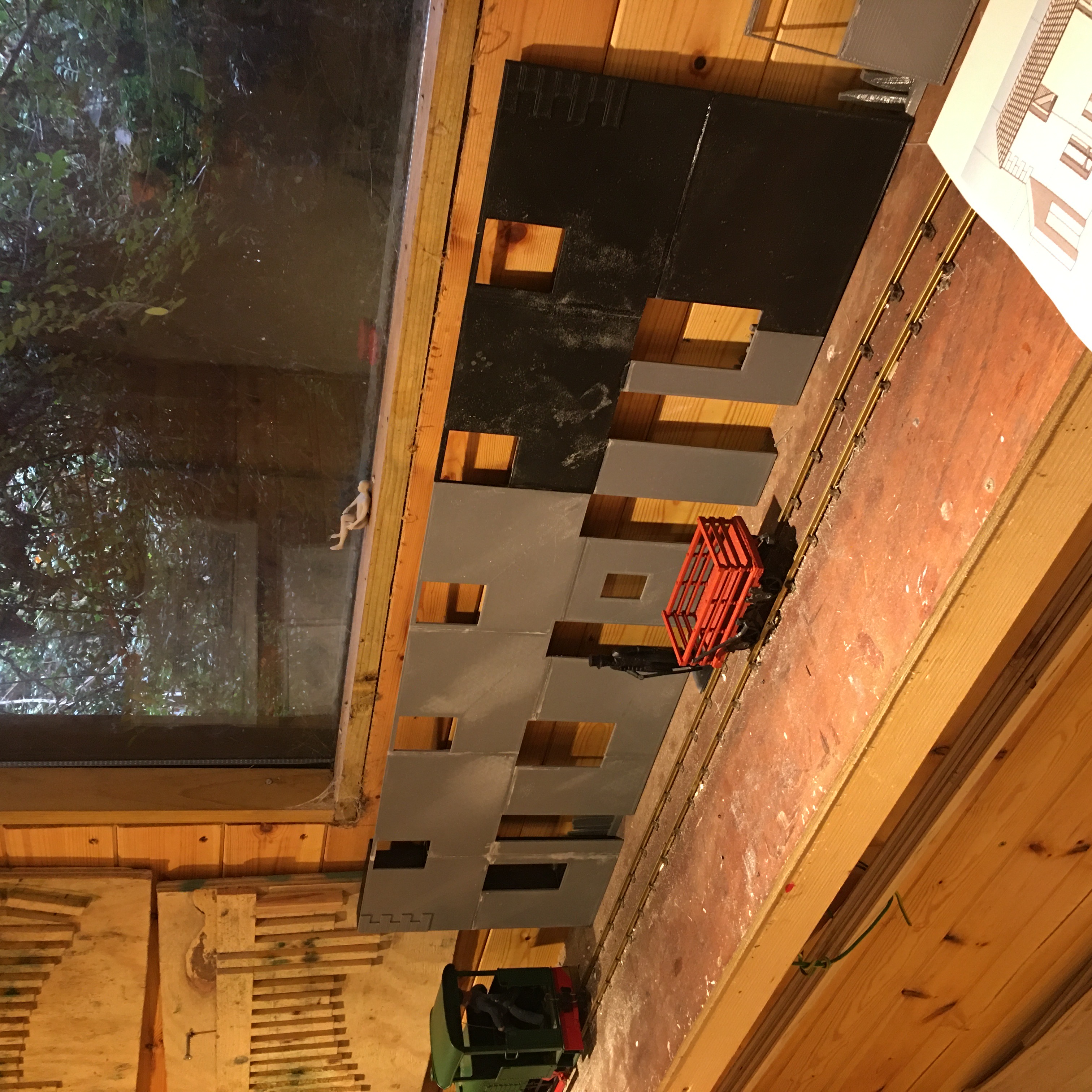

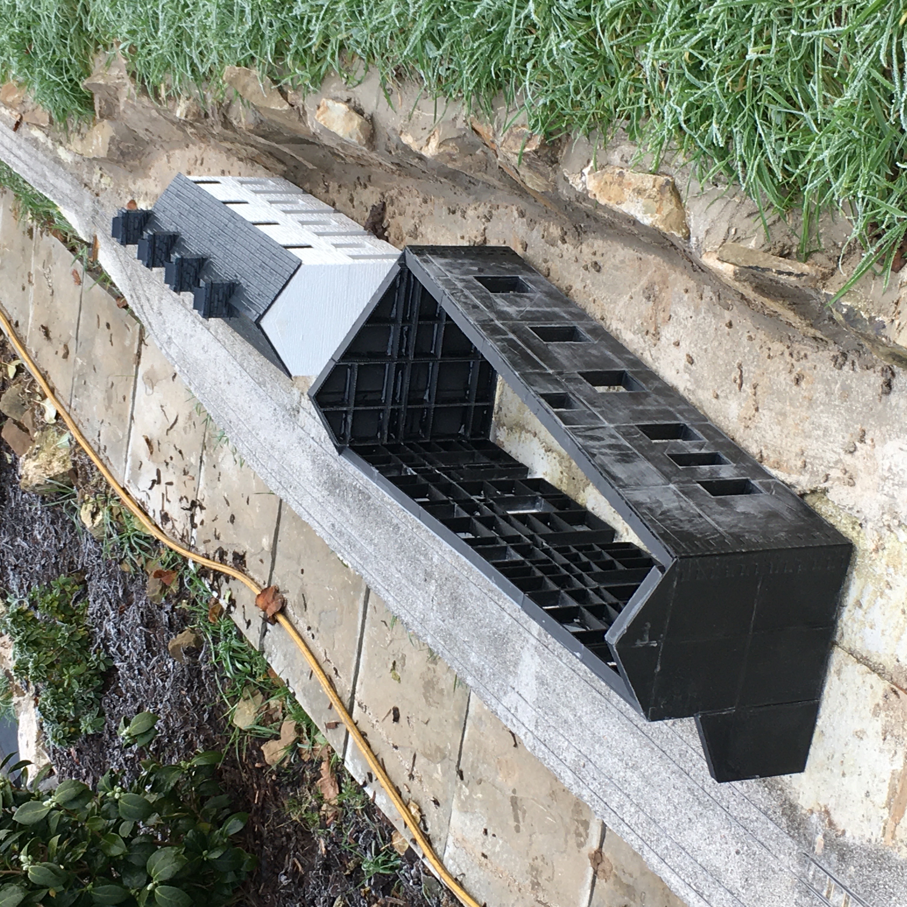

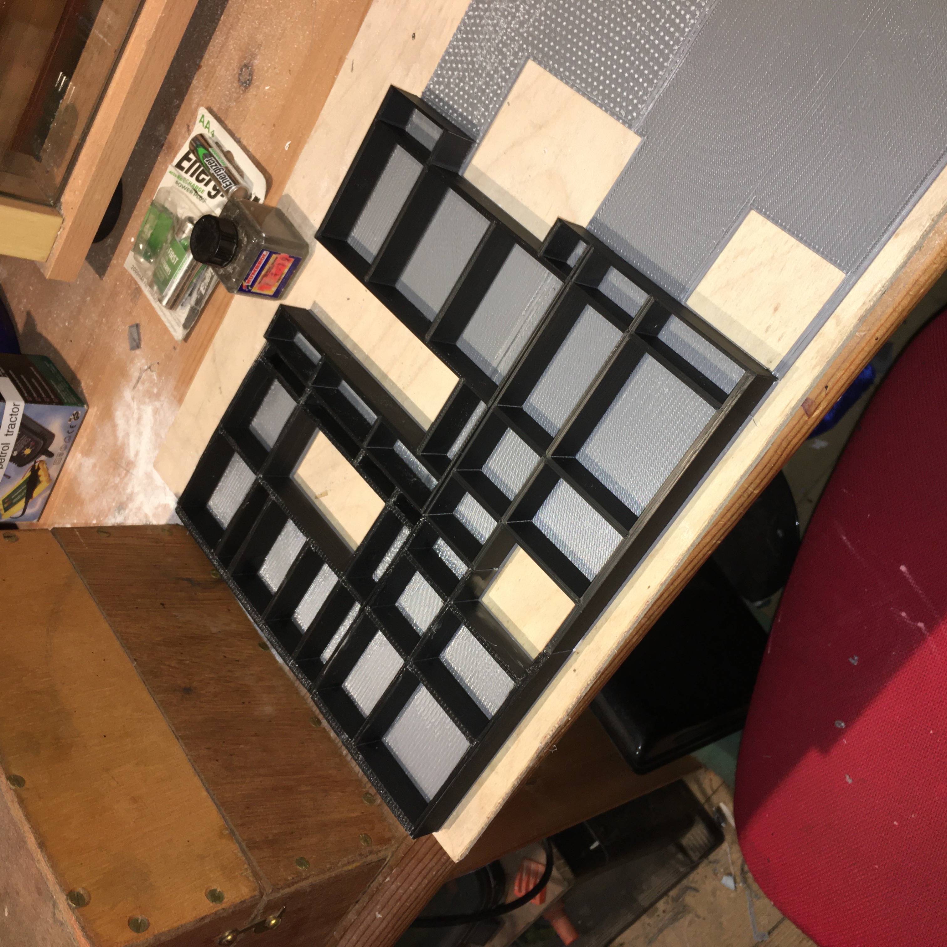

I have the facing of the front wall printed:
and I am currently working my way through the framework and adding it to the facing of the wall:

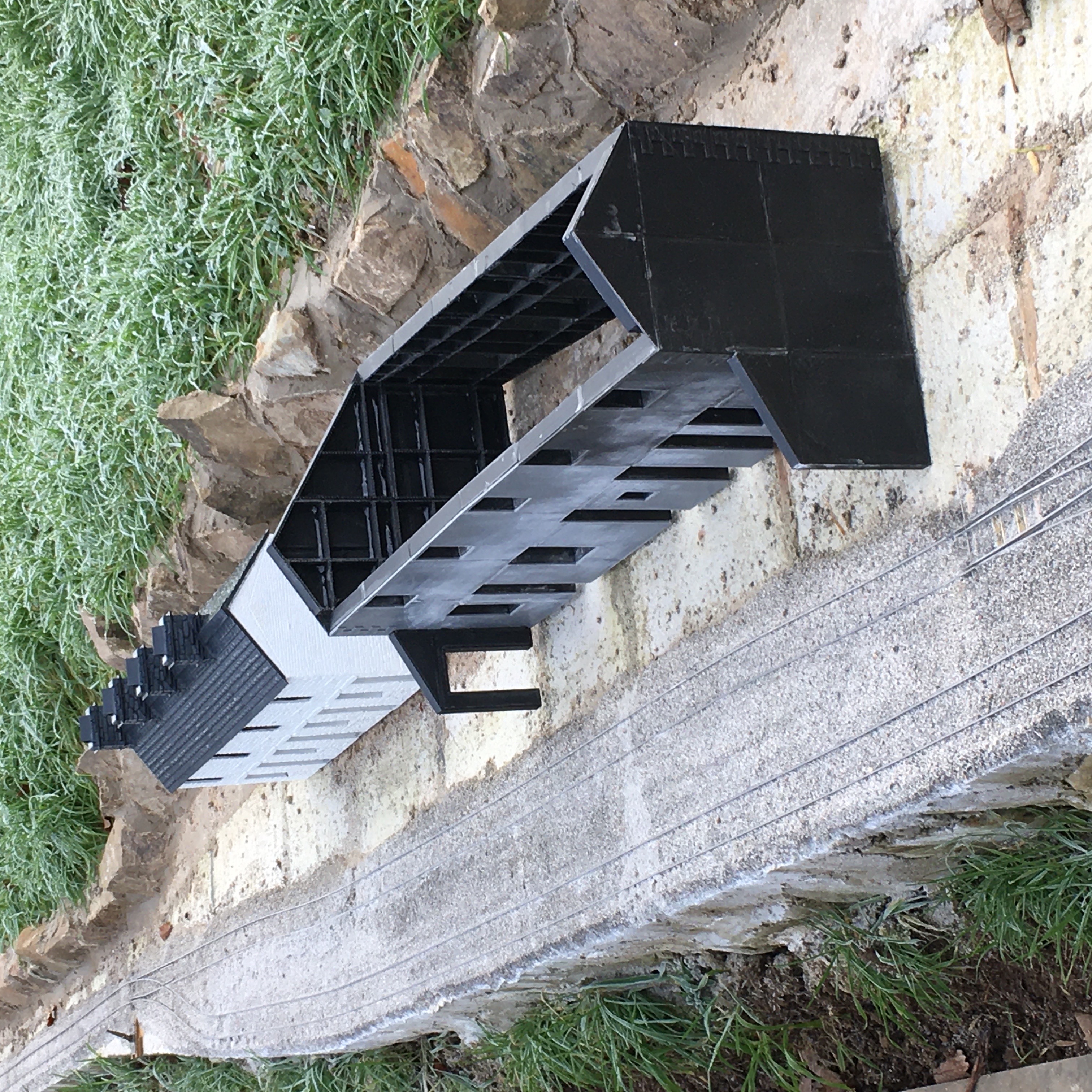

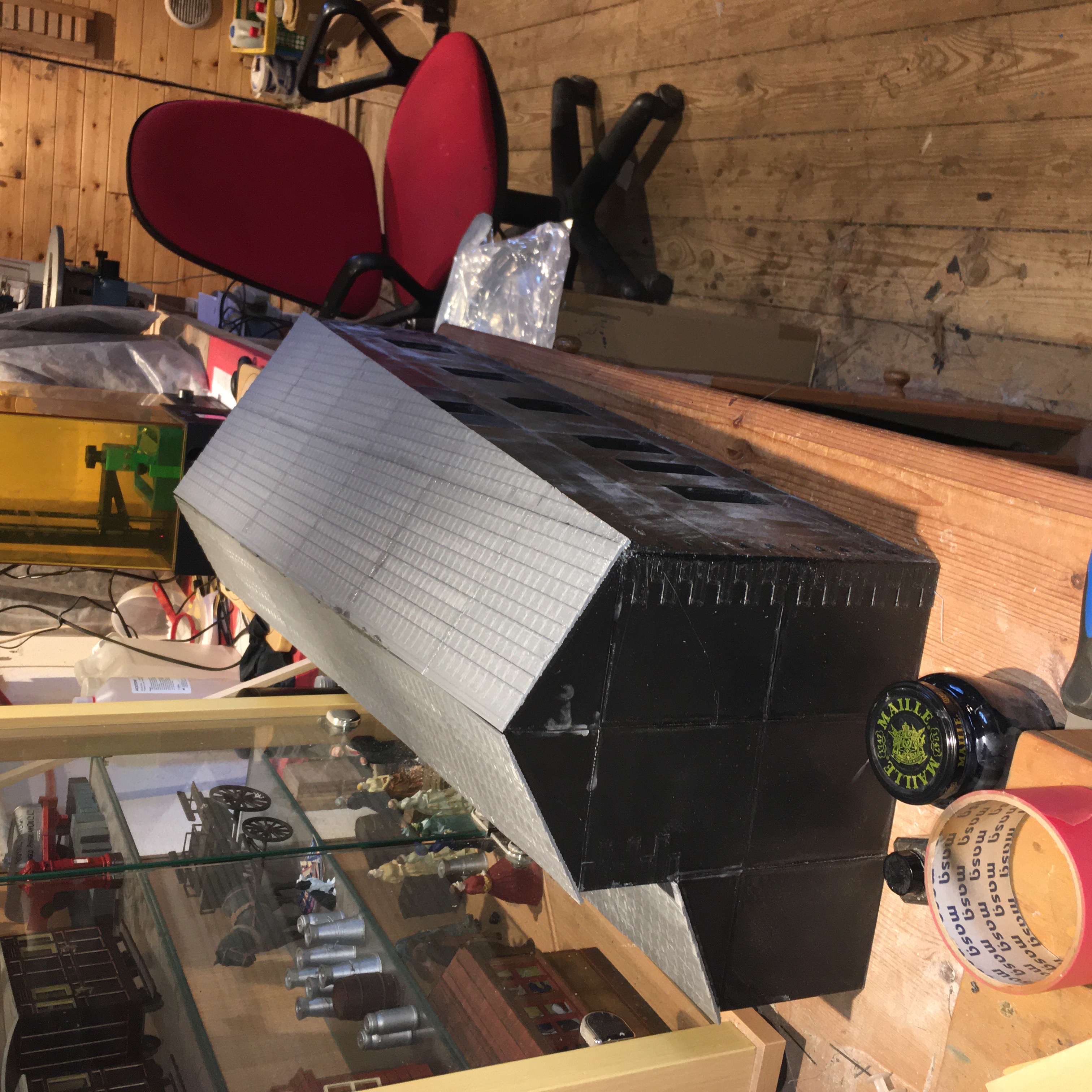

The station building progresses:
That is the front and first end printed and assembled. I'm currently printing the second end. The face consists of 6 pieces, each taking about 5 hours to print, and the frame behind it is 4 pieces, each taking about 7 hours to print.

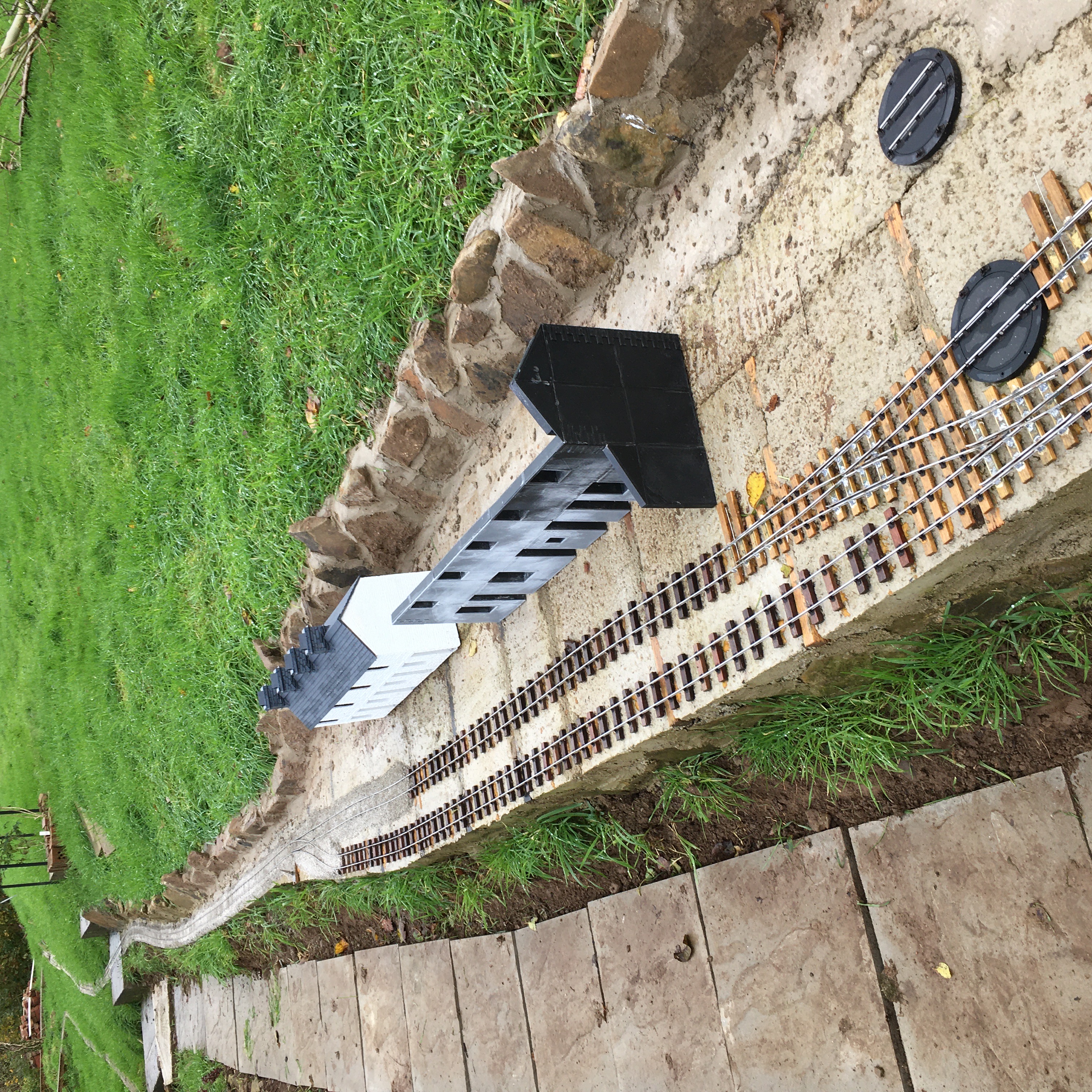

And to give you some idea of where it will fit:
That of course is the row of cottages in the background.

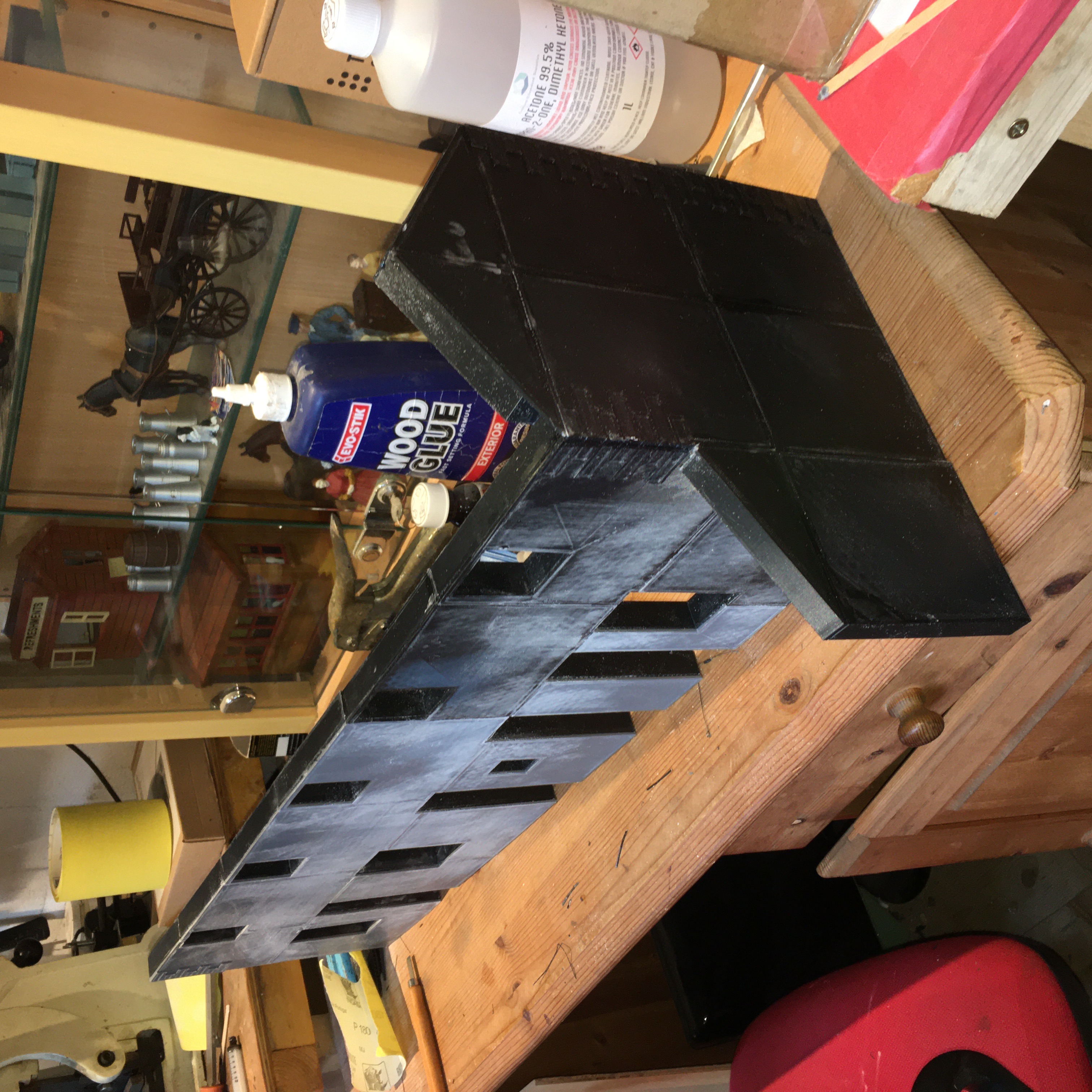

There are four sides printed now and this is what it looks like roughly where it will go:
- Posts: 7901
Re: Tan-y-Grisiau Station Building
Interesting that the back isn't parallel with the front. Is that based on the real cottages?

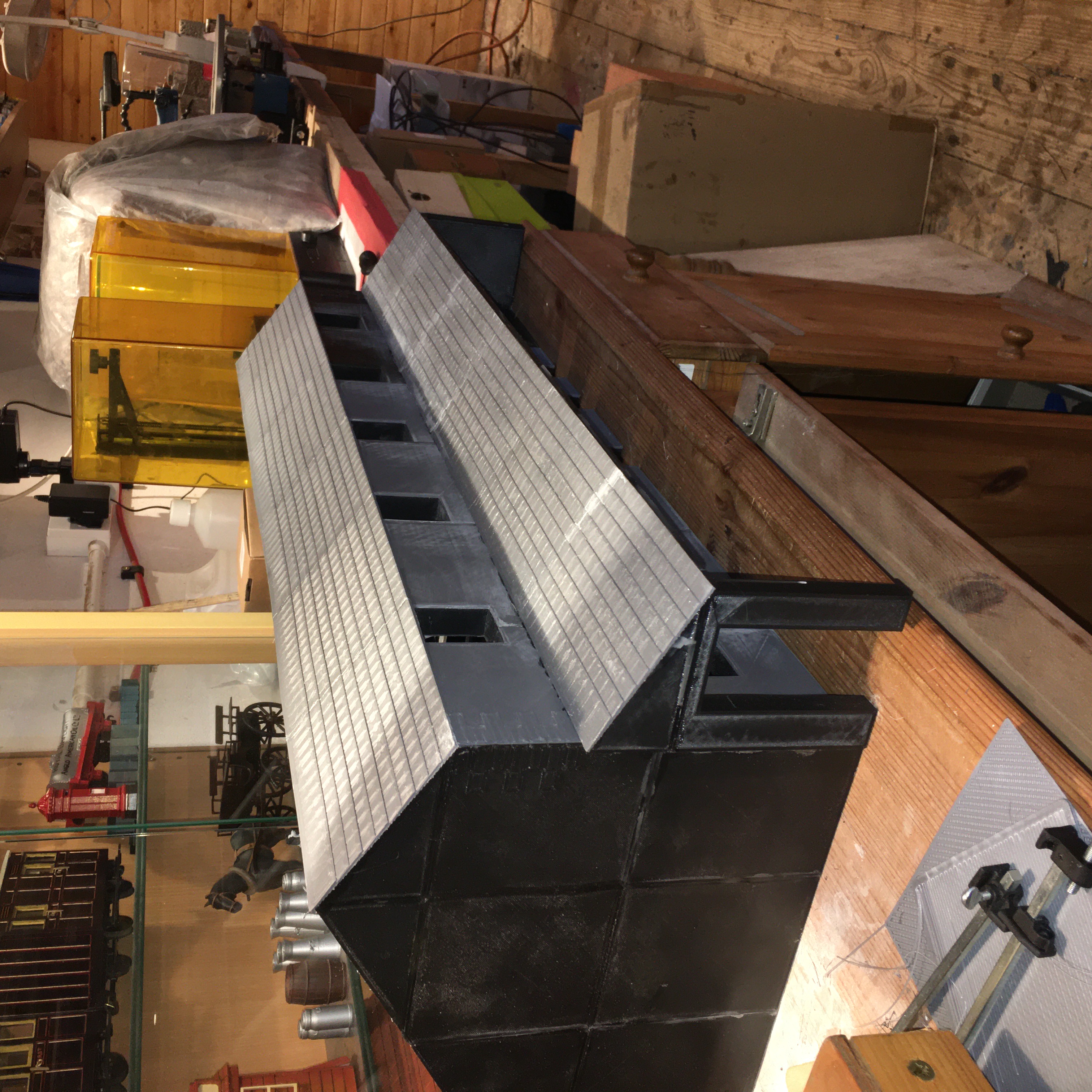

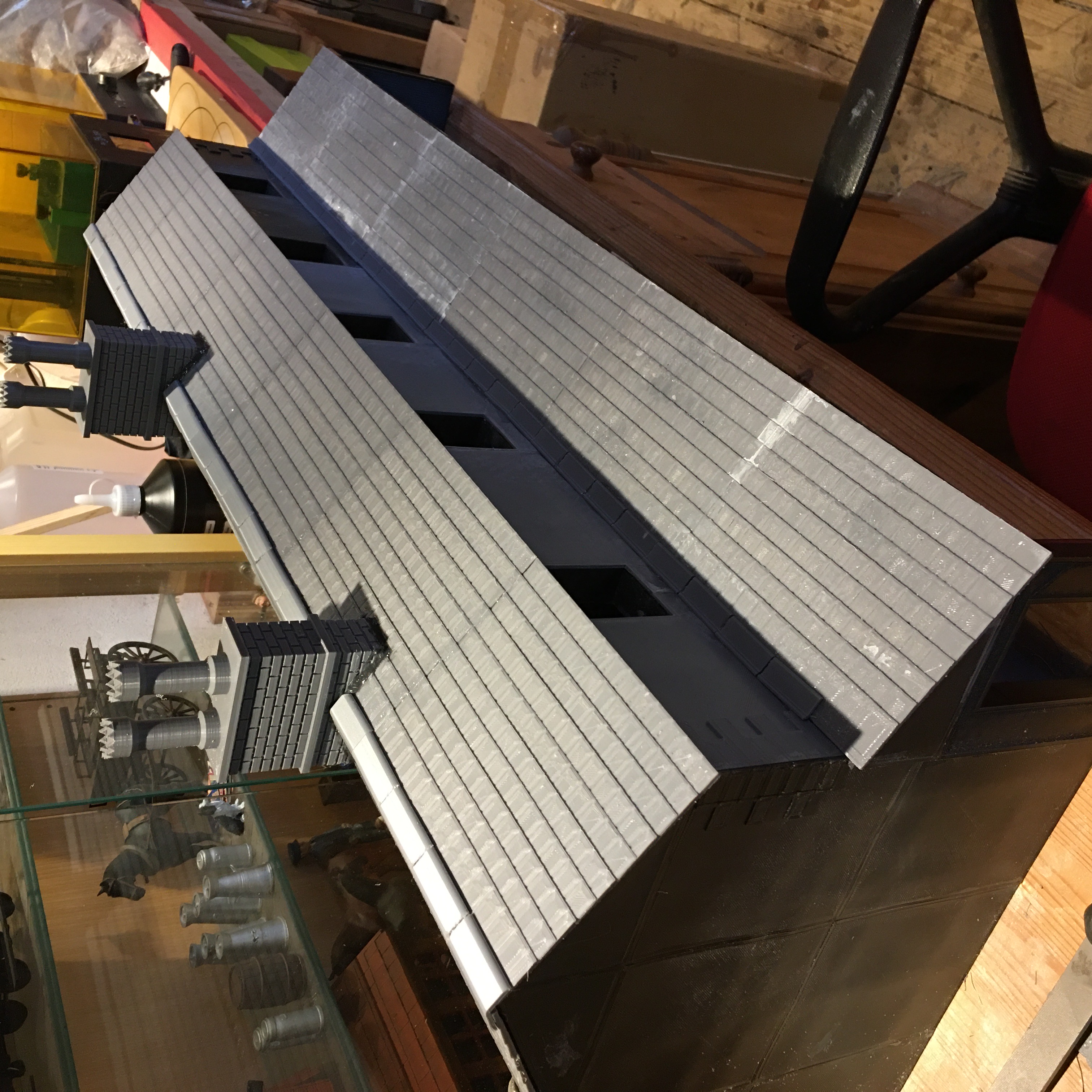

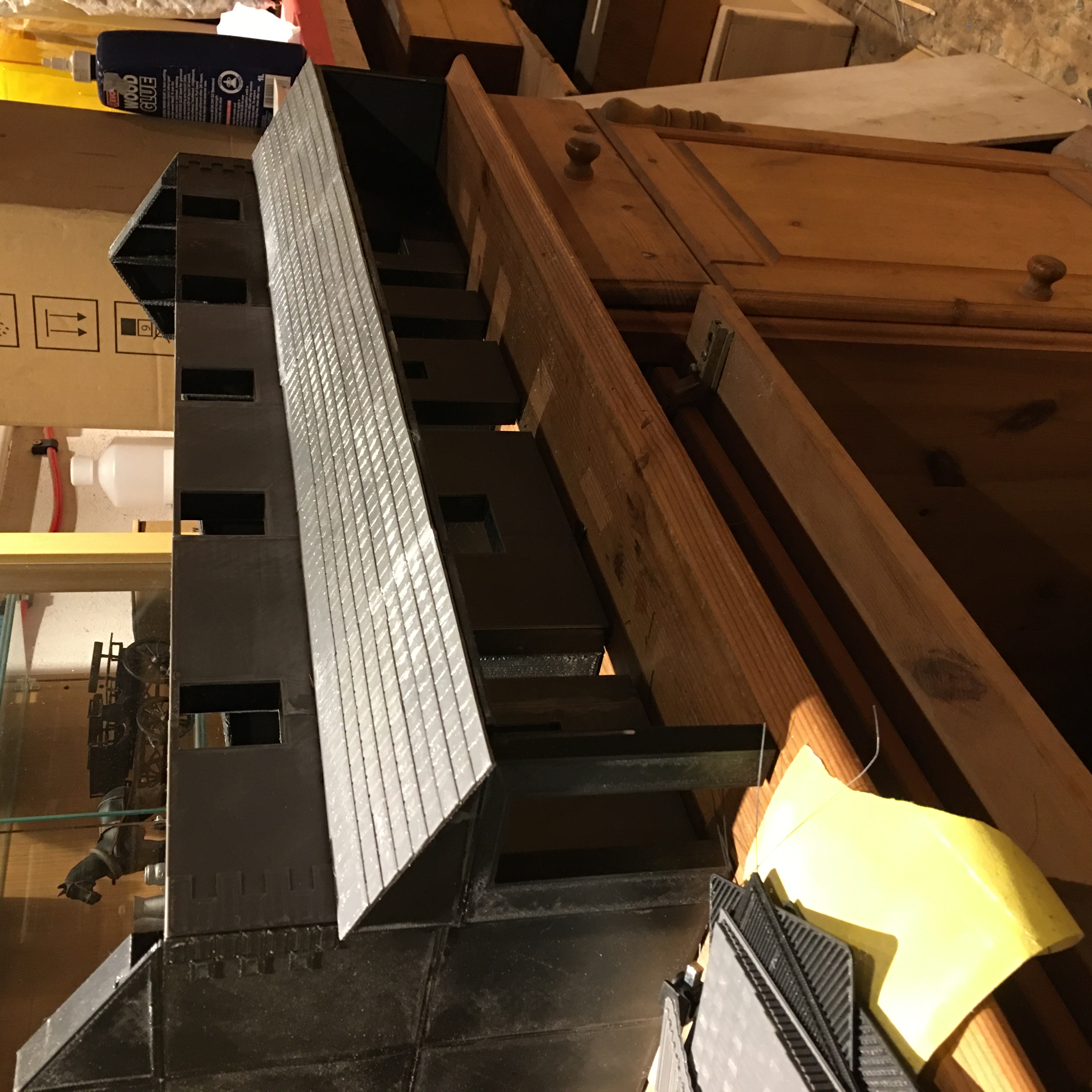

All the roof sections are printed and assembled:
The chimneys are currently printing.
I should be painting it tomorrow!

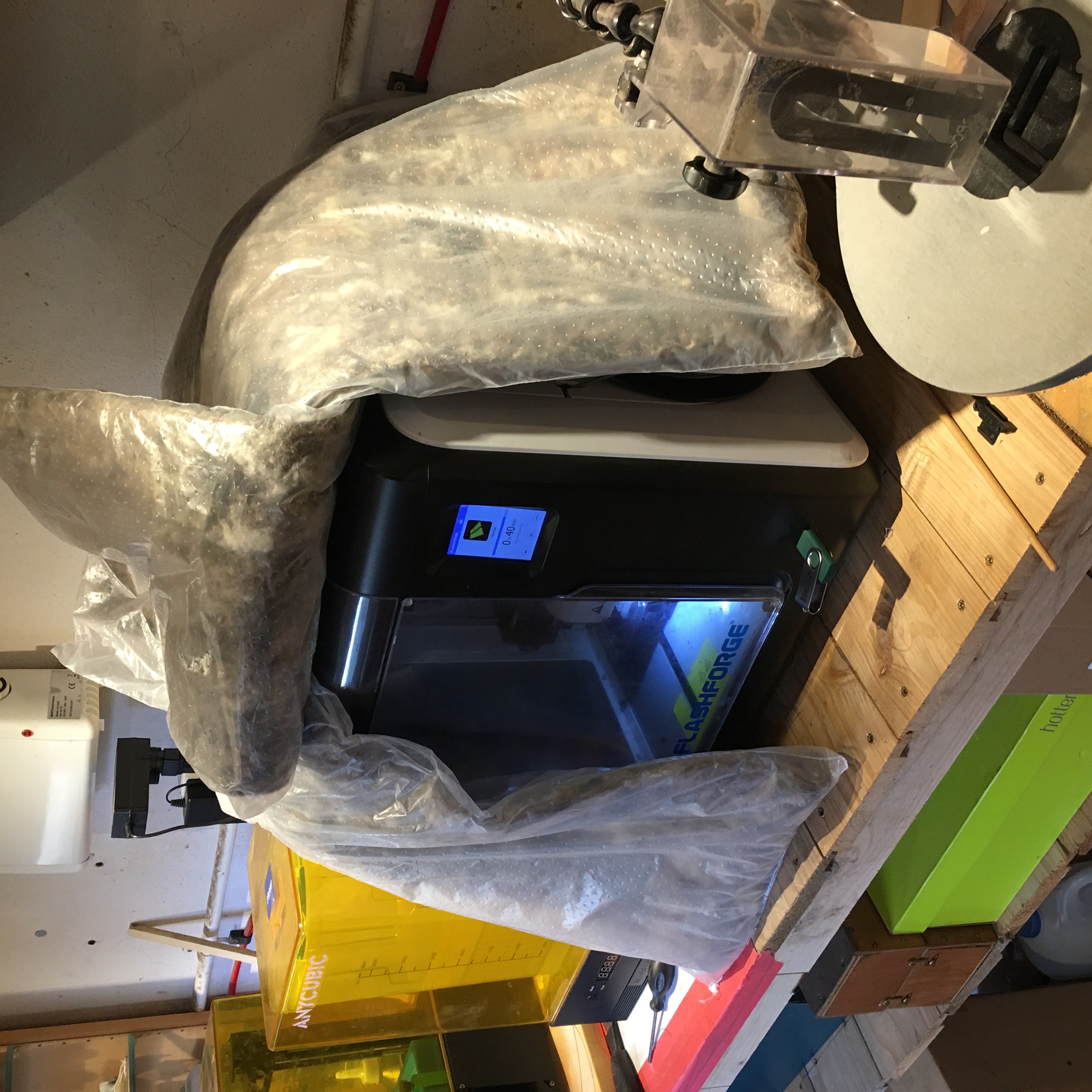

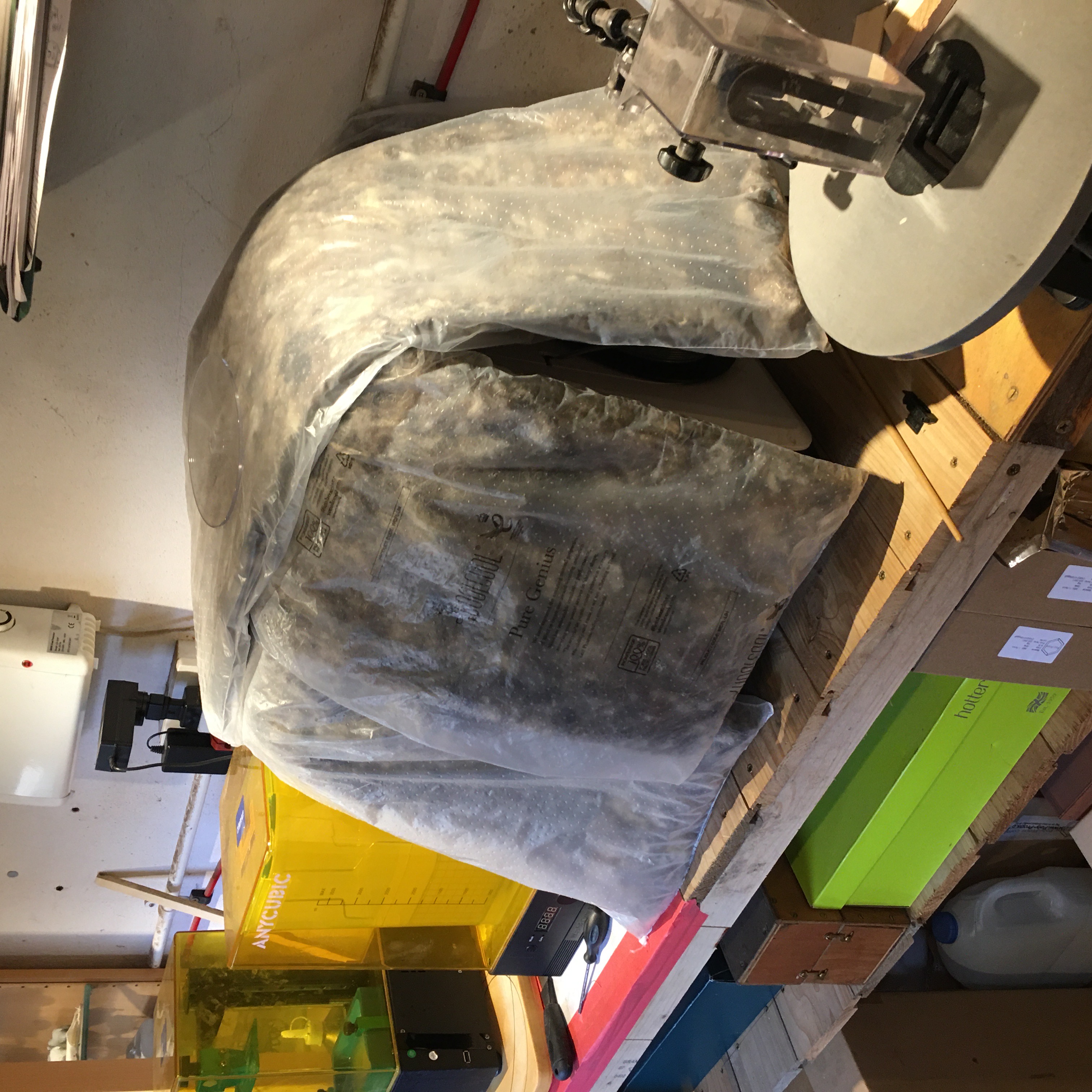

As an aside I should say something about the printing of the chimneys. As you will know by now I work exclusively in ABS - and I am getting perfect distortion free prints - every time. I now understand the cause of the distortion I was suffering - it was caused by the print cooling too quickly. I now have a thick layer of wool insulation enclosing the printer cabinet - and the distortion has gone away - even in UK winter conditions. The chimneys were an 18 hour overnight print run when the outside temperature was -3C, in a workshop which was unheated apart from the woodburner which ran out of wood at 1800!
And I have started the painting.

Wow! That's quite a build, look forward to seeing the pictures when it's fitted in place. I'm thinking of having another go with ABS (after several years avoiding it) to print out one of the quarry workers cottages later this year - I'll bear in mind your comment about the print cooling too quickly
- Posts: 1176
- Location: South West Wales
I can understand you avoiding ABS. I have wondered again and again if I was being stupid persevering with it. There have been a number of times when I thought I had the distortion issues sorted only to find that I hadn't really.
This time I am convinced I have actually got it fixed. For example the chimneys are perfect, and the ridge tiles which were printed on edge have really smooth surfaces.
A photo of the insulation around the printer to show you just what I have done.
1inch of wool allround and 2 inches on the top. And one part raised so you can see what is underneath:
