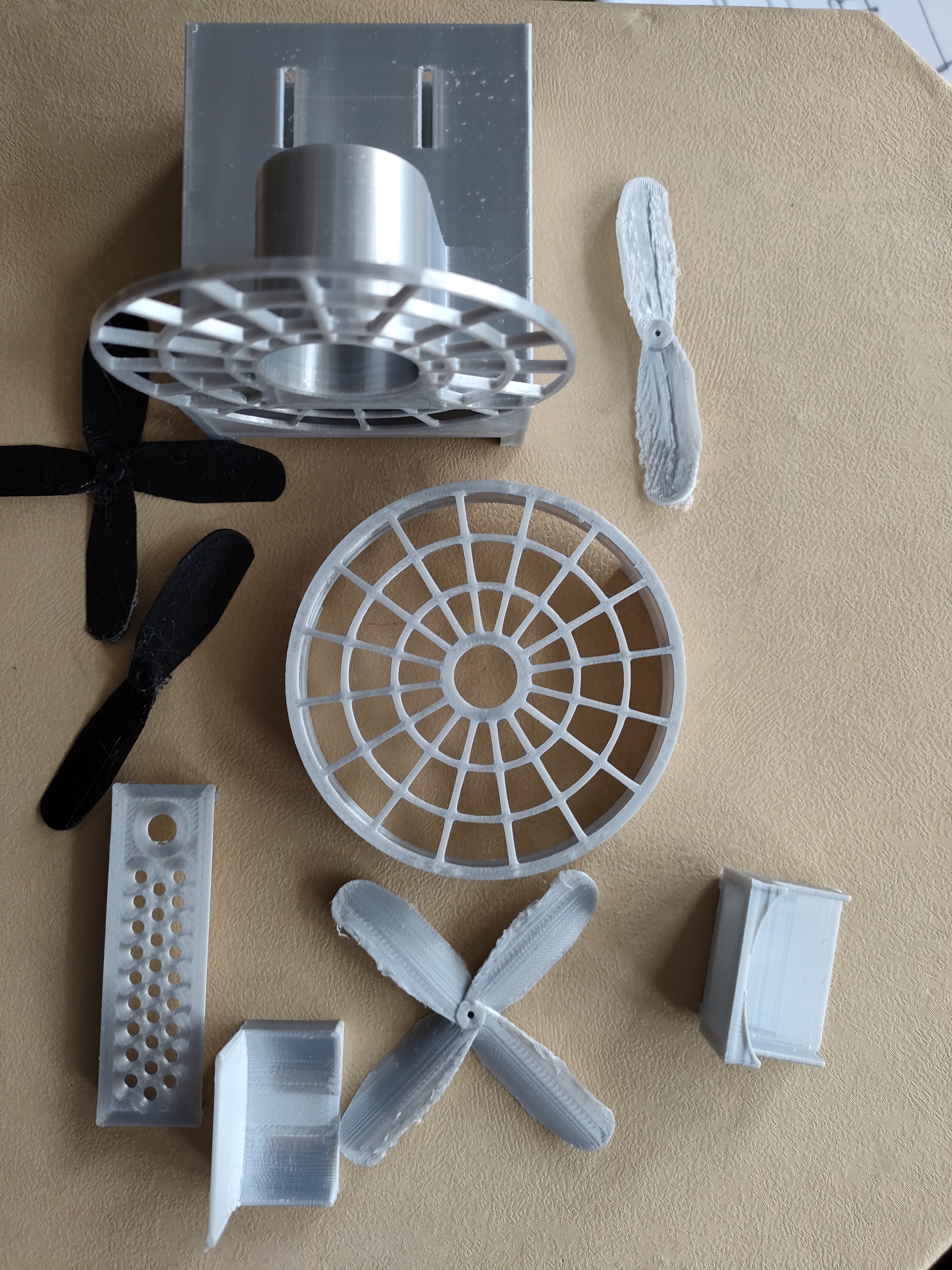

New propellers now finished, they are way better than the original set printed.
I will post up a picture of all printed items up soon.

Re: Summertime, and your printer's seem idle?
Ready to be boxed and sent.

Those black propellers look very good. How did you get them to print so cleanly? I tried using supports but mine turned out like your grey ones

Yes, I agree. I did look at the possibilty of volunteering when Phil first asked, but decided that the propellors would prove too difficult and kept my fingers off the keyboard.ge_rik wrote: Sat May 21, 2022 9:53 pm Those black propellers look very good. How did you get them to print so cleanly? I tried using supports but mine turned out like your grey ones

Simple, I printed it without support on the flattest side. Tends to print better with no support than a huge area of support. I think they will sand down very nicely.ge_rik wrote: Sat May 21, 2022 9:53 pm Those black propellers look very good. How did you get them to print so cleanly? I tried using supports but mine turned out like your grey ones

Many thanks for your efforts! - I did wonder if a propeller / fan would be awkward to print..
Quite a complex shape to draw.
Having messed with model planes, in a previous life, It will be interesting to see the result.
Thank you again! - Now all I will need to do, is finish them.
