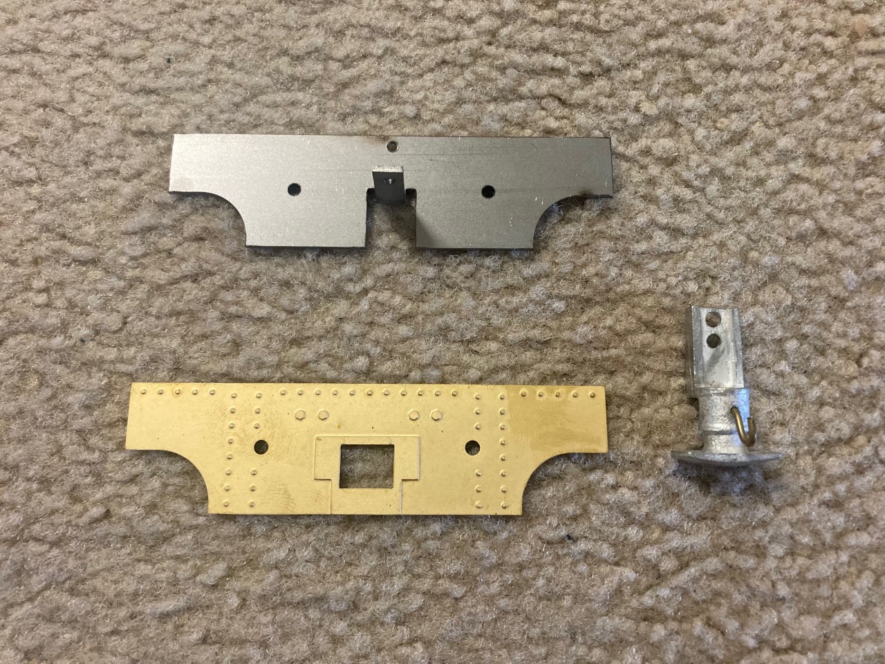

One of the first things I wanted to do was to check the buffer mounting style, as I'm considering a SwiftSixteen coupling and I wasn't sure which one would fit.
It looks like this is the one to go for (although I'm sure the others would work too) https://www.swiftsixteen.co.uk/product- ... e-coupling
That said, it looks easy to add this at a later date and the Roundhouse buffers look fine.
I'm also considering switching some of the M3 chassis/buffer beam bolts to ones with hex heads, so I measured up the brass slotted ones in the kit and they have about 5mm long threads. It looks like Roundhouse sell these as an option (and I believe that the factory locos may now have them on the buffer beams as standard), otherwise I will look for some online.

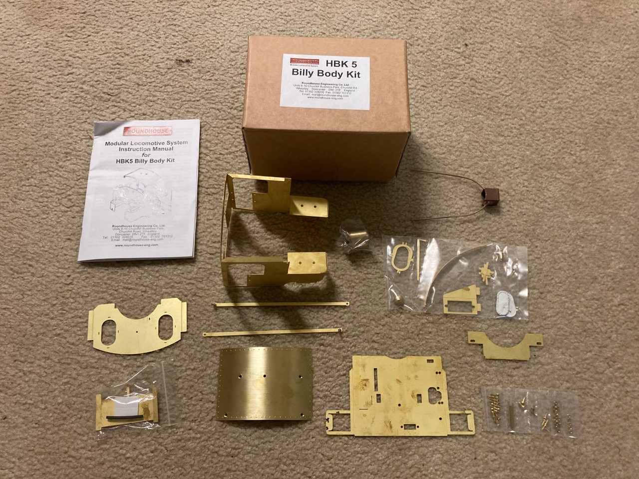

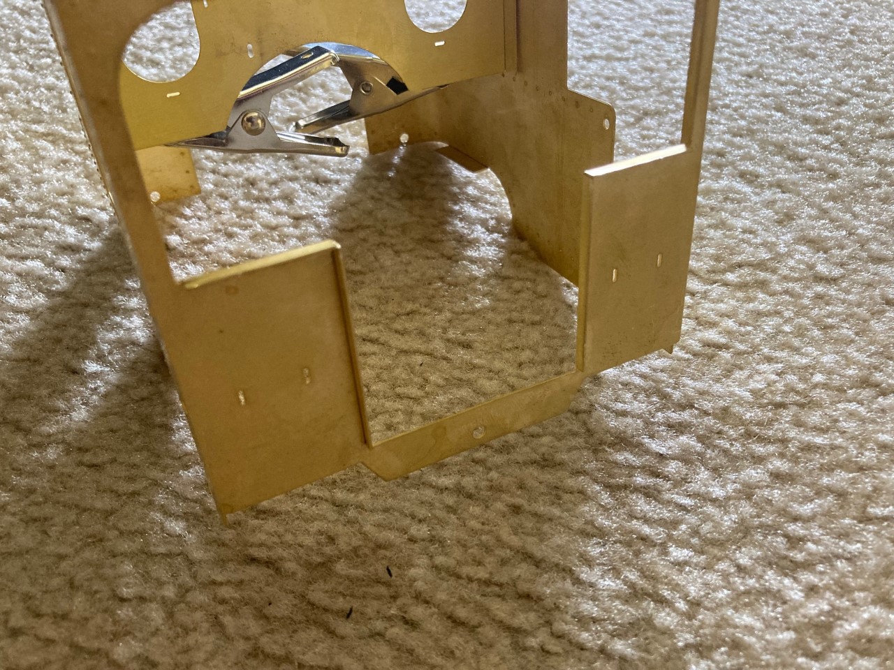

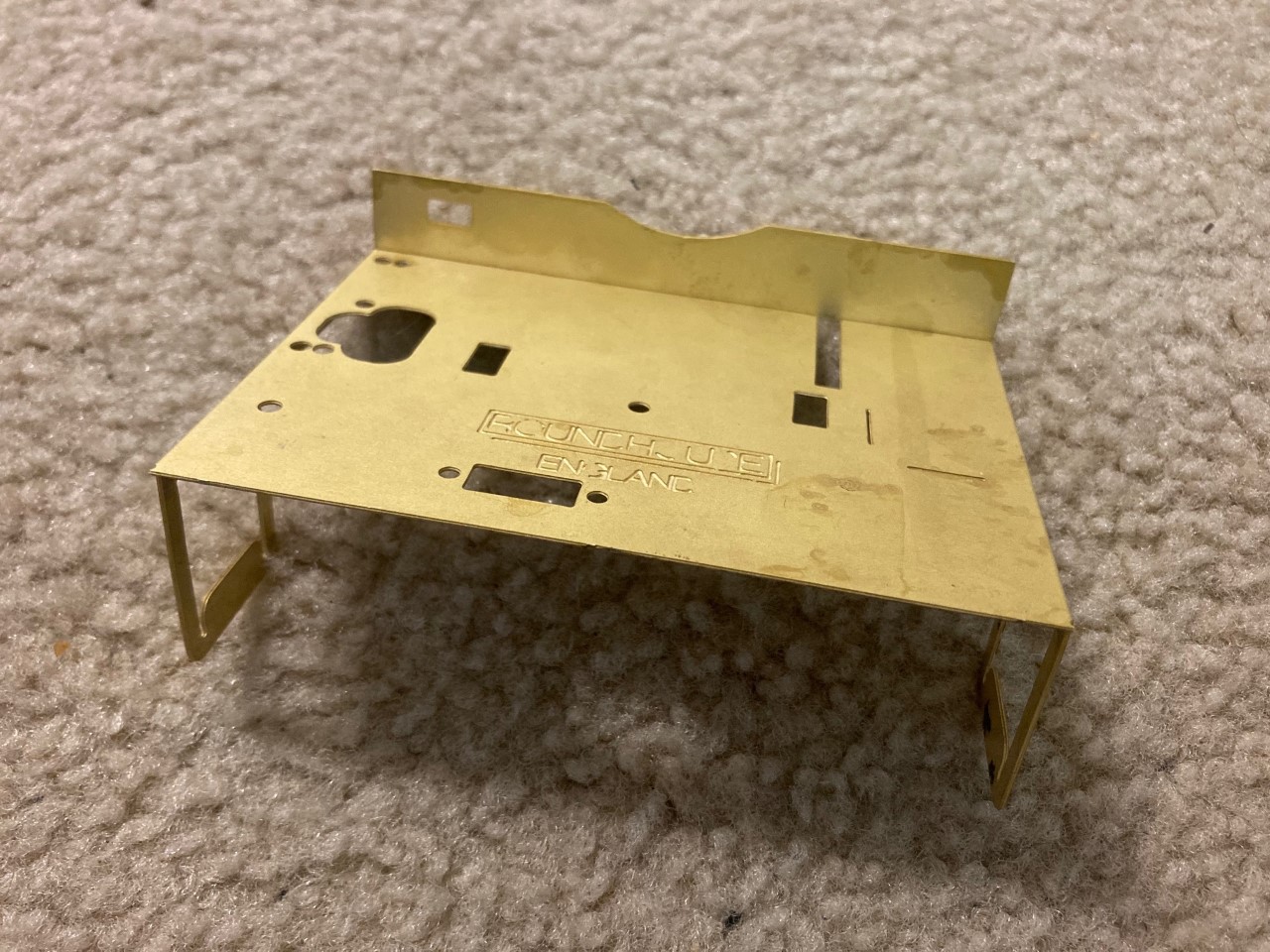

Whilst I am waiting, I have opened the body kit box. I am quite impressed that most of the difficult bending of the main part of the body has already been done by Roundhouse. It also has some rivet detail. I read somewhere that the dummy roof vent wasn't included in Billy kits but mine has it, however, it is designed to be stuck on with double-sided tape so I might look at something else instead.
I had my first go at bending the body floor and it was a disaster. I don't have all of my workshop tools here so was trying to make do with what I had. I thought it might be ruined but a few bashes with a hammer appears to have straightened it all out. :o The 'steps' are extremely weak and bendy though; I'm going to add some step detail, not just for cosmetics but also because I know I will accidentally snap them off pretty quickly if I leave them as they are.

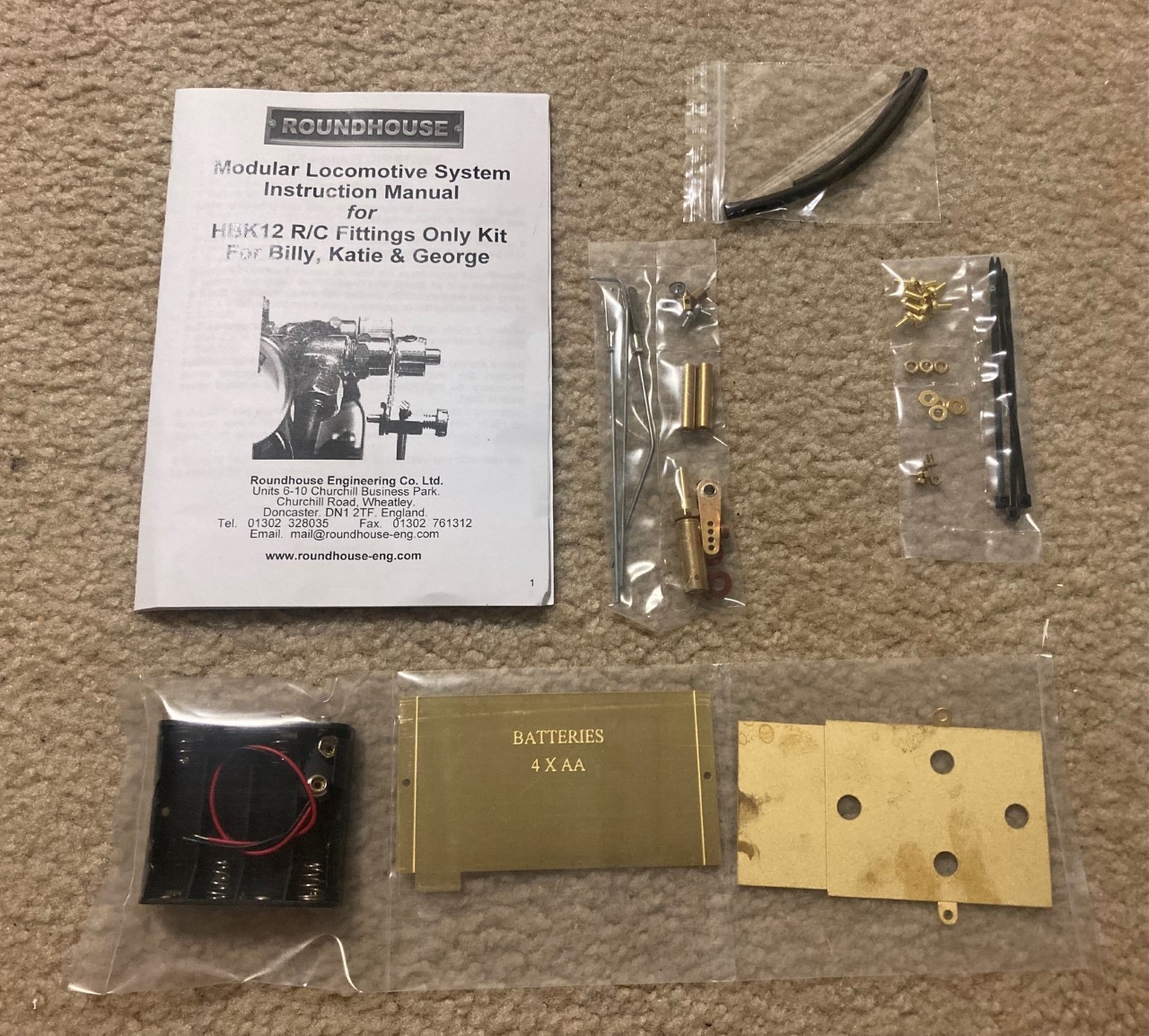

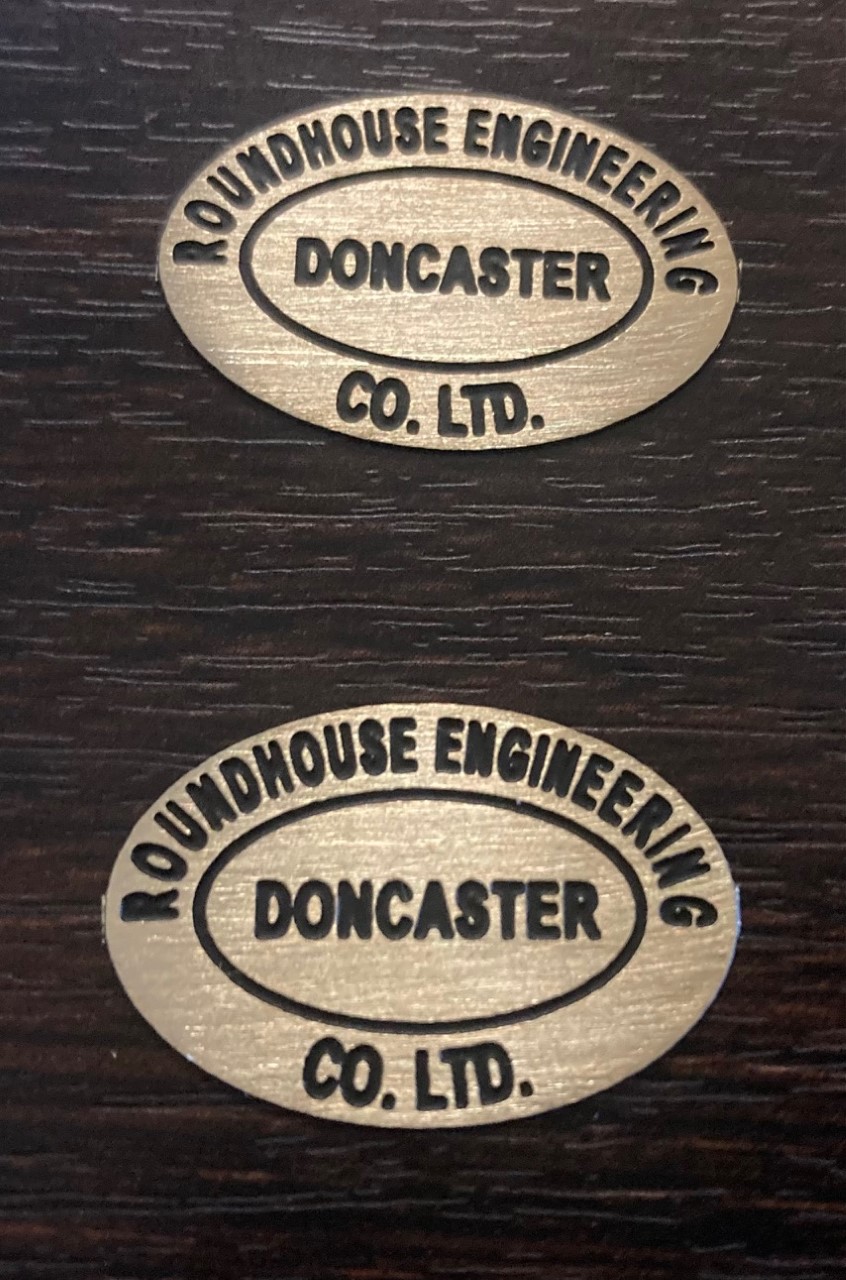

Next is the RC kit. There are some things in here that I probably won't use (e.g. the plastic battery box). It's a tiny bit pricey (£46.50 incl UK Vat at the time of writing) but removing the manual regulator from the kit took £28.65 off that, so it works out quite reasonable.
One of the first disappointments was the Works Plates. I had intended to paint them but the lettering is engraved, so I don't know how I can do that. They were about £3 each so I could probably have got something better elsewhere for similar money. I might still use them but I will probably need to shoot some clear over them first (which I haven't ordered). The only other slight disappointment, when spending that much money for a kit, was the fact that they didn't throw in a catalogue. I think a catalogue and the Works Plates should have been included, however, I will buy a catalogue when I place my next order.

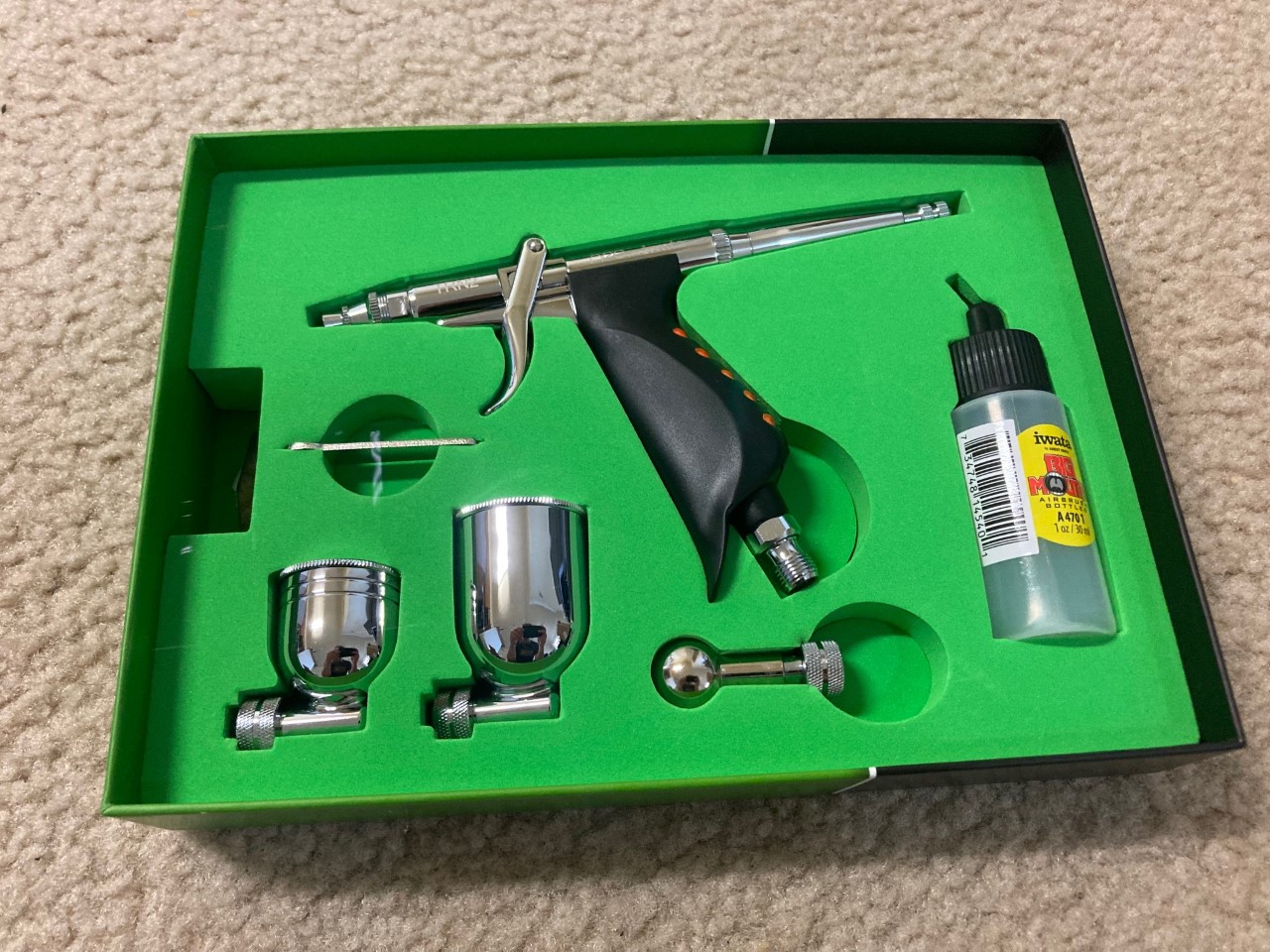

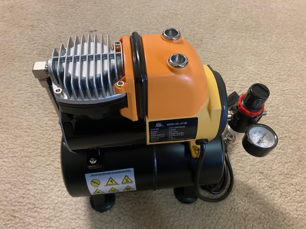

The airbrush equipment has arrived.
As I am only temporarily living in the US, I am trying to minimise the amount of electrical equipment I buy (as a lot of it doesn't work in the UK). I considered using cans of propellant for the airbrush but then came across this on ebay. It looks similar to others that are available from the big brand names but was only $70 (which is less than the cost of about 6 cans of propellant) so I took a chance on it. It also comes with an airbrush (which I am not going to use but will be handy for blowing off dust/drying etc). I'm really impressed with it for the price.
I spent a bit more on the airbrush. In the end I went with the Iwata Neo TRN2 trigger brush. As expected with Iwata, it feels pretty good quality.

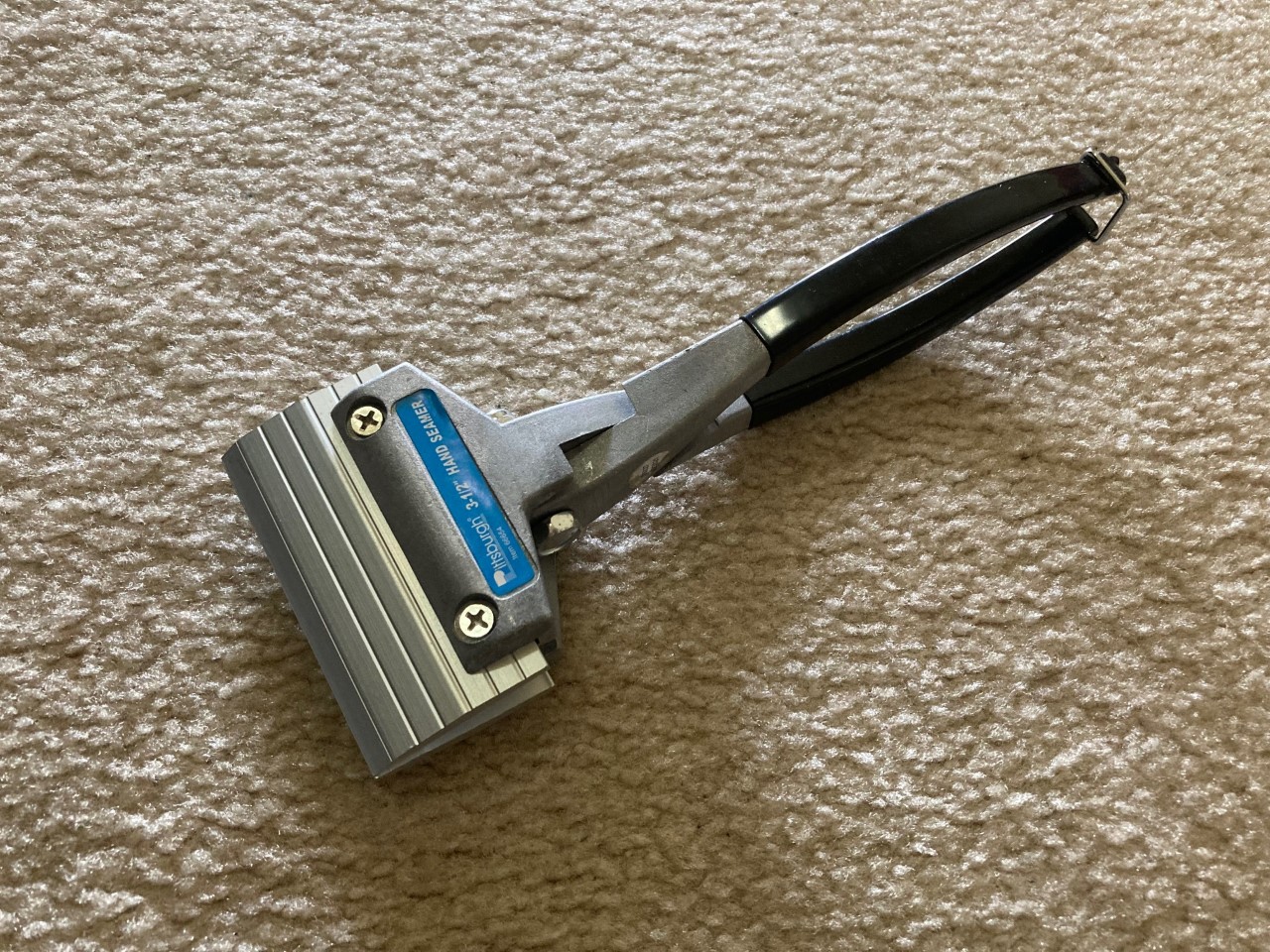

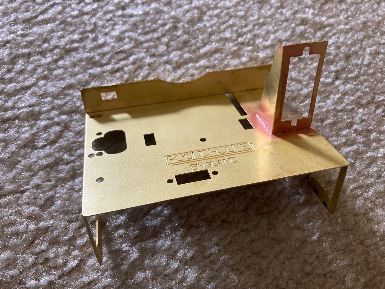

My first attempts at bending the metal parts proved a bit difficult. I looked at the tiny bends in the back of the body and wasn't sure how I would make a neat job of these. I looked around for options and found this hand seamer at Harbor Freight for $11. This is a bit big but it made light work of the bends and something like this makes the bodywork much easier.
I also had my first go at soldering, using Stay-Brite solder and a small butane/propane soldering torch. I'm quite happy with the result.

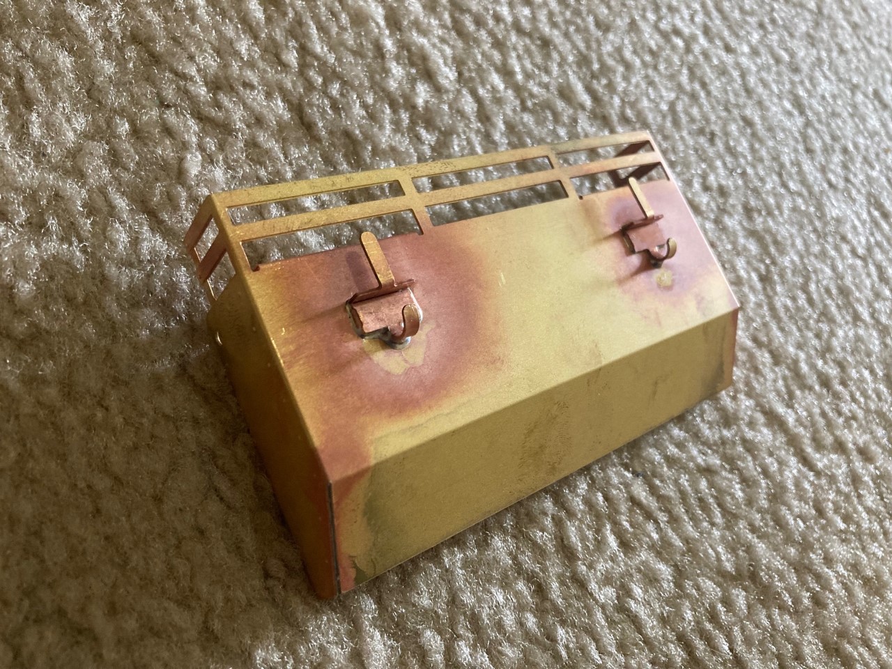

Optional coal bunker folder and soldered. Not my best effort but it will do.

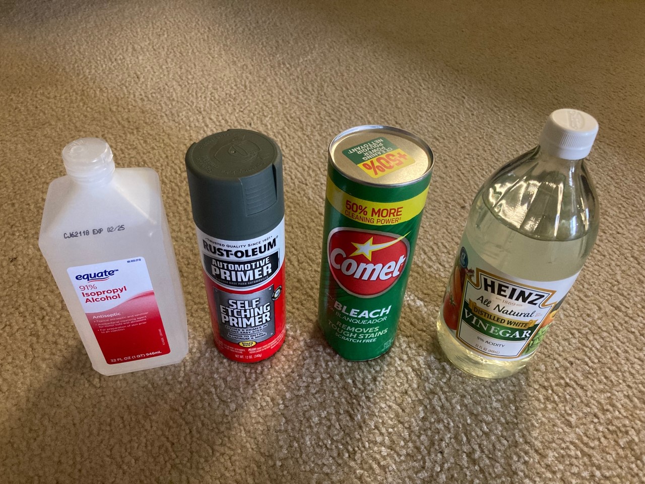

I have ordered the Scalecoat 1 paints. Searching the internet for ideas on surface prep suggests that there wasn't a Scalecoat primer, but there is now and I have bought some. However, it doesn't specifically mention that it is an 'etch' primer so I bought a spray can from Walmart today.
I have also bought a load of stuff shown in the photo below. How would you prep the brass before painting with Scalecoat 1? Would you use the etch primer can, Scalecoat primer, or no primer? Would you do the vinegar soak, clean with Isopropyl alcohol or Comet (and is that the correct Comet that I have bought)?

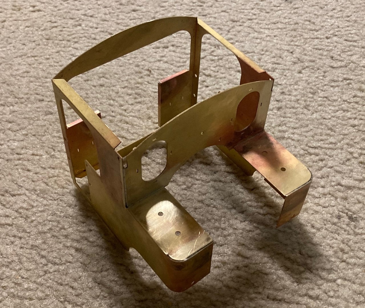

Body soldered and initial clean-up complete.
Not perfect but I'm quite happy with it. :D

siclick33 wrote: Sat Apr 16, 2022 11:59 pm I have also bought a load of stuff shown in the photo below. How would you prep the brass before painting with Scalecoat 1? Would you use the etch primer can, Scalecoat primer, or no primer? Would you do the vinegar soak, clean with Isopropyl alcohol or Comet (and is that the correct Comet that I have bought)?
No idea what 'Comet' is, but the label says bleach, which isn't what you need.
I haven't used Scalecoat for at least 4 decades, so no idea what it is like these days. Back then it was a lacquer similar to Floquil........
Anyway, my procedure for painting brass parts is as follows :-
- As soon as parts are soldered, I give them a good scrub with an old toothbrush and Ajax Creme Cleanser. The brand doesn't matter, but creme cleanser has a mild abrasive, as well as a detergent in the formula, so it neutralises flux residues and also cleans off oils, greases and surface corrosion. Parts built up from many parts should be cleaned after each soldering session. If you don't get all the flux removed, it will continue to cause corrosion under the paint.
- I use a local brand of etch primer, black where the loco will be all over black, grey on parts where it will be green, red, etc.
- I use Revell enamels and a local brand of spraying enamel for the top coat on my models. Roundhouse told me they use two pack acrylic lacquer (car paint) on their factory built models.
The water based acrylic paints sold in hobby shops are not heat resistant and using them on locos will only lead to tears and bad language. In the case of Scalecoat1, I'd suggest doing some tests before committing to it on a live steam model.
You need a paint that won't soften, or change colour, when exposed to heat. The smokebox of a gas fired loco can get up to temperatures over 150degC, the boiler temp at 40psi is 140degC. and cylinders will be over 100degC. Some people use 'pot belly black' stove paint on smokeboxes, although I find it a bit shiny and far too black for my taste. A good quality enamel paint can usually tolerate the temperatures found in our size of live steam locos. The local speed shops that cater to the petrol heads have heat resistant paint for brakes, motors, etc., but the colour range is generally limited.
On a related note, I have used cheap asian compressors, but found they run hot and wear out quickly when painting large scale models. I now use a small diaphragm type workshop compressor, rated at 1hp and 40lpm free air flow, which actually cost less than the hobby grade compressor it replaced.

Thanks for your reply.
Comet is like Ajax. Ajax only appears to be available in the US in powder form and although you can get Comet in cream form, it still contains bleach. I have found a 3M creme cleanser but I have to have it shipped to me, so it works out quite expensive.
On the subject of heat and paint..... I assume that I don't paint the boiler itself? If not, does it need any form of corrosion protection? I assume I paint both sides of the boiler wrapper?
And the smoke box, do I paint the inside as well, or just the outside?
All I know about Scalecoat is that it is a solvent-based enamel. I've read that other people have used it so I hope it's ok. I'm still not sure if it will be ok on the smoke box or if I need to buy specific heat-resistant paint.
I'm thinking of trying the following for the brass parts:
1) Clean with a cream cleaner (with a toothbrush).
2) Rinse.
3) Vinegar bath.
4) Prime with the Rustoleum etch primer.
5) Top coat with Scalecoat 1.
I'll probably try some pieces first that are easy to replace in case it goes wrong (maybe the buffer beam overlays).

siclick33 wrote: Sun Apr 17, 2022 5:53 am Thanks for your reply.
2) Rinse.
3) Vinegar bath.
As an industrial chemist I'm very wary of using anything with bleach in it to clean metal, due to the chance of residual chloride initiating corrosion. I'd use Ajax powder (or any equivalent brand without bleach)...........
You are using an etch primer, so a vinegar wash won't make the primer work any better. Not all etch primers are created equal, so check that the one you are using is suitable for both brass and steel.
The boiler projects into the cab, so it is worth painting at least that part of it. Just remember to cover all the bushes to keep overspray from getting into the threads. I paint the upper part of my cab interiors cream and do the same to the backhead, any etch primer that works on brass should work on copper as well.
No point in painting the inside of the smokebox, it's a bronze casting and will be soaked in steam oil after the first run, so it won't corrode.
I paint the inside of the cleading as well as the outside. It's not strictly necessary, but it prevents any corrosion if water gets trapped in there while filling the boiler, or from condensate dribbling down from the safety valve.
Test pieces are always a good idea when painting with something you aren't sure about. A metal part can easily have the paint stripped off without damage to try something else, if the first attempt doesn't work out. It doesn't have to be a model part, but best to be the metal in question when testing for paint adhesion.

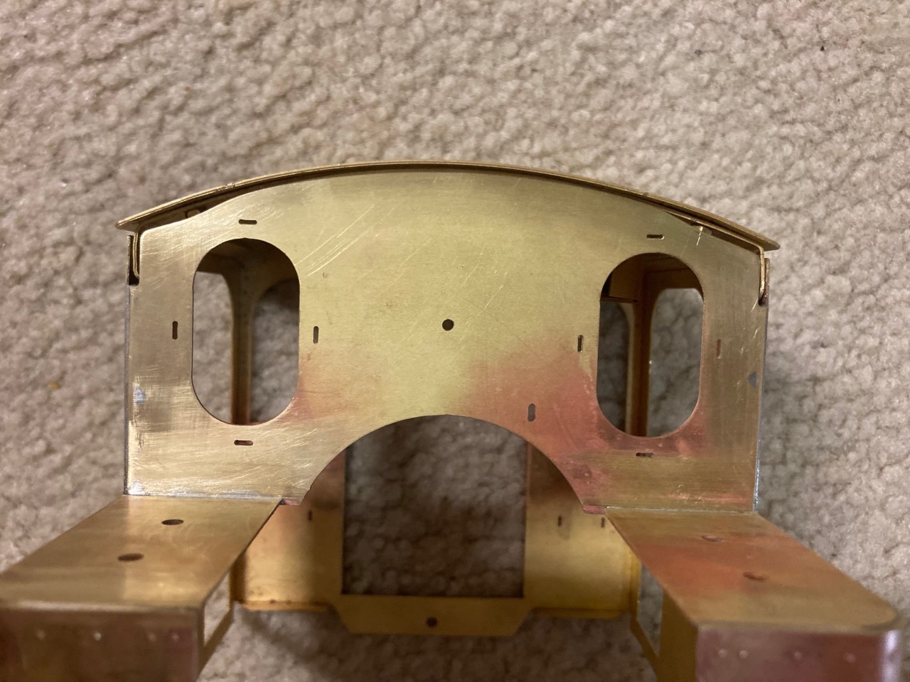

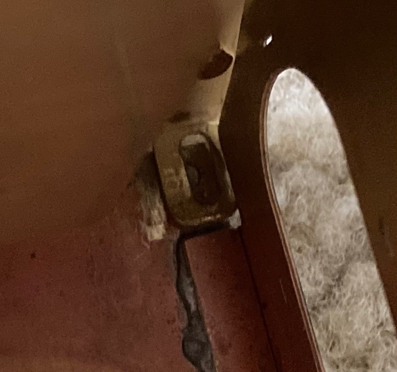

First problem has come, with the roof.
The instructions say that the roof 'hinges' are slotted to be able to adjust the roof and to 'tighten when correctly positioned'. I put it all together and there was no way that this was going to work. After a few adjustments I realised that the bottom of the hinges was hitting the flanges on the inside of the body, so I bent the hinges to allow the roof to drop some more. However, now the roof wouldn't open without the nuts that hold the canopy hinges on, hitting the front part of the body (where the windows are) when you open it. I ended up grinding away some of the metal from the front of the cab, and now it all works. There is no way that these retaining bolts can be 'tightened'' and I subsequently found another part of the instructions that mentions that they need to be loose :x If you don't go through all of this hassle then the roof sits quite high, as shown on a photo I found on the internet.
If I was to do this again, I would try to leave the end of the hinges flat, and grind away some of the flange from the inside so the roof can sit lower. I might grind these flanges away a bit anyway, so that I can replace the roof strap later.
The other concern I had was that the battery box looks odd, when installed, when viewing from the rear. I thought I had made a mistake but, looking at the Roundhouse factory photos, this is correct.
I'm sure there is room for improvement on the kit here; at the very least the instructions are a bit of a mess.

I certainly hope this doesn't sound rude, but I think you need to perhaps slow down a little and think things through a little more carefully before doing things you can't undo, such as grinding down the spectacle plate of your cab. There is no way this should have been necessary. I built this kit, as did many others present, and I found the instructions to be excellent: much better than any other kit I have ever built. Furthermore, I found every part fit perfectly. This is Roundhouse's well-deserved reputation.
The holes in the cab roof bracket/hinge are oval because the roof is meant to be lifted before hinging forward. This would have allowed the nuts on the bottom of the cab to clear the front. The second picture, of the red "Billy" shows the roof pulled up prior to being tilted forward. It should be possible to push it down so it sits correctly. It's not meant to hinge forward without being pulled up first.

Again, you did a great job soldering the cab. But I think you could benefit from slowing down, reading the instructions several times, dry-fit everything, and if it doesn't fit, ask for help or think some more before taking a grinder to it. When you get to the part where you have to assemble the valve-gear, it will be imperative that you understand exactly what you are doing before you do it.

Quote from the instructions:
'The hinge has slotted holes to allow for adjustment of the roof position. After tightening into position, file away any excess thread'.
Only 2 pages later (in the section about the tank support) does it say, 'the nuts on the inside should be left slightly loose to allow the hinge to operate'.
So it is tight, or is it loose? Nowhere does it say that the roof should be lifted to open; a hinge operating is just rotating, not lifting! Maybe we have different ideas on what constitute excellent instructions; these aren't too bad but they aren't fully comprehensive (there aren't many diagrams showing where things should go) and they jump about all over the place. In any case, I am mainly posting here to show others where the unclear areas are; this is certainly one of them.
I did work all that out through trial and error, but there was still no way that the nuts that hold the roof hinge strap would clear the front panel when opened. I couldn't even push the roof down as the ends of the hinge strap was getting stuck on the inside flanges of the cab front. I have an engineering background; none of this was caused by rushing!
EDITED TO ADD: I've re-read the instructions and it is clearer now, but I still think it could have been explained better. The initial 'tightening' refers to the hinge strap on the roof. The 'should be left slightly loose' refers to the hinge where it meets the cab body. That still wouldn't have helped in my situation though, due to the interaction with the flange that I mentioned earlier.
It looks ok but I think it might annoy me now, so I might de-solder it all and replace the cab front with a new one. If I put some extra washers in between the hinge and the cab then I might be able to push the hinge bracket far enough away from the sides that it clears the flange.
