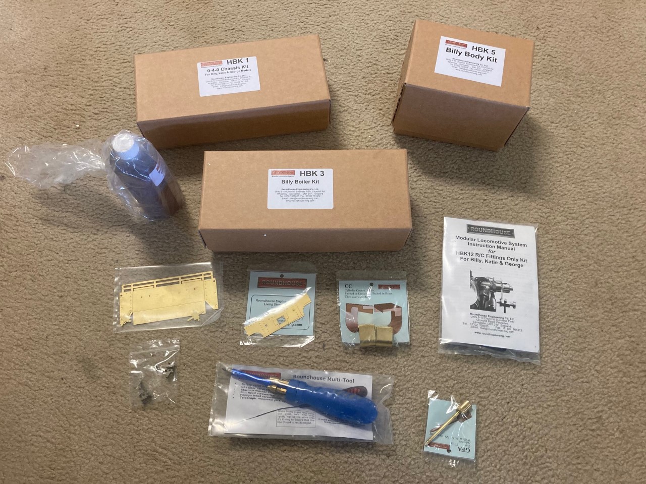

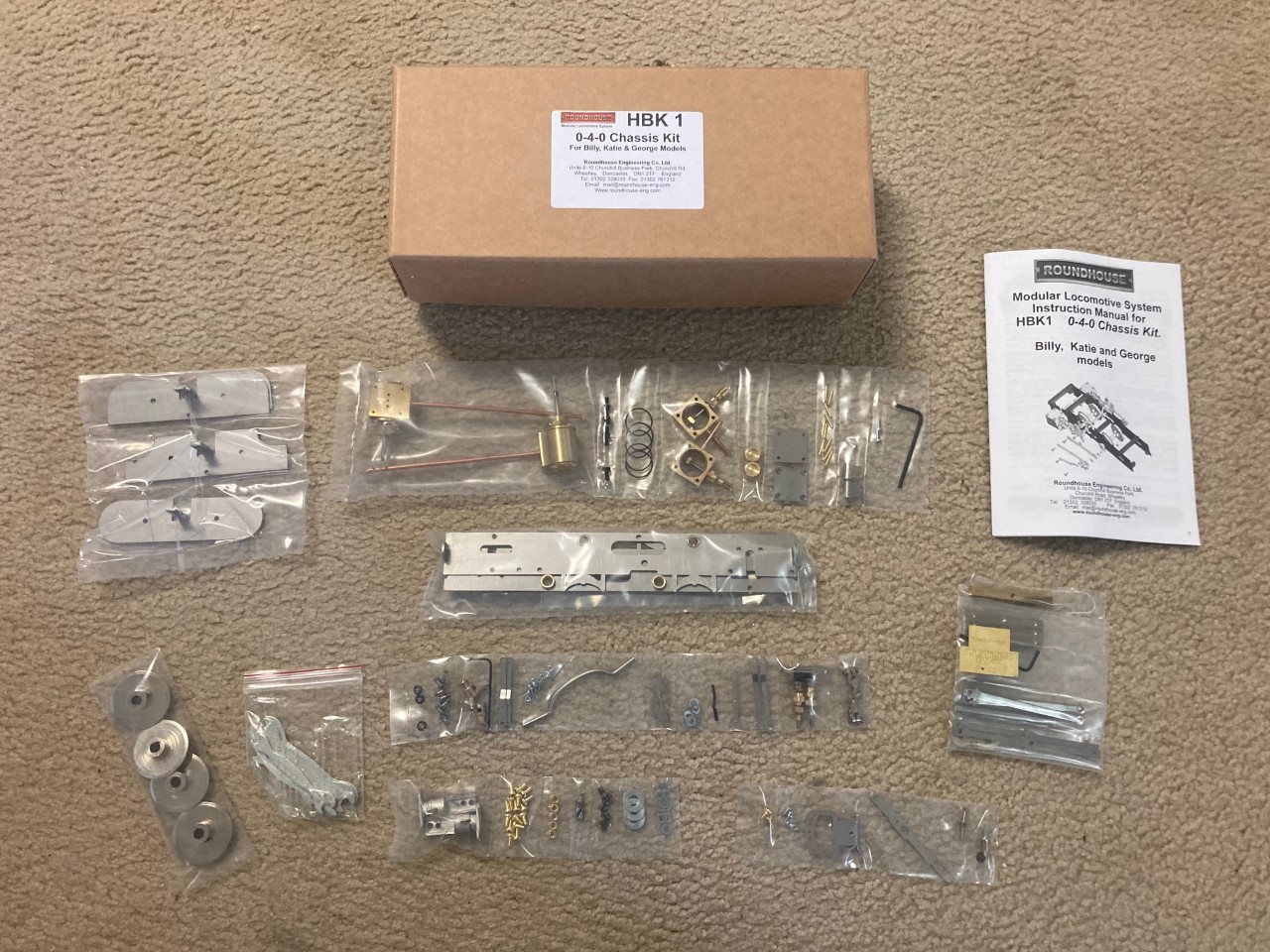

It has arrived :D
Photos of what I received, and the contents of the chassis kit, which is where I will start. From payment to arriving with me in the US was 5 days!

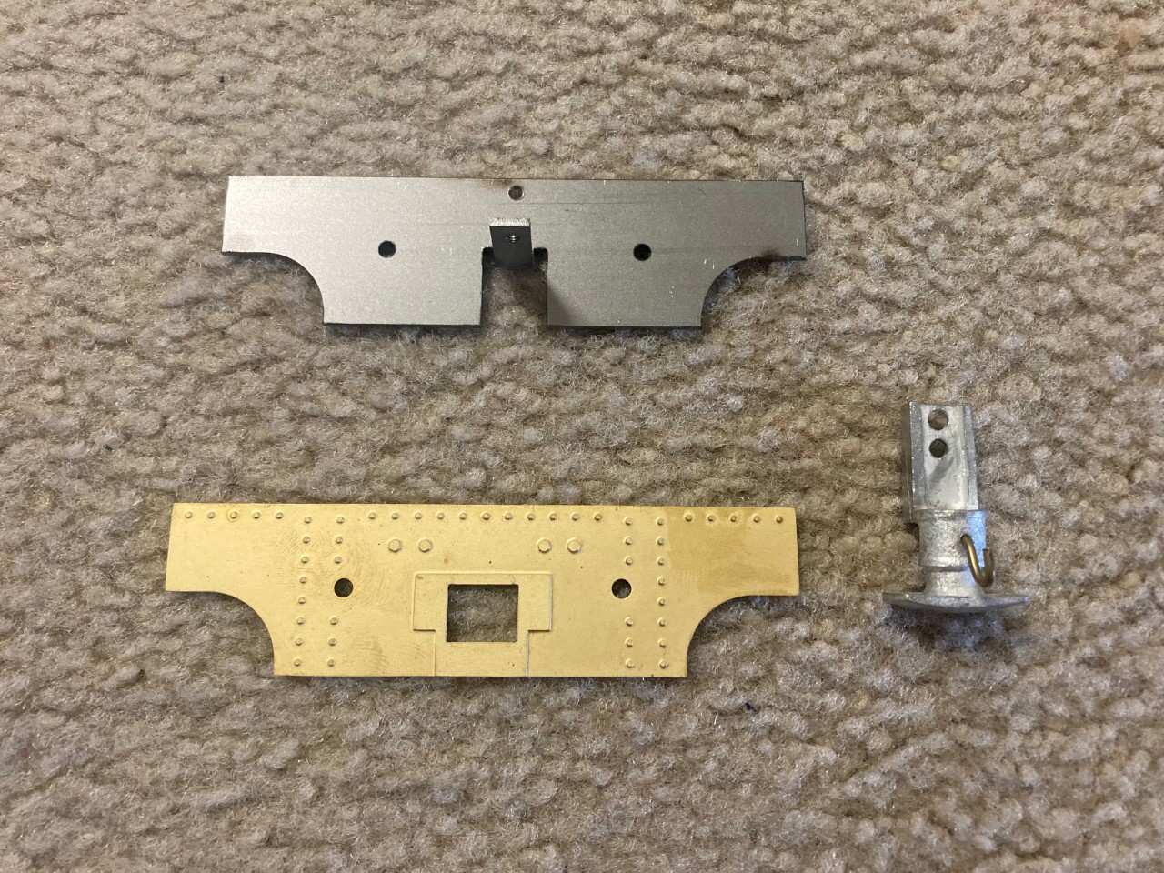

One of the first things I wanted to do was to check the buffer mounting style, as I'm considering a SwiftSixteen coupling and I wasn't sure which one would fit.
It looks like this is the one to go for (although I'm sure the others would work too) https://www.swiftsixteen.co.uk/product- ... e-coupling
That said, it looks easy to add this at a later date and the Roundhouse buffers look fine.
I'm also considering switching some of the M3 chassis/buffer beam bolts to ones with hex heads, so I measured up the brass slotted ones in the kit and they have about 5mm long threads. It looks like Roundhouse sell these as an option (and I believe that the factory locos may now have them on the buffer beams as standard), otherwise I will look for some online.

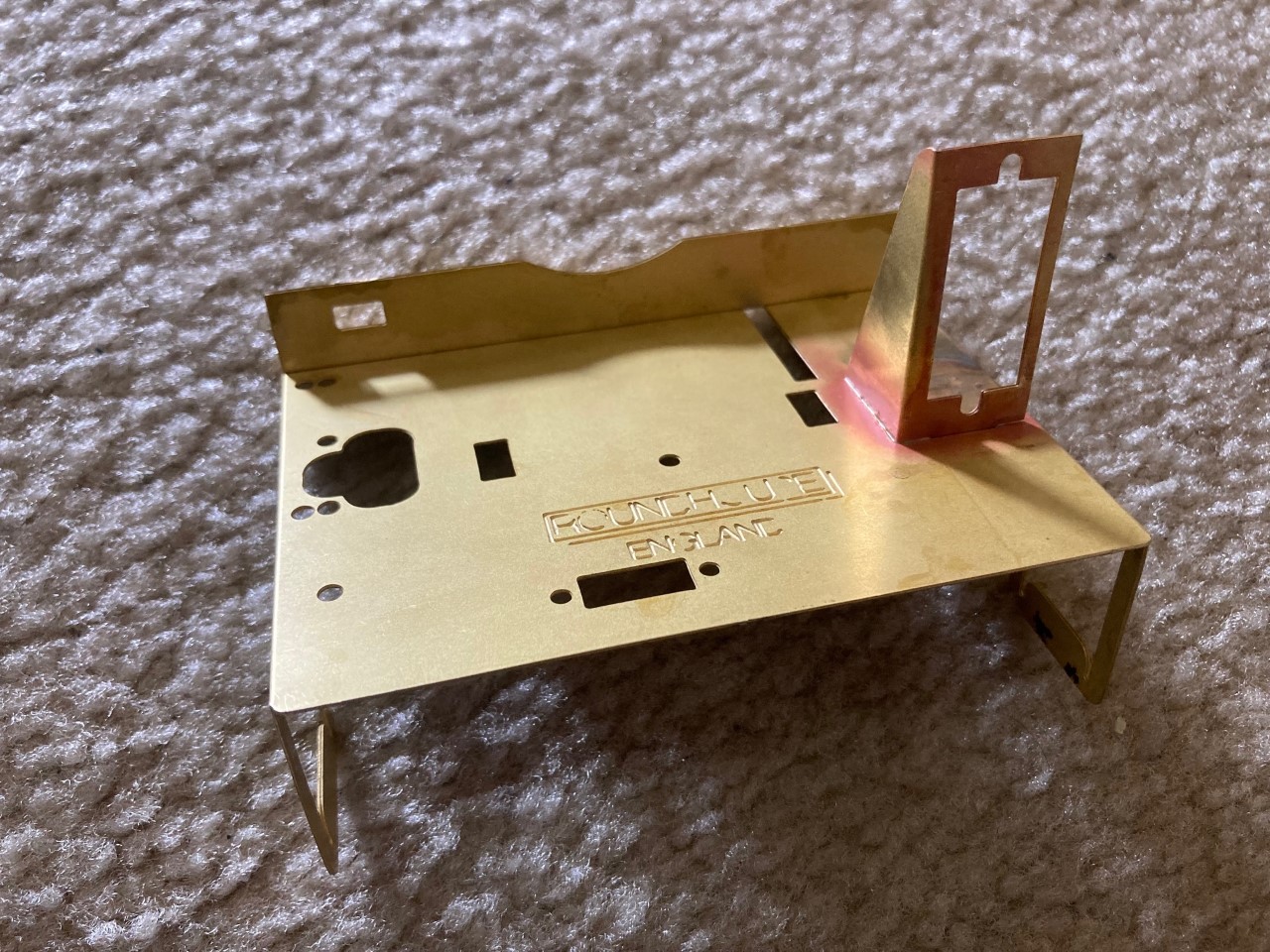

Whilst I am waiting, I have opened the body kit box. I am quite impressed that most of the difficult bending of the main part of the body has already been done by Roundhouse. It also has some rivet detail. I read somewhere that the dummy roof vent wasn't included in Billy kits but mine has it, however, it is designed to be stuck on with double-sided tape so I might look at something else instead.
I had my first go at bending the body floor and it was a disaster. I don't have all of my workshop tools here so was trying to make do with what I had. I thought it might be ruined but a few bashes with a hammer appears to have straightened it all out. :o The 'steps' are extremely weak and bendy though; I'm going to add some step detail, not just for cosmetics but also because I know I will accidentally snap them off pretty quickly if I leave them as they are.

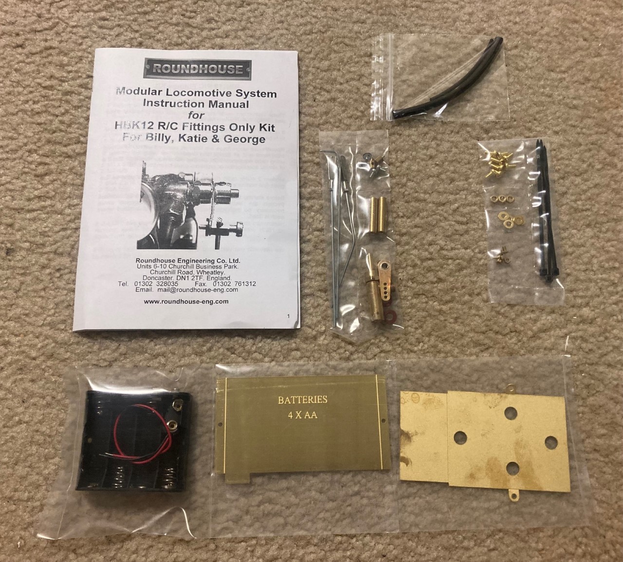

Next is the RC kit. There are some things in here that I probably won't use (e.g. the plastic battery box). It's a tiny bit pricey (£46.50 incl UK Vat at the time of writing) but removing the manual regulator from the kit took £28.65 off that, so it works out quite reasonable.

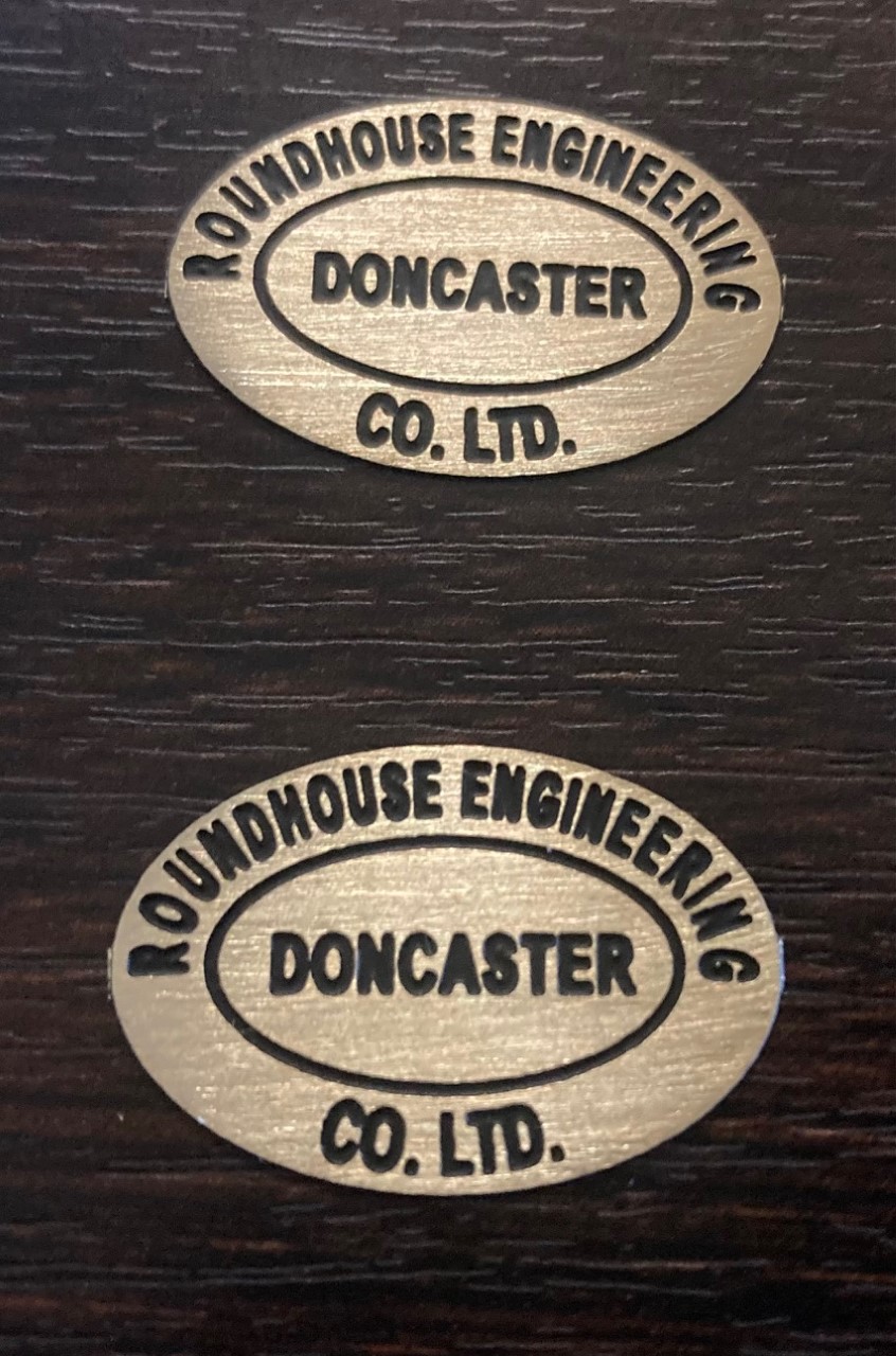

One of the first disappointments was the Works Plates. I had intended to paint them but the lettering is engraved, so I don't know how I can do that. They were about £3 each so I could probably have got something better elsewhere for similar money. I might still use them but I will probably need to shoot some clear over them first (which I haven't ordered). The only other slight disappointment, when spending that much money for a kit, was the fact that they didn't throw in a catalogue. I think a catalogue and the Works Plates should have been included, however, I will buy a catalogue when I place my next order.

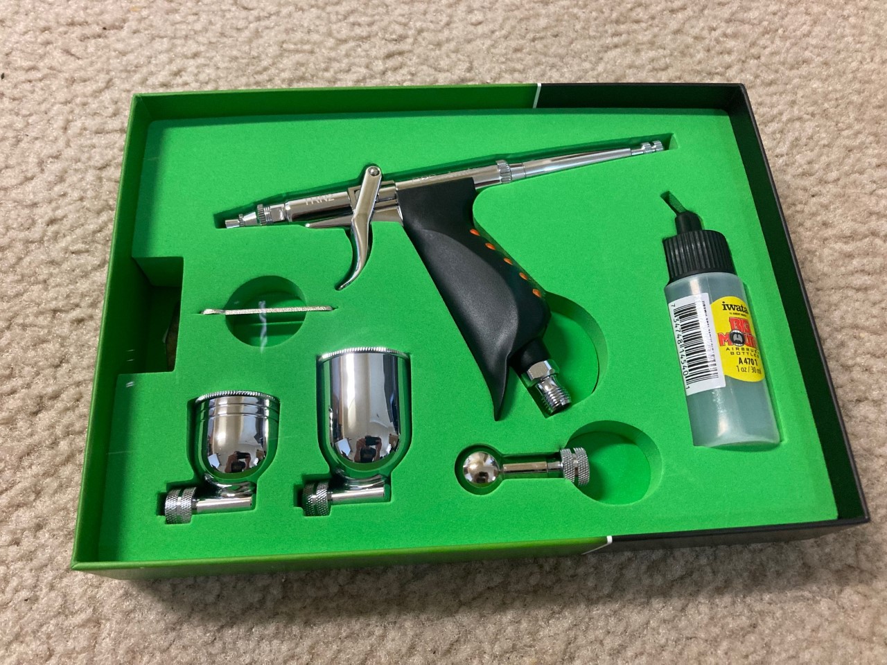

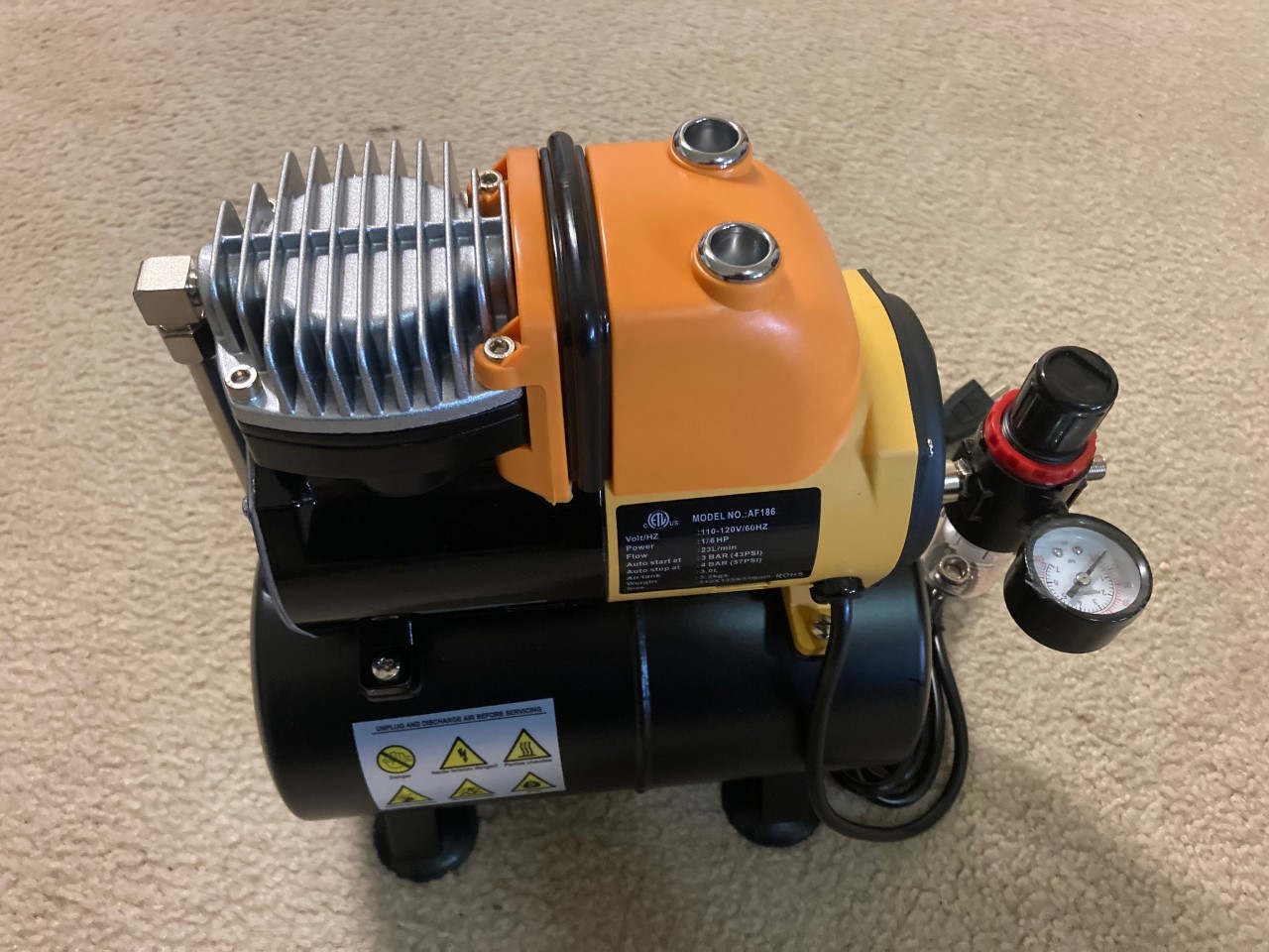

The airbrush equipment has arrived.
As I am only temporarily living in the US, I am trying to minimise the amount of electrical equipment I buy (as a lot of it doesn't work in the UK). I considered using cans of propellant for the airbrush but then came across this on ebay. It looks similar to others that are available from the big brand names but was only $70 (which is less than the cost of about 6 cans of propellant) so I took a chance on it. It also comes with an airbrush (which I am not going to use but will be handy for blowing off dust/drying etc). I'm really impressed with it for the price.
I spent a bit more on the airbrush. In the end I went with the Iwata Neo TRN2 trigger brush. As expected with Iwata, it feels pretty good quality.
I still don't have any idea when the paint will arrive yet though :( I might try some soldering this afternoon instead.

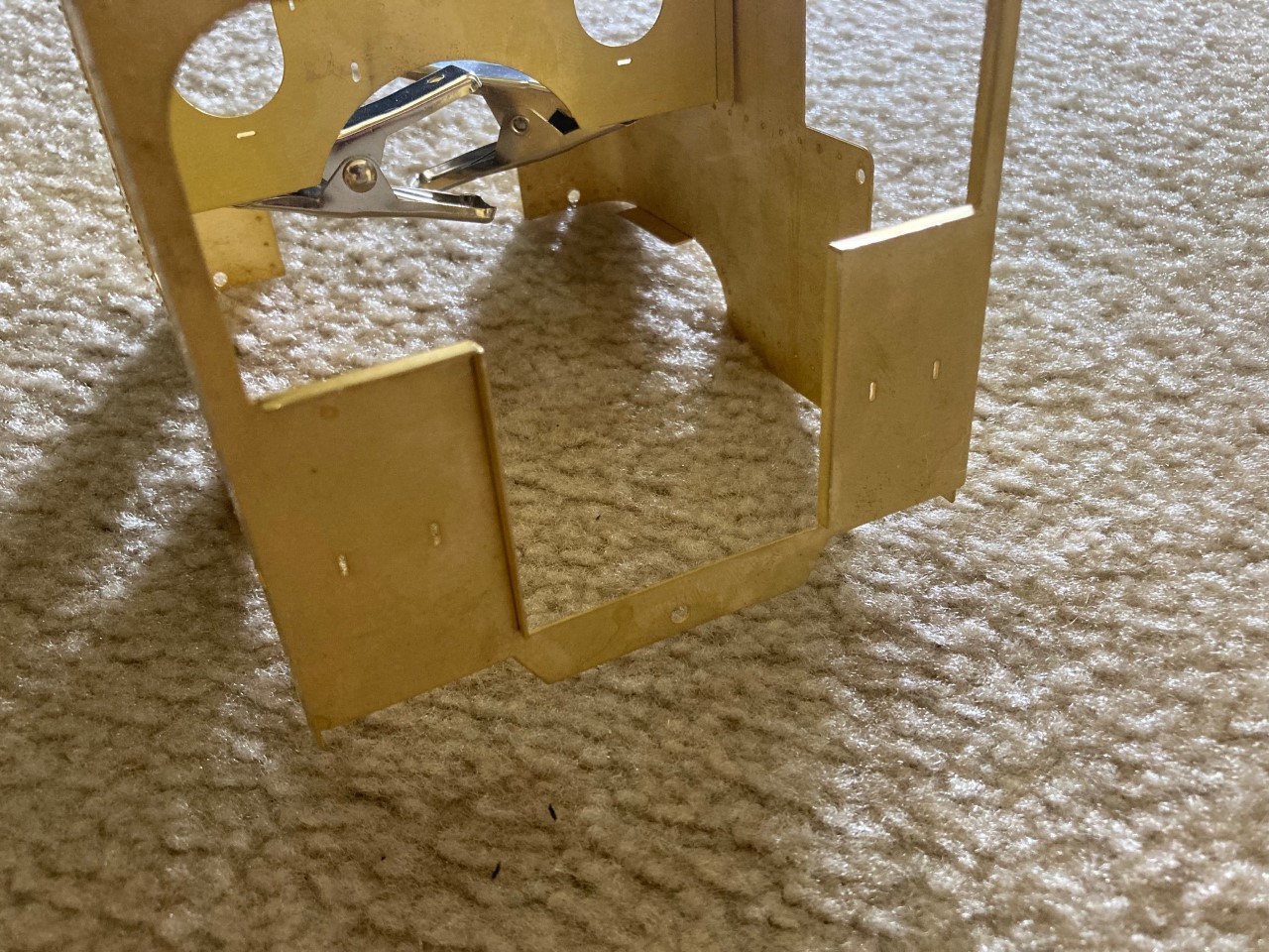

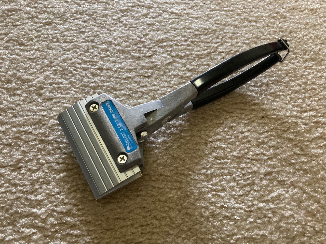

My first attempts at bending the metal parts proved a bit difficult. I looked at the tiny bends in the back of the body and wasn't sure how I would make a neat job of these. I looked around for options and found this hand seamer at Harbor Freight for $11. This is a bit big but it made light work of the bends and something like this makes the bodywork much easier.
I also had my first go at soldering, using Stay-Brite solder and a small butane/propane soldering torch. I'm quite happy with the result.

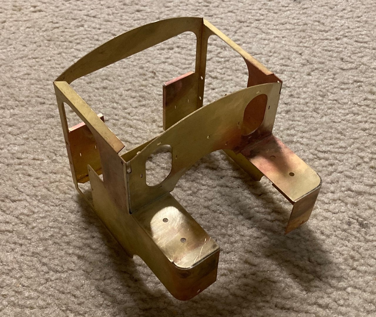

Post by siclick33 » Sun Apr 17, 2022 2:06 am

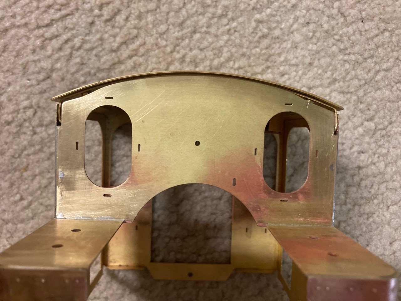

Body soldered and initial clean-up complete.
Not perfect but I'm quite happy with it. :D

On a related note, I have used cheap asian compressors, but found they run hot and wear out quickly when painting large scale models. I now use a small diaphragm type workshop compressor, rated at 1hp and 40lpm free air flow, which actually cost less than the hobby grade compressor it replaced.

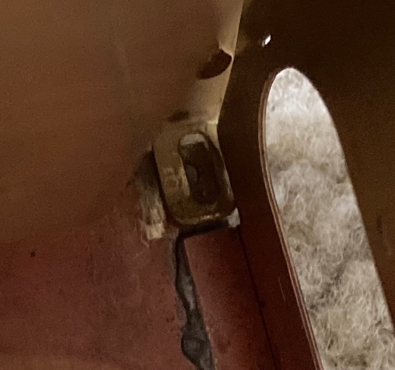

First problem has come, with the roof.
The instructions say that the roof 'hinges' are slotted to be able to adjust the roof and to 'tighten when correctly positioned'. I put it all together and there was no way that this was going to work. After a few adjustments I realised that the bottom of the hinges was hitting the flanges on the inside of the body, so I bent the hinges to allow the roof to drop some more. However, now the roof wouldn't open without the nuts that hold the canopy hinges on, hitting the front part of the body (where the windows are) when you open it. I ended up grinding away some of the metal from the front of the cab, and now it all works. There is no way that these retaining bolts can be 'tightened'' and I subsequently found another part of the instructions that mentions that they need to be loose :x If you don't go through all of this hassle then the roof sits quite high, as shown on a photo I found on the internet.
If I was to do this again, I would try to leave the end of the hinges flat, and grind away some of the flange from the inside so the roof can sit lower. I might grind these flanges away a bit anyway, so that I can replace the roof strap later.
The other concern I had was that the battery box looks odd, when installed, when viewing from the rear. I thought I had made a mistake but, looking at the Roundhouse factory photos, this is correct.
I'm sure there is room for improvement on the kit here; at the very least the instructions are a bit of a mess.

I certainly hope this doesn't sound rude, but I think you need to perhaps slow down a little and think things through a little more carefully before doing things you can't undo, such as grinding down the spectacle plate of your cab. There is no way this should have been necessary. I built this kit, as did many others present, and I found the instructions to be excellent: much better than any other kit I have ever built. Furthermore, I found every part fit perfectly. This is Roundhouse's well-deserved reputation.
The holes in the cab roof bracket/hinge are oval because the roof is meant to be lifted before hinging forward. This would have allowed the nuts on the bottom of the cab to clear the front. The second picture, of the red "Billy" shows the roof pulled up prior to being tilted forward. It should be possible to push it down so it sits correctly. It's not meant to hinge forward without being pulled up first.

Quote from the instructions:
'The hinge has slotted holes to allow for adjustment of the roof position. After tightening into position, file away any excess thread'.
Only 2 pages later (in the section about the tank support) does it say, 'the nuts on the inside should be left slightly loose to allow the hinge to operate'.
So it is tight, or is it loose? Nowhere does it say that the roof should be lifted to open; a hinge operating is just rotating, not lifting! Maybe we have different ideas on what constitute excellent instructions; these aren't too bad but they aren't fully comprehensive (there aren't many diagrams showing where things should go) and they jump about all over the place. In any case, I am mainly posting here to show others where the unclear areas are; this is certainly one of them.
I did work all that out through trial and error, but there was still no way that the nuts that hold the roof hinge strap would clear the front panel when opened. I couldn't even push the roof down as the ends of the hinge strap was getting stuck on the inside flanges of the cab front. I have an engineering background; none of this was caused by rushing!
EDITED TO ADD: I've re-read the instructions and it is clearer now, but I still think it could have been explained better. The initial 'tightening' refers to the hinge strap on the roof. The 'should be left slightly loose' refers to the hinge where it meets the cab body. That still wouldn't have helped in my situation though, due to the interaction with the flange that I mentioned earlier.
It looks ok but I think it might annoy me now, so I might de-solder it all and replace the cab front with a new one. If I put some extra washers in between the hinge and the cab then I might be able to push the hinge bracket far enough away from the sides that it clears the flange.
