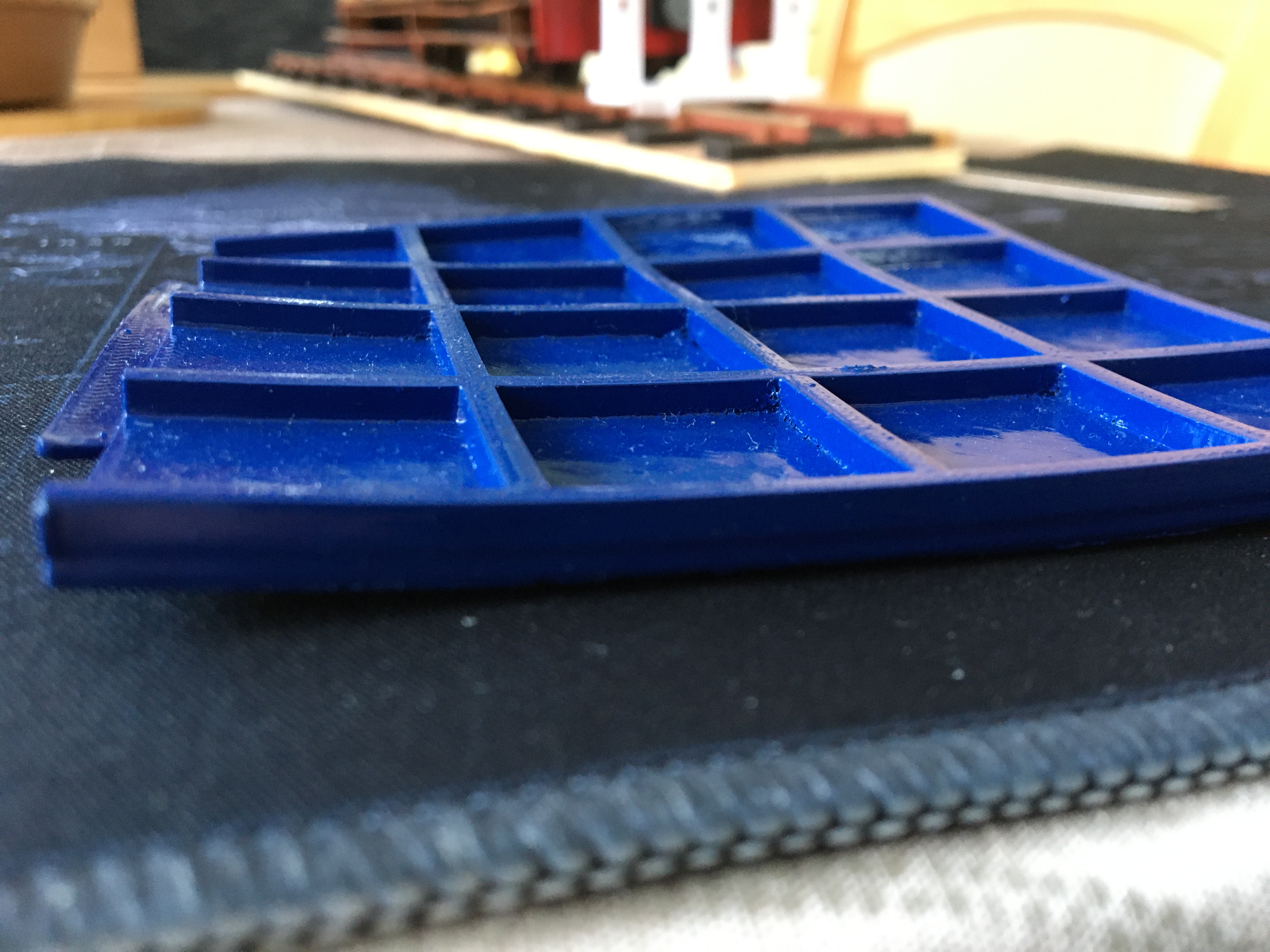

Which filament should be used for outdoor use. I was doing something for my youngest grandson last week. I sprayed it and seeing how it was such a nice day, I left it by the open garage door thinking that it would harden off I bit quicker. ( I was getting a bit fed up with doing this for him, it was taking me ages to do) When I went back about half an hour later what did I find. A curled up bit of useless part..... I then thought what if I was doing a building for outside, would that end up just like this. I use PLA. Is there anything else that is stronger and less susceptible to a lot of heat, or is it a case of moving the building indoors after we have finished.

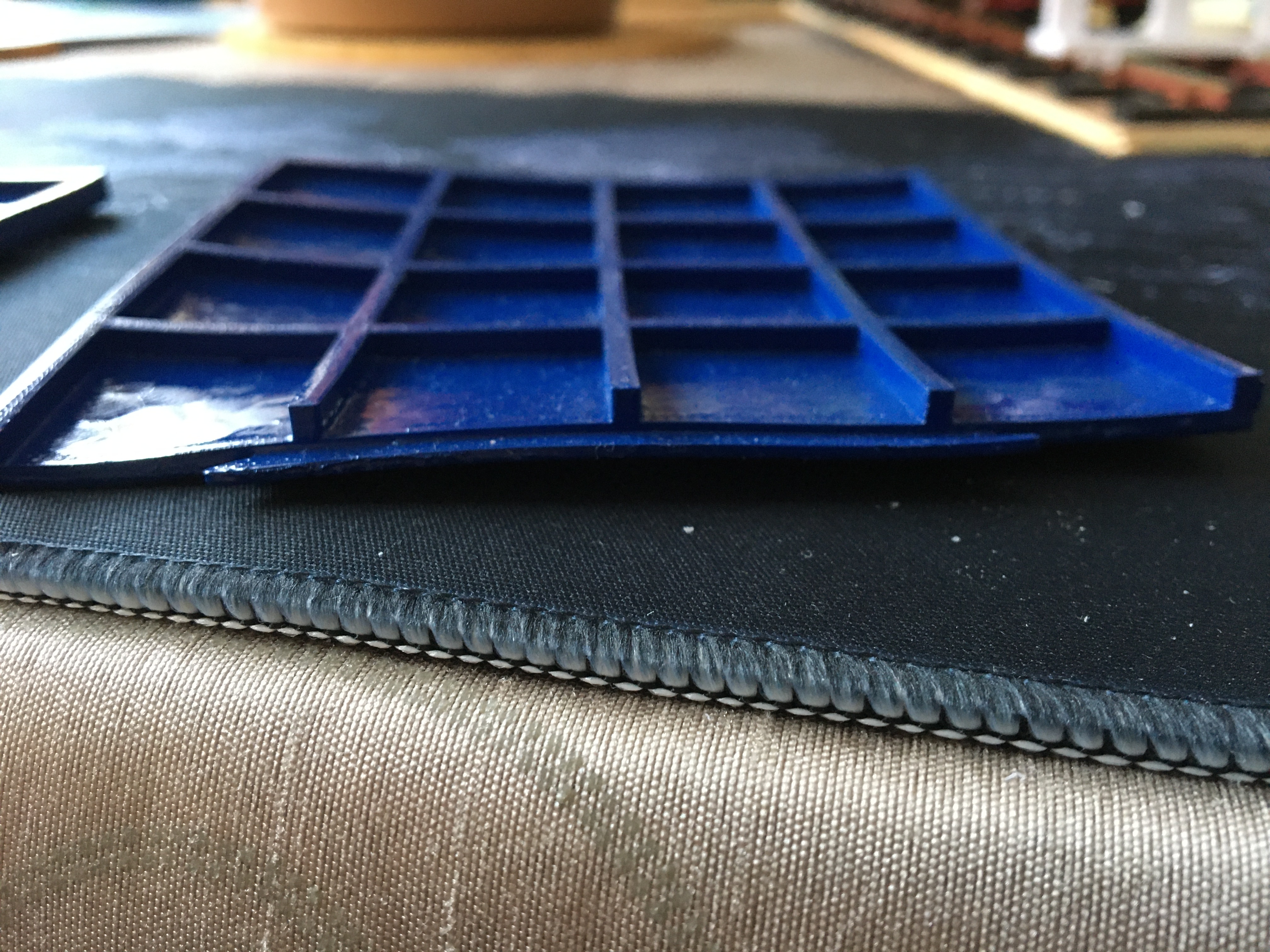

I did spray both sides first Rik, I needed to give another coat to one side on both of the pieces. I really think though that it was the extreme heat that day. Surely if the temperature is reaching 30 degrees that would be hot enough to boil an egg....... :lol:
I have heard also that PETG can be a bit of a pig during printing, but if you get the settings right, a lot of people have done some brilliant models.
I think the infill was about 60%. One thing that has had me confused though Philip. I know it doesn't take much :roll: Does the amount of infill make the item stronger ie: More infill = stronger part. and does it obversely make the part longer to print. It may sound daft to other members, but sometimes things get confusing for me, well most of the time really... :lol: :lol: :lol:

Pretty nasty hey........

As you say, pretty nasty! Thats a shame because the original print looks to be very nice.
Looking at the way it is distorted, with a bigger problem at one end, I think it is a heat thing pure and simple, with the others things that Rik and I have suggested probably contributing in some way.
For some reason I assumed that the object would be relatively bulky rather than thin and flatish. 60% infill is pretty high, normally 10-25% would be fine and going up 60% increases print time by a factor of 4-6 times. Having said that, depending on the cross section dims of the ribs I can see why you might want to up the %, but I don't think I'd go that high, because the gaps between the infill lines would be virtually non-existant. Of course the other relevant factors are wall, base and top layer line counts and layer thickness, because obviously the higher those figures are the less space there is between them to actually infill anyway. Get them high enough and you have a solid!
There are normally several different infill patterns available in the slicer settings and some are said to be stronger than others. Tbh, in my prints I haven't ever printed anything with a large enough volume for it to be significant, I think it really only matters for structural or mechanical parts.
I am slightly guessing, but my gut feeling is that in this particular instance, your rib section dimensions are probably small enough that the infill type is irrelevant but the multiple 'wall's' will make it stronger and more warp resistant.
Just a suggestion, which may not help, but you don't have much to lose, try sticking the failure in very hot ( not boiling) water for a few minutes to get it to soften slightly and then immediately put it on a flat surface with a heavy weight on top and leave it over night to cool down. It may get it back to something like flat.

Thank you Philip, that's very helpful. Just what I needed, someone to explain in a little more detail what the infill is. :salute:
Also thank you for the suggestion on putting the part in hot boiling water and adding a weight. I had never thought of that, but as it happens I printed another part off and this time kept it out of the :sunny: :sunny:
:lol: :lol:
I have I must say though have printed most of my parts that are of a decent size and thickness with 60%. I should be doing them like you say with about 10-25%. I will give them that setting from now on and see how they turnout.

FWLR wrote: ↑Wed Sep 08, 2021 9:48 am I should be doing them like you say with about 10-25%. I will give them that setting from now on and see how they turnout.
I normally use 15 or 20 and only down to 10% if it's a rough print to check something. Go too low and you increase the risk of 'pillowing', where the air trapped inside stays warm too long and pushes the top surface up. You can sort that by either increasing the infill or increasing the number of top layers ( or a combination of both)

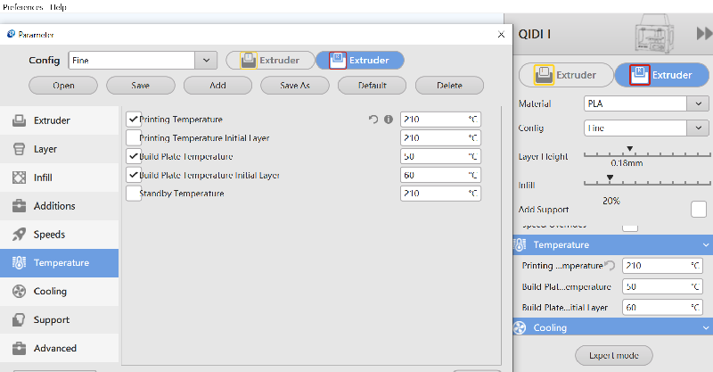

I have my build plate initial layer at 60deg and then drop to 50 deg for the rest of the print. The 60 helps with sticking to the plate. Then my normal printing temp is 200 or just occasionally 210.
I never use a raft. I did when I first had it because thats what the instructions said, but, as just you said, I can never get the print off the raft! I use a brim for small items, or nothing at all for items with a reasonable size footprint ( bigger than about 10mm square, equivalent).

Very interesting reply. How do you set the first layer to 60deg though and then change to 50. I thought when you set your bed temperature that was it. My slicer which is FlashForges own just has one setting I think, I will have to have look and do a screen shot, it maybe better if I did, because I think you use some other slicer program for which I may have tried to download and if it did I couldn't get it to be recognised by my machine.

I can't answer about Flashprint I'm afraid, although as far as I can see it has very limited ability to change the print parameters. I think Trevor uses it so he may be able to answer more fully.
I use Qidiprint which is a customised version of Cura, supplied by the m/c manufacturer.
It has literally hundreds of customisable settings, most of which I don't understand, let alone know how to use! Rik uses the full version of Cura, which is why, for example, he is able to play around with the "Ironing" feature settings which he mentions from time to time, and which is disabled on mine for some inscrutable Chinese reason!.
However, in the screen shot below, on the RH side you'll see it has options for initial layer and subsequent layer temps.( The figures that look like >10 are actually "210" but rescaling the picture to fit on the forum screen has squashed it!)
Below that section is an "Expert mode" button, and pressing that brings up the small window which is on the LH side of the screen, and that has a number of different settings available, including the plate temps. This allows defaults to be set which can be altered individually in the RH window on a print by print basis if required.

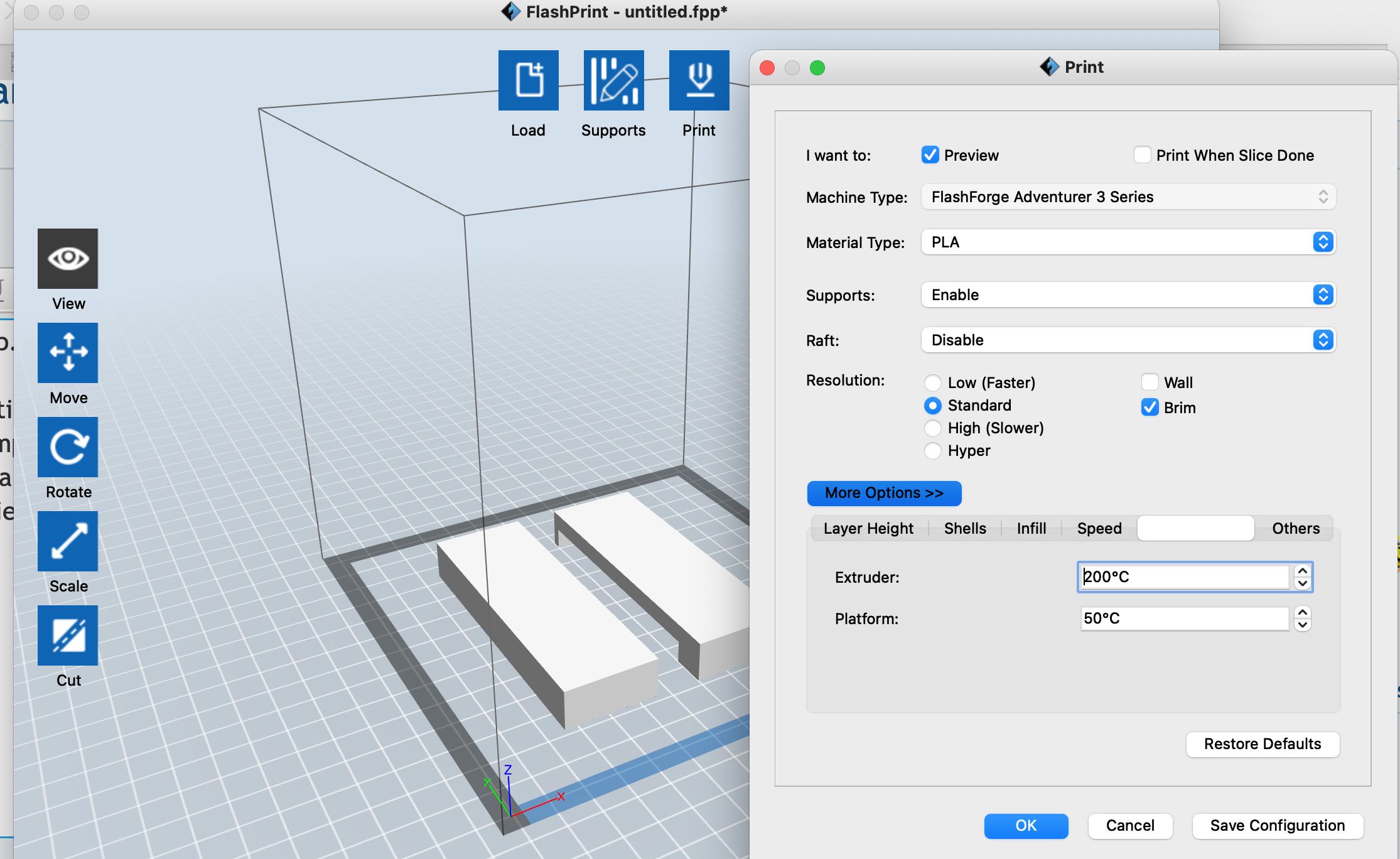

Perhaps I should comment on the screen shot you posted, showing flashprint and two box like prints being sliced. I notice that they seem to be hollow underneath - I would have printed them the other way up - with the hollow uppermost to reduce the supports needed. I would have lifted it 1 mm and used the "linear" supports at the default setting (1.5mm wide).
I have had problems getting thin prints to be stable. The chess board did look pretty thin. I like flat surfaces to be about 3mm thick, and I tend to use higher infil ratios. I am typically making things with 6 top, side and bottom layers, and with at least 40% infil, increasing that to 60% for some prints. For example the part I made to repair the print head had 80% infil - because it is subject to a lot of stress, and its hot.
I noticed that as well, but forgot to comment. I would also print it the other way up but flat on the bed with no raft, no supports, etc. That way you use the flat bed surface to give a perfectly smooth surface with no need to clean anything up. From what I've read that doesn't seem to be an option with Flashprint though?

That part that I have put on the screen shot is how it appears off the file before I have done any moving of it. I was just showing Phillip the setting that was being used because I couldn't see how to reduce the heat on the first initial layer and then for the rest Philip puts more heat. On Flashprint we are not able to do that it seems....
The part on the screen and for most of any part that is visible, I have found that if you print it face up like you see on the screen, it leaves all kind of marks and lines, likewise if I turn it over and print with the flat down onto the bed then like you say and Philip also, that it is a pig to get off cleanly. I do lift parts off the bed by about 2-3 mm and put linear supports on, I tend not to use the tree supports though, they are worse for getting of the parts, because no matter which setting I try to reduce the thickness of the support, it leaves horrible marks on the part when it is removed.
I try to print my parts on their side now because it tends to leave both sides pretty smooth, with hardly any marks at all, which I find after they are painted gives a lot better appearance to the part. It's a personal thing though, you may think it's not worth it and yes it does tend for longer print times and I think more filament, but the cost is minor I think, I don't know if I am right or wrong there though Trevor. Maybe there are better ways, I am not that experienced though and I do the best I can. I do improve though a little bit when like I say members give their valuable knowledge and far superior experience.

The part that I used to show on the thread that ended up warping was printed at the thinest 3mm and thickest 8mm and it isn't might to be used outside. It was something I printed for my youngest Grandson to use for school and it needed to be in four separate parts, so he could explain in class the principle of what the subject was about. School things are way beyond me now..... :lol: :lol: :lol:
