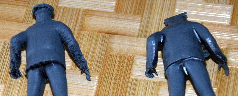

Just out of curiosity I've printed your driver figure on both filament and resin machines, with interesting results. Firstly though I must say that these aren't properly cleaned up, I just roughly took the supports off and quickly sprayed with primer and haven't done any filling or anything.
DSC_0003 double.jpg (235.8 KiB) Viewed 135696 times
The resin one seems to have undergone some sort of partial headectomy :D . Not sure why but I'm guessing the stand off from the raft wasn't enough to allow for the angle when printing.
Other than that, it is a much better print than the filament version. Oddly, the facets are much more obvious on the legs than the body.
There is some bridging between the right arm and the body, which is there on the stl itself and isn't a printing artefact.
The filament version suffers from holes in a mangled face, which I virtually always get when printing figures on my machine, so it wasn't a total surprise except that your one looks perfect, so it must be something to do with my slicer settings I think - what infill % and layer thickness did you use? Mine was 20% and 0.1mm.
My filament version also suffers from major yeuck on the underside of the arms, plus raggedyness at the bottom of the jacket, which I'm guessing has the same root cause.

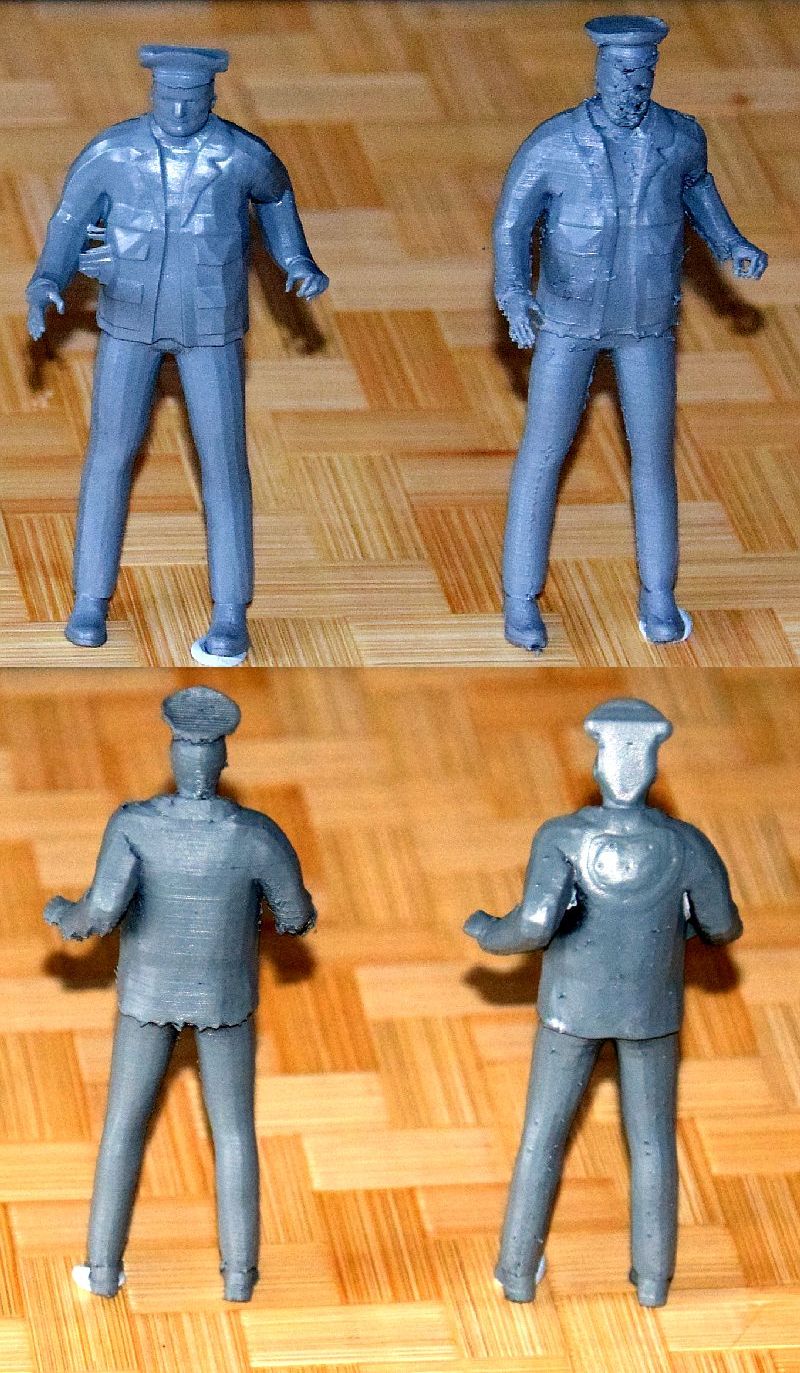

To show how they have worked out:
I will find the time to go back and try to improve the files! It is all a learning experience. I never would have thought I would be printing all of these people and "things" 15 months ago!
