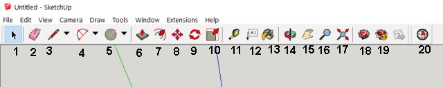

First though, a quick explanation of the buttons at the top of the screen. Hover your mouse over the icon at any time and a tooltip appears, but for reference this is the list:
Screenshot 2020-08-15 07.04.06.png (23.02 KiB) Viewed 471567 times
1) Select
2) Eraser
3) Lines - the adjacent down arrowhead allows for drawing either straight lines or freehand.
4) The Arc button has several variants accessed by clicking the down arrowhead to the side.
5) The circle or square Shapes draws that shape and also has a couple of other options under it's arrow.
6) PushPull -The rectangle with the up arrow on top is one that we'll use a lot and drags a face up, down or sideways to create or alter a 3-D shape.
7) The two arcs with a red arrow is the Off-set tool and we'll come back to that.
8 ) The 4-headed arrow is the Move tool and slides selected items around without affecting everything else.
9) The two arc shaped arrows Rotate a selected object. (This is a horrible tool to try to use and I avoid it as much as possible!).
10) The solid grey square inside a red square is the Scale button and is very useful at times.
11) Tape Measure has several functions, from simply measuring a distance on the drawing to setting guide points and lines, to actually resizing the object.
12 & 13) The next 2 buttons we don't need at this point.
14) The red and green swirl Orbit button is very useful and allows you to spin the entire drawing in any direction.
15) The hand Pans the drawing in any direction,
16) The magnifying glass Zooms in and out.
17) Extents - The magnifying glass with three arrows, automatically zooms the drawing to fit the window.
18) SketchUp 3-D Warehouse - not much use for our purposes.
19) SketchUp Extension Warehouse.
20) Solid Inspector2. This is not part of the default tool set but needs to be downloaded from the Extension Warehouse. It is not infallible but is a useful tool for looking for errors in the drawing. Download and install it and this new icon appears on the toolbar. Then at any point in a project just click the icon and a window will pop up indicating errors. Download from: https://extensions.sketchup.com/search/ ... 0inspector

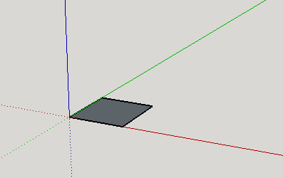

First use the Orbit button to arrange the axes with the origin towards the LH side of your screen and the solid blue axis vertical and solid red axis running from L to R.
Next select the Shapes button to a draw a rectangle: position the Pencil on the origin, click and hold the Left mouse button and draw a shape to the right, then let go, the size doesn't matter because in the "Dimensions" box, now type "45,45" ( the comma is important ) and hit Enter. The shape you drew will change to a square 45 x 45.
Screenshot 2020-08-14 16.30.11.png (2.23 KiB) Viewed 471541 times

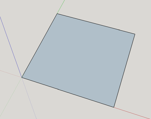

Hit the "Zoom Extents" button and it will zoom in to fill the screen. Now use the Orbit tool to angle the square more towards you so that you have a reasonable view of the square.
Screenshot 2020-08-15 14.00.25.png (25.05 KiB) Viewed 471541 times

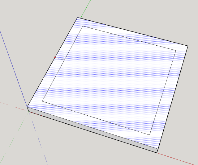

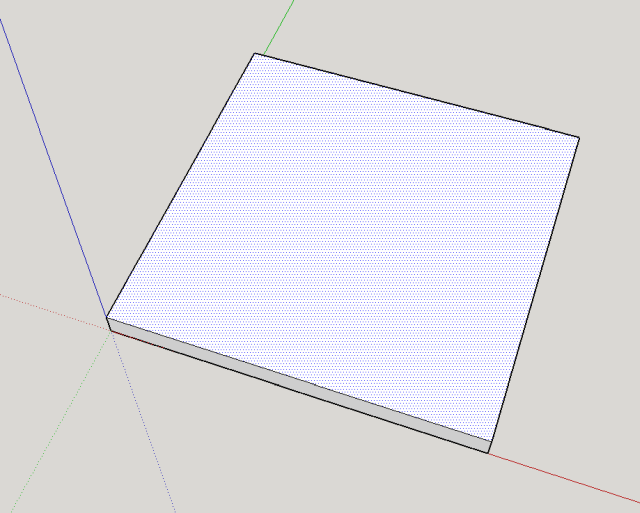

Use the Select arrow button to select the top square by clicking on it anywhere and it will change to a speckled blu-ish colour, now use the PushPull tool to pull it up. Enter 3 into the box and hit enter. You now have a solid slab 45x45x3mm
NOTE: SketchUp can sometimes give unexpected results if you try to do several things on a 2-dimensional surface and then extrude them one at a time.
Screenshot 2020-08-15 14.03.25.png (86.49 KiB) Viewed 471541 times

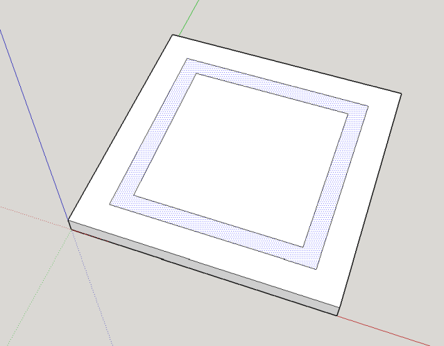

Select the top face of the square then click on the Offset tool, click on the edge of the square and a small red dot will appear, drag the cursor towards the centre and let go, type 5 into the Distance box and hit Enter. The new square will move to be a symetrical 5mm inside the outer border. Pick the Select tool and click anywhere outside the block to deselect everything.
Screenshot 2020-08-15 14.09.20.png (100.07 KiB) Viewed 471541 times

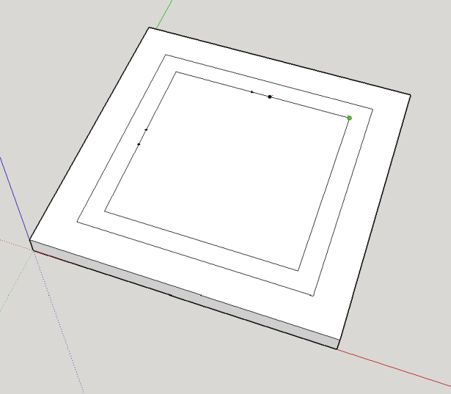

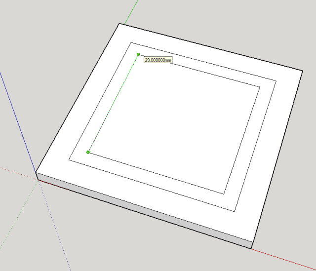

Using the Tape Measure tool, click on one corner of the inner square, let go and move along an adjacent edge to the next corner, it should say 29.0000mm.
Screenshot 2020-08-15 14.17.23.png (47.05 KiB) Viewed 471541 times

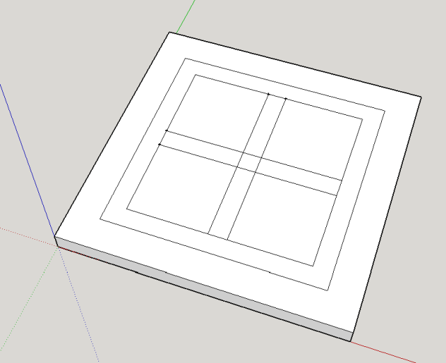

Now we need to add the central dividing frames, which should be 3mm wide to match the outer. So 29 -3=26mm, divided by 2 gives us two panes each 13mm wide. Using the Tape Measure tool, click on one corner of the inner square and drag along one edge, type 13 in the length box, hit Enter, and a small mark will appear on the edge at 13mm from the corner. Go to the corner at the other end and repeat. You should now have two Guide marks on the edge, 3mm apart. Repeat this for one of the other sides.
Screenshot 2020-08-15 14.22.15.png (44.72 KiB) Viewed 471541 times

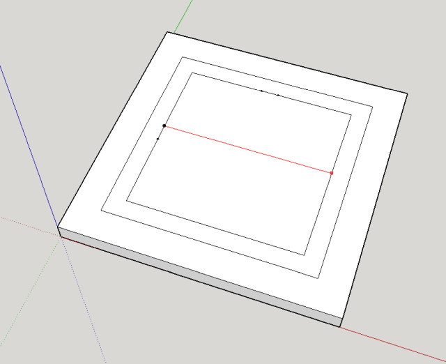

Select the Line tool ( pencil), place it on one of the guidemarks and drag it towards the opposite side. As long as you go in an apporoximately perpendicular direction it will maintain the line until you get to the opposite side and will draw an indicator line in the coour of the axis. ie. L-R it will be red, F-B it will be green. When the pencil gets to the opposite side a small box will pop up saying on "On edge", so let go and a black line will be drawn.
Screenshot 2020-08-15 14.24.42.png (45.29 KiB) Viewed 471541 times
Repeat this for all four Guide points.
Screenshot 2020-08-15 14.28.08.png (51.43 KiB) Viewed 471541 times

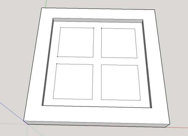

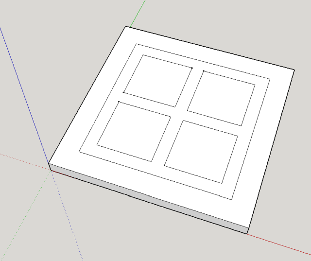

OK, nearly there! Using the Eraser tool, click on each of the lines that are closing off the ends of the inner frames.
Screenshot 2020-08-15 14.30.55.png (50.18 KiB) Viewed 471541 times
Select the outer frame face, then use the Push Pull tool to pull it UP, 2mm.
Screenshot 2020-08-14 18.19.48.png (18.58 KiB) Viewed 471541 times

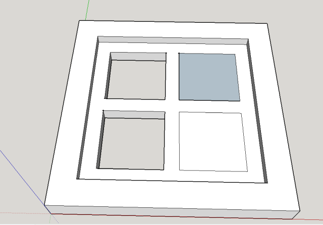

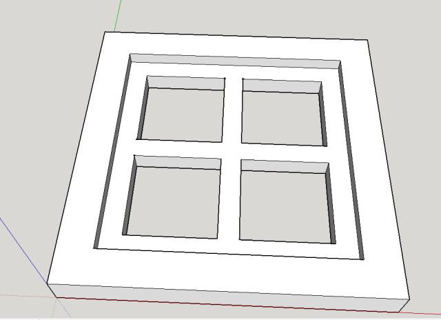

Now, one at a time, Select the individual panes and using the PushPull push them DOWN by 3mm, the infill should disappear leaving the frame with 4 openings.
Screenshot 2020-08-14 18.21.31.png (21.41 KiB) Viewed 471541 times
Screenshot 2020-08-14 18.22.17.png (26.63 KiB) Viewed 471541 times

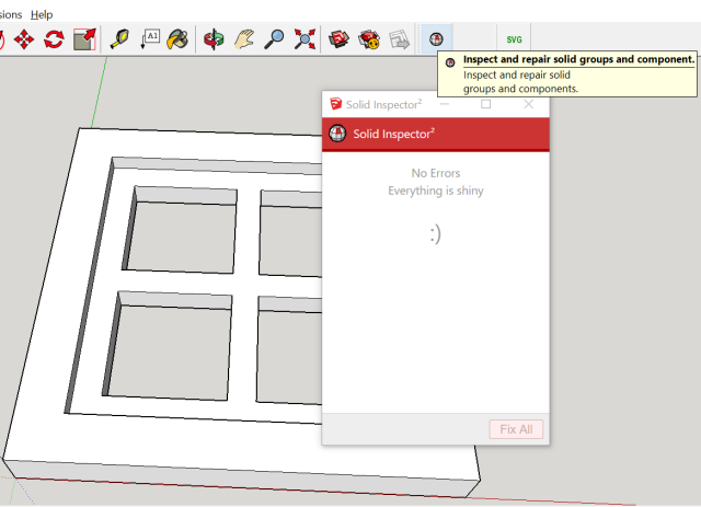

Now click the Solid Inspector (looks like a globe at the RH end of the toolbar) and it should say "No errors - All is shiny"!
Screenshot 2020-08-14 18.42.47.png (45.6 KiB) Viewed 471541 times

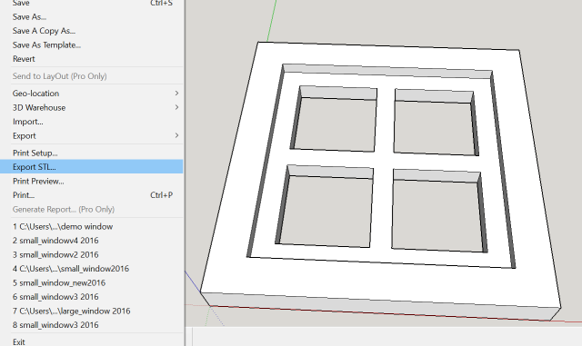

Save your drawing and then part way down the File menu you should see Export STL.
Screenshot 2020-08-14 18.54.56.png (42.1 KiB) Viewed 471541 times

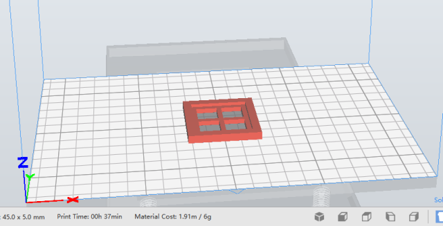

Select that and export the file, then run it through your slicer...
Screenshot 2020-08-15 14.42.33.png (71.35 KiB) Viewed 471541 times
Job done.

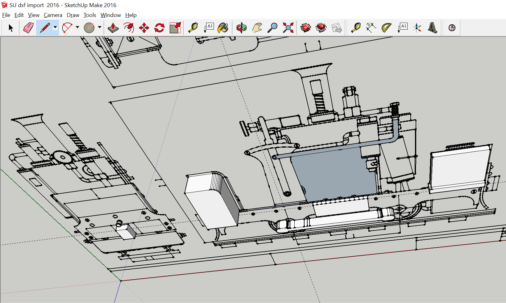

I have just come across a potentially very useful 'work around' for the old free Sketchup Make.
As was discussed on another thread, it is possible to import graphics files and then draw over them to produce a 3d drawimg for 3d printing. One of the SU limitations is the inability to to import pdf's and another limitation in the free verion is that it won't allow the import of Autocad .drg and .dxf files.
However, there is a free program called Inkscape ( do a Google search) which will open pdf's and allow the export of a vector file in Autocad formats. (It appears to be able to do a load of other things but I haven't explored them)
Now for the sneaky part: Sketchup 7 is a very old and obsolete version but is still available to download (http://www.oldversion.com/windows/googl ... -7-0-10247) and, most importantly, back in those days before Google sold it off, they allowed the import of .drg and .dxf files, which can then be saved as Sketchup ( .skp ), files. These then just need to be opened again in SU 2016 or 17 and saved, and the drawing can then be manipulated as any other SU drawing.
The first thing to do is resize the imported drawing to whatever size/scale you want, using the tape measure tool on a known dimension, to avoid confusion going forward.
Some of the shapes on the imported drawing do not always have a solid 'face' in SU initially. However this can usually be sorted by simply drawing over one of the edges and it will go solid and can then be pushed, pulled, etc.
So, because I had it handy, I did some experimenting with a Dave Watkins De Winton pdf drawing and followed the procedure outlined above . The following screenshot shows:
1) The black outlined areas are as drawn and imported.
2) The greyish blue area is a solid face.
3) The white blocks are extruded solid faces.
Screenshot 2021-05-19 15.45.19.png (103.21 KiB) Viewed 469432 times
For full instructions see these links:
https://sketchucation.com/resources/tut ... conversion - Note: this article talks about Sketchup Pro, but the instructions are the same for the free version, you just need to do the conversion in the following link:
https://designerhacks.com/how-to-import ... thout-pro/ ( includes the download link for SU 7)

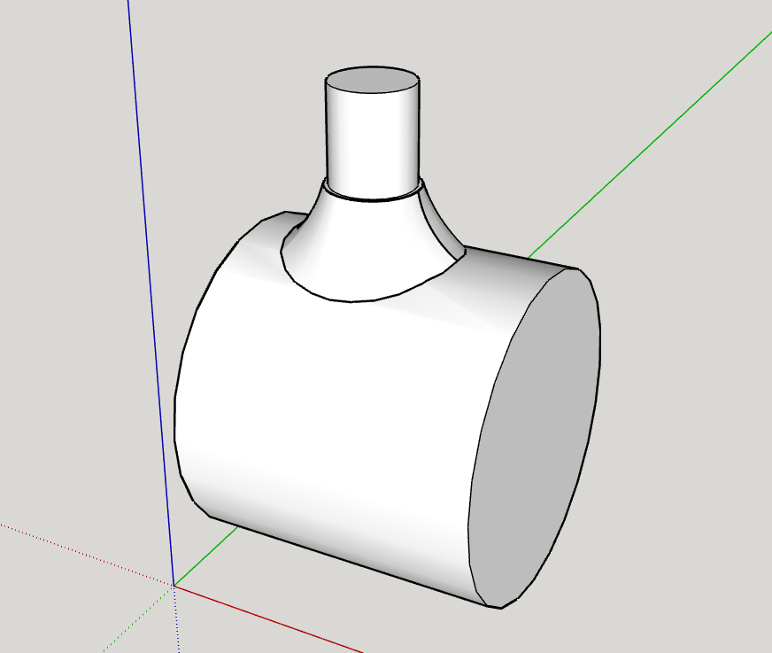

One of the most difficult things to do in many 3D CAD programs is to create the multiple smooth curves between the bottom of a vertical loco chimney and the larger diameter horizontal smokebox.
Sketchup is no exception and I've always had to resort to a manual bodge to get something that doesn't look too bad at a quick glance. I've searched online a number of times over the years without finding an answer...until today. It's actually been there all the time if you ask the right question ( ! ) and is not too difficult to do when you know how!
The key is to install 3 plugins and a control script, all of which are available foc from SketchUcation, which you need to register for if you haven't already.
You need:
https://sketchucation.com/plugin/903-libfredo6
https://sketchucation.com/pluginstore?pln=roundcorner
https://sketchucation.com/pluginstore?p ... sOnSurface
https://sketchucation.com/plugin/1175-curviloft
To install them, download them, open SketchUp and go to Extension Manager. Find the plugins in the list, Click the INSTALL button and select the Libfredo6 . Then, one at a time, install the three actual plugins. Nothing happens until you close SU completely and reopen it and all the new icons appear by magic.
NOTE that the Fredo stuff is in the Windows dropdown, not Extensions.
Having installed this lot, there is a very useful animated GIF in the SU forums showing exactly what to do, about halfway down this thread:
https://forums.sketchup.com/t/fillet-be ... s/126455/9
It goes a wee bit fast but it does work if you follow it through, although it gets frustrating having to see it over and over, to get back to where you need to be.
This screenshot is from my first attempt, just using rough random circles to create the two starting cylinders. It clearly has mileage when using accurate dimensions and I think there are probably ways to improve the end result with some fiddling about.
Screenshot 2024-10-03 17.03.44.png (32.87 KiB) Viewed 448532 times

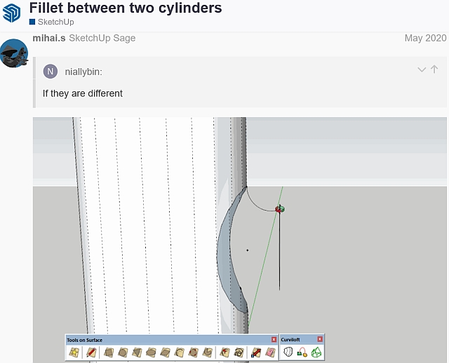

Trevor Thompson wrote: Wed Oct 30, 2024 5:53 pm Hi
I have got as far as installing the plugins, but can't access the animated GIF. Could you check that the address is correct - or advise me on how you accessed it.
Trevor I'm pretty sure that's the correct link, but here it is again:
The gif is the 2nd to last post in that thread:
Screenshot 2024-10-30 at 19-12-58 Fillet between two cylinders - SketchUp - SketchUp Community.jpg
