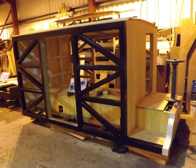

The kit construction makes this very clear with the sentry box being a separate unit, not an extension to the side panel. It is built in such a way that the original balcony step is made first and is hidden under the box seat. Also, the roof line is slightly higher than that of the main body.

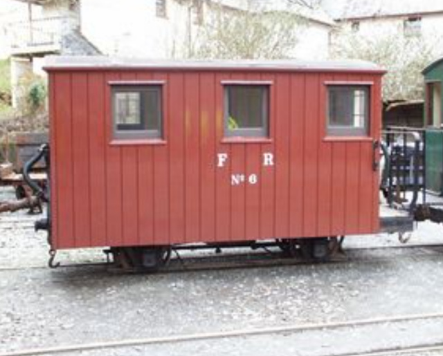

I have found this photo on the 'Festipedia' website which seems to confirm that your info about the end balcony is indeed correct. Festipedia also state the it is 13' in length, which may be correct as brake van 6 with end balcony on the same website is quoted as 12'6" and the proportions do seem similar.

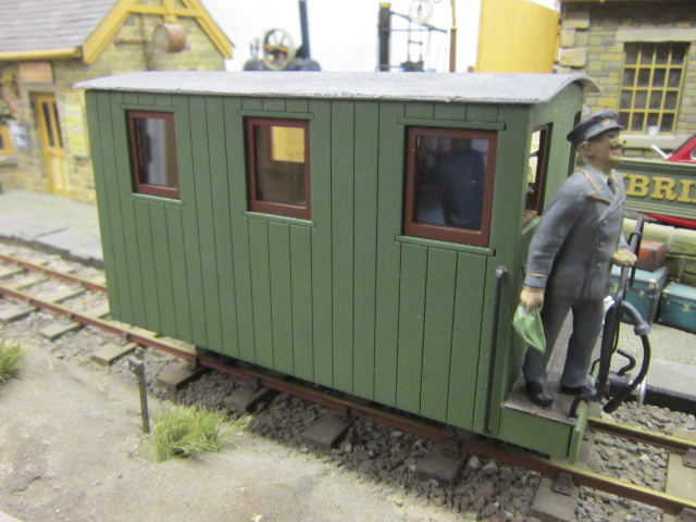

Very interesting.... I also have a kit-built model of brake van 6 (kit-maker unknown) so I can make a direct comparison for you. Too late and dark now so tomorrow it will be......

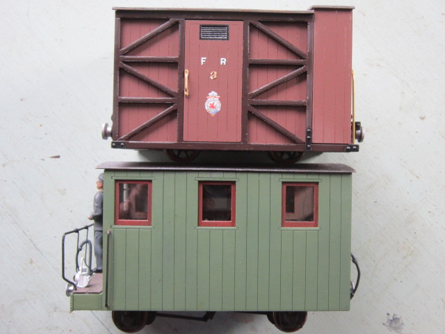

Kit comparison as promised......
Quite a big difference when seen this way, the brake van 6 scales at 12ft. 3" (over balcony) so pretty close to prototype.
Re: FR. Sentry box brake van.
I could be wrong, but think your kit may be one of the original IP ones Peter, which were "scaled" (ie stretched!) to suit the size of the average 16mm loco - which would make a size comparison tricky.
The ""scaled" models weren't popular, apparently, (I certainly recall them causing rifts on the 16mm e group!) so replaced with the current range, which are to scale.

That's an interesting comparison Peter. It seem strange however that if Festipedia is correct and van 3 is approx 12' long and 6' high it should be twice as long as it is high. Do we think a little artistic licence is being used in producing your kit to a squarer outline than van 6. Van 6 does look more prototypical.
