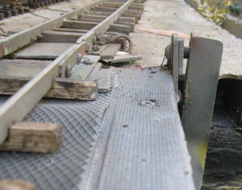

You have seen my bridges.
The 'trick' is to have the hinge pivot ABOVE the top of the rails.
These pics are of my alum bar rail, but I did have a bridge with normal rails at Ti-tree, (now demolished and no pics.)
My 'hinge' is just a few bits of steel with 1/4" bolts - rough and ready but been there for 25 years!
hinge combined 2.jpg (215.16 KiB) Viewed 22238 times
Note that I used 'outriggers' to align the rails as the rough hinge had a lot of play. Easy with the alum bar, but it's not hard to do with normal rails - I just ground the foot down to the width of the head and soldered some 2mm brass on.
I used the same method at the 'lifting' end to align the rails automatically.

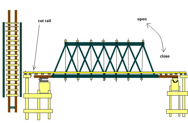

I have 2 options;
1. hinges on top of the bridge seems to be the norm
2. and one suggestion where the hinge is below the bridge.
Korms Bridge.jpg (38.48 KiB) Viewed 22189 times
Bit more thinking/planning to be carried out
Re: Lift up bridge questions
Posted: Tue May 12, 2020 6:24 am
Either should work. The 'below' option will be potentially less visually obtrusive but more complicated to implement, I think.
Posted: Tue May 12, 2020 9:37 am
by Jimmyb
I agree with Philip, the hinge below does look good, but could be complicated, but if you have the skill *and i am sure you have) go for it.

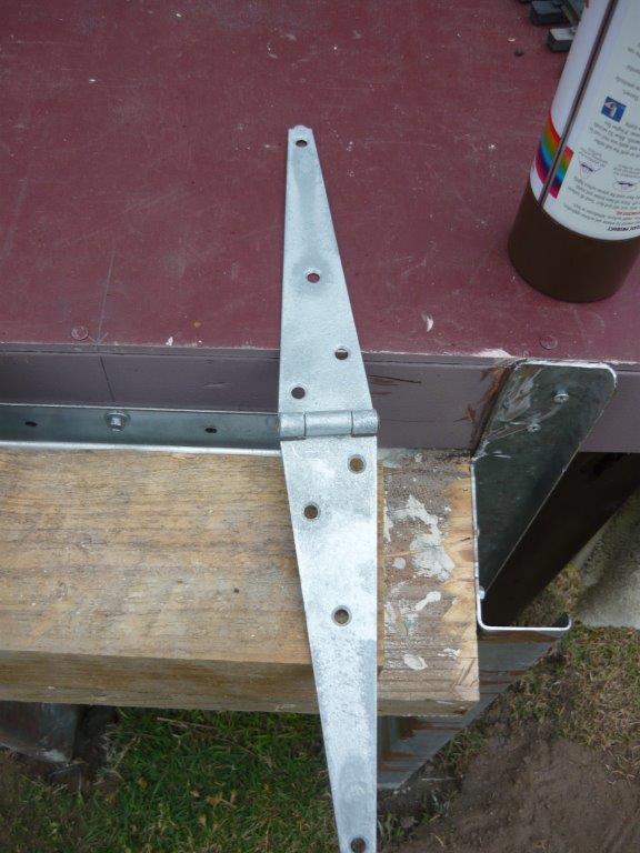

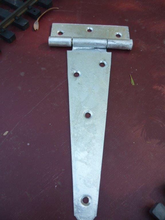

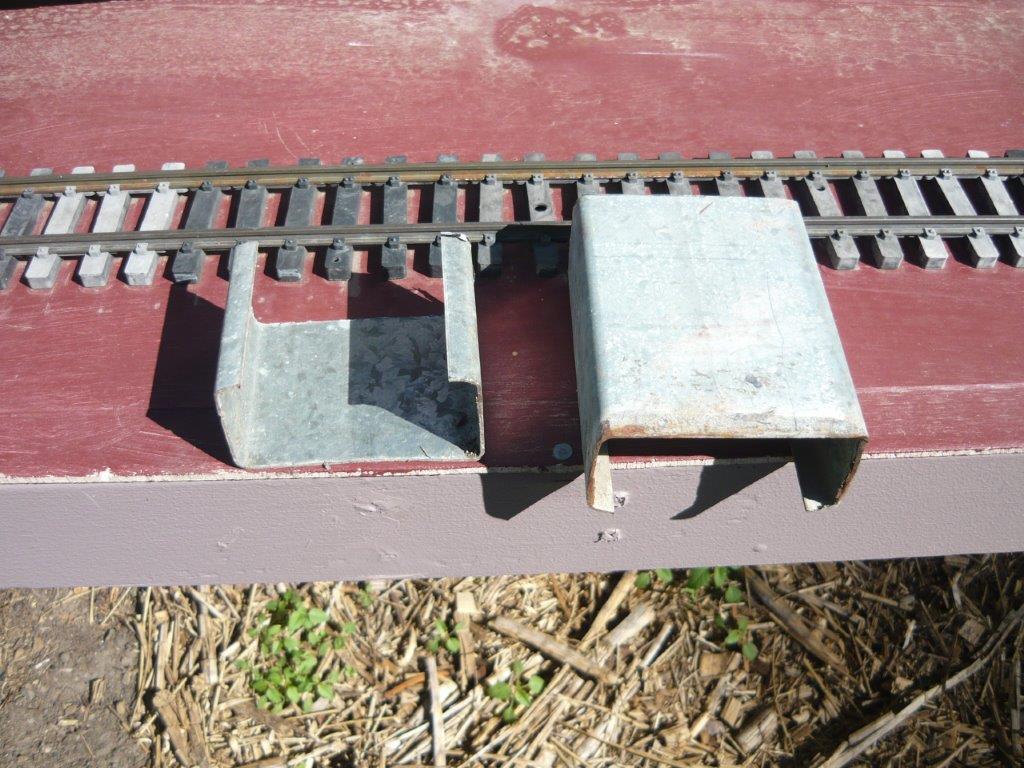

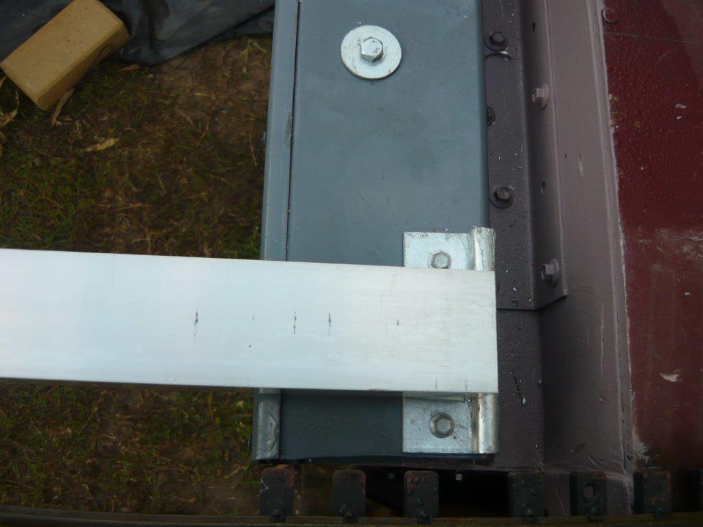

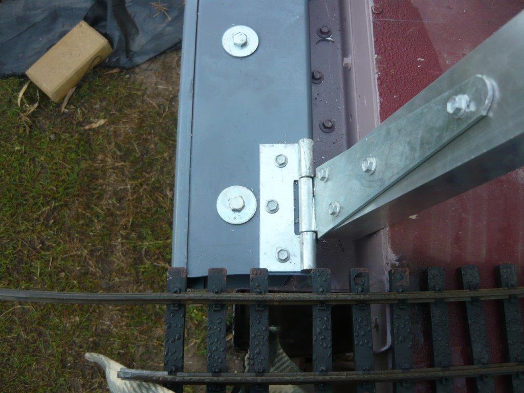

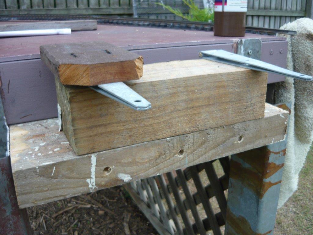

Pictures of the mounting block made from "C" Purlins and the new more robust hinge.
Type of Purlin pieces used
C purlin pieces.JPG (149.63 KiB) Viewed 21723 times
The mounting block
C Purlin Mounting Block.JPG (99.7 KiB) Viewed 21723 times
New hinge
Second Hinge.JPG (42.27 KiB) Viewed 21723 times

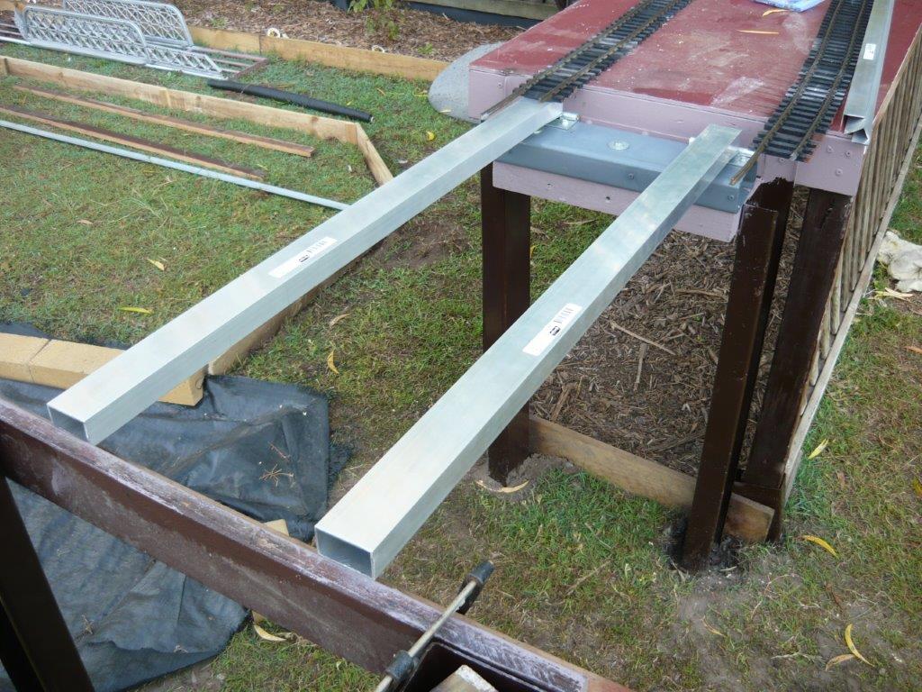

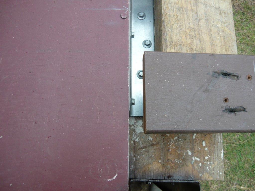

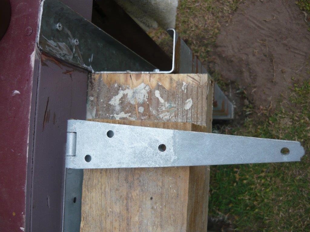

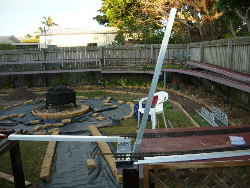

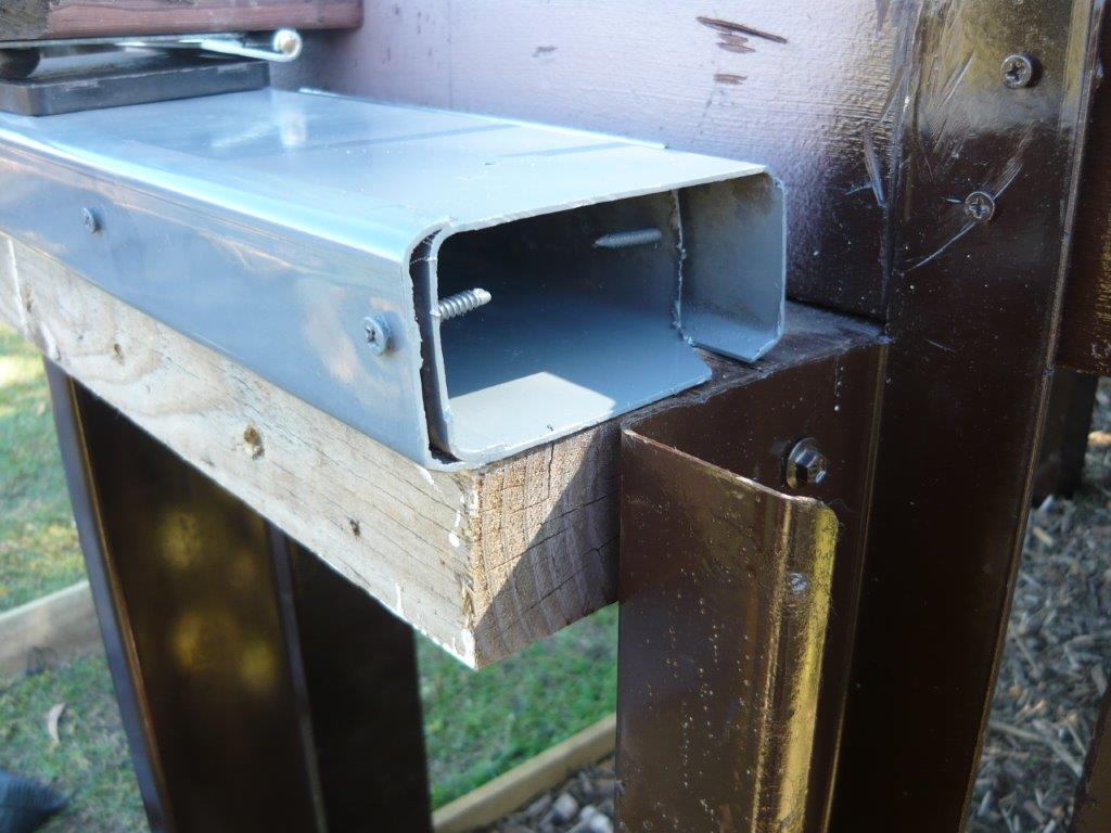

I built the bridge supports out of aluminium box section to reduce the weight so SWMBO can open it, if I made it out of hardwood it would be to heavy for her.
The whole bridge will be made out of aluminium.
Some pictures of the supports an hinges also showing mounting block attaching bolts.
Bridge Supports.jpg (170.12 KiB) Viewed 21697 times
Bridge Support Open Position.jpg (156 KiB) Viewed 21697 times
Hinge with Support.jpg (75.9 KiB) Viewed 21697 times
Hinge with Support (Open).jpg (106.38 KiB) Viewed 21697 times

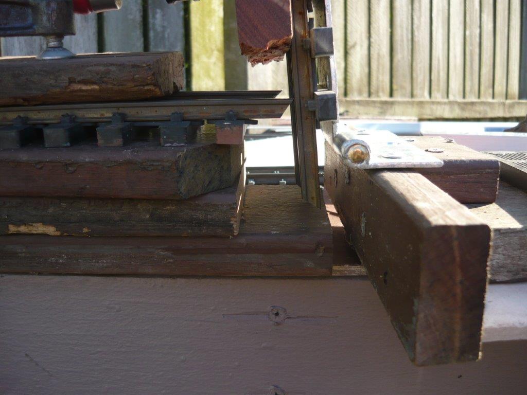

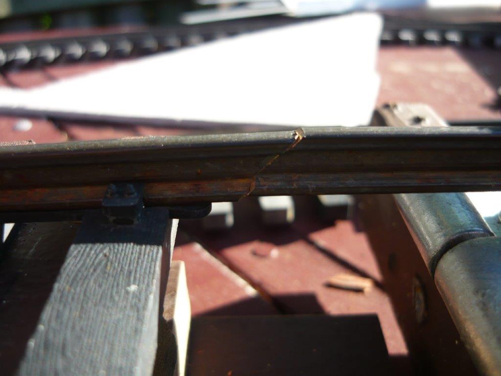

A question was asked on another forum about the pivot height and when I revisited it I found that when track is attached to the supports there is a yawning gap that just does not work.
I have built a proof of concept jig to test the opening method and so far it appears that the secrets to having the hinge below the track is the angle of the cut made to the track, 45 degrees as opposed to vertical seems to work the best with no fouling.
So it is back to the drawing board for this little project.
Posted: Fri May 29, 2020 1:18 am
by GAP

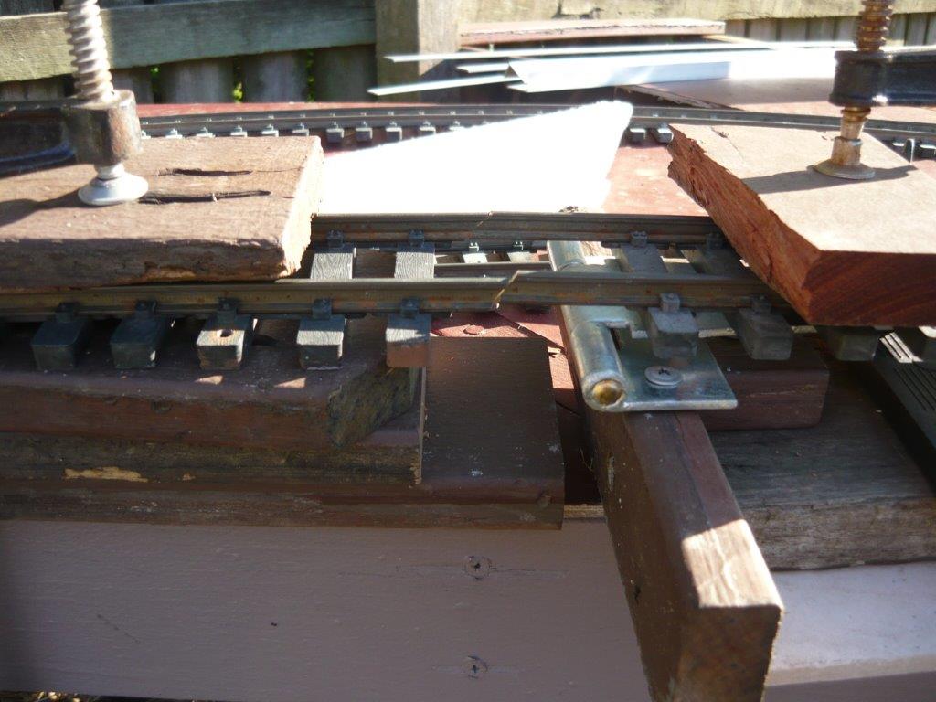

Bridge Design MkIII proof of concept jig has been built and the design has been tested with positive results.
As previously stated the secret of the opening is the 45 Degree cuts in the rail which allows the moving rail to drop away from the fixed rail without fouling.
The moving arm of the hinge is level with the baseboard and the gap that the rail folds into is not real wide.
The error I made with the MkII was that I put the bridge support on top of the hinge and when the rail was added the gap was just unworkable as the support folded into it, the bridge support will now be level with the top of the hinge and will not fold into the gap.
So now the bridge construction can now begin following the concept principles.
Closed
Proof of Concept Jig (Closed).jpg (97.21 KiB) Viewed 21618 times
