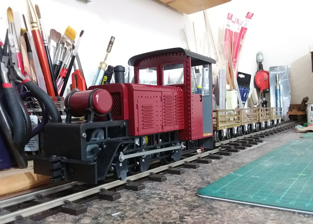

Hi folks, i may have mentioned in my CCT thread that i was getting a baldwin kit in 45mm, well it showed up a month ago and here are some photos of it.
the mostly complete chassis
mostly complete body

That's looking pretty good so far Mitch. What is the chassis made of? I like these Baldwins, looking forward to more of the build.

Hi grant, the chassis is made out of laser cut steel, the project is currently on hold waiting for new axle bushes to come and a few electrical bits too

the chassis is pretty easy to put together, just screws and washers mainly.

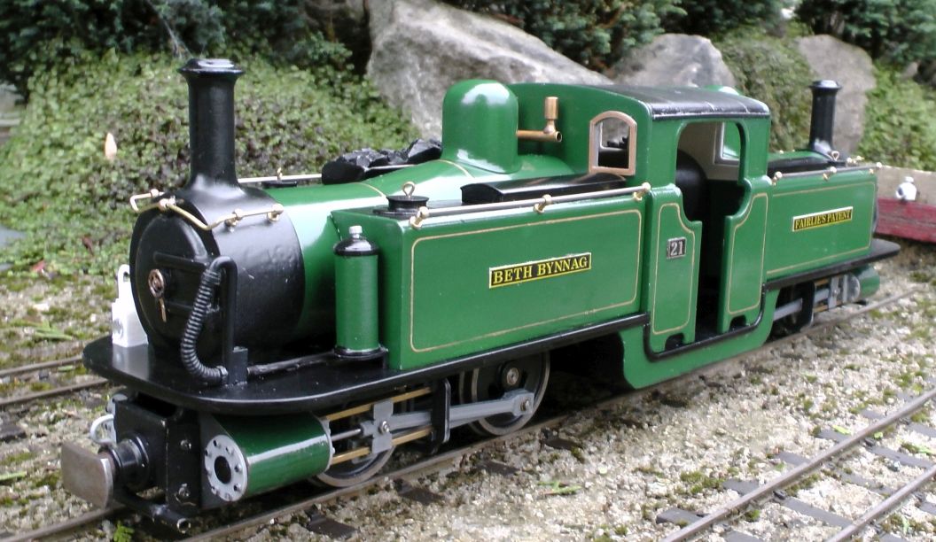

PDF double Fairlie, completed December last.
The main kit came via evilbuy, and turned out to have many parts missing.
However, it had been well prepared, with a good coat of smooth primer.
I had to source another motor, and in the process bought a third bogie from that auction site.
This gave me three bogies, all with different motor mountings.
A good deal of bodging and fettling followed, and I'm quite pleased with the outcome.
[attachment=0]MR191207-009.jpg[/attachment]

You should be pleased, that has turned out a nice model.

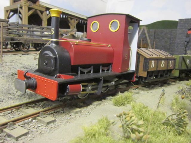

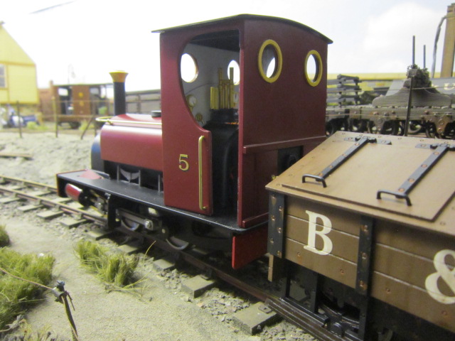

The Hunslet kit is now complete and looks pretty good, I think!. It has been interesting to get a smooth finish of the material, but well worth the effort. I am seriously thinking of doing it again, for myself this time. Although there is limited (understatement again!) space in the boiler, I have managed to fit 8 rechargeable AA batteries in there and made a special housing for a 3 position (on, off, charge) switch in the cab, and the RC receiver alongside the firebox.
Dennis and Julie are pleased.....

Post by LNR » Fri Feb 28, 2020 11:52 pm
You've certainly achieved a beautiful finish, and I don't imagine there's much free space left in such a diminutive loco.

The finish you've achieved is remarkable, having seen the starting point. How have you achieved that really effective satin finish?
Posts: 5713
Re: PDF Baldwin the Build so far
Post by Peter Butler » Sat Feb 29, 2020 11:40 am
Thanks guys, always nice to receive such a response.
There has been a lot of preparation time and effort to get a good smooth surface, without that there is no chance of a good finish. Having prepared the surface I first sprayed the individual items with Halford's filler primer, two coats, followed by a fine wet and dry sanding. Next, several fine spray coats of chosen acrylic colour, which leaves a high gloss finish. Final assembly of the loco follows and then a single spray coat of Matt Lacquer, which reduces the full gloss to a nice satin appearance...... simples!
