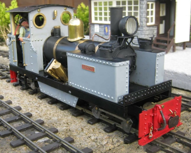

Details of said locomotive:
Cross sectional drawing of steam motor
The locomotive as originally built
After Berry Hill Works repaint

Posted: Thu Nov 21, 2019 1:22 pm
That repaint is a beautiful job and turns a fairly mundane looking loco into something really eye catching.
