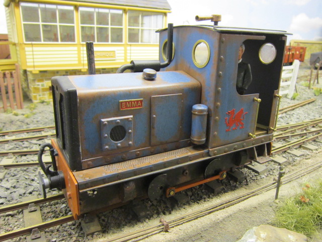

My Jessie was one of the first locos I acquired and in poor condition, I stripped it completely and re-built it with extended chassis either side of the bonnet. I believe it still has the original motor and gearbox although doesn't get used a lot (like all my stock!), however, with the RC Trains control system is a really smooth and responsive runner.... nice loco.....
Re: IP Engineering Jessie rebuild
The weathering on your "Jessie" is brilliant Peter. I love it.....

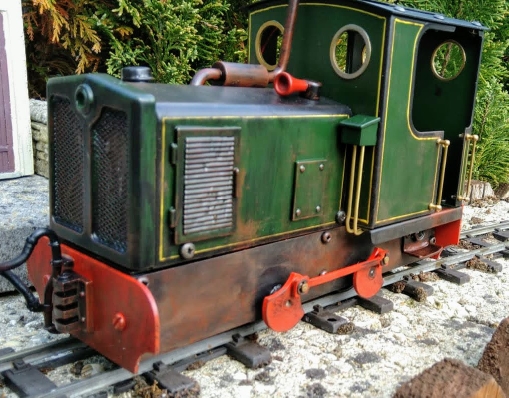

So, after a complete rebuild - including a new motor, gearbox and Fosworks RC and sound; the finished article:
- Posts: 5713
That's a lovely job, great transformation, well done.
Very nice weathering job on your Jessie...JMORG wrote: Fri Aug 07, 2020 9:30 am So, after a complete rebuild - including a new motor, gearbox and Fosworks RC and sound; the finished article:
