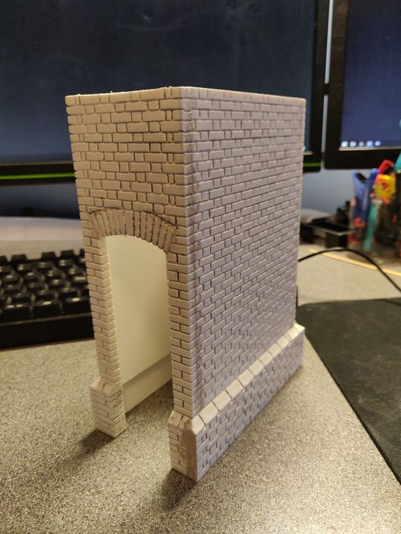

The PVC foam was marked out, cut and filled as per Rik's writeups, resulting in a brick shell:
1-5 shell_resized.jpg (82.3 KiB) Viewed 72078 times
