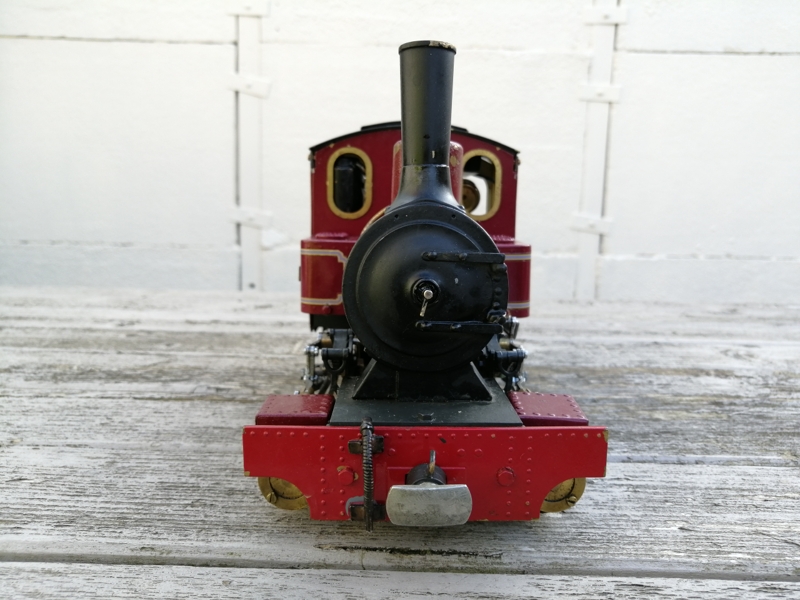

Rod (FWLR) sent me his Billy recently as he was not happy with how it performed and had concerns that the Summerlands chuffer was not fitted correctly (and you will see he was right to suspect this).
This is how she arrived:
Unfortunately, the loco has had a little accident in Rod's ownership and when steamed it was evident either the timing or return cranks were at fault.
But before looking into the poor running I wanted to see why the chuffer was wobbling about in the smokebox and was not making much of a chuff noise.
Smokebox removed, mystery solved:
I have come across some botched chuffer installs since tinkering with locos but this one beats them all.
Once both exhaust pipes were connected to the chuffer it was on to fixing the running issues.
I played about with the timing but got this far before I suspected something else was wrong as I was not happy with her performance:
Inspection of the return cranks found the culprit, one was not set correctly (possibly from her little trip off the line as the cranks had not been pinned).
Second attempt and much happier with her:
