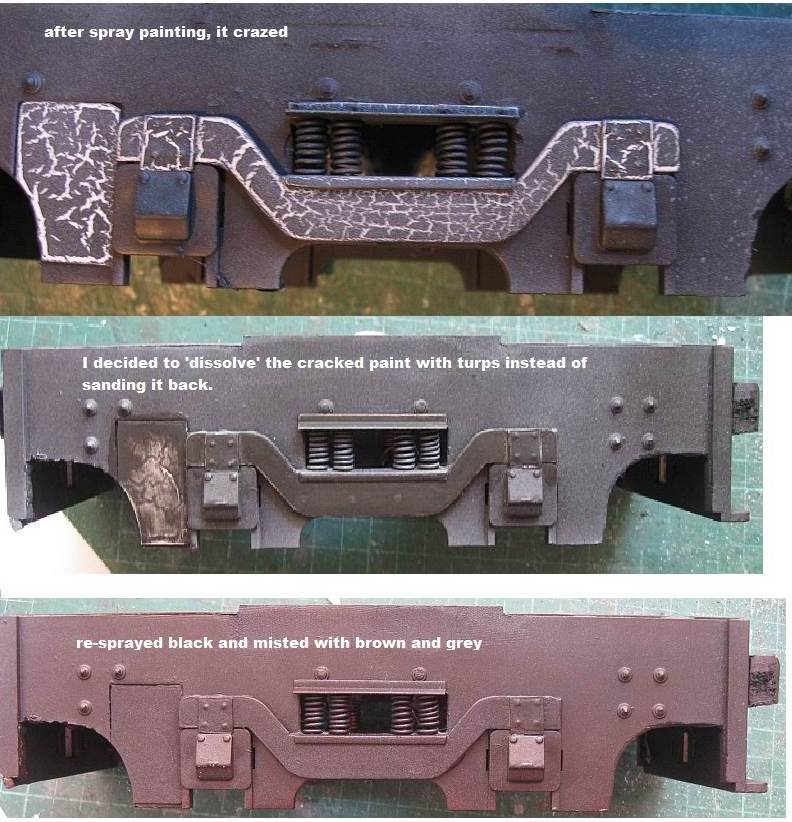

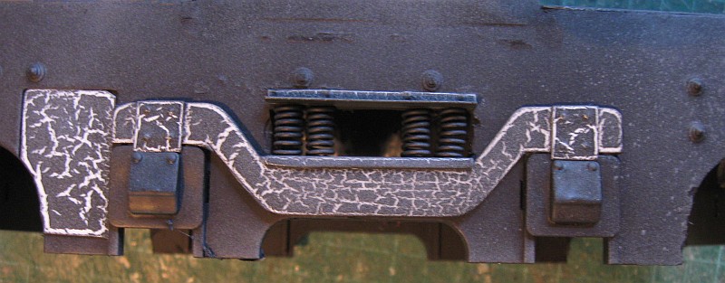

I'm always having problems using spray cans of paint on styrene.
Sometimes - just sometimes, the paint crazes like this
crazed paint.JPG (89.16 KiB) Viewed 6534 times
In this case I sprayed directly onto the bare styrene. Usually I spray grey primer first and it 'rarely' crazes.
I've searched for the reason, but drawn a blank. I've tried ensuring the can is warm enough (not a problem in Sydney in summer).
I've wondered if it is high humidity (it IS in Sydney). I've washed the styrene parts in soap and water and rinsed well but still SOMETIMES it crazes.
And usually the solution is to sand it all back and hope it works next time. Bit of a pain if I've spent hours adding rivet detail!
Anyhow, I have managed to find a part solution - I took a cotton tip (?) and dipped it in turps and washed it over the crazed paint. It dissolves and makes the paint 'flow' into the cracks.
repair crazing (1).JPG (151.84 KiB) Viewed 6534 times
the picture looks worse that it is - just use lots of turps so it 'flows'.
repair crazing (2).JPG (126.79 KiB) Viewed 6534 times
Not a perfect job, especially if you want a perfect finish.
But in this case of the bogie, it allowed a quick fix. Here's the result.
crazed 3.jpg (101.83 KiB) Viewed 6534 times

philipy wrote: Tue Feb 12, 2019 8:57 am Greg,
I'm not trying to be clever, but when you say turps, I assume you mean 'white spirit' not actual turpentine proper?
Here in Oz, it's full name is Mineral Turpentine, but called turps by everyone. It can be used to thin enamel paint and for cleaning brushes.
Don't know what white spirit is.
