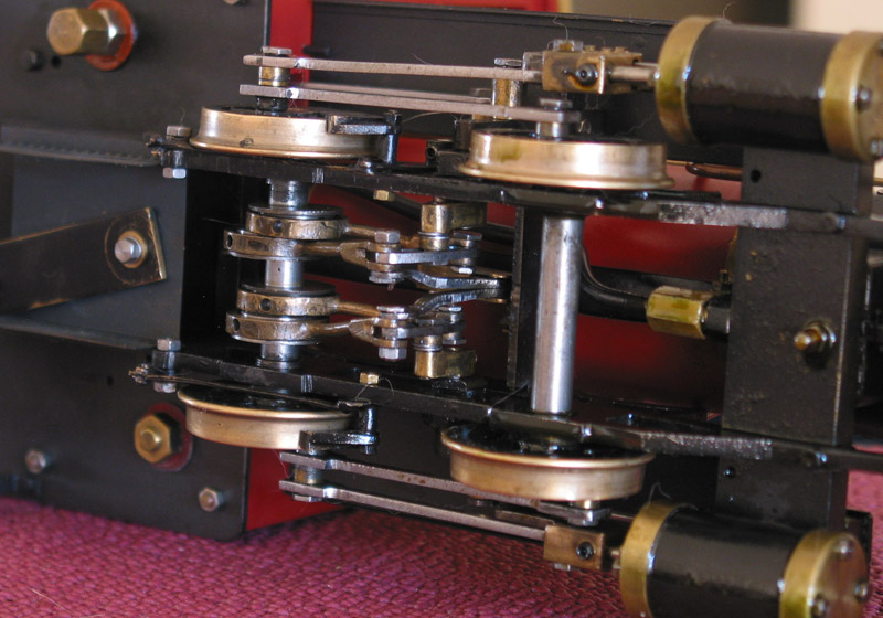

The following pic is the Stephenson valve gear that Gordon fitted to the 45mm gauge Philadelphia models that he built about 20 years ago. To give you some sense of scale, the coupled wheelbase is 53mm, the driver dia. is 33mm and the cylinders are 7/16" dia.
The 32mm gauge mm models came with slip eccentric gear, due to the restricted space between the inside frames. My loco was one of the machinist kits he sold and had a hard life before I found and restored it, so I was very familiar with the valve gear by the time I finished. There are a few general pics of the restoration in this old thread, but none show the valve gear.
https://gardenrails.org/viewtopic.php?f ... win#p58209
These models are smaller than a Roundhouse Lilla and being typical Baldwins, the valve gear is inside, with the valves and cylinders outside. Gordon supplied bronze castings for the eccentric straps and rods, but I've fabricated them on subsequent models, using gunmetal straps and brass rods/clevises. The eccentrics are fixed to the axles with grub screws so they can be adjusted and there is a hole drilled through the eccentric strap to access the grub screw once everything is assembled.
The rockers needed to transfer the valve drive through the frames is what takes up a lot of space which wouldn't be needed if the valves were also inside the frames. Also 45mm gauge inside frames are closer together than 32mm outside frames, which is why I think it can be fitted to a 32mm gauge Quarry Hunslet.
Clearances are fairly tight, but no worse than the area around the crosshead and slidebars on an outside Walschaerts loco. in this scale. The valve gear does run OK. It can be linked up and will use less steam when that is done.

...The following pic is the Stephenson valve gear that Gordon fitted to the 45mm gauge Philadelphia models that he built about 20 years ago. To give you some sense of scale, the coupled wheelbase is 53mm, the driver dia. is 33mm and the cylinders are 7/16" dia....
That's most useful! - thank you!
Lilla wheelbase is 72mm and driver dia is about 34mm, so your pic is directly comparable. Your loco might be 45 mm gauge, but if you take away inside frames (and replace them with outside frames) it could easily be 32mm gauge?
...The 32mm gauge mm models came with slip eccentric gear, due to the restricted space between the inside frames. My loco was one of the machinist kits he sold and had a hard life before I found and restored it, so I was very familiar with the valve gear by the time I finished. There are a few general pics of the restoration in this old thread, but none show the valve gear.
[url]...Also 45mm gauge inside frames are closer together than 32mm outside frames, which is why I think it can be fitted to a 32mm gauge Quarry Hunslet...

For comparison, the eccentric rods in that photo of my Philadelphia are only 28.5mm between centres and that valve gear works fine.

That's very interesting. I would love to know more about ( - better to learn from other people's mistakes :D ):
...poor chassis design...
Pleased to hear, that she now :
...runs very nicely...
I presume that 3/8" dia cylinder (when compared with RH 9/16" ??) wasn't "the" problem?
They all run on 40psi boilers?
I know about Roundhouse one (what type of valve gear does it have?) but I get excited more about designing and building than buying, so that one is not for me :mrgreen:
p.s. how about side by side photo of Roundhouse and Swanage Models version :thumbup:

The chassis problems were more of poor construction than poor design, although the latter did come in to play. The axle boxes are sprung but on some locos the springs are so weak the boxes are always on their stops, while on others the springs are so stiff the loco bounces around as it runs. Add to this spring stops of different lengths (making the loco three-legged), non-parallel frames and a host of other issues conspiring to make the running poor.
Yes, 40psi boilers on both locos.
Swanage loco has 1/2-inch cylinders.
The Roundhouse version has their own design of valve gear.
Picture below ... Roundhouse at top, Swanage below.

Many thanks Tony :thumbright:
I always thought that LBSC's idea of brazing frames to buffer beams made for much more rigid and stable loco, so I guess Ross's design (particularly when "poorly constructed") was likely to be flimsy...
I guess you have improved matters by getting better axlebox springs? or did you dispense with springing altogether?
Spring stops of "different length" totally puzzle me - or was it another case of "poorly constructed"?
There is a mention of springing problems in this report:
Garden Railway Club - Lilla
although I must admit I do not understand the solution proposed there?
Did 3/8" cylinder in Ross's loco cause it to be more temperamental than Roundhouse version? (as reported by David Jones on Yahoo group).
Do you know dia of Roundhouse cylinder?
Google search didn't come up with an answer so far...
Thank you for the photo of the two suspects :D
Strangely Swanage one looks slightly bigger than Roundhouse version (or is it photographic distortion?).
Chris
ps apologies for this inquisition :mrgreen: but it is so good to find someone who is not only experienced but also has the two versions of the loco that interests me, that I cannot resist asking all these questions - hope you don't mind?
Re: "Garden Rail" 1994 Ross Harrison's 16mm Hunslet (Lilla)
Posted: Wed Feb 27, 2019 10:51 pm
by TonyW
bambuko wrote: Wed Feb 27, 2019 6:35 pmI always thought that LBSC's idea of brazing frames to buffer beams made for much more rigid and stable loco, so I guess Ross's design (particularly when "poorly constructed") was likely to be flimsy...
Mine got new buffer beams on arrival as they were the main cause of the misaligned frames. Putting the fixings were they should have been squared-up the frames and stopped the running gear from binding.
bambuko wrote: Wed Feb 27, 2019 6:35 pmI guess you have improved matters by getting better axlebox springs? or did you dispense with springing altogether?
Mine still has its springs but with the stops all the same length it actually rides on the stops rather than the springs, which is fine. Better that than a later "bouncy" one with stronger springs, I feel.
bambuko wrote: Wed Feb 27, 2019 6:35 pmSpring stops of "different length" totally puzzle me - or was it another case of "poorly constructed"?
I'm afraid so. Basically they are a piece of stout wire soldered in to the top of each axle box so they should all be the same length.
bambuko wrote: Wed Feb 27, 2019 6:35 pmThere is a mention of springing problems in this report:
Nor me, but I do know the person who owned that loco no longer does.
bambuko wrote: Wed Feb 27, 2019 6:35 pmDid 3/8" cylinder in Ross's loco cause it to be more temperamental than Roundhouse version? (as reported by David Jones on Yahoo group).
It did "scalded cat" very well, hence fitting of radio control. My experience of the Roundhouse version is that it is much more docile.
bambuko wrote: Wed Feb 27, 2019 6:35 pmDo you know dia of Roundhouse cylinder? Google search didn't come up with an answer so far...
No.
bambuko wrote: Wed Feb 27, 2019 6:35 pmThank you for the photo of the two suspects :D Strangely Swanage one looks slightly bigger than Roundhouse version (or is it photographic distortion?).
They were pretty much identical size-wise, although the chassis on the Roundhouse version is wider to accommodate use on 45mm track - no chance of that on the Swanage one.
The thing that puzzles me is where all of the Swanage ones are now...? I know of one other that is pretty much a Shelf Queen, and another is owned by a friend of mine (and runs nicely). I know several people who owned one but have sold them on. I know several people who had one on order but cancelled when their issues came to light.
