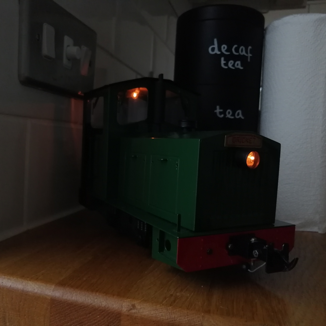

When fitting working headlights on models I always use a grain-of-wheat "proper" light bulb. These give a warm pink light that mimics those seen on the full-size Darj locos. LEDs can be a bit stark and bright.

Agree with Tony here, they look good on my Brandbright Cricket:

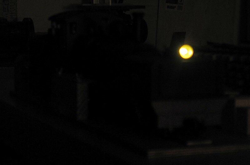

White LEDs actually emit UV and like a fluoro tube, the colour temperature you get depends on the phosphor used. The 'standard' white ones emit a distinct blue white light, but there are white LEDs available that emit a warmer colour. Usually referred to as warm white, or golden white and the body is an orange colour rather than clear.
The warm white 3mm LEDs I fitted in the Ceylon Garratt have a definite yellow cast that is a good match to the headlights the VR used on mainline bg steam locos. These gave off a warm golden light, nothing like the blue white sealed beam lights you see on modern diesels.
On my railcars I used yellow LEDs to simulate the colour you'd expect from headlights running off a 6V automotive electrical system.
It was like trying to take a photo of a black rat in a coal mine, but the colour in the attached shot is what I get with the warm white LEDs fitted to my Garratt.

None recently, so thanks for the additional information. However, I do still have a big bundle of bulbs...!

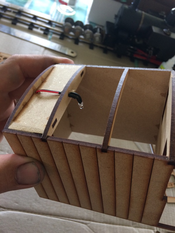

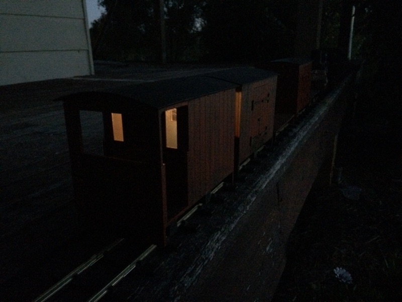

As mentioned previously , using the correct type of LED is critical to having something that looks correct as a headlight. Also, you can easily paint the LED to gain the required effect too if needed. That biggest advantage with LEDs is the very low current draw, so battery’s last a hell of a lot longer than with traditional style globes of equivalent size. I recently fitted an interior light into a brake van kit I was building from Houston gate locomotive works , and in the process I accidentally got a fairly heavy but even coat of grey etch primer on the LED. I almost cleaned it off but had second thoughts about it, opting instead to test the lighting first because I was a little worried the LED would throw off too much light for such a small area and look very unrealistic. The result was petty much bang on what I wanted so the overspray stayed. I will attach a photo in the next post

Photo of the van being built , before painting, and the finished look at night time

That's a nice warm glow effect from the LED you have used, what is its specification?

I purchased them off a Chinese eBay seller that didn’t give much info on them other than they were 3mm , warm white, 9-12v operating range , and very cheap.
