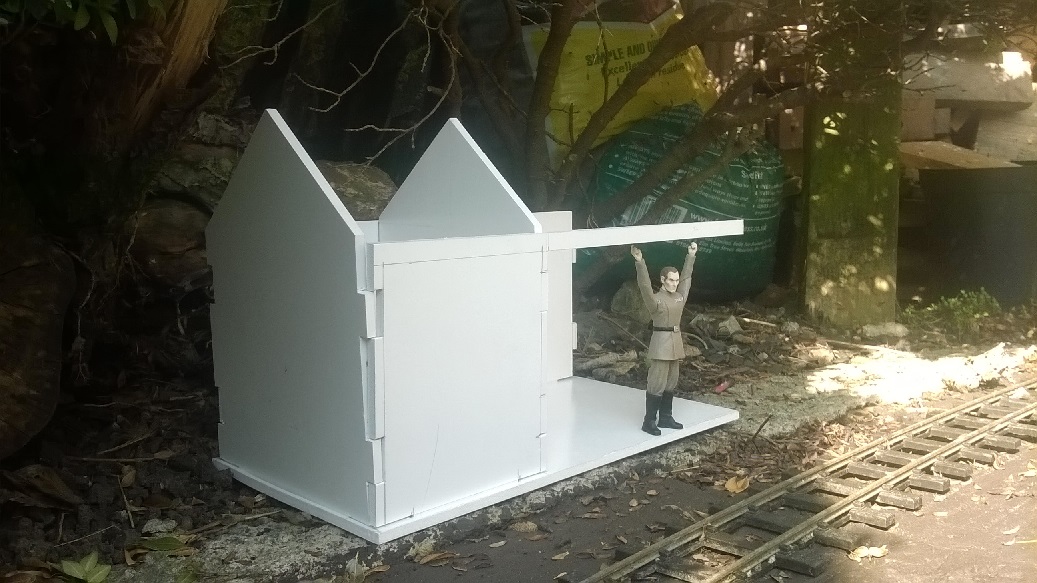

The (Windmill Hill) Welsh Highland currently has very few buildings - a station building recycled from my old line at Trefechan, a resin corrugated hut at Clarach, and a grounded coach body at Penlan. I thought it was about time that changed, so have started knocking together a station building for Penlan based on the one at Nantmor on the old Welsh Highland and recreated in mirror-image at Pen-y-Mount on the present day Welsh Highland Heritage Railway.
Here's where it's at currently, with a Star Wars baddie taking a break from taking over the universe to lend a hand. He's also been useful in working out rough measurements - he's 6'3" in 16mm, pretty tall for the 1930s, so if he doesn't bang his head my other passengers should be fine...
The walls and the floor (which will represent a concrete base) have been cut from 5mm exterior foamboard, and I'll stick corrugated plastic over the top. Windows will be from a dollshouse range (the same type sold by Jackson's Miniatures) - in the absence of drawings I've used photographs to make my own plans which will suit the windows. It's a slightly backward way of doing things I suppose, but quite liberating to take a "looks about right" approach...

Looking good so far Andrew. Interesting technique with the dovetail joints at the corners. I've not seen that done before, I just butt them up and put reinforcing fillets inside.

I think "dovetail joints" may be a little grand for this hacked-together construction! Slot and tab? Anyway, because I'm making up aspects of the build as I go along, I felt I needed the ability to take it apart and reassemble until a fairly late stage so I can cut window openings etc as I go... The whole project was inspired your lovely buildings - I think I'm using the same board supplier and glue that you use, based on a Forum recommendation you gave a few years ago, so thank you!

tom_tom_go wrote: ↑Sat Sep 01, 2018 9:25 pm Looks good so far, I like the action figure doing the YMCA...
Re: (WH)WHR Buildings
Grand Moff Tarkin, Governor of the Imperial Outland Regions, and Commander of the Death Star (I looked him up...) has asked me to point out that he wasn't "doing the YMCA" but helping support the front of Penlan's station of the building, out of the goodness of his heart. If he wasn't such a nice guy, he added, he'd be training his deadly lasers in the direction of certain garden railways...Soar Valley Light wrote: ↑Sun Sep 02, 2018 8:46 pmtom_tom_go wrote: ↑Sat Sep 01, 2018 9:25 pm Looks good so far, I like the action figure doing the YMCA...![]()
I'm not so sure myself - when I went out to photograph progress yesterday he seemed to be throwing some shapes in the new waiting area/dance floor:
Frankly, he's outgrown his usefulness, and he's going to start getting in the way if he keeps bustin' moves all over the place, but how do you tell that to a grumpy old man who has the power to destroy entire planets? Through the medium of dance, perhaps?
Anyway... The photo was intended to show that there's been a little more progress on the station building, with the end cut out and a start made on the (plastic) woodwork. You can see the sort of thing I'm trying to achieve here:
Looking at that I think I may have the pitch of the roof a little wrong, although it's hard to tell because the proportions are all slightly different anyway... I think the roof's the next step so I'll pause for a bit of a think (and a new knife blade) before cutting any more foamboard...

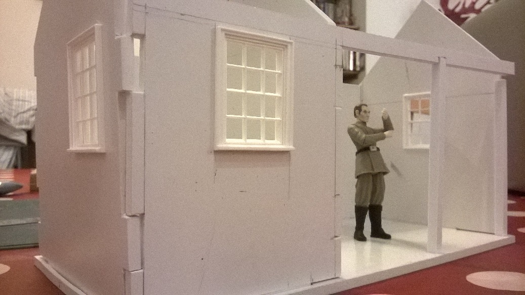

A little more progress this evening, with the window apertures cut and the window frames temporarily pushed into place:
I've lowered the roof a little too since this photo was taken, looks better now I think...
I like the slot together design and as you are going to clad over the slots they won't show unlike on some laser wood cut kits.
It's working pretty well for me so far - I took it apart and put it back together again twice yesterday, once to cut the windows and once to modify the roof. I could've avoided all that by doing some really careful planning before I started, but I'm rather enjoying the carefree make-it-up-as-I-go-along approach. The tabs should make the finished thing stronger too, because I wouldn't have been able to brace the corners in the open waiting area.tom_tom_go wrote: ↑Mon Sep 03, 2018 9:39 pm I like the slot together design and as you are going to clad over the slots they won't show unlike on some laser wood cut kits.
