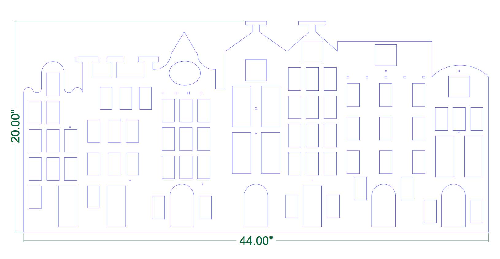

Thanks for the comments; but I am still working on it. In the past, laser cutting people accepted pdf file but now they need a vector-based file. I have CAD software but it would take a long time to draw as I am not a professional in this aspect. Fortunately, I found Fiverr offers such a service, and Madelemara (https://www.fiverr.com/madelemara; madelemara289@gmail.com) helped me with only $20. Attached figure he did for me within a day. I was impressed.

I was busy for traveling in the past days; but I had spent a few minutes a day to look for laser cutting companies. One company, you may not want to know the name, asked ~ $700.00 when I sent him the pdf fiel and he said he needs to spend time to draw it. Then, I hired Fiverr people to sketch the buildings in dxf file and sent to him again, and this time he asked the the cost of laser cutting and material, altogether ~$1,000. I guess he didn't remember me who contacted him just a week ago. Anyway, Pololu in Las Vegas, NV charged me totally for the job $122 ($88 for laser cutting, 34 for 3mm-thick plexiglass, dimension 20 x 44 inc). I am sure this is the best deal among many companies I contacted so far. And they are also very easy to accept the files. Just let you know, in case if you need to do similarly.

Here is the printout from Pololu,
Plexiglass building prior to laser cutting.jpg (96.45 KiB) Viewed 113954 times
