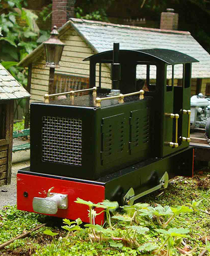

The GWLR has just taken delivery of a new diseasel locomotive for PWay and recovery work on the line.
Seen here undergoing acceptance trials on the Silverdale Light Railway (North), he has yet to be modified in any way. Plans include RC, Sound card, detailing and general 'roughing up'
Being a Mamod Boulton, he will be called 'Matthew'.

Belatedly, here is an attempt to catch up on the trials and tribulations of a Mamod Boulton, including both detailing (done and yet to do) and problems encountered, together with the solutions.
As Received, and Running In
This is the loco in 'factory condition' As supplied, she is manually operated - with a battery holder for 8 AA batteries, which could be fitted with rechargeables and charged in situ via the provided charging port in the cab (a fairly standard 2.1mm socket). There is a toggle switch in the cab also, which switches the loco on or off together with a switch which changes direction from forward to reverse or vice versa. Speed is controlled via the exhaust stack, which is simply an extension to the arm on a potentiometer.
The chassis and running gear is manufactured by Essel and supplied to Mamod for assembly, as I understand it.
I ran the loco in this condition for all of last summer, and it performed reasonably well, but as it 'ran in' one or two problems became apparent The motor and gearbox gradually became noisier in operation. Upon inspection it appeared that the motor had somehow worked its way loose, and one of the brass wheel bearings had become detached from the chassis and was just rotating on the axle. (Having taken this photograph, I realised how much crud had accumulated around the gears and it has now been cleaned!)
I decided to disassemble the running gear and motor to check there was no inherent fault. The problem with the motor was fixed by simply tightening the mounting screws for both the motor and the gearbox, which had either worked loose or never been tightened to the chassis in the first place. The brass bearings had been fitted with the flange to the inside of the chassis. As they were a push fit, they had simply worked there way out onto the chassis and become free floating. Reassembling them with the flange outside the chassis meant that the coupling rod assemblies would keep the bearings in place on the chassis members. It may be that when set to 45mm this wouldn't be an issue, as the wheels would keep the bearings in place on the chassis, but that isn't the case when set for 32mm running.
It would appear that the problems are simply due to a lack of quality control in the assembly process - they were easily fixed once apparent and don't detract from the usefulness of this little loco. I would say that if you are considering a Mamod Boulton, don't let these niggles put you off. It is a well engineered chassis to a trusted and proven design and will form the basis for an interesting and individual diesel locomotive, or even just provide a quick set up useful engine. I'll go on to the work I'm doing to make mine more individual in another post.
